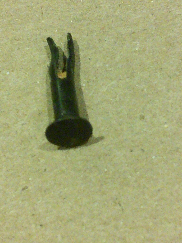

This is one of the 4 rivets; I used a thick awl with a small metal bar as fulcrum, and unbent the two curls one by one, straighten them with pliers and voila. No real damage to wood either.

(02-27-2019, 09:29 PM)morzh Wrote: ........This is one of the 4 rivets; I used a thick awl with a small metal bar as fulcrum, and unbent the two curls one by one, straighten them with pliers and voila. No real damage to wood either.
I wonder if I could reuse thm, tbey have that patina........
Good save Mike, that's the first Zenith handle rivet I've seen removed. I don't see why they couldn't be reused unless a side breaks off from being re-bent.
John,
Yes it is also my fear, but should I be able successfully remove all 4 of them, I will try.
Not sure how I am going to curl them back, but methinks a thick needlnose will do.

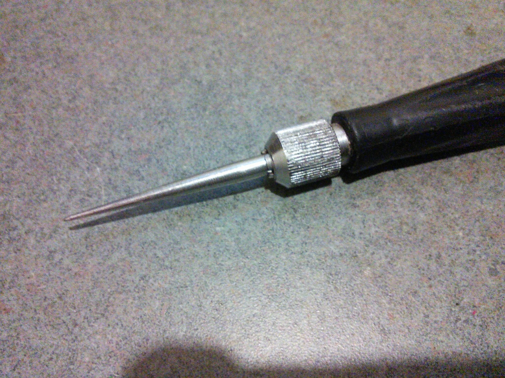

I use an awl by itself to pry out the rivet curl and then continue to use it with a 1/16" flat piece of metal (I use a small flat chisel) as fulcrum to continue extracting the curl, then straighten the curls end with pliers and extract the rivet.
The awl

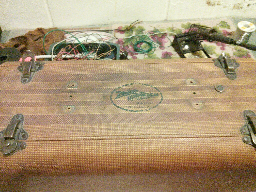

The top of the radio

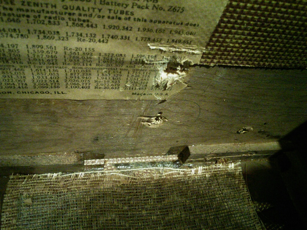

The wood under the rivets

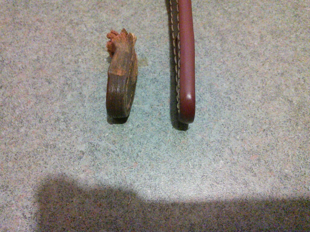

Compared thickness of the new artificial and original handles

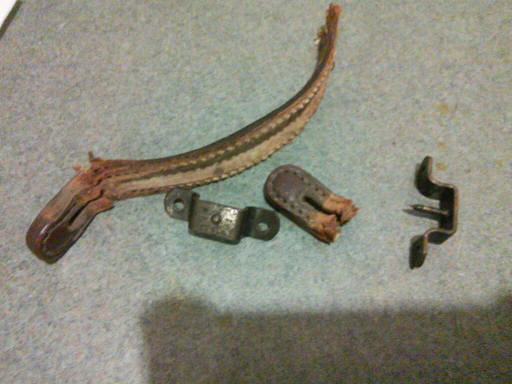

Removed parts
