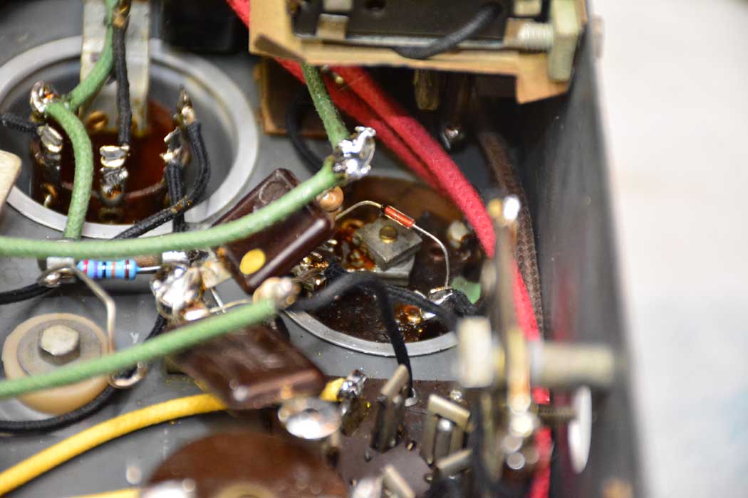

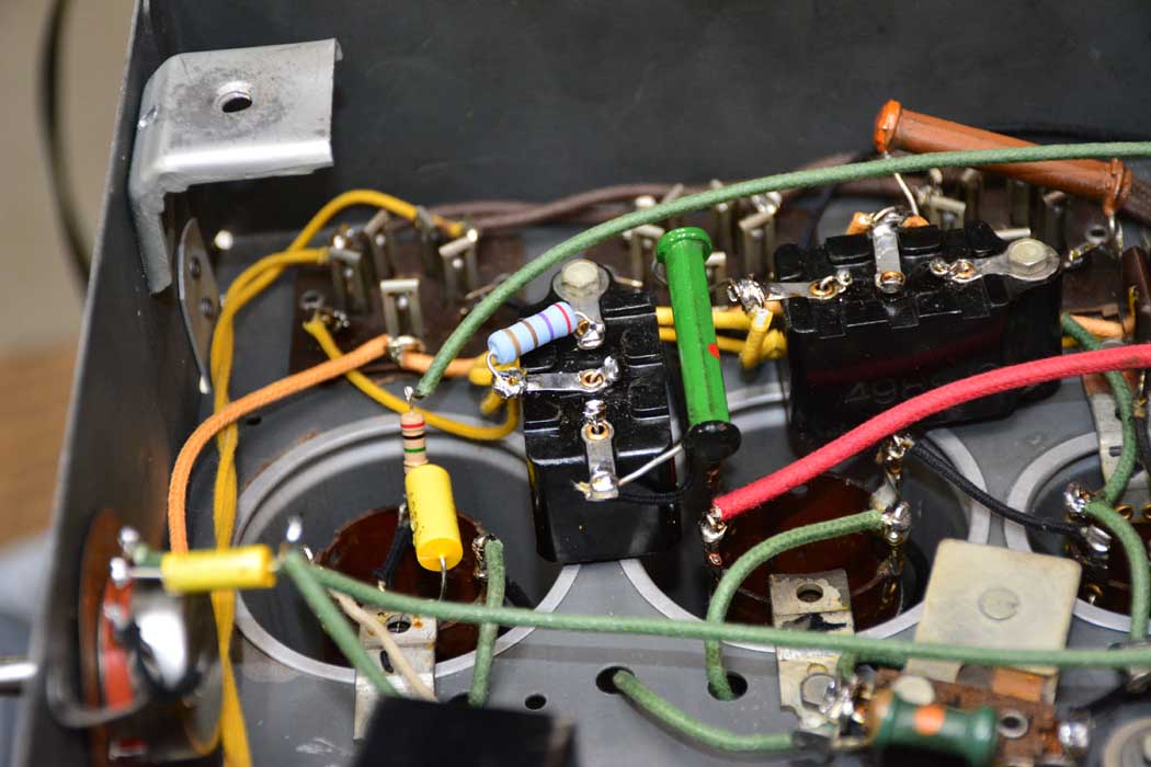

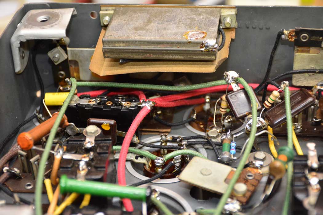

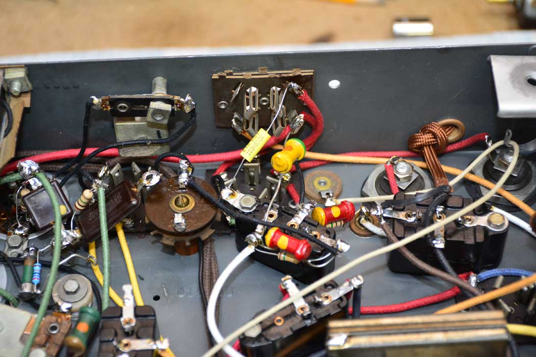

Ed and Rob, I would like to see photos of the underside of your chassis. I'm wondering if my problem is a parts placement issue. I do have AVC capacitors sharing bakelite blocks with plate/screen bypass caps, and that was probably a mistake.

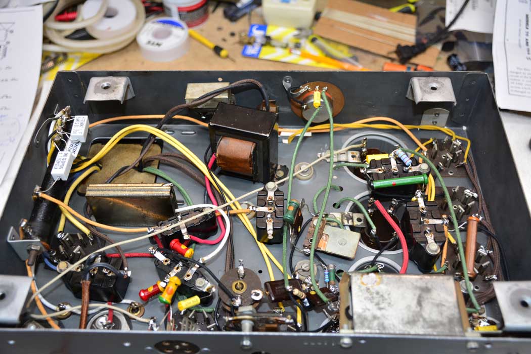

Interesting! You know everything after the volume control works. layout is nothing special on mine. In fact, since I wanted the ability to turn it back into a normal 70, the AVC line is just kind of supported on the the end of the resistors soldered to the coils. Not real neat and hig quality construction! I was thinking of taking the chassis out this afternoon to test the frequency response of the audio portion. I'll take a couple of pics for you. As I told you yesterday, I left all of the old components in there so there is stuff just hanging unconnected. I was just playing mine, and except for the roll off of the extreme highs, it sounds great.

Ryan is stopping over later today to take some pictures of the modded 70 chassis for you.
Will be sending them your way soon.

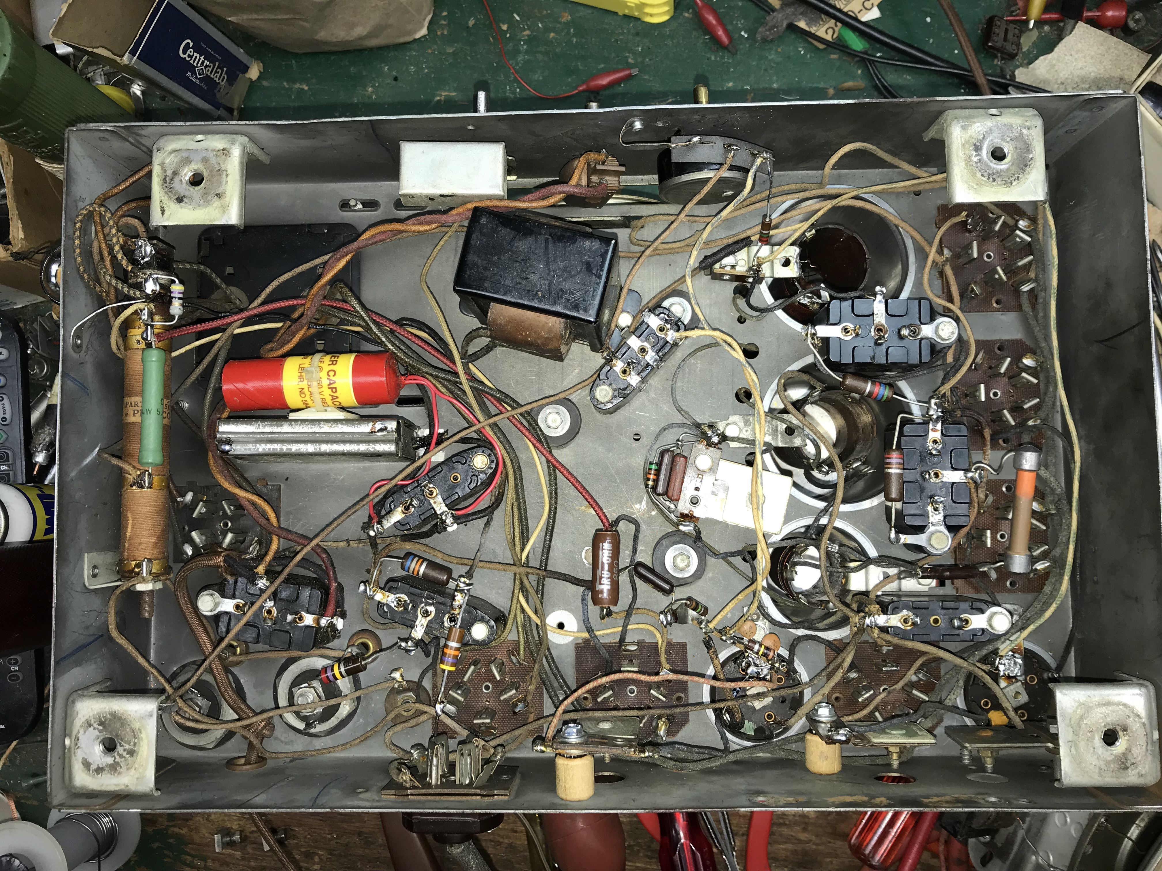

Here's a picture of my chassis. I have a couple more if you need them.

In looking over the photos posted by Rob and Ed, one thing I see is that the AVC filter caps are placed away from screen/plate bycass caps - at least in Rob's conversion. Ed, I can't really tell where you placed your AVC filter caps (.047 uF)?
I don't know when I will return to this project. No time to work on radios weeknights, was gone all day yesterday, lots of other things to do today. We shall see. I might find a little time to mess with it today, and I might not.
And Steve - thank you. Pulling tubes sounds like an excellent starting point for troubleshooting, although I am still thinking that I am going to have to move my .047 uF AVC filter caps closer to their respective coils and away from bypass caps.

On the top of the photo, there is a 2.2meg resistor connected to the hot side of the volume control to a 1 leg terminal strip. If you look closely, there is a thin black wire that connects from the terminal strip to one section of a dual bakelite block cap. The other section of the cap. has a 5.6K 1W connected to it. That's where the .047 cap. is.
I hope that helps.
