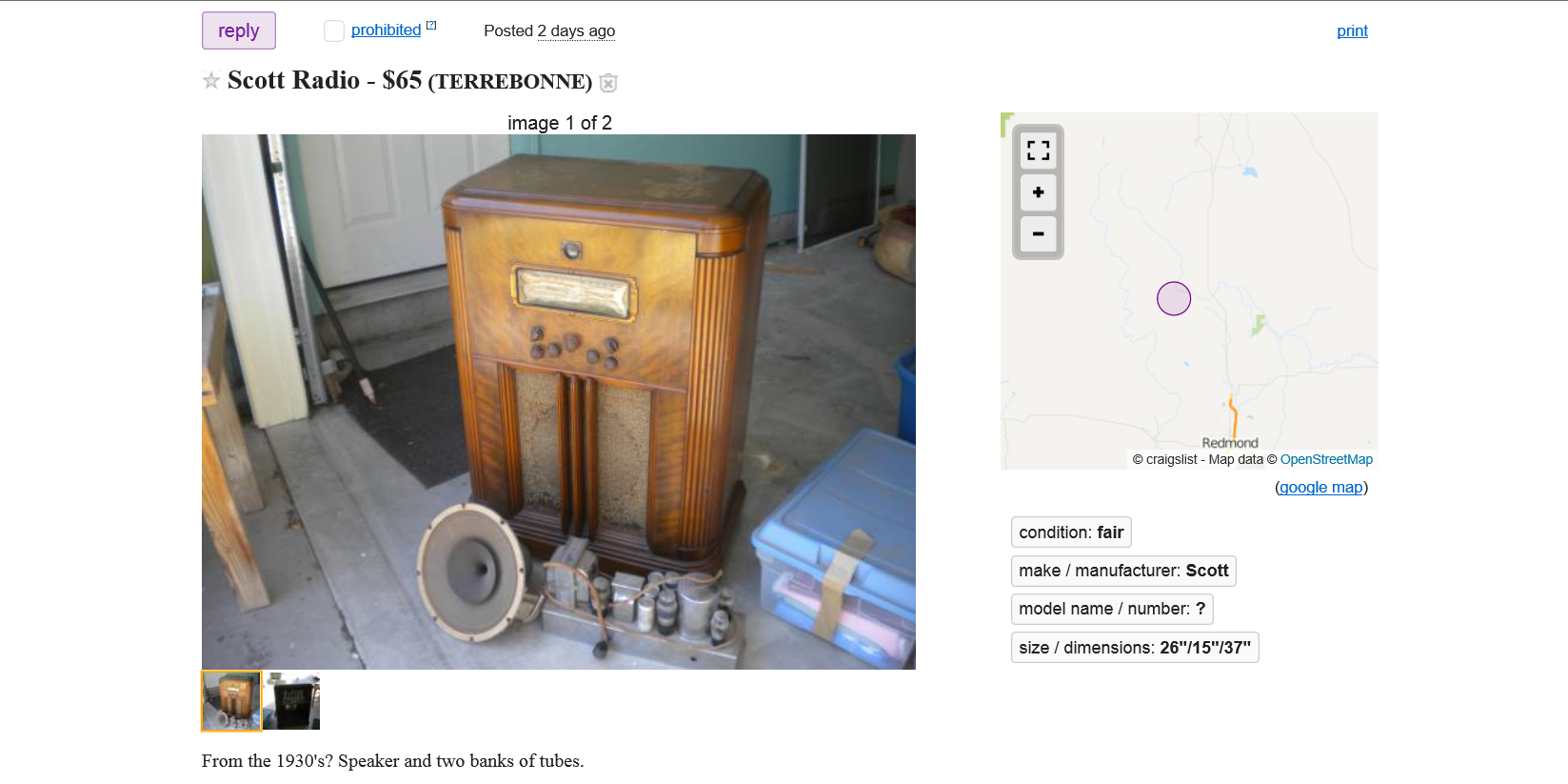

Russ, did you just get it?  Post a picture.
#47
It is just a Phantom - 19 tubes no FM, but it has a nice cabinet. I will do some clean up today and evaluate the chrome. It does have all of the original knobs and a speaker. There is one shield with a cap missing but I have one.

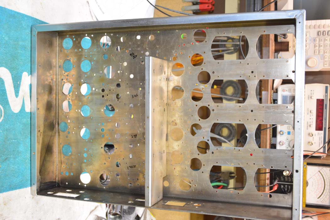

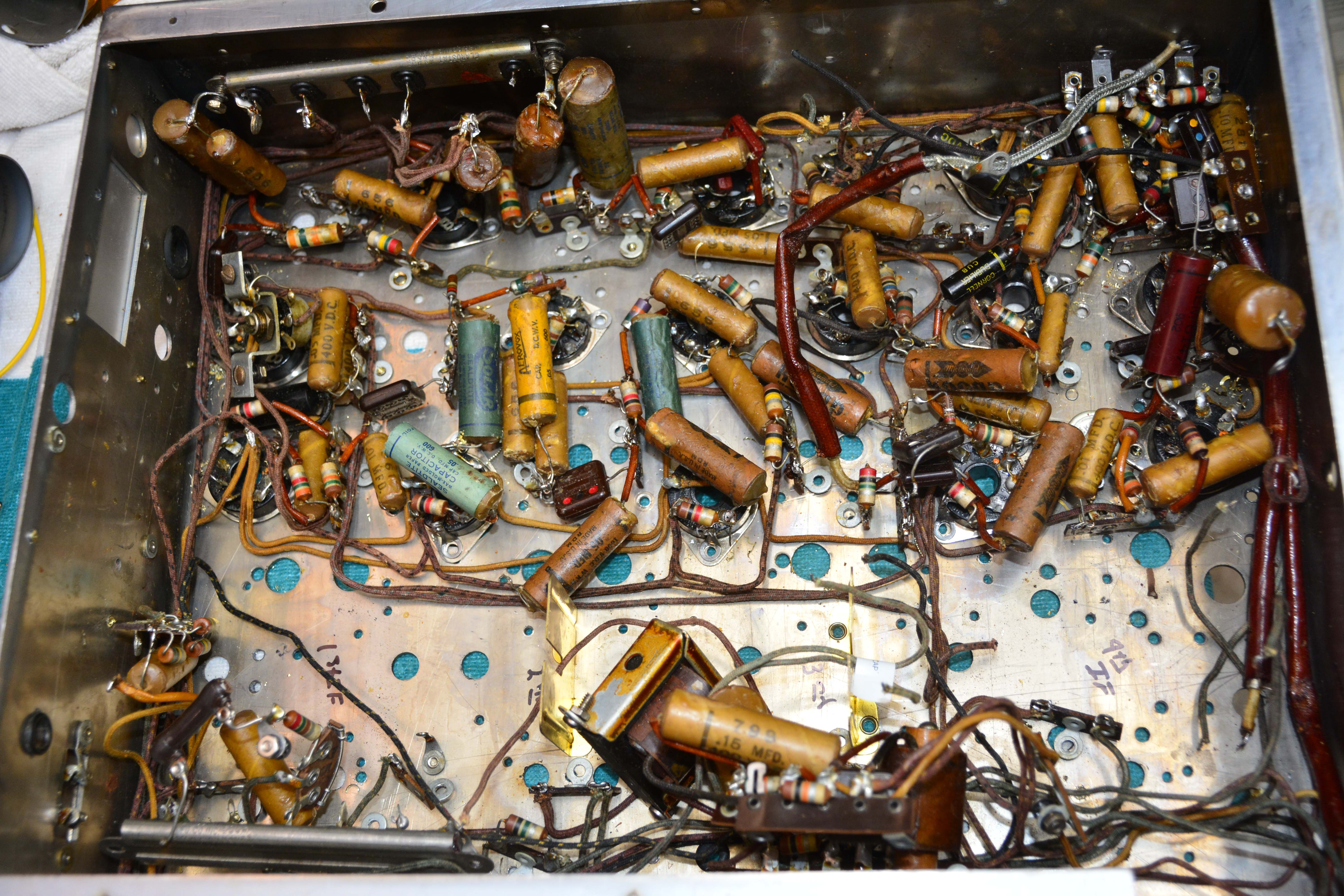

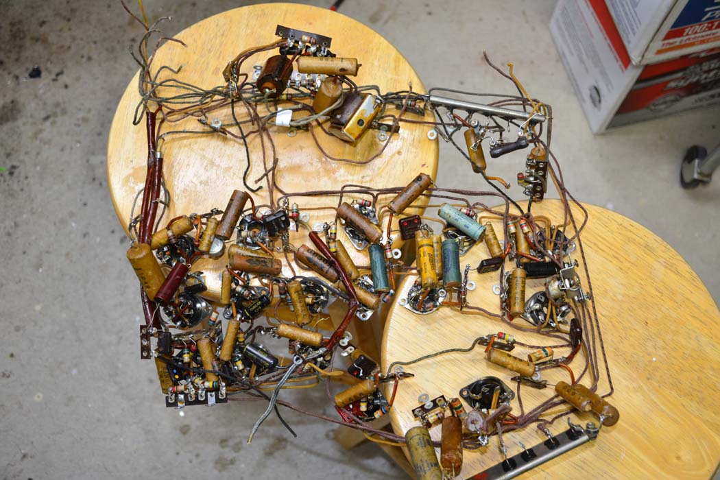

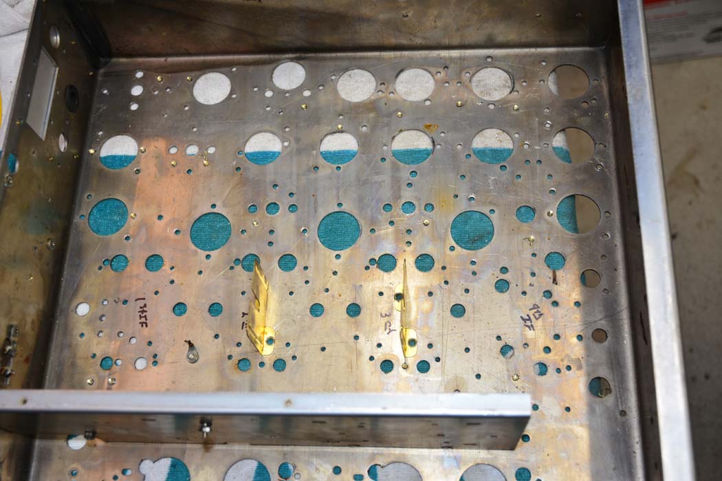

The chassis is ready for the plating shop.  I'll wait until the amplifier/PS comes back to be sure I like their work.  The first photo is of the assembly with all rivets and screws removed.  Then the entire assembly lifted out of the chassis.  The challenge will be to get it all re-installed without wiring errors.
