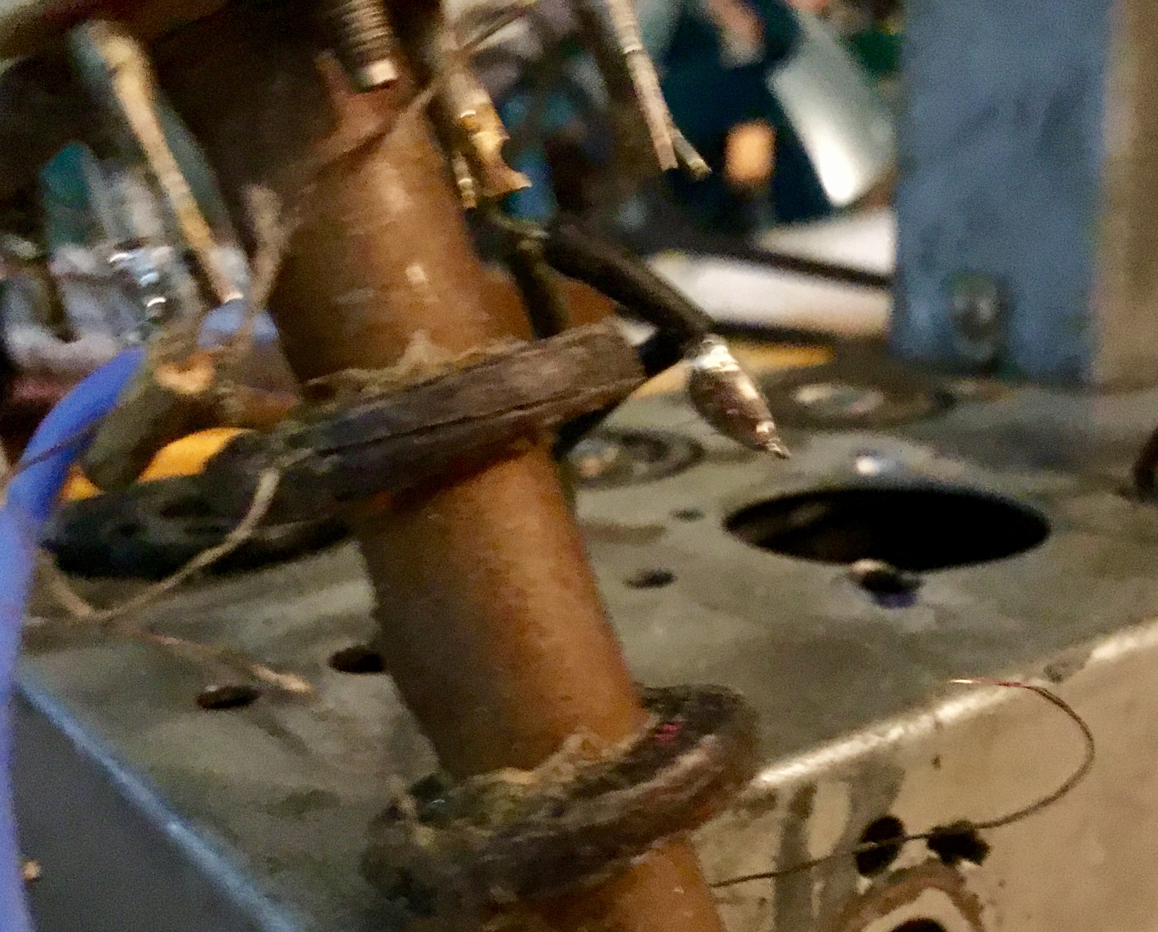

One of the coil leads to my IF transformer came disconnected, what’s the best way to fix it? I was gonna take a piece of leftover wire I had from my rewire, wrap the lead end around that and solder that to the terminal (after I figure out where it goes too)
Adam

I’ve figured out where the magnet wire lead goes too. Now all I need to do figure out the best way to attach it
