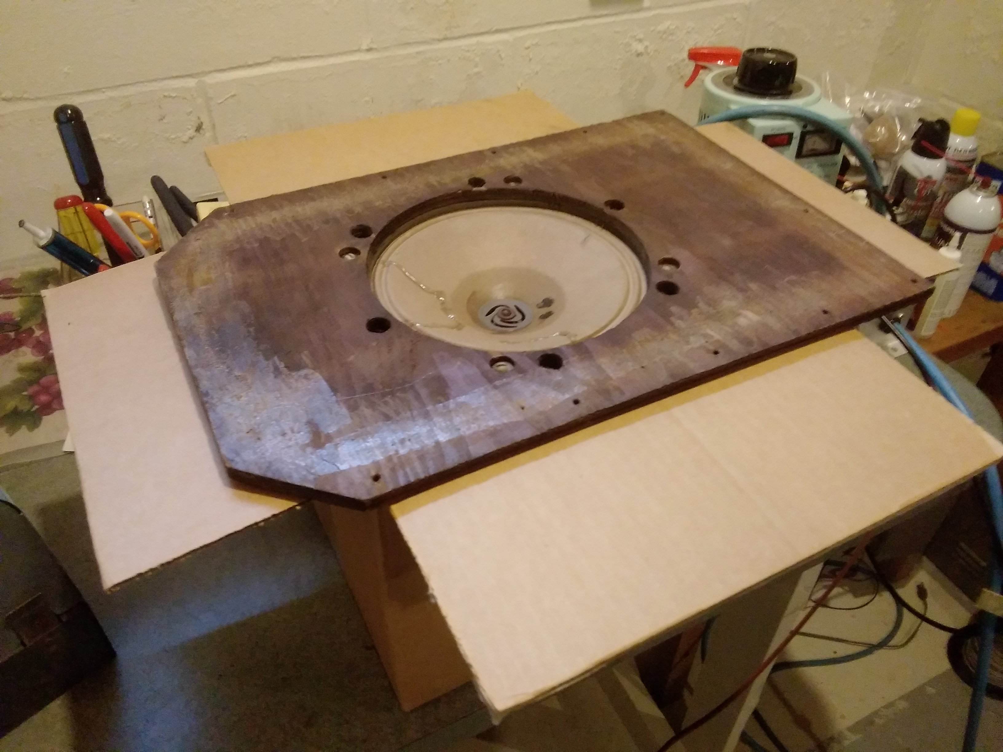

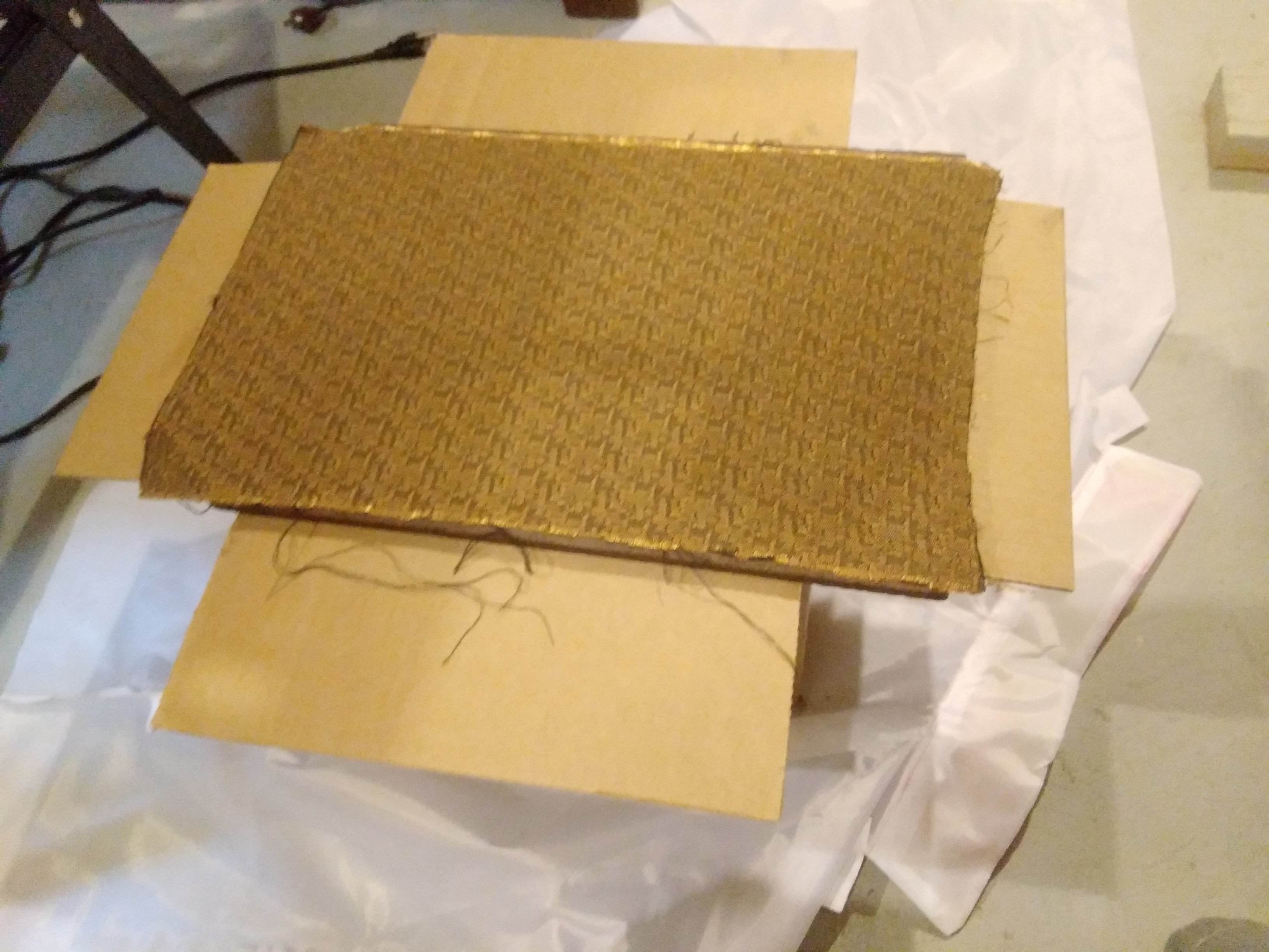

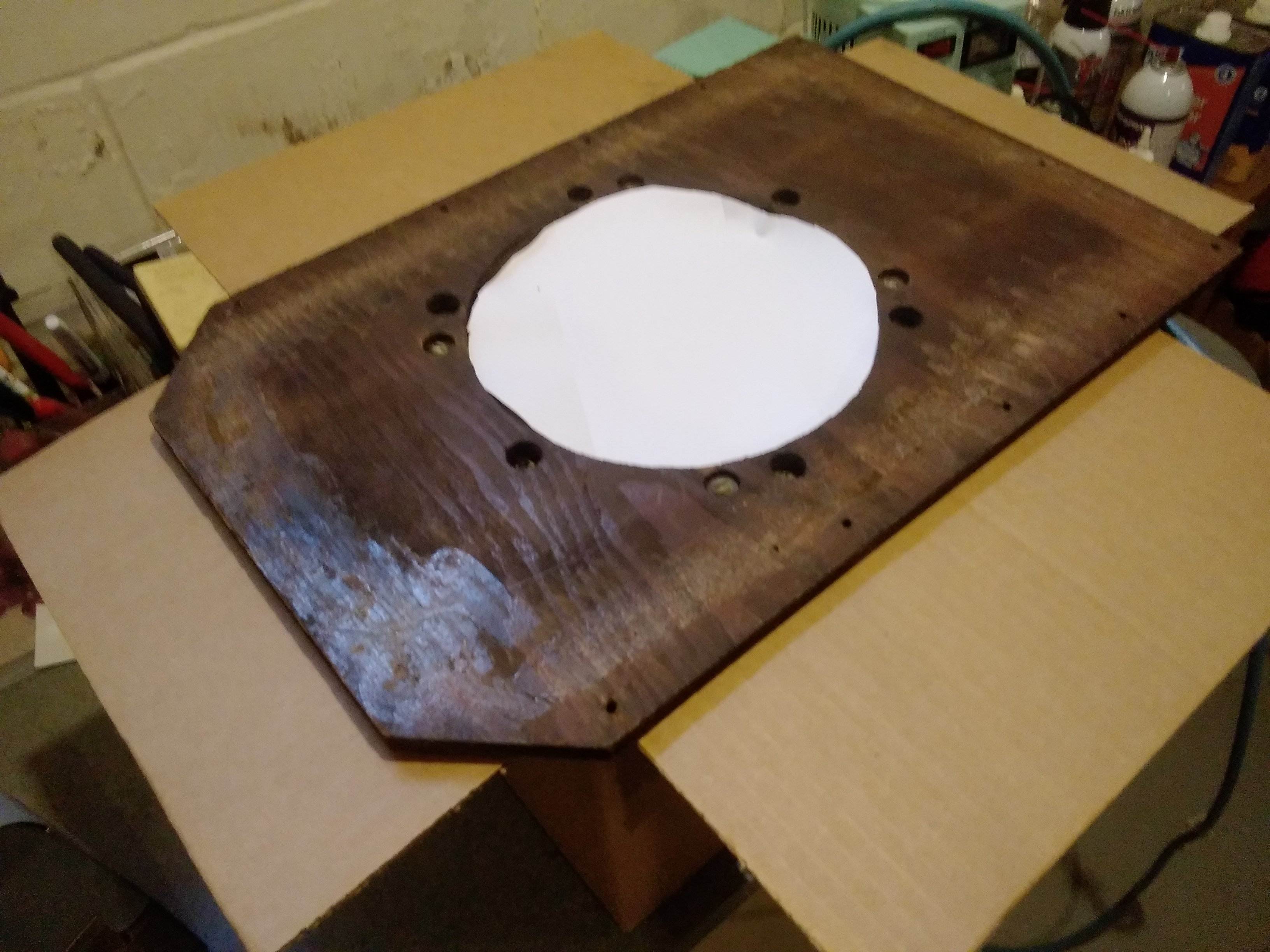

First, I cut, starched and ironed the cloth.
As I said before, I have the second board so the unwieldy one with the speaker already mount wasn't necessary to use.
Then, as Mike suggested, I used a cardboard box as the holder. The box is sturdy enough to not collapse under even more considerable pressure than the one I had to apply (not much at all).
Then protected the cone.
Then glued the top, dried, and then the rest of it, having stretched while gluing.
Then installed in the cabinet.
And the chassis.

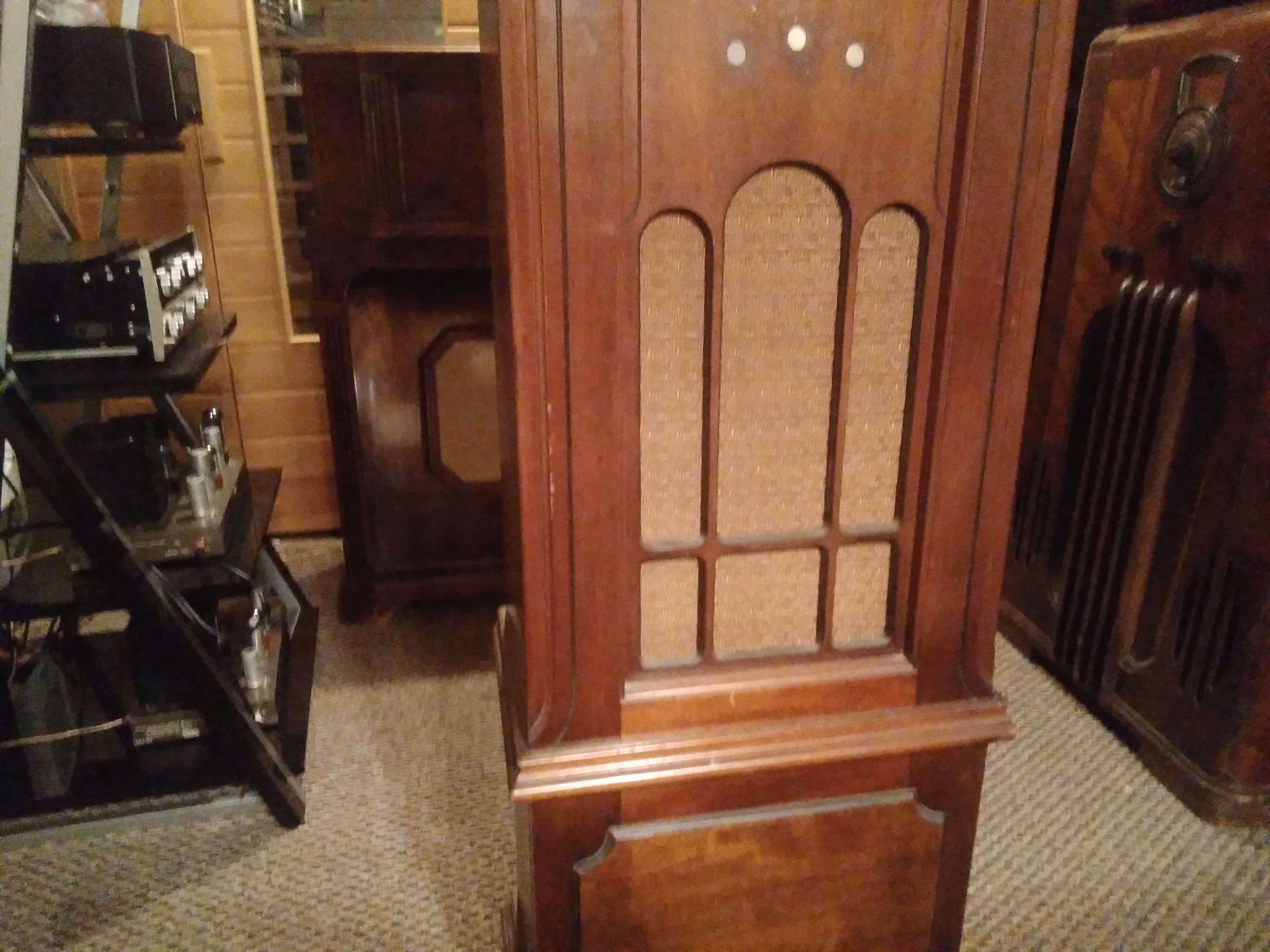

What I noticed, the dial pushes against theescutcheon.
I  moved the dial deeper down the tuning cap shaft. But it could be done only so much.
It still presses on it a bit.
Tuning cap cannot be moved, the dial....maybe another 0.04" if this much.
The chassis itself is as far back as the holes in the shelf allow it to be.
As for the sound....as expected. I cannot call it very good, it is a 70.
Maybe with a better speaker....
But I do not improve on factory designs.
Will have to do.

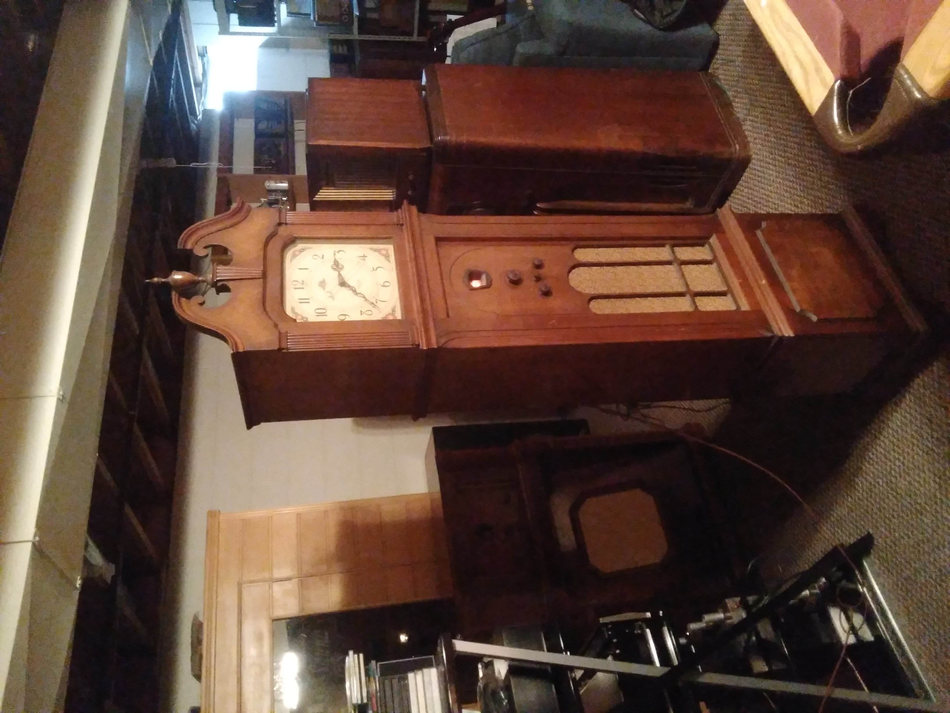

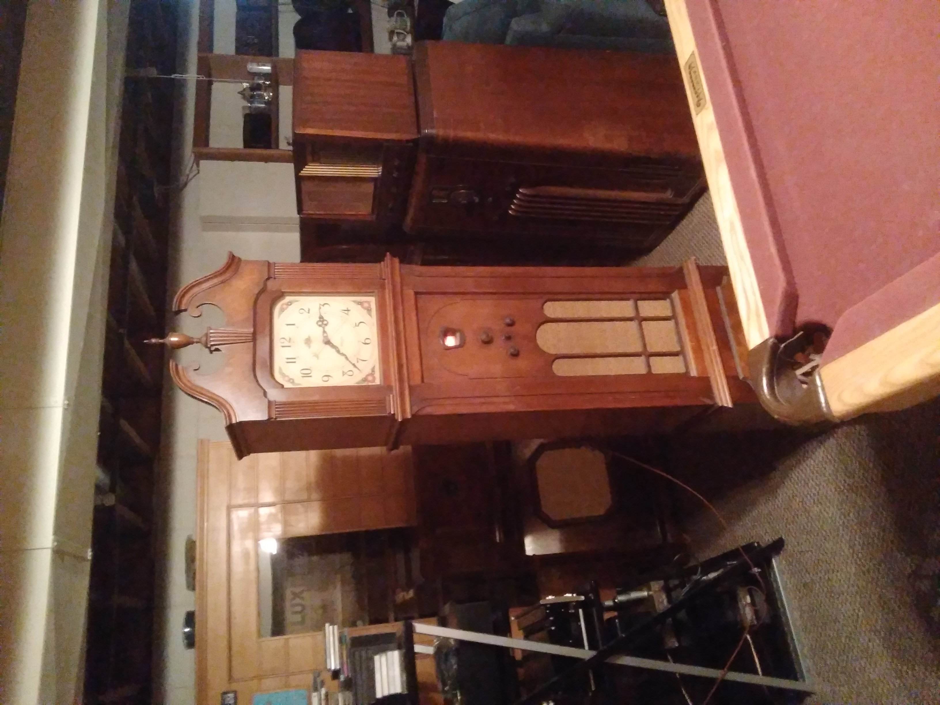

Now the clock.

Nice job Mike. That grill cloth looks good.

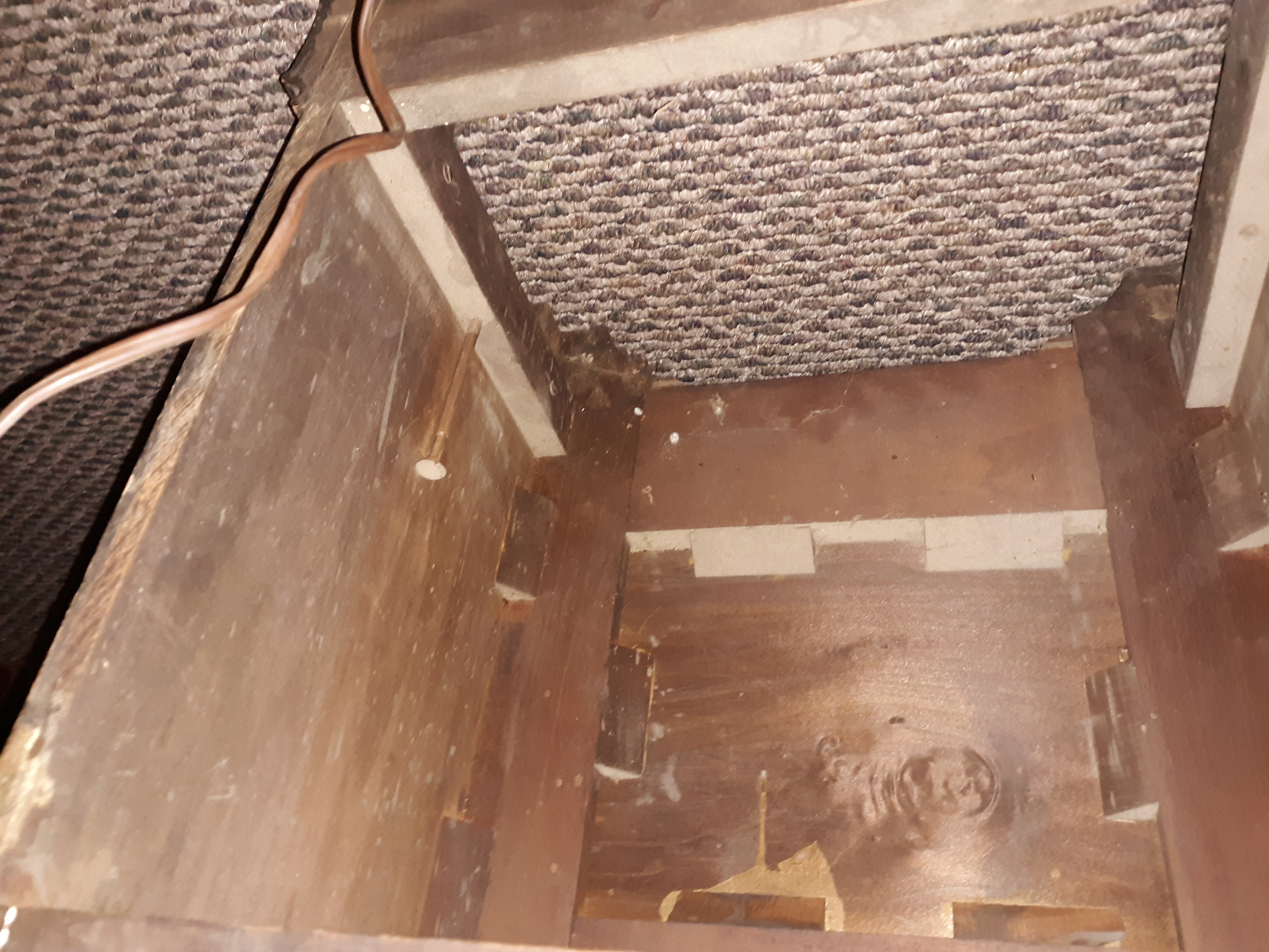

It is my suspicion there was something at the bottom of the cabinet.
There is a long bolt there. I  wonder what it held.
A weight, possibly? The center of gravity of this clock is high and it might be dangerous.
I wonder if they had some sort of lead plate there.
#53
Mine has nothing. I've always assumed that that bolt, which I've seen on other Philco's was for shipping.
#54
With the chassis inside it is not entirely unstable but given enough tip it could fall.
#55
I'm not saying one would never tip over (with a little help perhaps), but mine sat in the living room area of our previous house for 18+ years with all ages of kids crawling, walking, and running by it with nary a mishap except an almost poke through the grille cloth by some little fingers.
I suppose Ralph Nader would deem it Unsafe at any Angle or Unsafe on any Surface Icon_e_wink
Looks good Mike, send the clock to Kirk, he's a clock expert and bored being quarantined
