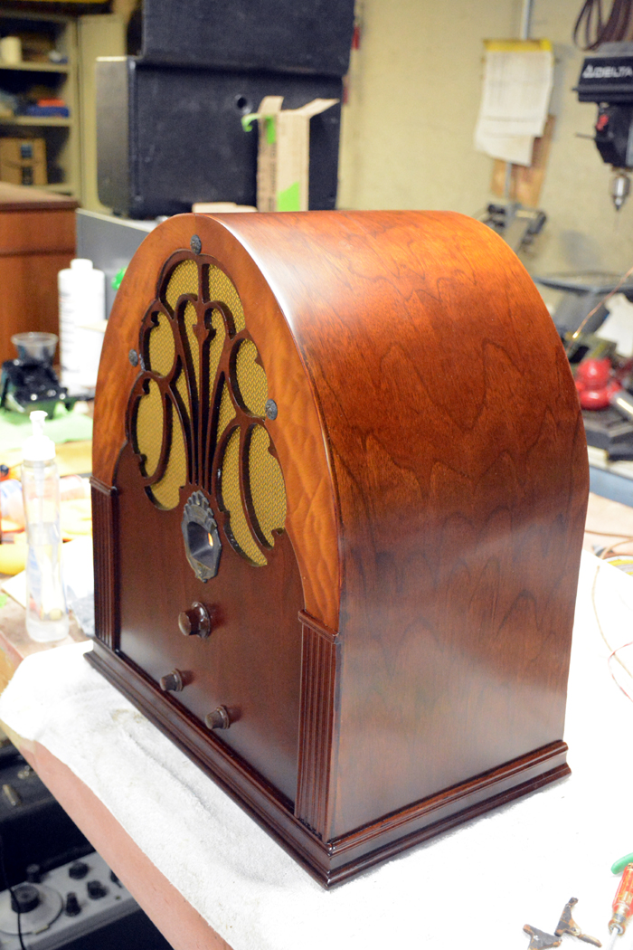

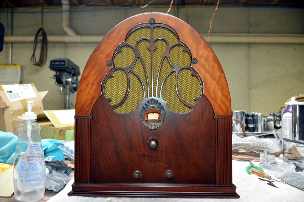

Okay. Done, I think. Stripped the cabinet again and refinished again. this time I hope it won't develop the cracks in the lacquer.
The radio has a great lack of sensitivity on the low end of the dial compared to the high end. I suspect it may be because of the re-winding of 2 of the RF coils. Not sure I will investigate as I really don't like the sound of the radio even with a good signal. At least I can demonstrate that it works and looks reasonable.
Rob
It looks just great!

Thank you! So far, the finish has not cracked on the re-do. I suspect that on the first time around, I didn't leave enough time between coats of lacquer. Also, I used instrument lacquer instead of regular lacquer until the final 2 coats of semi gloss. It is supposed to be more flexible. I also tried to get it closer to the original finish. Notice the slight shading near the "columns". This is what the original finish had (look at the photos of the original radio condition - post 1.) Accomplished by not masking off the front while toning the columns. Toner overspray darkens the front panel ever so slightly near the columns and the front panel along the bottom molding. Also notice on the original photo how the light colored arch is slightly toned on the inside edge near the grille filigree and the outside edge. Again, I tried to accomplish the same thing with very fine application of toner. I mixed my own toner and used the HVLP turned WAY down with no fan pattern to carefully tone those areas. I keep learning!!! Someday, maybe I'll catch up to Russ and Fred.

RF, I have repaired and made violins for years. Modern instrument lacquers that come in spray cans are not suitable for violin work as they DO become too hard and brittle. No good violin has a lacquer finish, just the cheap ones. Good violins are finished with oil based varnish. I make my own from linseed oil, pure gum spirits of turpentine, pure grain alcohol, and amber, using a modification of an old recipe I found in an old violin making book that was given to me by an elderly friend, now deceased. This is why I have chosen to use tung oil varnish when restoring radios. It must be rubbed on in very thin coats by hand, coat after coat, but it remains flexible after it dries, and is very water resistant and durable. Tung oil is also an excellent varnish to use for instruments because of this. You can color these varnishes by mixing in a little artists' oil paint, using one of the CLEAR colors, not the opaque colors, so you need to read up on your artists' oil paints too. If you do color them, it will slow down the drying process. Tung oil dries fairly quickly, in a couple of days per coat. My own varnish can take a week or three depending on the weather. LOL !
