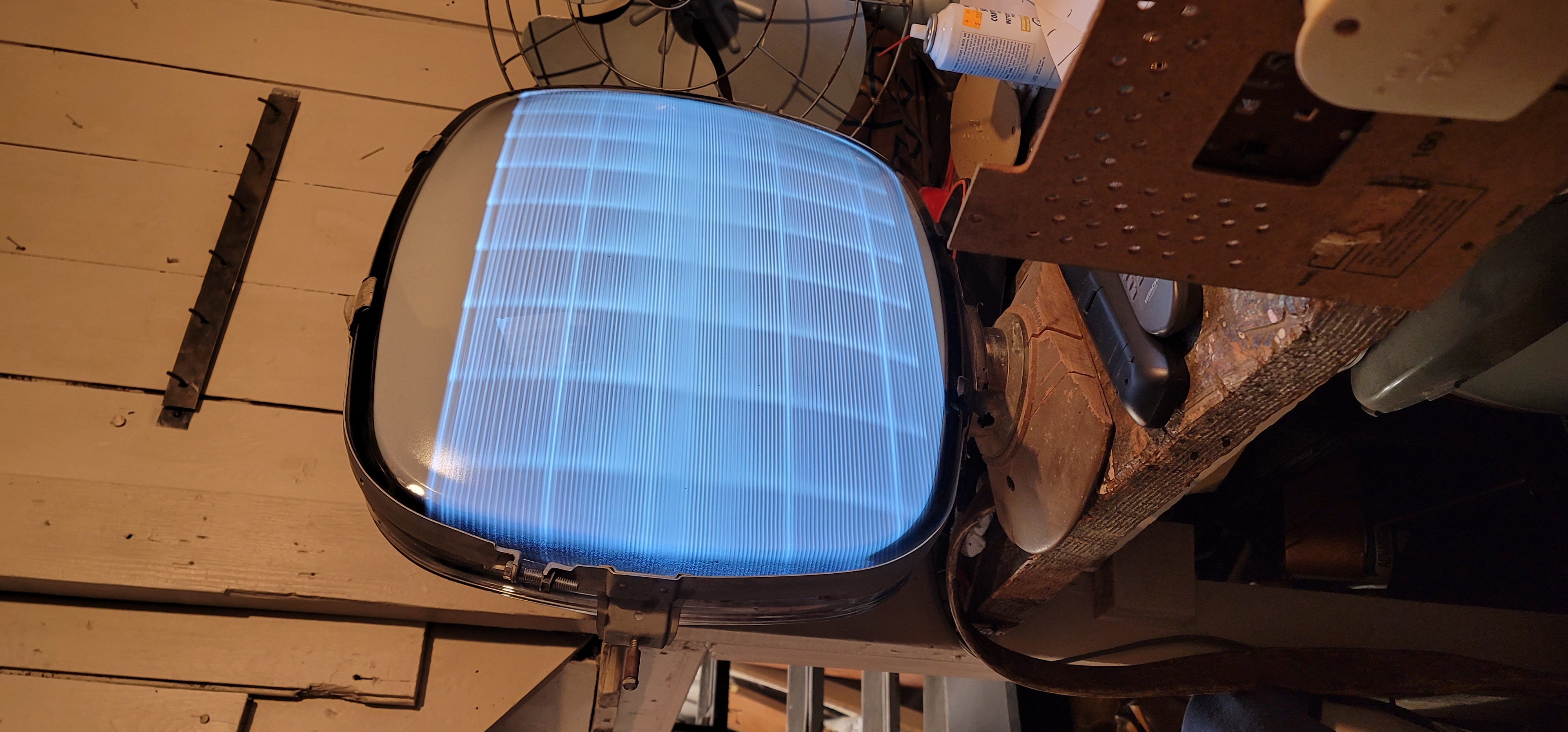

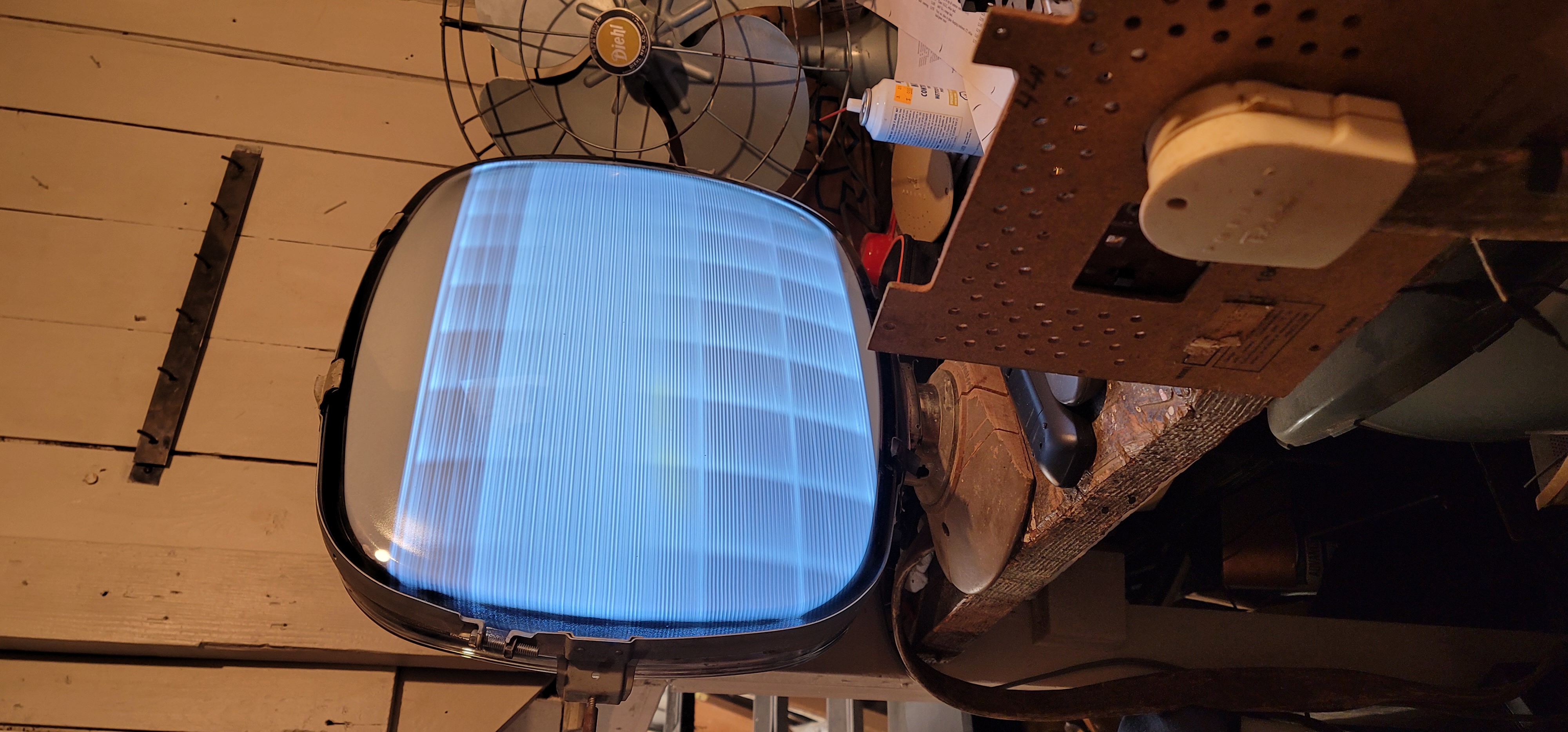

I finally had a chance to replace the Networks. I have to say Chris's networks are really nice. However I have 2 left over 30-6037-1, and 30-6028-2. The picture is a lot better but still not ok. It fills more of the tube, and I can see most of the vertical lines now. Also I don't understand it, but the white distorted patch moves from the top of the screen to the middle and then the bottom every 10 or 15 seconds, occasionally the screen will be filled with it, then it will go to a different spot. I'm still seeing twitchy lines on a diagonal going through the screen, they have been there since I disconnected the original diodes and replaced them.  Is it possible AC voltage is getting into the chasis and causing my distortion? The picture I have up is the grid pattern. Also should I try tacking on the 2 caps to try and bring voltage up?

apERNA1885  looking at your pictures. The white diagonal twitchy lines are the horizontal retrace which is normally blanked out but the brightness is up so high that they are showing. This is normal with the brightness all the way up.
Also it looks like the horizontal osc is locking as I can see the grid pattern. Will the picture tear when you adjust the horizontal control?  If it will tear then the oscillator is locking.
Your rolling distortion is likely horizontal Bars banding the screen that can be the line AC interference getting into the video signal coming thru the IF amp. Or maybe getting into the vertical deflection.
As I understand it BW sets vertical ran at 30hz That's one full screen every 1/30th of a second. Then when the color system came online it chanced to 29.97hz as to not interfere with the color signals. (N.T.S.C.  Never The Same Color twice) And the older BW sets could still lock on to the new 29.97hz vertical sync signal. So when all other things are working this difference is why there can be  moving bars of interference from the AC line. Two bars is 60hz and after the rectifier section 120hz can be four bars.
(Many years ago I was a TV broadcast engineer but didn't work on tv monitors much. I was mostly tasked with keeping the beta tape machines up and running.)
The really fine horizontal lines maybe ringing (high frequency oscillation) in the IF section or the vertical section.
And there is still distortion in the vertical deflection waveform. Hence the lack of full picture with fold over.
#49
After thinking about it for a while. The symptom of the grid pattern is being obscured by the rolling banding interference. I think the AC interference is getting into the video signal which is coming from the IF section. It's interesting to note the ringing (very fine horizontal lines) is riding on the AC noise.
You really need a oscilloscope to check the DC voltages for AC noise. And looking for distorted waveforms otherwise you are flying blind.

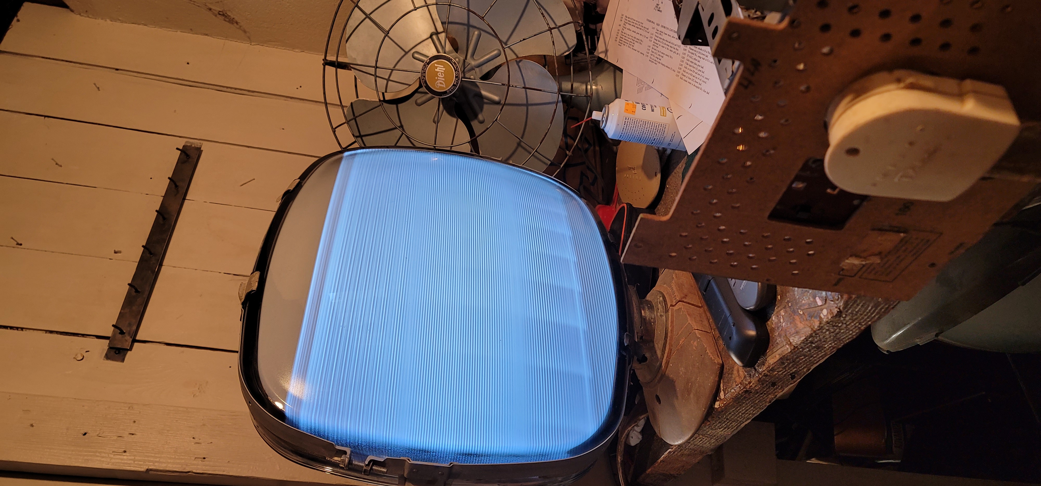

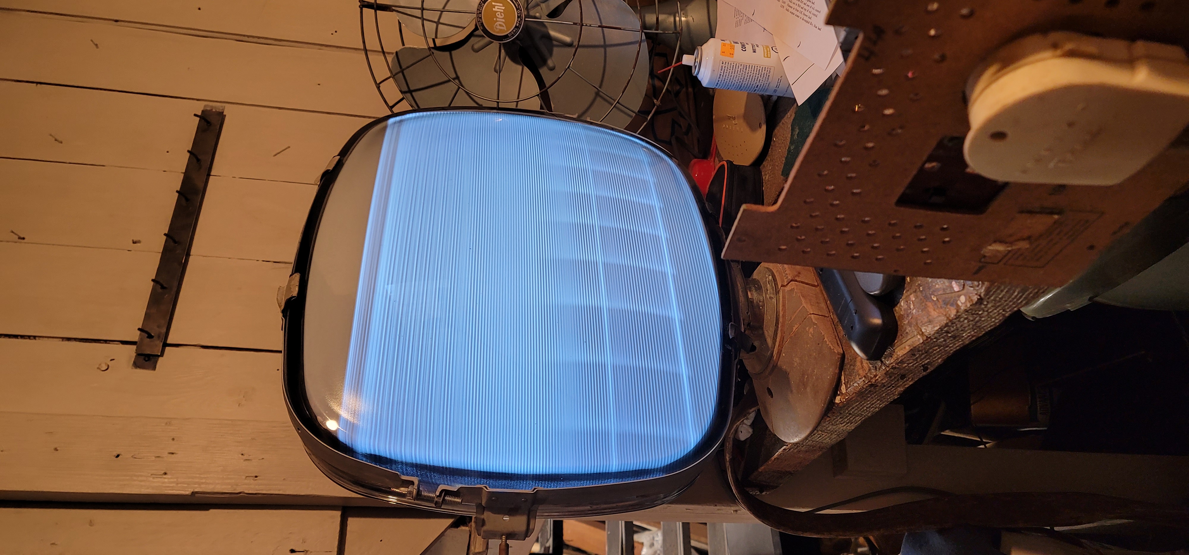

So I found out the K network for retrace lines was under the chassis and I replaced it, I also replaced the one on the picture tube. Then I tried again to adjust everything and I can't get a good picture. I took a video so you guys can see. One video is a DVD playing, the other is my signal generator showing a 9x9 grid.

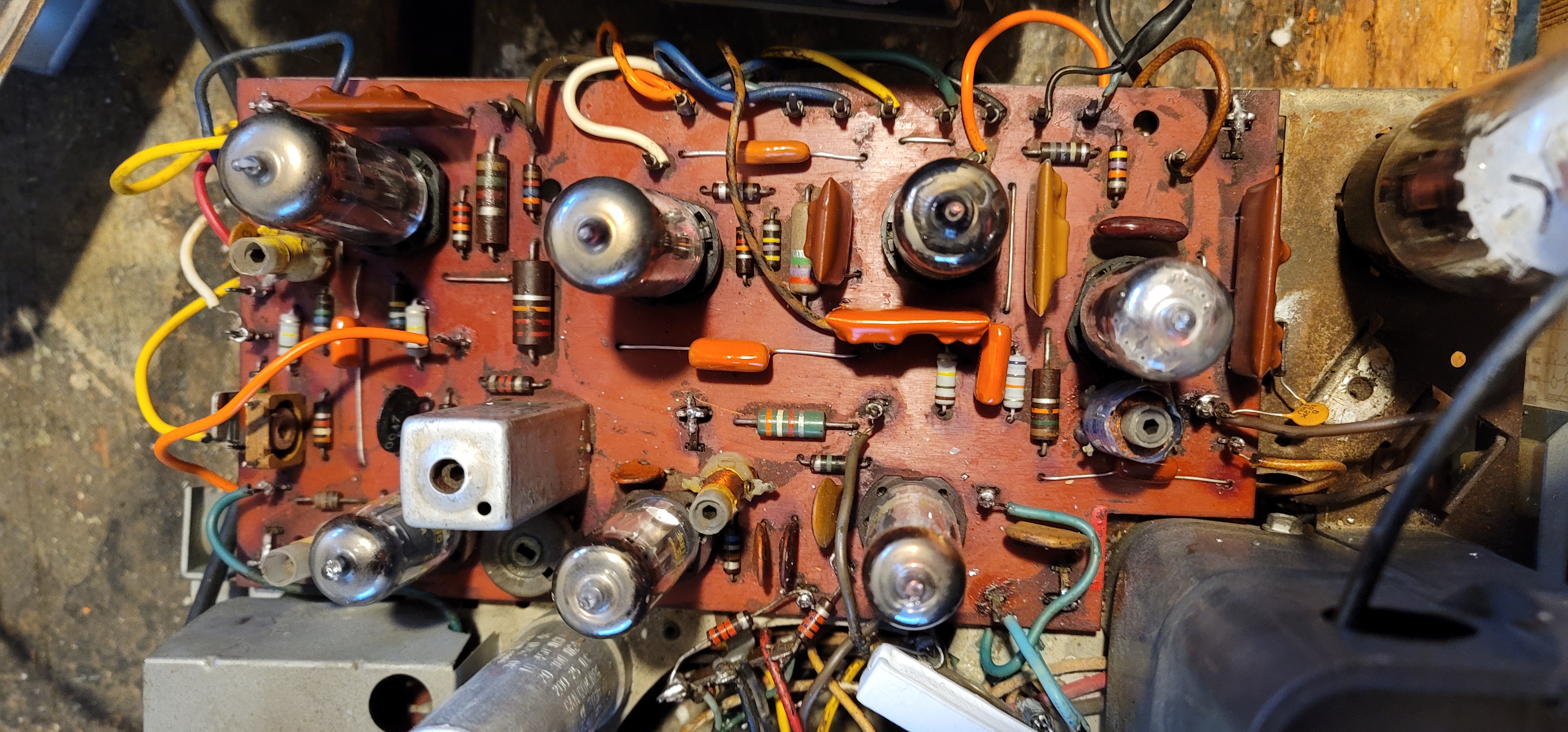

OZ4 I'm wondering if I have to rebuild the IF board next.

I'm seeing some technical misunderstanding going on.
1) NTSC standards are 59.97Hz for the vertical (interlaced traces makes ~30fps) and 15736Hz for the horizontal. This frequency was chosen because it was in sync with the 3.579545 color burst.
The author is using a super cheap basic matrix generator which syncs to both of these. It uses TTL dividers and square waves to reproduce the basic dot/crosshatch patters using different pulse widths. The color it generates by sending a burst pulse.
It's the generator he's using that you're seeing as out of sync/frequency vertical/horizontal. It's actually in sync, but there is some h-k leakage going on, mostly capacitive. My first suspicion could still hold true, and there is a problem with the long cable going between the chassis and CRT.

Agreed. Could also be an issue with the video amp inside the CRT housing. It is supposed to compensate for losses in the long cable.

From the schematic I see the video output tube is with the CRT. Without an oscilloscope don't know how one would troubleshoot. You can't see what the video signal looks like without one.  Did this tube get tested? I see at least three caps in the CRT housing?

From the video it almost looks like he has an extreme vertical foldover where the top of the picture is superimposed on the bottom.
Without a scope its really hard to tell, but instead of a vertical deflection sawtooth wave, he seems to have something like a distorted triangle wave vertical sweep. The deflection signal rises linearly but then instead of falling sharply it decreases as a slower rate which produces a folded over superimposed image.
There also seems to be some hum modulation of the vertical sweep where a 60 hz signal is beating with the 59.94 vertical frequency, causing the image to slowly vertically roll about the foldover point at the difference frequency.

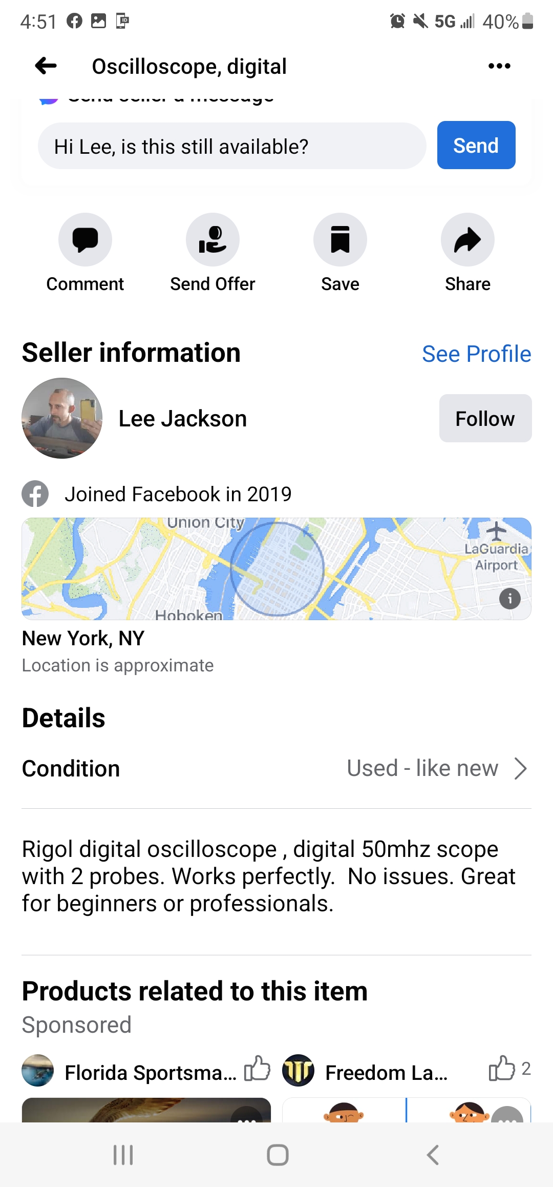

Ok, from what everyone is saying I really need an Oscilloscope to figure out what is going on. I found a few locally on Facebook, I don't know much about what I'm buying. My only Ocilloscope experience is with automotive sensors and with checking ignition systems, and the scopes we used for designed for that. I found a few scopes with missing leads, are leads specific to the scope or are they easy to find? Also what frequencies am I looking for? I found a nice looking Heathkit one for $50 but it has no leads. I've seen hi end looking ones for $200 and up. How sophisticated of a scope to I need?

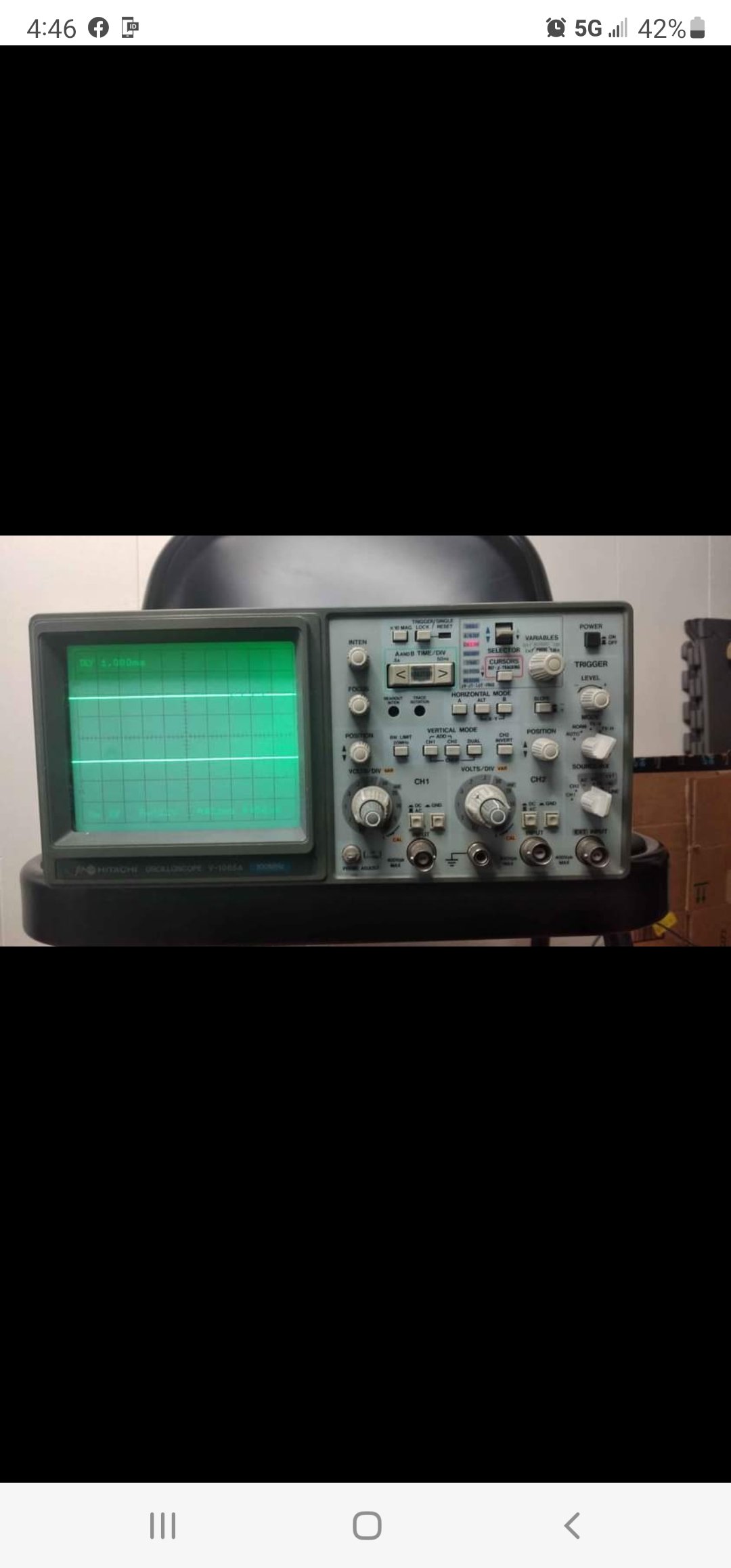

The first one is a Hitachi 1065a it says it works but has no probes he wants $100
Heath kit IO-14 says powers up but no probes $80
There's this one made by Rigol too that one is $75
Other than that there's a bunch of untested ones and ones over $200.
#60
If I had to choose between those, I'd definitely go with the Hitachi. 100MHz dual channel analog scope.
