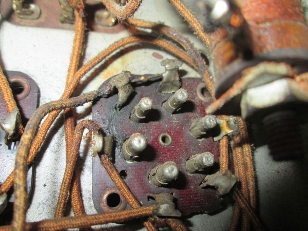

Hi Hamilton, The values for primary impedance I got from my docs are higher than those quoted by Dale and Ron, but go with them. [Correction, 07/11/23- By "them", I mean Ron R and Dale, not the specs that I posted from the RCA and Tung Sol documents. Sorry for any confusion.] My info was from the RCA Receiving Tube Manual, but possibly at a different voltage. Ron and Dale are Philco Experts and have the documents to prove it (Speaker P/Ns, Specs, etc.). However, anything mildly close will be better than the open one that you have.
The one thing that you may want to try to do is to peel back the paper. In your pic, there seems to be a burn mark. I expect that connection#3 is the open one and the burn is under #4, but it also seems that the wires cris-cross under the paper. You may get lucky. However, a new transformer is better than an 87 year old one.

While your under the hood take a look at the 42 sockets. What you are looking for are burnt marks or carbon traces between pins 1 and 2. Pin 1 is at ground potential and 2 is at +300vdc and the ac signal. This can cause these high voltages to arc and damage the socket or the output transformer in extreme cases. When it arcs it will develop a carbon trace which acts like a low value resistor or short. That causes the hv to be shorted the ground through opt. The other side of the heater pin 6 is 6v above ground and pin 5 is at -20 something. Not to much of a chance of a problem.
I have this problem with one of my sets I think it was the 660L. Out of a dozen that I've serviced I've seen it once so it's not a common issue. But opt on the H-13 are. That's been about a 50/50.
