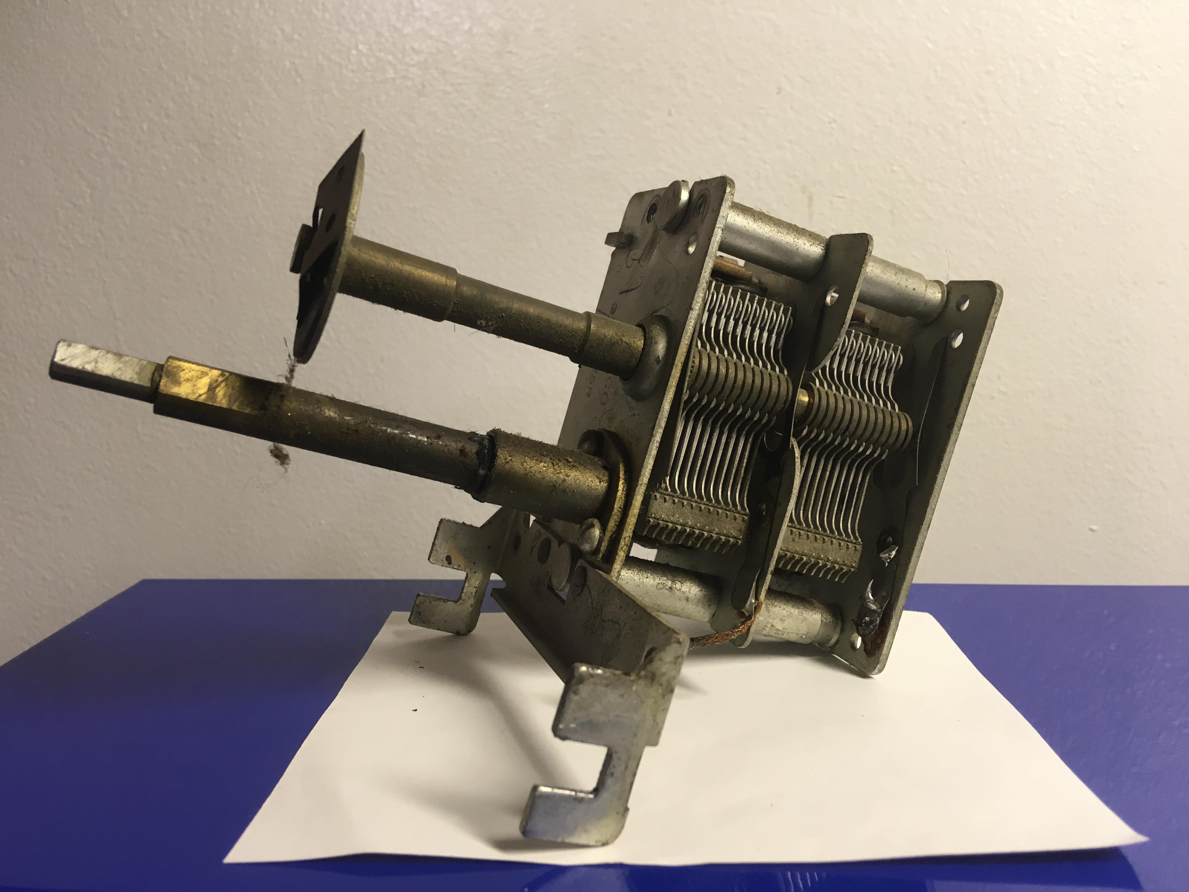

hello everyone,
I know it has been a while since I have posted about this radio but finally got chance work on it .
I pulled the tuning capacitor So I could finish taking it apart and put in my Ultrasonic Cleaner the one thing I was wondering I  have to do  remove the mica sheets on the trimers .
P.S.
This tuner is filthy and tons of old grease
#48
Yes, you should carefully remove the mica sheets from the trimmers otherwise you risk trapping foreign material in the trimmer. You'll also have to clean the mica sheets before putting them back. Maybe leave them separately in the ultrasonic cleaner. Make sure they're dry before reinstalling.

Rob I will remove them and I thought i might use my Capacitor checker and see what value it reads before taking them apart.
Steve for sure and you still can get mica and I bet if you went snooping around MCMaster-Carr you could find something to replace it with .

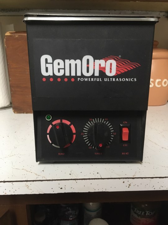

P.S. I sure like my ultrasonic cleaner it's very handy I even clean my electric razer's rotory cutters in it too.
#54
Rich do you dunk the whole razor in there with it turned on to get a good mix? Icon_lol

I don't think it is as critical as some would think. I've washed chassis, typically on hot days during the summer time, tuning condensers, padders, trimmers, everything, and did not remove any mica sheets, but I do loosen the screws first. Granted I am not immersing them or the chassis, nor am I subjecting them to any risk of mechanical damage, but I also rinse the chassis thoroughly, and let the whole thing dry for at least a week before powering up the set.
With regard to mica sheets, it is a good electrical insulator, but also will conduct heat since it's a mineral. They used to use it for windows in coal fired pot belly stoves at one time. In some areas of the world they used ceramic washers rather then mica, or as Phillips did, they made these funny cylindrical trimmers put of aluminum, where one would section screw down into the other. They also had a sort of trimmer that worked like a gimmick, except it was on a ceramic tube, and you would adjust the capacity by wrapping more or less wire around the outside.

Hello Dconant,
Very funny but here is Photo of my Gemoro ultrasonic cleaner !
Arran , I have not had any issues either and far as washing the chassis I have never done that on Antique radio but more modern electronics like VCRs and computers .
thanks for your info .
#57
Hello Guys,
Don't mind my 1950s kitchen countertop and funny thing about that countertop it has little what looks like gold flakes in it .
this Gemoro has served me well for many years it is a 1 quart I am thinking of getting a bigger unit .
