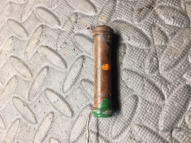

What should I do with this 15K ohm resistor? It is now 16.6K and I am thinking about replacing it. What wattage should I use? I am pretty sure it gets hot.
#47
It is 20% tolerance, your measurement says its in spec...
If it got too hot, the body would char the coding paint...

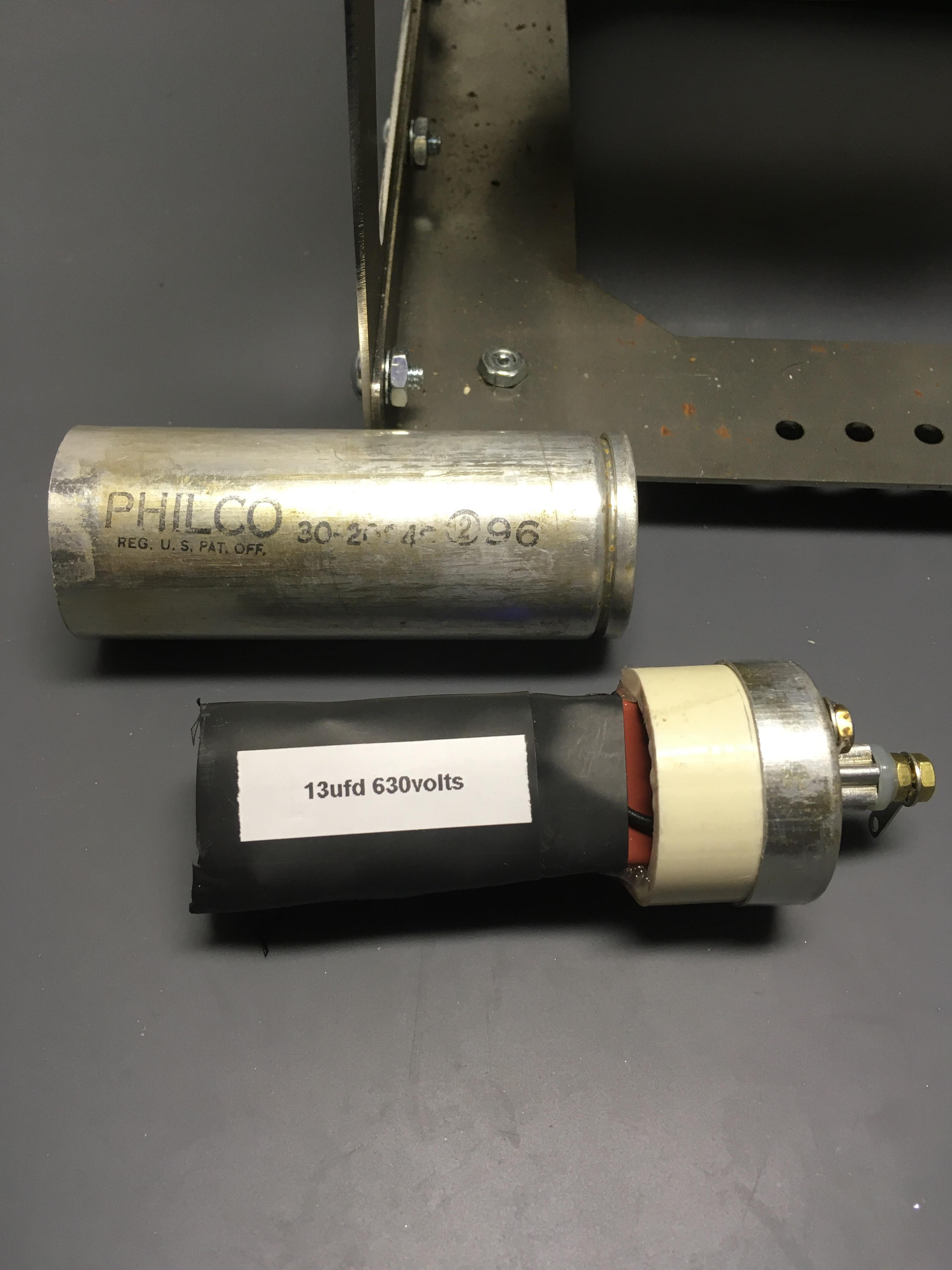

Hello KI5OMM,

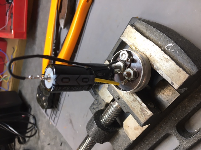

Well nice job on that Electrolytic capacitor here is a photo of the one I just did Sunday .
#50
Nice job on that capacitor Richard! Good clean construction. Today I will re-stuff the double 8Mfd can and get it back into the chassis.

#51

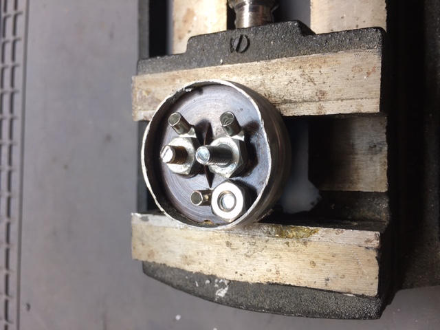

I just finished the double 8mfd can. The original solder lugs on the end of the can were riveted with aluminum rivets. I had to drill those out using a drill press. It was a bit fussy, but doable. I then added screws and solder lugs and finally soldered in the new caps.
Everything checked out good, so back into the chassis it goes....
#52
Your wires (nuts) are too close to another nut that is close to the shell. I think it is well under the required spacing.
#53
You get extra points for being observant! Actually the nuts were still loose when that photo was taken. The nut that is closest to the shell is the grounding lug. Everything is now properly placed.
Also on another note: I wired the two caps wrong and had to change them up a bit after noticing my mistake on the schematic.

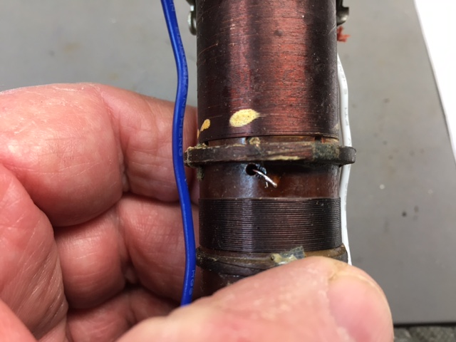

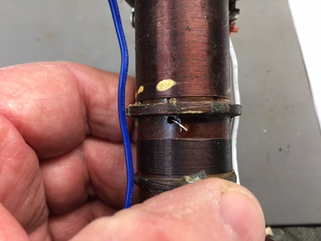

I powered it up for the first time today and it actually works pretty good! I have been fretting over the antenna transformer coil trying to get it hooked up properly. I also found a broken lead on the coil. Fixed that. I replaced all of the caps, many resistors, and some bad wiring. I removed all of the previous crappy repairs and strange modifications to the wiring, and brought everything back to the original schematic as designed.

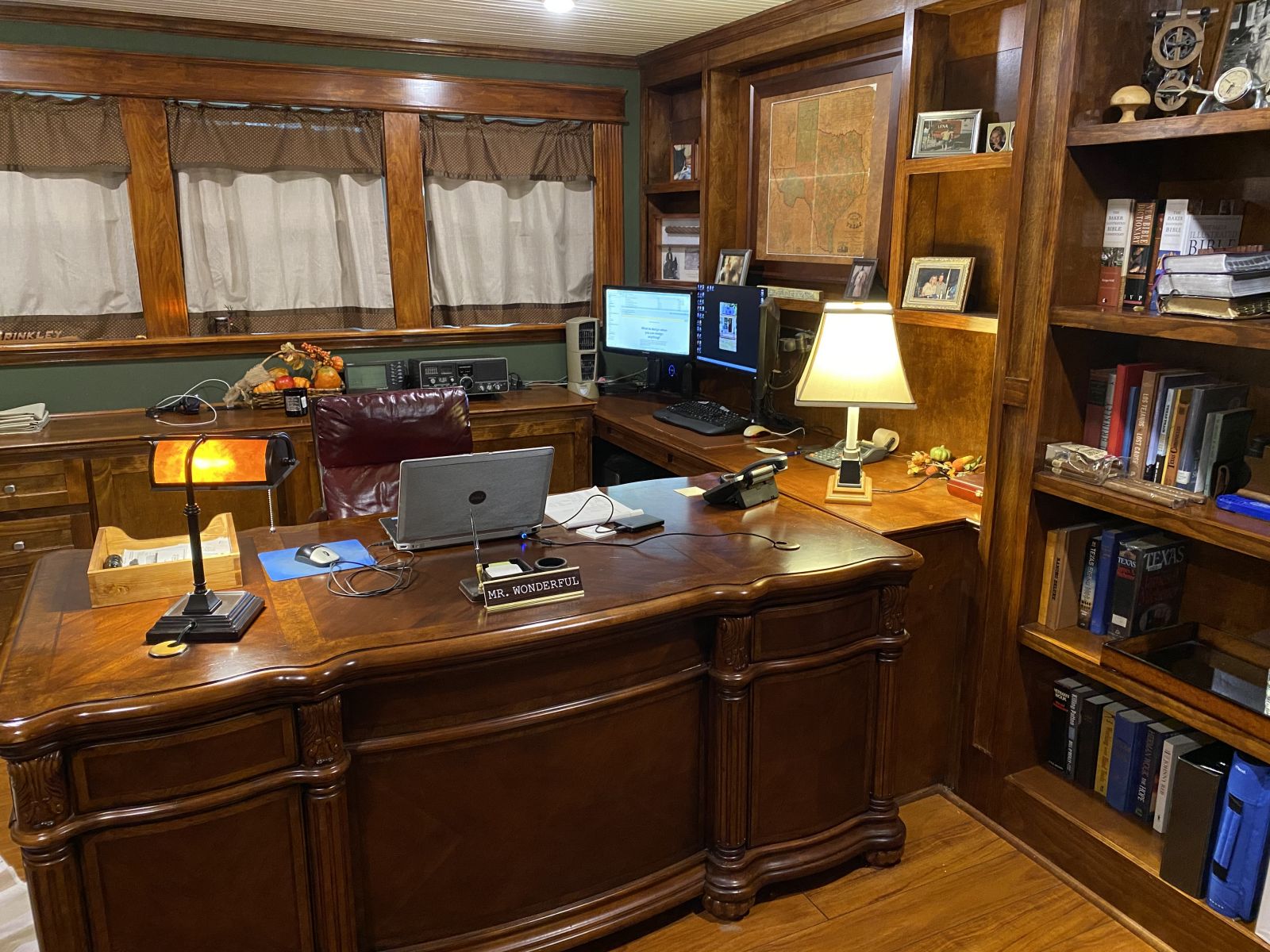

Now it's onward to the cabinet refinish. Now finally I am in my element....I have been a master woodworker for many years. I build high end furniture as one of my hobbies and in fact I have built most of the furniture in my house. I have a small but well-equipped shop and I treasure my hand tools like fine jewelry. Ok - enough of that crap. LOL
Here is a quick photo of my library and desk that I built some years ago. Most of the panels are hand hammered veneer of various woods. I like using traditional hot hide glue for furniture construction and most especially for veneer work.

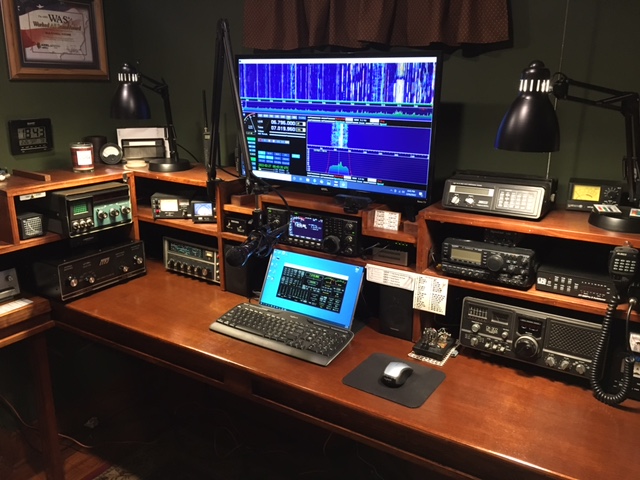

Here is a photo of my ham shack
