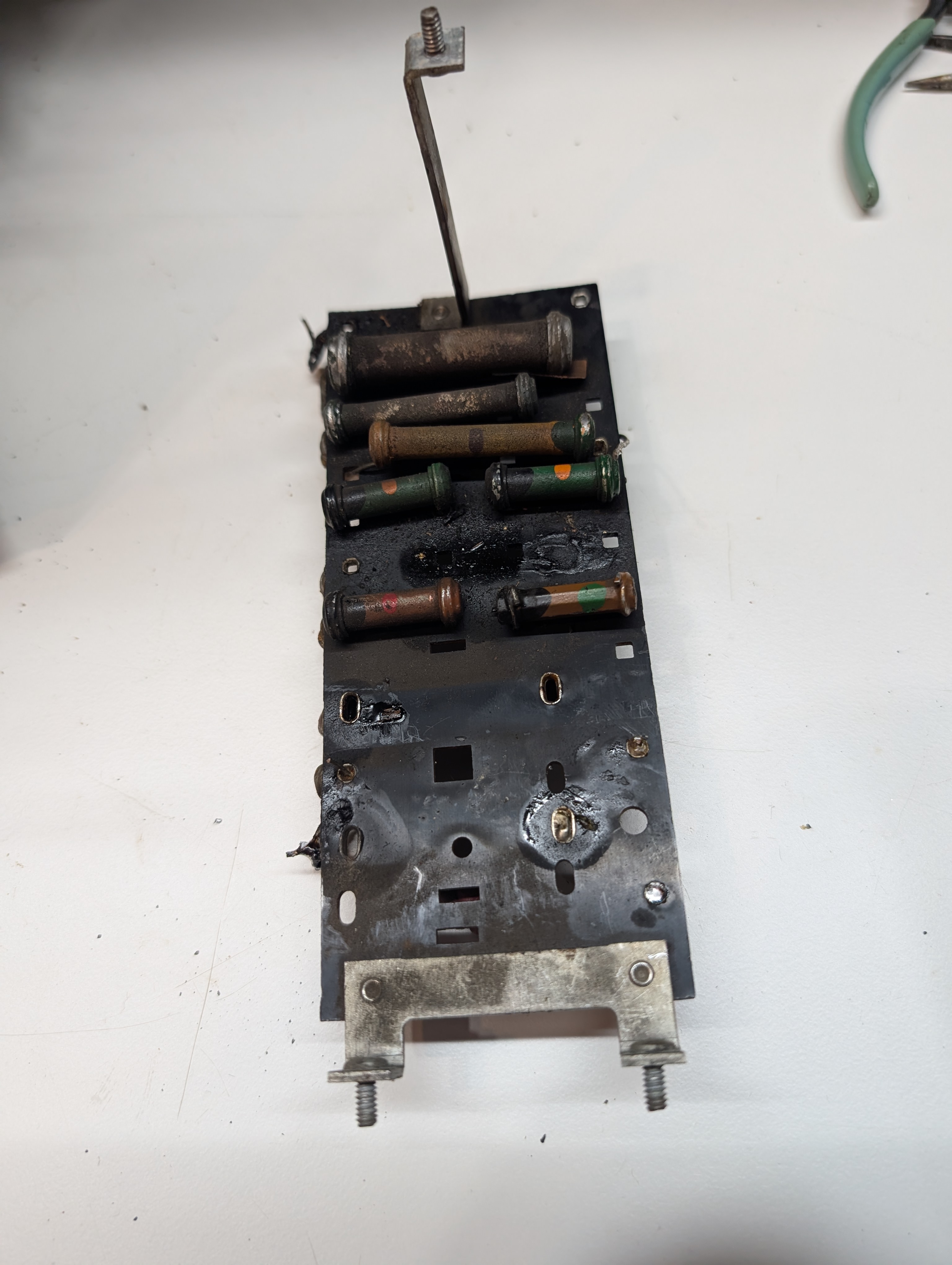

I don't think I will be restuffing this Black Beauty.
It is not authentic to the radio. BB is late 1940-s and this radio is early 1930-s.

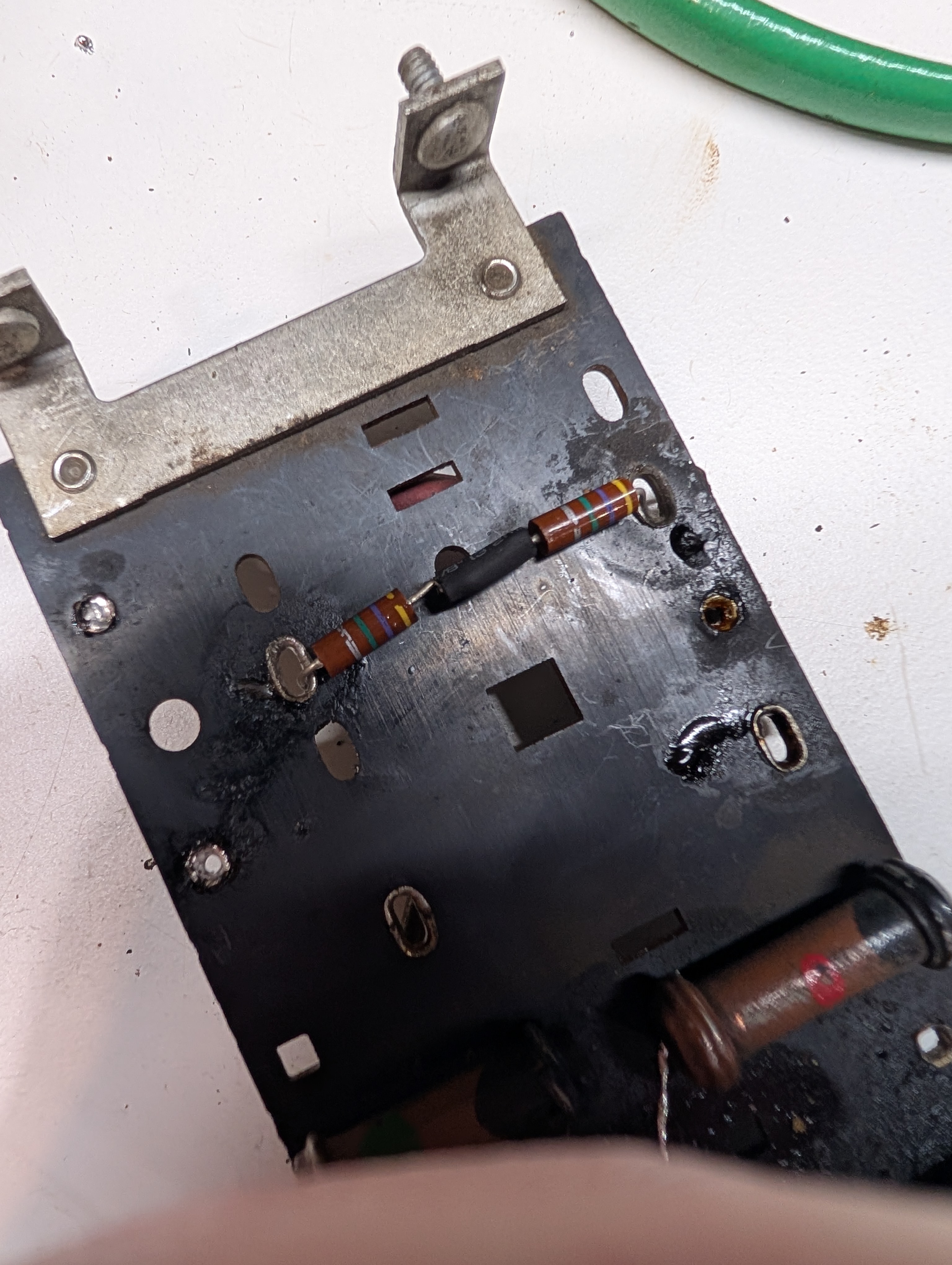

It was a repair.

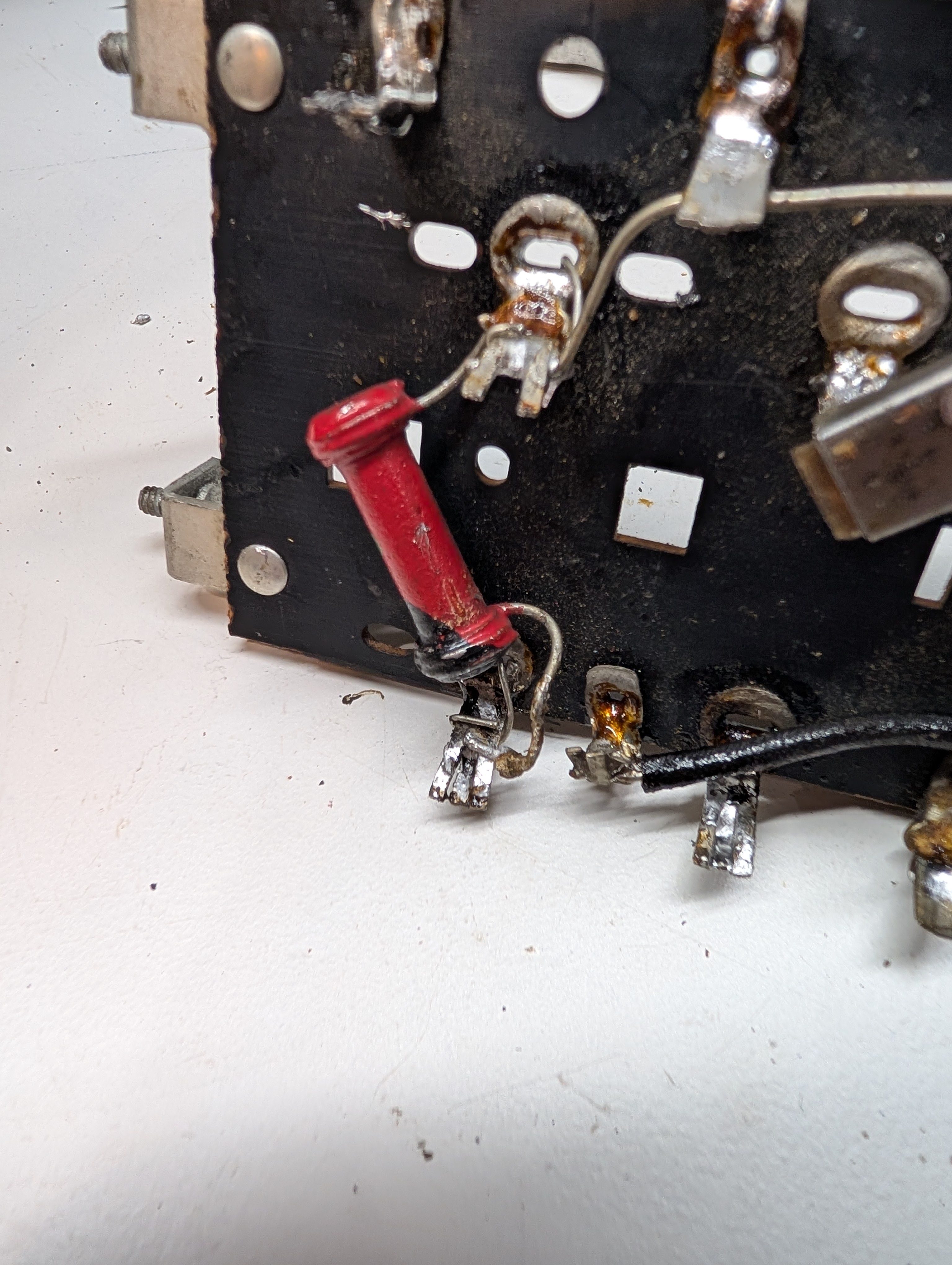

I took the resistor board out. Too involved and teathered, with too many stubs to unsolder to handle it while still not fully free.
I still use parallel resistors to remedy those that do not exhibit signs of deterioration and simply drifted up a bit more than acceptable.

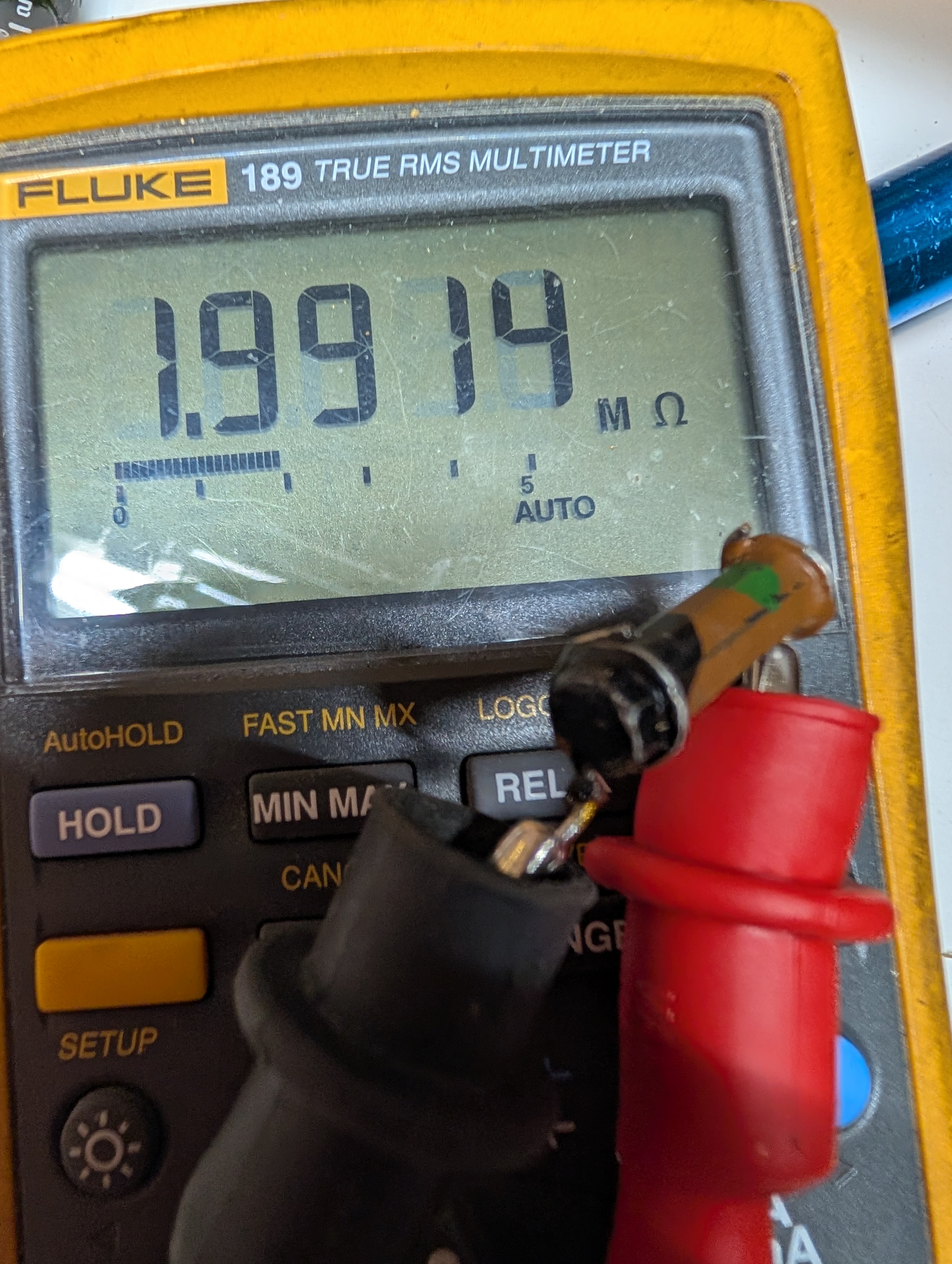

This one is 2M.
It drifted to 2.7M.
I needed to put 8.5M in paerallel. I had a bunch of 4.7M resistors from a kit from mAmazon (their tolerance more like 10% vs promised 5%), one being 5.7M....I put two of the lowest values, 4.65M in series, in parallel to the original one and got some 2.1M.
Then I will need to clean the board. Grimy as a tar pit.

So, today, other than taking out that board, I restuffed a few caps.
I hope, my photos and my memory will not fail me when I start reconnecting all this.

Mike, Great work. I would've never thought of paralleling resistors, a nice touch. Nomally I'd rip them out and replace 'em. Be strong. Joe
Joe
often times I do the same, but there are places where a resistor to be within tolerance is more important thn in others (like, to me AVC being 2M or 2.7M would not even make me touch it; this one is in series with the Control grid, so the drop caused by even a small current can affect it) and so some resistors I correct and some I do not.
Those that I do correct, I either replace or parallel.
Those I parallel are the ones that went outside of tolerance but within reason considering the age.
2.7M vs 2M is within reason to me, over 90 years.
Within reason means speed of change. This one went up 30% over 90 years., or 0.33% a year on average.
Then let's say it went to 4M/5M. To me this is bad, same as if it were open. I will yank it and change it.
Another possibility if a large resistor went up so much, that you could parallel the intended value resistor to it (say, 10K went to open or 100K and you parallel a 10K there) and hide it behind the original resistor. Sometimes I do that too.

I've seen 2M being open or 10M.
Some of the 100K or 250K or so in Philco 20, I remember were fully open, but those were at least conducting something. Those that come from the wire-wound, one feeds the detector plate and the other Screen Grid. Forgot which one.

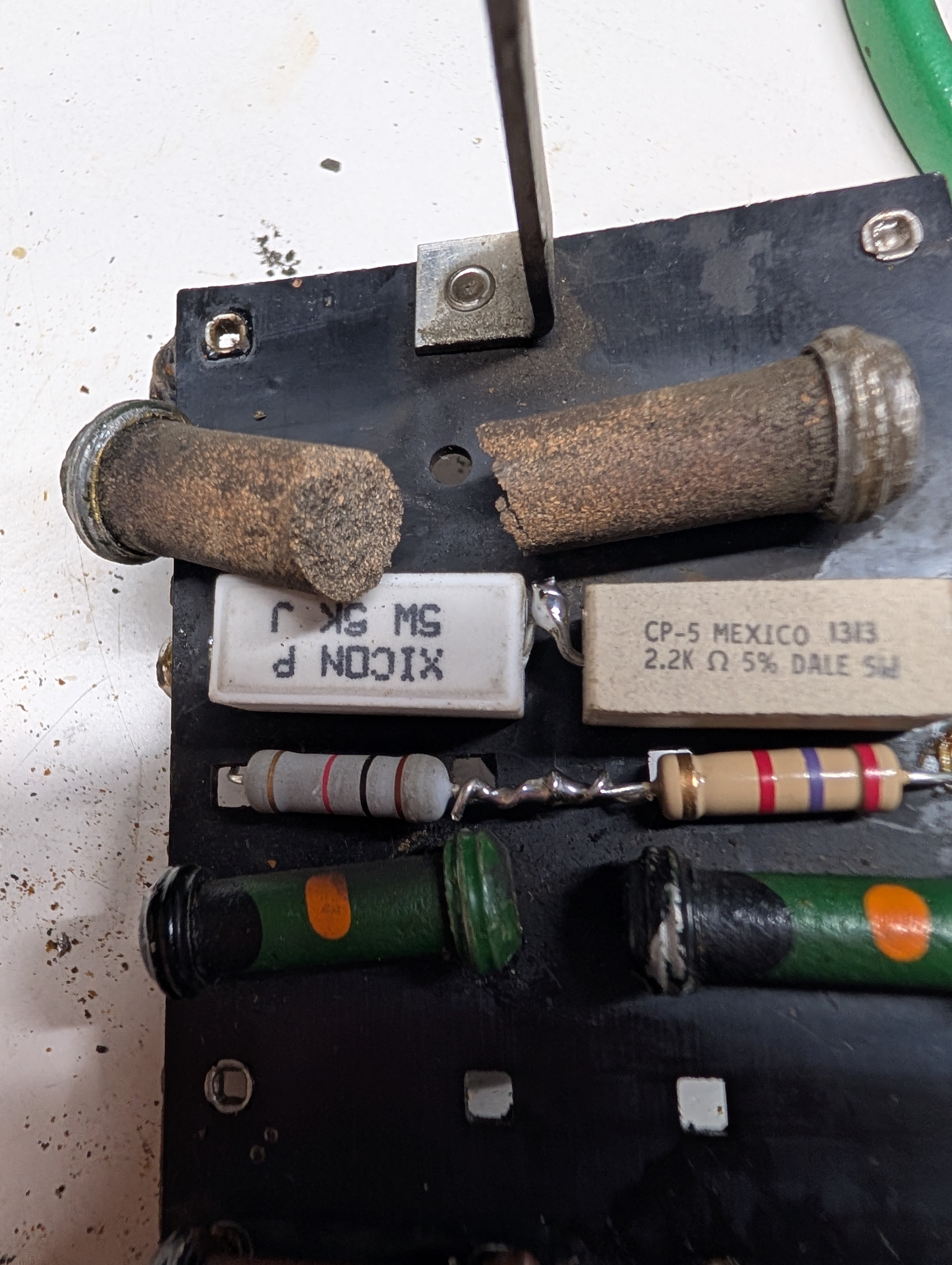

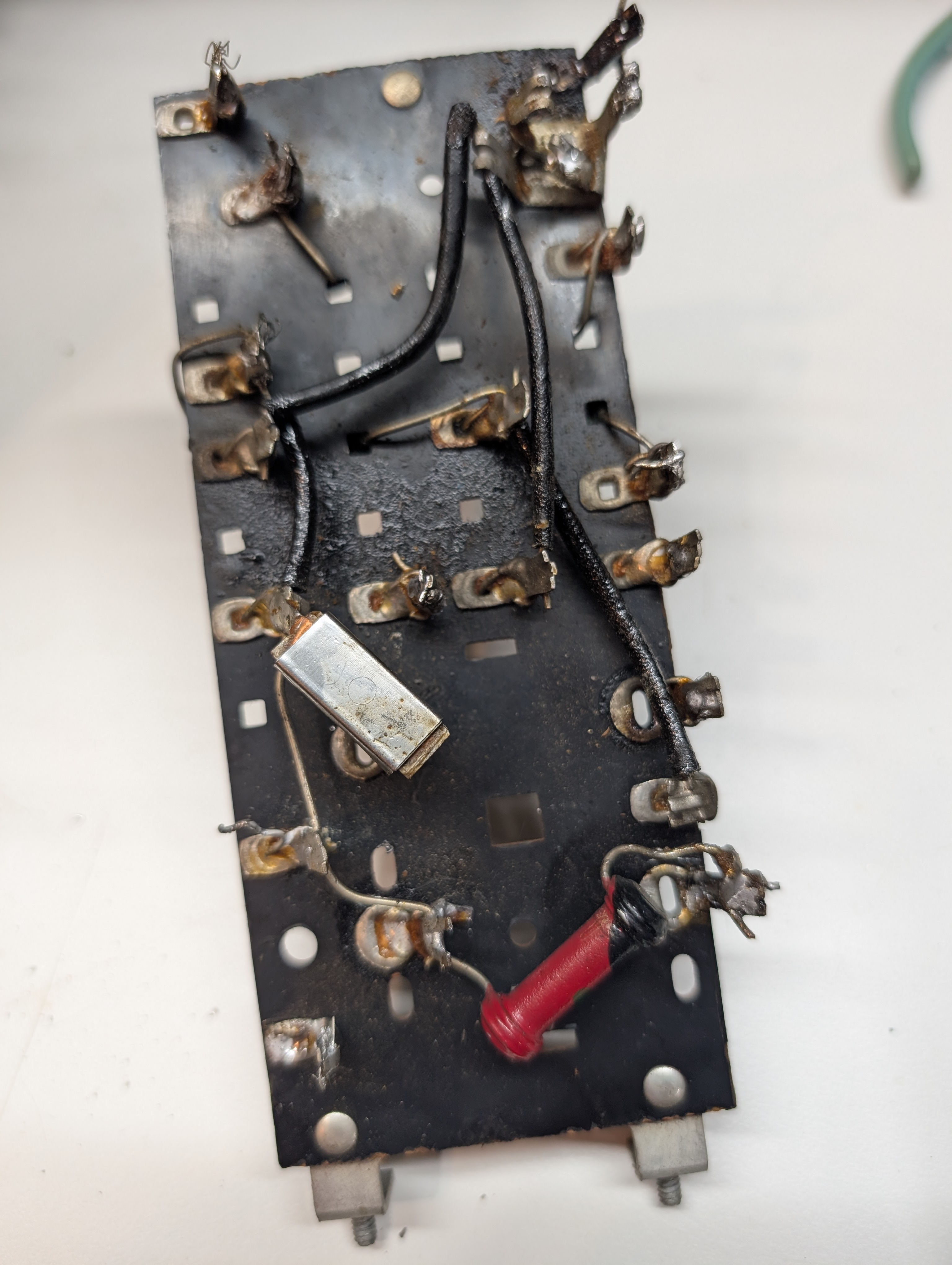

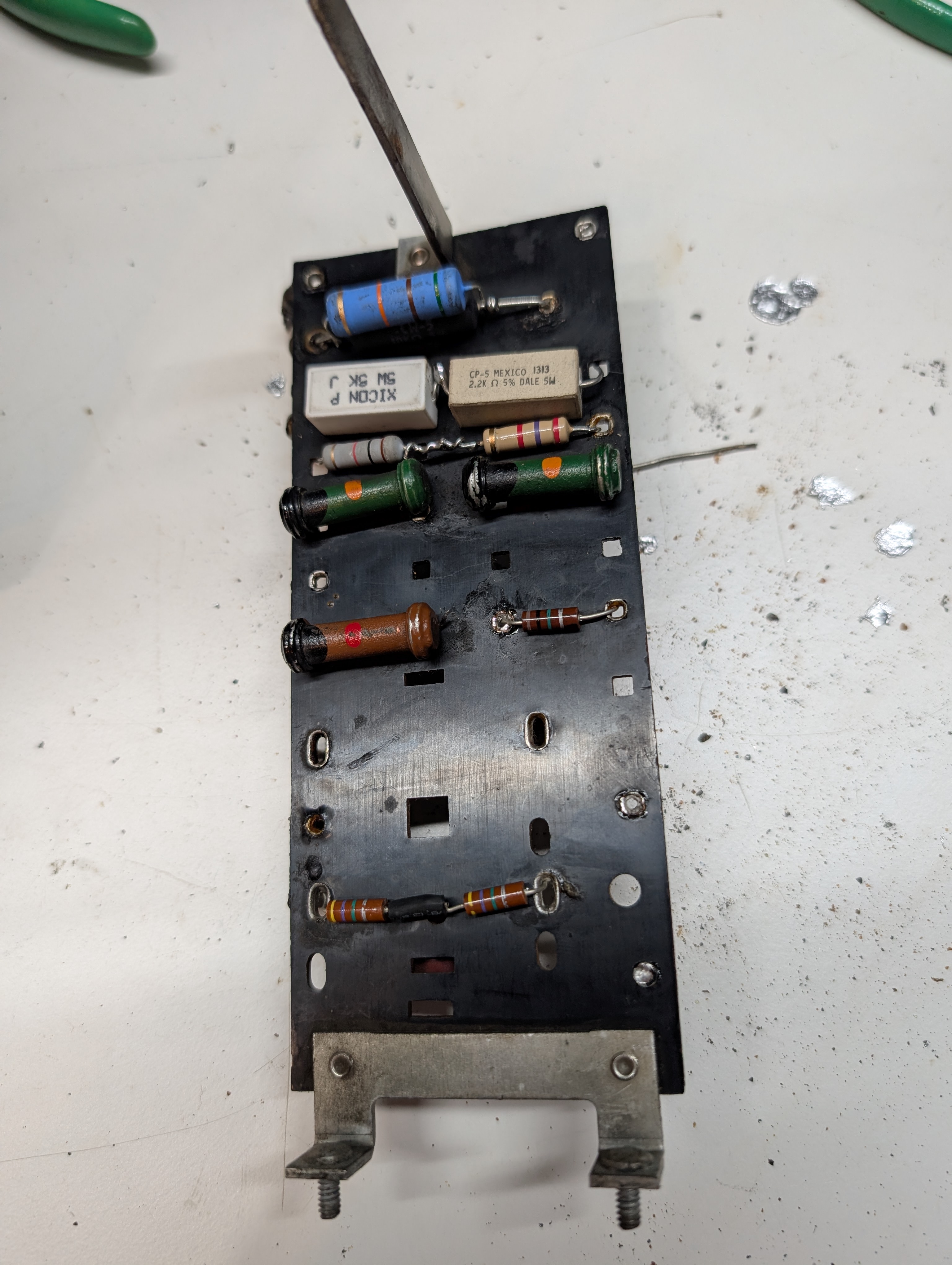

Speaking of out of tolerance resistors, this type I change.
A 1M that is exhibiting 2M.

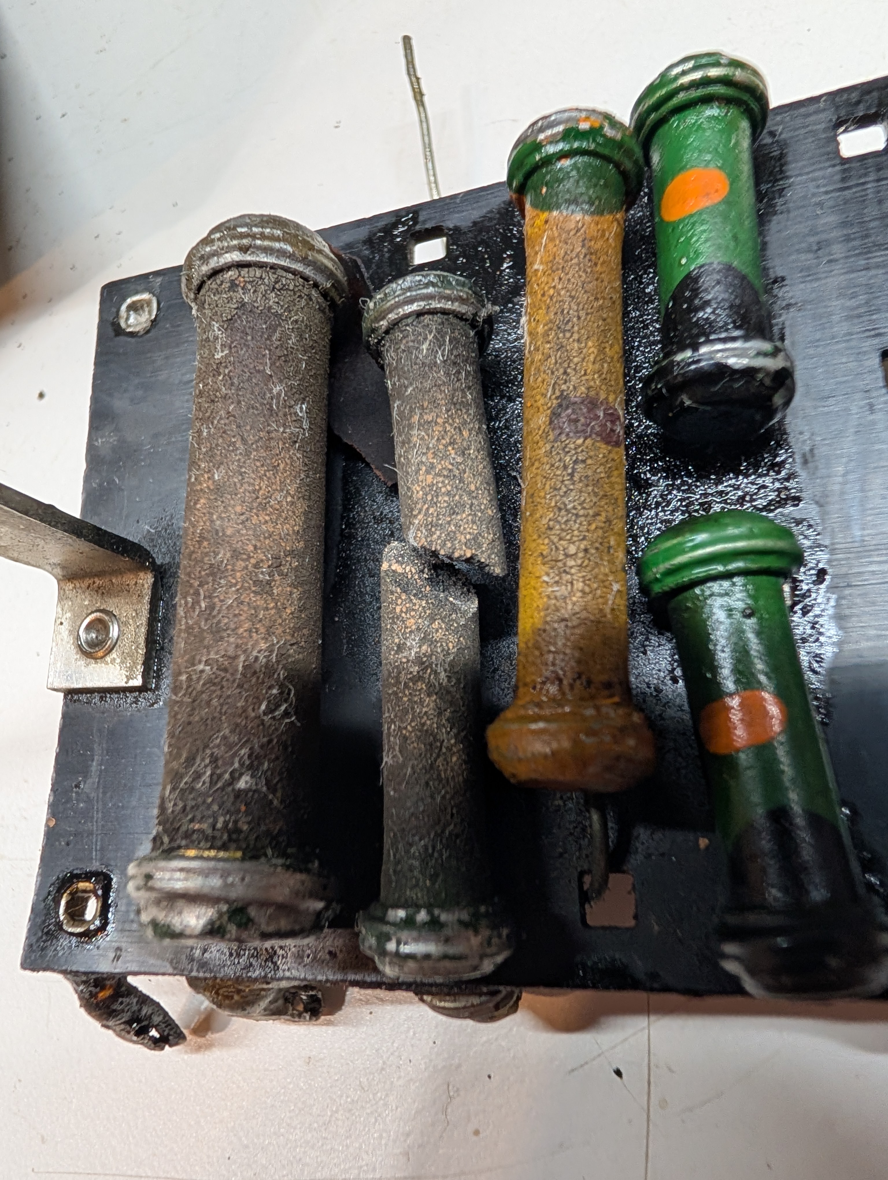

Now, there are three resistors, R7 / 3.5K, R6 / 6,5K and R5 / 8.5K.

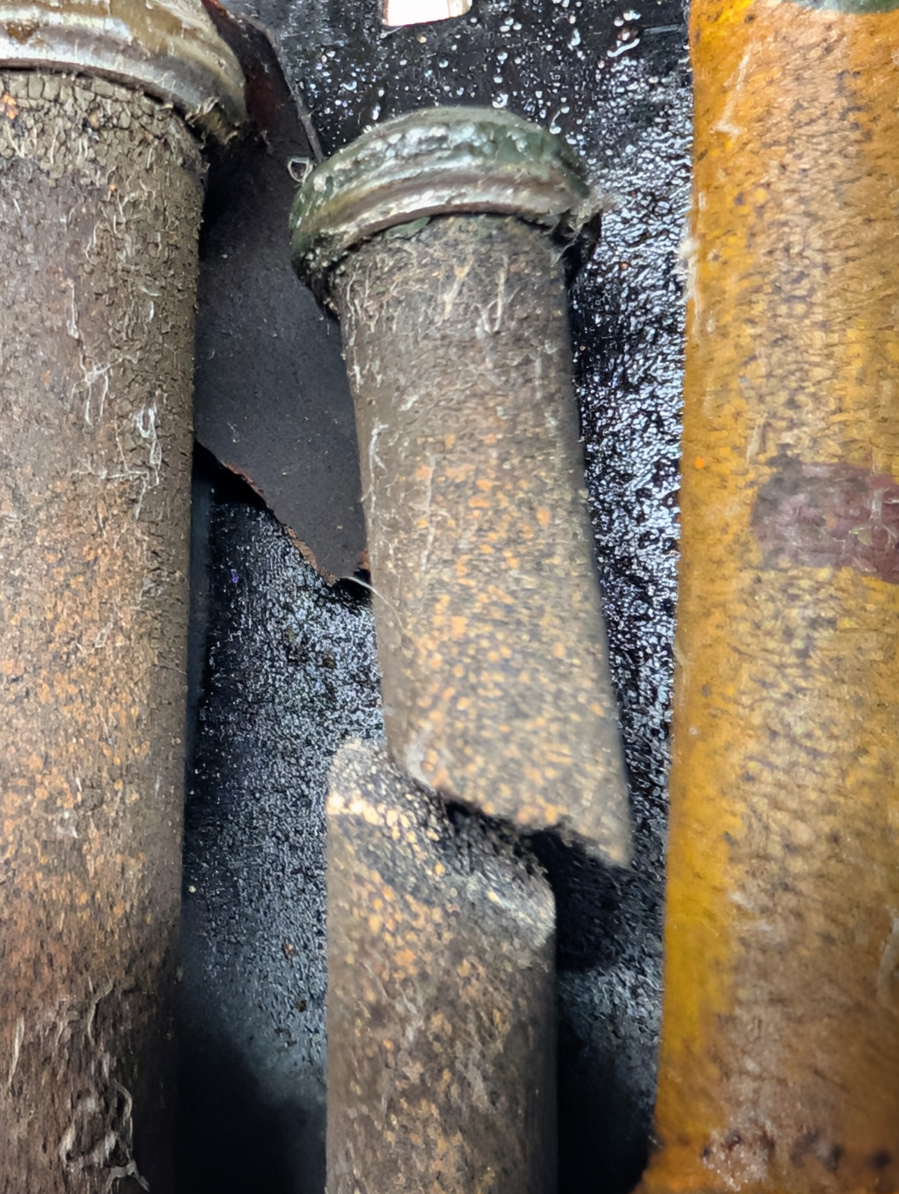

Obviously they are power-dissipating type, as all were discolored.
All went down in resistance (I've observed that with Philco power dividers in Philco 60 and similar Philcos, for the power divider resistors, a lot).
The 3.5K was 2.5K and the only one that retained some colors and did not break when simply touched.
The 6.5K was broken (I broke it but without any effort, probably just touched during the board handling), and the 8.5K was 5K before it also broke when slightly touched.
I was able to use paralleling/serializing and got pretty close to the requir ed nominals, plus I think I have good margin on the power ratings.
The rest of the resistors were either right on the money, or pretty close, so I left them.
This is how it looks now.
