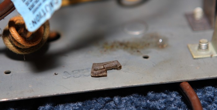

Hi Everyone,
I've just about got everything removed from the top of my chassis (except the adjustment coils in the square cans - so I'll have to come back and re-read this discussion on alignment later). I've got new caps (restuffed in the old cardboard tubes) and resistors and am just waiting for my wire to arrive and I'll redo the entire underside of the chassis.
In the mean time, I was pushing the tuning buttons on the chassis and this fell out of the mechanism somewhere. Any ideas what it is? Where it came from? Where I can find a new one? Do I only need one, or do I need several?
Thanks!
Eric
#54
I managed to figure out the part from my last post, it looks like a rubber bumper for the buttons in the push button tuner. Does anyone know where to find replacements? I haven't found any online yet...
And on the topic of the push button tuner mechanism, what type of cleaner is best for cleaning the gunk out if the mechanism? Can I use some CRC cleaner and the Re-lube the mechanism with some WD-40? Or should I use something else?
I finally have some time this weekend and will begin replacing the caps, resistors, and rubber wire.
#55
Eric, CRC followed by a tiny spritz of WD40 is what I've used, with no problems. Someone else might have a better idea though..
#56
Eric, as for the bumpers, I have several fall out. Some were "alive" enough I could put them back in with some rubber cement. Some like yours were well, just totaled. I found the push buttons worked just fine without the missing ones. I don't know if anyone makes reproductions or not.
Jerry
