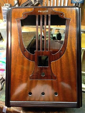

Definitely have to be historically accurate. Especially sine it is Mikes cabinet Icon_lol
Thanks for the No blush info.
She is done and set aside to dry.

Kirk, that looks fantastic!!! Icon_thumbup Icon_thumbup Icon_clap Icon_clap Just like you took it off the Philco assembly line. Seriously. Great job!
#48
Looks great!

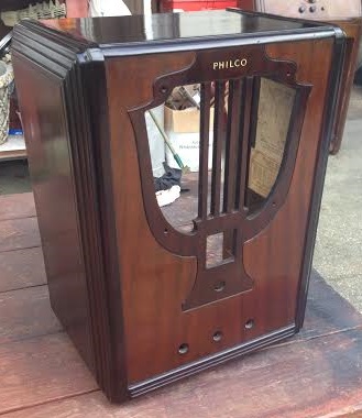

Great looking job,
Did you spray clear over the new "Philco "logo or applied it afterwards? I am about to attach mine, wonder which way to go. Thanks.
#51
You have to clear the decal itself and the wood before and after application
Kirk
#52
So then you will not be rubbing out the top of the grill, as it might reach decal, right?
#53
I will be rubbing out the whole cabinet. You should have a good thick layer of lacquer over the decal. Rubbing it out should not affect the decal or hasn't on any of my radios.
Kirk
#54
Thanks, Kirk.
#55
Just put a couple coats of clear on top and should be no problem. Without the clear the letters will wipe right off.
#56
I already have 5 heavy ones and 10 days in drying. Live and learn.Might have to put it in after the buffing out and coat it with a thin lacquer ever so lightly.

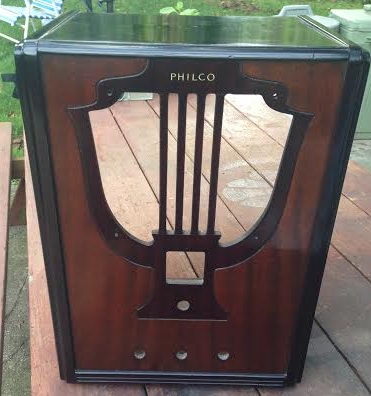

I am 99% done with this cabinet.
The final coats cured for only 2 weeks but I 400-2000 sanded and she is ready for wax.
#58
Waxing hurts.
Be gentle on her.
