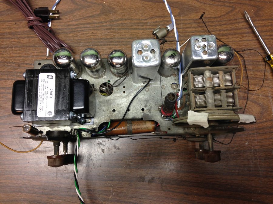

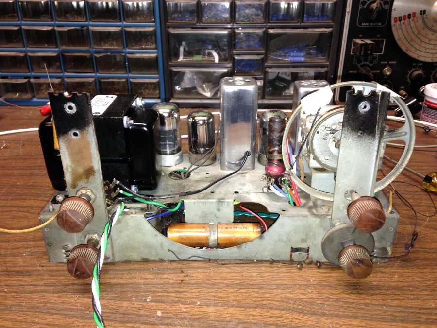

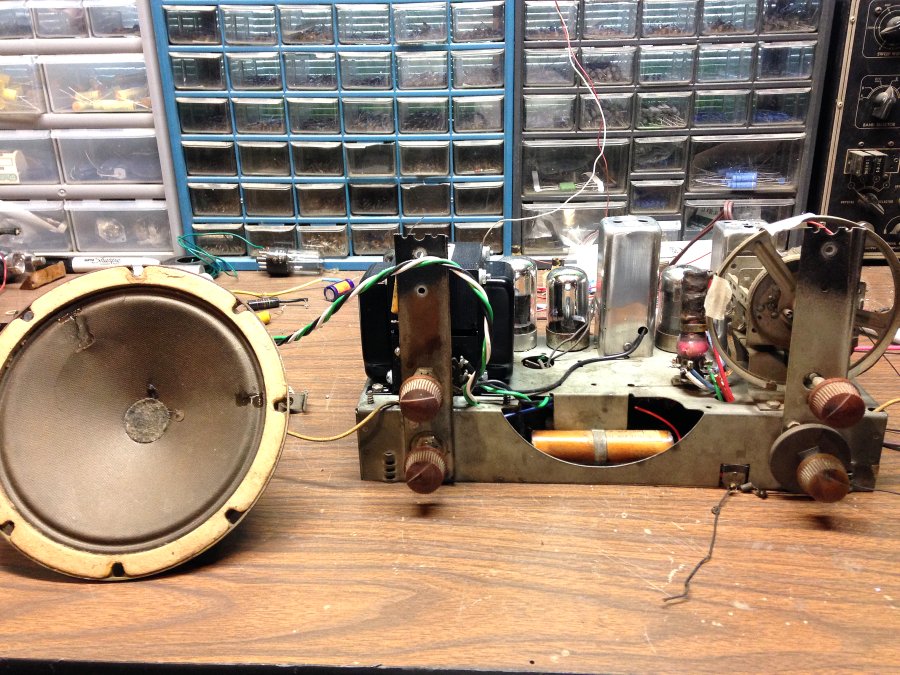

And now I have a new Hammond 270EX transformer.
It is longer than the original, plus it has wires protruding from both bells. The original had all of the wires coming from just one bell. So...that meant drilling and enlarging a second hole for some of the transformer leads.
Here's how it looks:
[Image: http://www.philcoradio.com/images/phorum...e00030.jpg]
[Image: http://www.philcoradio.com/images/phorum...e00031.jpg]
[Image: http://www.philcoradio.com/images/phorum...e00032.jpg]
I'm using only three screws to hold it onto the chassis; the fourth screw hole would be right above where the audio output transformer is mounted, so it could not be used.
I probably should have purchased the 270DX instead; that would have allowed me to reuse the original transformer bells. But this one has plenty of reserve current capacity and should never run hot. With all of that iron, it looks like a 25 cycle transformer (even though it isn't)!
This transformer has a 5 volt winding as well as a 6.3 volt winding, so I rewired the 6X5 tube socket to accept a 5Y3GT instead. The 5Y3GT is a more robust rectifier, and this mod should eliminate the possibility of a shorted rectifier tube.
And It's Alive...
[Image: http://www.philcoradio.com/images/phorum...e00033.jpg]
I had a NOS GE 5Y3GT tube, so it went into the former 6X5 socket.
I crossed my fingers...plugged it in and turned it on...
In less than a minute, I was listening to my home SSTRAN playing 1950s music.
I let it play for a half-hour or so, checking the transformer periodically. By the time I turned the radio off, the transformer was barely lukewarm, and I think a lot of that was due to the heat generated by the 5Y3GT and the two 7B5E audio output tubes, all of which are right behind the transformer.
So once the dial back plate returns and is reattached, this will only need an alignment and then should be good to go. I really won't be able to test SW until then. (Yes, I know I could now, but I don't want the dial cord to come completely unattached. You will note in the photos above that it is being held onto the flywheel with masking tape so it does not come off.)
Posts: 5,650
Ron;
How are the voltages reading out of that transformer? I was a bit concerned that the filament voltages may be a little high, I was not sure if you actually needed 3 amps current capacity for the 5 volt rectifier winding, as well as 4 amps would be overkill for the 6.3 volt winding since the rest of the tubes only draw 1.55 amps. Since the high voltage winding was already lower then the original, but at more then double the current rating, it should be pretty close to the 270-0-270 the radio calls for. If any are a little too high some wire wound resistors should take care of it.
It's not really a surprise that it's running cool, but one thing I don't like about the newer Hammond transformers are those plastic labels they glue on them rather then the nice brass badges they used to use, and the nylon washers they used on the bolts holding the end bells on, both are minor and easily undone.
(This post was last modified: 11-23-2014, 03:22 AM by Arran.)
I went down and took some measurements.
6.3V is reading 6.54V.
5V is reading 5.13V.
I could not measure plate to plate on the rectifier as one of the electrolytic capacitors is in the way, so:
5Y3GT pin 6 to B- is reading 288.8 VAC.
B+ measured 325.3 VDC from rectifier output to B-; and 248.4 VDC from rectifier output to chassis ground.
This transformer has three terminals for AC input - common, 115 and 125. I am using the common and 125V taps. At least, that is what the diagram states (gray, 115V tap; black, 125V tap). I should measure with my ohmmeter (with the power off and radio unplugged, of course) to be sure I am using the 125V tap and not the 115V tap.
AC line input is reading 123.9V.
Using a 5Y3GT, I only needed 2A for the 5V winding. And using LEDs for the three pilot lamps will cut down on current consumption a little bit.
Posts: 5,650
Ron;
Current won't be an issue with the transformer, however the filament voltages, or even the plates running a bit high may shorten the life of the tubes somewhat. You can use regular #44 lamps for the pilot lamps, if anything it will drop the filament voltages down some more and not harm the transformer.

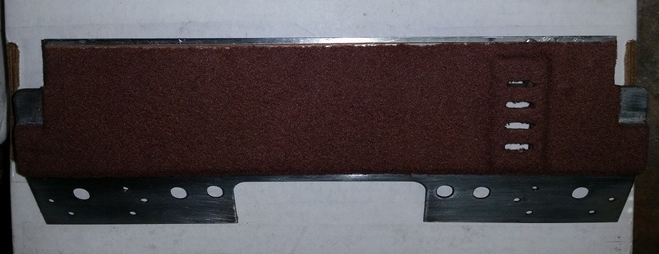

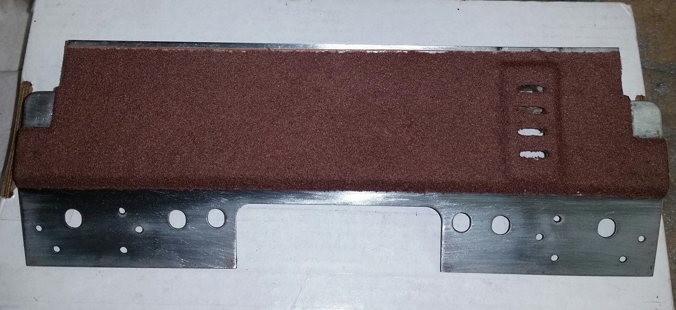

Since it was such a snowy, cold, icy, miserable weather evening here in southeastern, Wisconsin, I had a bit of time after work to give Ron's dial back plate some attention. I think I had some success!
And I also managed to install the freshly rewound OSC coil, courtesy of Ron, into my 59C, and...
It's alive!!
I was able to tune in WBBM in Chicago, some 120 miles south of here.
So in spite of the weather, it was a good day!
Greg V.
West Bend, WI
Member WARCI.org
W O W
Man, that dial back plate is now beautiful. It looks like it was just freshly flocked at the Philco factory! (try saying that three times)
My hat's off to you, Greg. I don't know how you did it...but I am certainly glad that you did! Thank you so much for your help, I really appreciate it.
I'm guessing you must be doing this in a heated room. I simply could not make things work right in the cold house garage. I think that if I ever attempted it again, I would work outdoors in hot weather, treating it just as I would refinishing a radio cabinet.
I am also glad to see that your 59C is up and running, too.
Greg, thank you again! So now I will only need to align the radio and the chassis will be done. That will leave cabinet cosmetics...that will have to wait for warmer weather.
