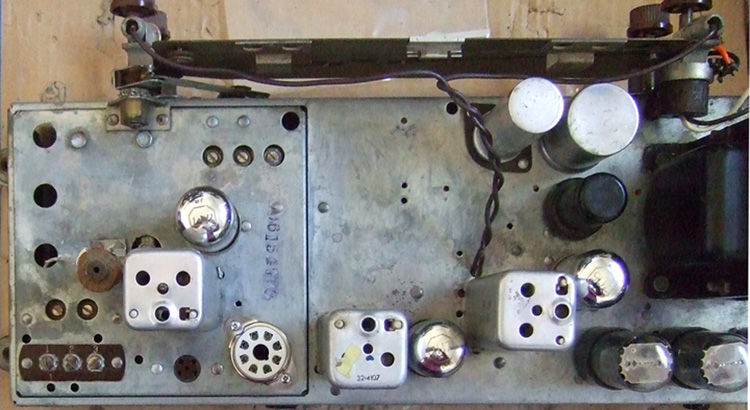

I just finished mounting a ceramic top-side saddle mount Octal socket which neatly covers the Loctal socket hole with room to spare. Next I will order a 6SG7 to install. I had one old Silvertone and one old Admiral AM AC/DC chassis that might have had a socket I could have used, but installing a bright shiny new socket looks better. I misplaced those chassis anyway. Next I need to check the pin-outs for the 6SG7, although I think they are the same as the 7H7.

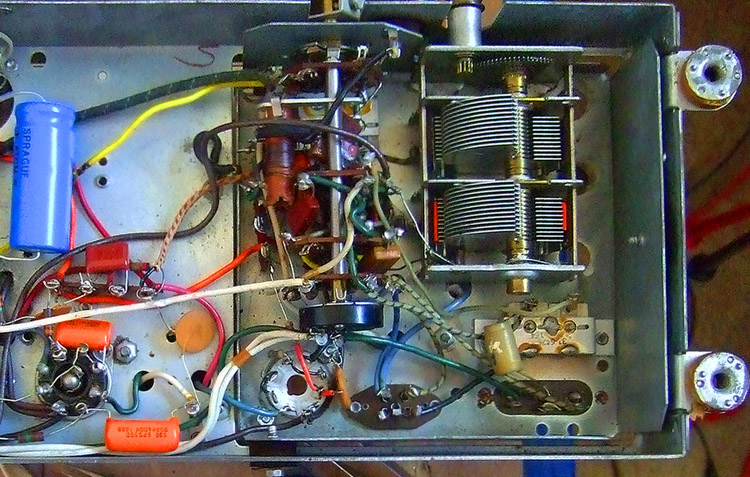

I finished the installation of the new Octal socket which will employ a 6SG7 IF amp tube when it arrives. The work went rather easily and the end result looks neat and clean. I did use a new 27K ohm 1/2 watt resistor for the B+ to the screen grid and a new 68 ohm 1/2 watt resistor for the cathode resistor. The IF transformer wires to the signal grid and the plate tube socket contacts were of adequate length and were easily moved to their new locations. I decided to take some new photographs of the area to show the new socket.
The Octal tube shown in the new socket is not an actual 6SG7, but a 6J5 just for illustration purposes.

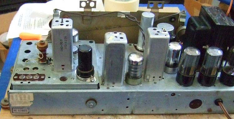

As a follow-up to the modification of the 1st IF from a 7H7 to a 6SG7, I did receive the new old stock Sylvania 6SG7 from AES on Friday. Yesterday I felt better after a Tylenol to help diminish the fever I was having from the flu and installed the new tube. A quick check with the substitute AM loop antenna showed that the reception is better than before with many more AM stations appearing all up and down the dial. So this particular tube is a good replacement (not substitute) for the original 7H7.
