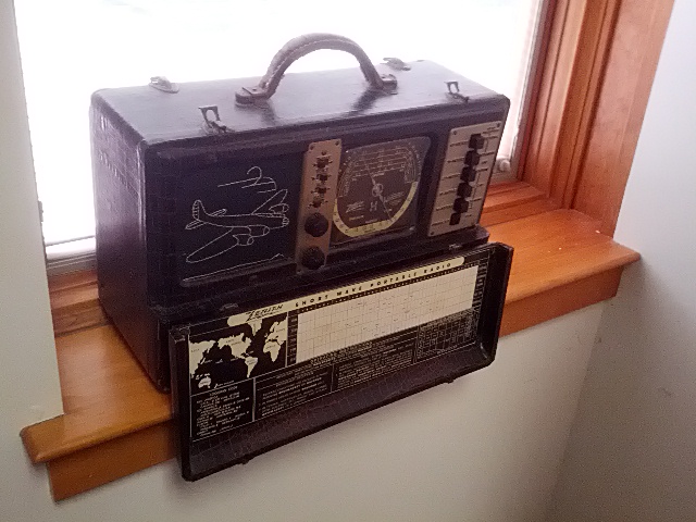

Here's the one I just snapped - I took it to work to show to some folks. It is by the window as this is the only place where I could get reception - otherwise the tin roof blocks it.
Obviously you could not see it working :Icon_smile but I am planning to eventually shoot a short movie, like I did with other radios.
Mike.

That's very nice Mike!
#70
Nice radio, and great restoration Mike - thanks for the picture!
#71
Looks very good. Icon_thumbup
