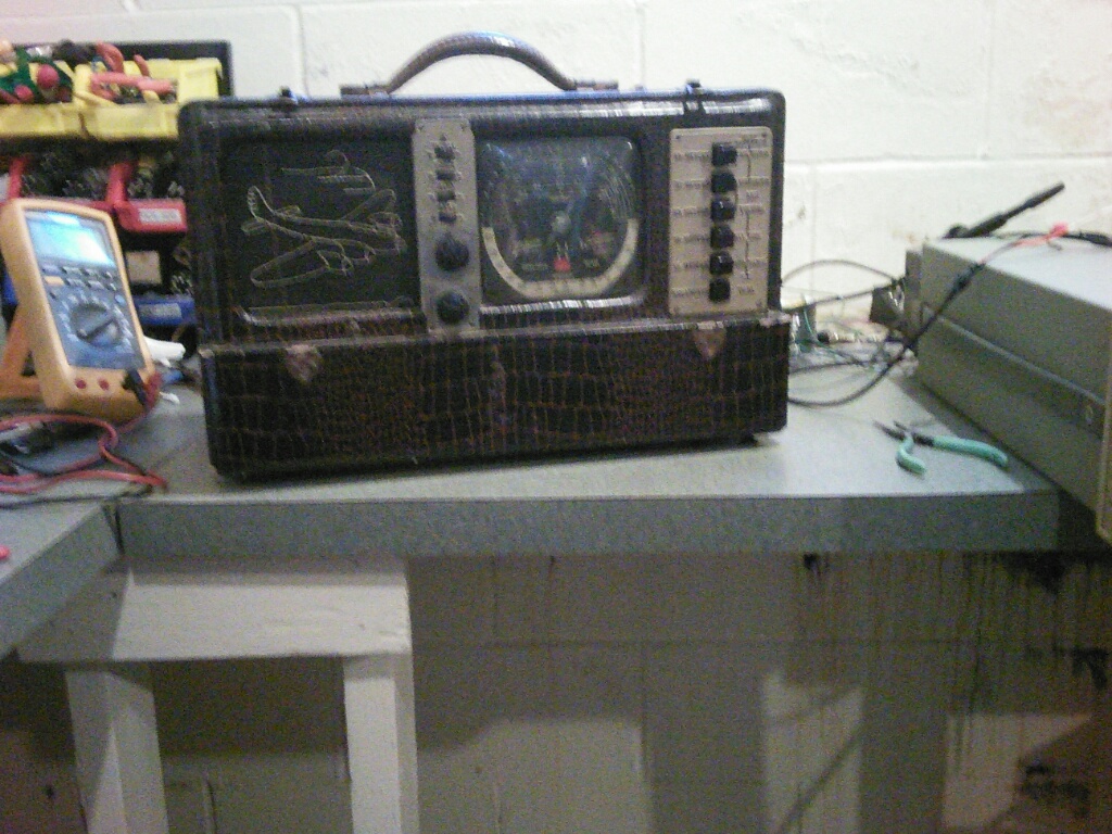

Yesterday I decided to investigate the issue of the crackles while tuning. To remind, it only showed on BC band and only between 1200 to 1600 kHz.
I took the tuning cap out and gave it a good bubble bath with soft long brush between the vanes, then dried with heat gun on low.
Then left overnight and today I connected it to a doubling rectifier via resistor 30K.
I put the voltmeter across the plates and turned it on. I did all three sections one by one while turning the rotor.
No sparks or jumping voltmeter value, meaning no shorts and no burning debris.
I also didn't expect the crackles to be the result of the bad wipers contact to the rotor as there are 4 of them - no chance of such repeatability.
So....put it back, turned it on......no crackles anymore.
Put the dial back, then the pointer....same, no more crackles.
I will have to realign the bands.
Mystery.

I don't remember if I said that I found this set to be less sensitive than the other, especially when using the battery.
So after clearing up the crackles problem I decided to see what gives.
Yesterday after realizing that touching the loop antenna input did not result in anything while on any band (though connecting the rod has effect on SW) I extracted the 1st RF tube, bypassed the filament with a 30 ohm resistor and found out that this did not affect the reception at all.
Further investigation showed the primary of the RF transformer is OK (and so is the plate voltage) so I suspect it is the secondary winding that might be bad.
However the radio tunes correctly (it did pass the alignment).
Will poke more tonight. I want this to perform at least as good as the other one.
Well...a wire from the secondary of the mentioned RF transformer coming to the BC band switch was inconspicuously broken. Once reattached, the sensitivity went way up.
Now I think I should re-align the set, just in case.
Assembled it back, works fine, sensitivity is the same as that one of the other set.

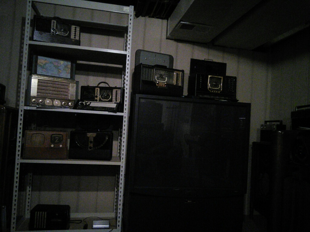

My tube portables (some transistor ones are on the right)
Posts: 1,519
Threads: 69
City: Kansas city, MO.
You got a nice collection there Mike.
