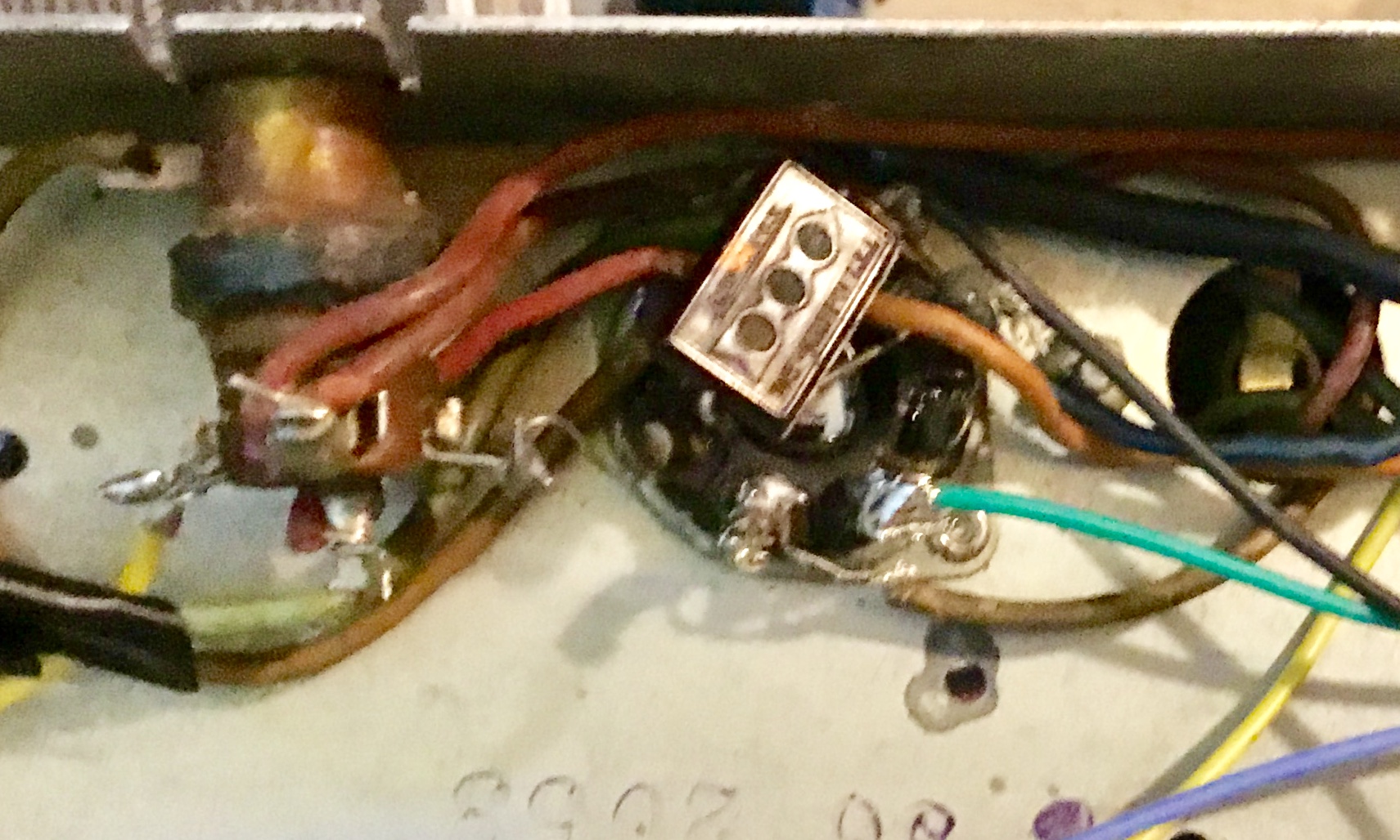

I need advice although I think I already know the best way to handle this proper, I’m just scared to ruin the cap in the process because I don’t know what to replace with.. I’ve got a couple of iffy connections behind this mica cap that in order to repair them properly they should be replaced. As you can see I’ve attempted to do the repair without removing it but, I’m not really happy with it (especially the black wire) Got any safe and reliable ways to go about fixing those without removing the cap or can I remove the cap and reinstall it when I’m done without breaking it… i know I can unsolder it but, I’m more worried about being able to resolder it back on
