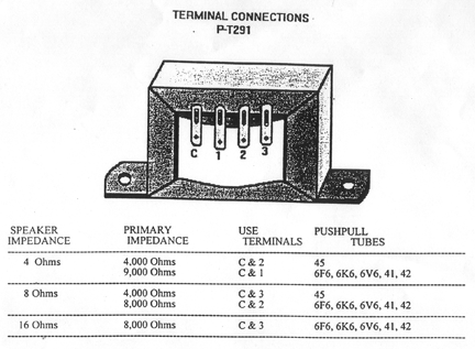

The data sheet for the correct transformer looks something like this? If not could you post a picture of the data sheet for the correct transformer. One can never have to much info when working on old radios.
If it is a Hammond, their SE part number has "SE" in it.
There are, I think cheaper alterntives. Hammond is expensive.
