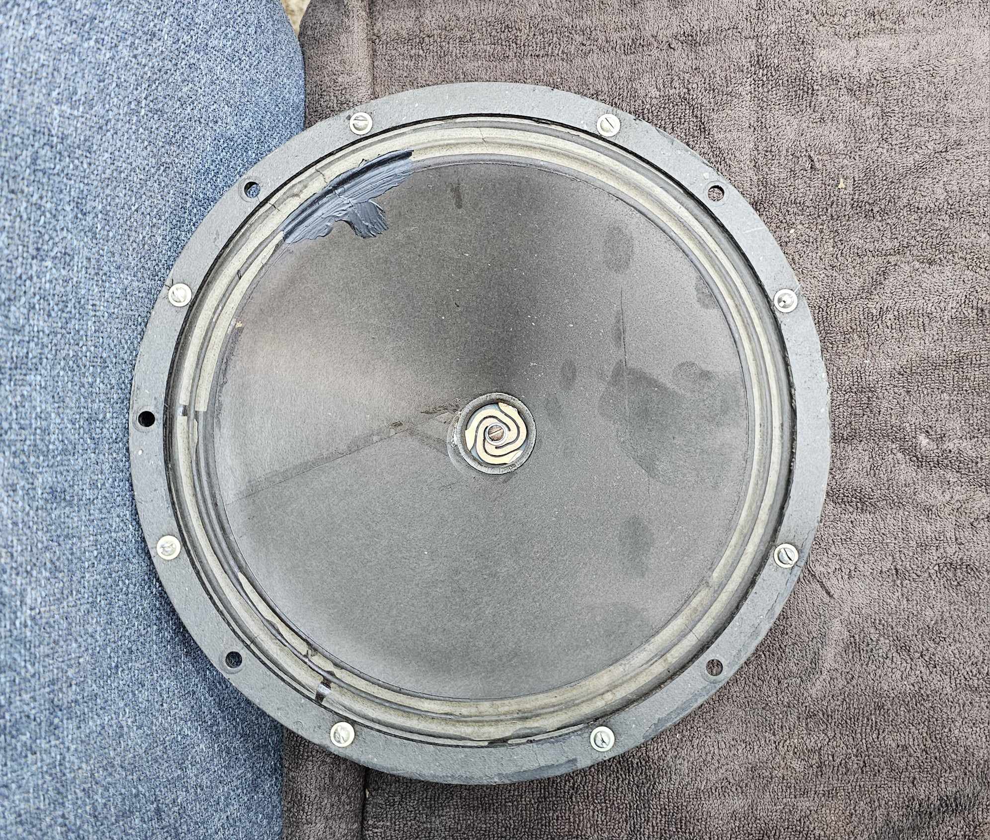

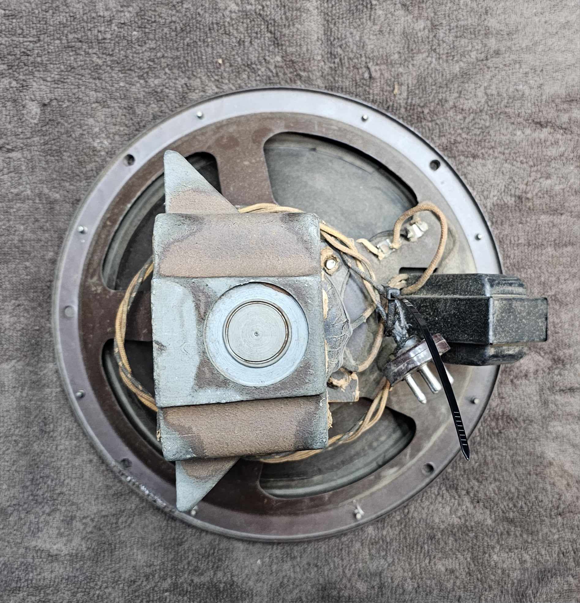

Well,
After a long pause and a few other project radios, Im am finally getting all the bits and pieced together to start this restoration.
So in my travels I have managed to find 2 speaker units for this radio. One for the dual 47 chassis and the other for the single 47.
My question is, can you swap the cones? They look like you can desolder two wires, remove the screws and separate the cone from the frame. Is this the case? If So I would like to put the better cone with the single 47 unit.

#65
The cone/vc are the same but you may have some trouble getting it off of the frame. After 90+ yrs they get stuck to the cardboard ring and all most glued to the frame. Have had some just pop off and other that I had to cut off with a sharp knife. The folds near the outside edge tend to fails, paper just fall apart requiring a new cone. On these they are 10 1/2" so you have to use a 10" cone a make a spacer to fill in the gap between the cone and frame.
When you have it apart do clean the dust from it and the gap (the area were the vc fits down in to). Dirt gets in there and restricts the vc movement deminising the speaker's frequencies response.
I just got done servicing speakers in a 21B,70B, & 90B v2. All got new cones and cords.
GL
#66
I just finished resurrecting an H13 10-1/2 Inch speaker for my 650. The original opt was bad and the cone & spider was bent out of shape but the vc and field coil were good. I had planned to attempt a recone when I found an opt and Philco 650 at an estate sale for ten bucks. The cone fit perfectly in my original frame. I used contact cement around the cone's flexible edge to reinforce the paper. I left the cone slightly loose with the speaker face down on the workbench and played the radio on and off for about a week to see if some distortion could be alleviated and it worked. The vc had centered itself.
The gap for the voice coil was really dirty. I used a thin feeler gauge with a vacuum cleaner to get it clean.

#68
Quote:The cone/vc are the same but you may have some trouble getting it off of the frame. After 90+ yrs they get stuck to the cardboard ring and all most glued to the frame. Have had some just pop off and other that I had to cut off with a sharp knife. The folds near the outside edge tend to fails, paper just fall apart requiring a new cone. On these they are 10 1/2" so you have to use a 10" cone a make a spacer to fill in the gap between the cone and frame.
GL
So.. you are suggesting disturbing the cone at all will result in the failure of the brittle surround? But thats only when you have to cut the cardboard off?

#69
Quote:I just finished resurrecting an H13 10-1/2 Inch speaker for my 650. The original opt was bad and the cone & spider was bent out of shape but the vc and field coil were good. I had planned to attempt a recone when I found an opt and Philco 650 at an estate sale for ten bucks. The cone fit perfectly in my original frame. I used contact cement around the cone's flexible edge to reinforce the paper. I left the cone slightly loose with the speaker face down on the workbench and played the radio on and off for about a week to see if some distortion could be alleviated and it worked. The vc had centered itself.
Well using rubber cement on the surround sounds like that might be a good tip! thanks!
Did you get your cone off without destroying it?

#72
I've used some watered down fabric glue around the edge to add some support. At 50% a few coats seems to work. On the K speakers I have some replacement cones so it not that much more work to just replace as I would recommend a good clean no matter what.
Rod, On the H13 spkr the fc/pot assembly can be removed easily by using a drift to drive the course threaded screws out. It's about one turn per 3/4". That goes for all the Philco spkr that use these fasteners. The rub is that the cone is in the way so on most of the K and the later H spkr the cones are glued in...
#73
Mike_4f - Yes, the cone came off with just a little nudging at the rim of the frame.
#74
Quote:'ve used some watered down fabric glue around the edge to add some support. At 50% a few coats seems to work. On the K speakers I have some replacement cones so it not that much more work to just replace as I would recommend a good clean no matter what.
Now I got even more questions  Icon_biggrin Icon_biggrin
1) Do you have a link to the brand of fabric glue you used?
2) Where did you get your cones from?
3) do you have a photo of the finished speaker with your spacer?
Cheers!!

#75
I don't like putting a substance on the surround that makes it stiffer. I like flexible so the cone moves freer, nicer bass.
