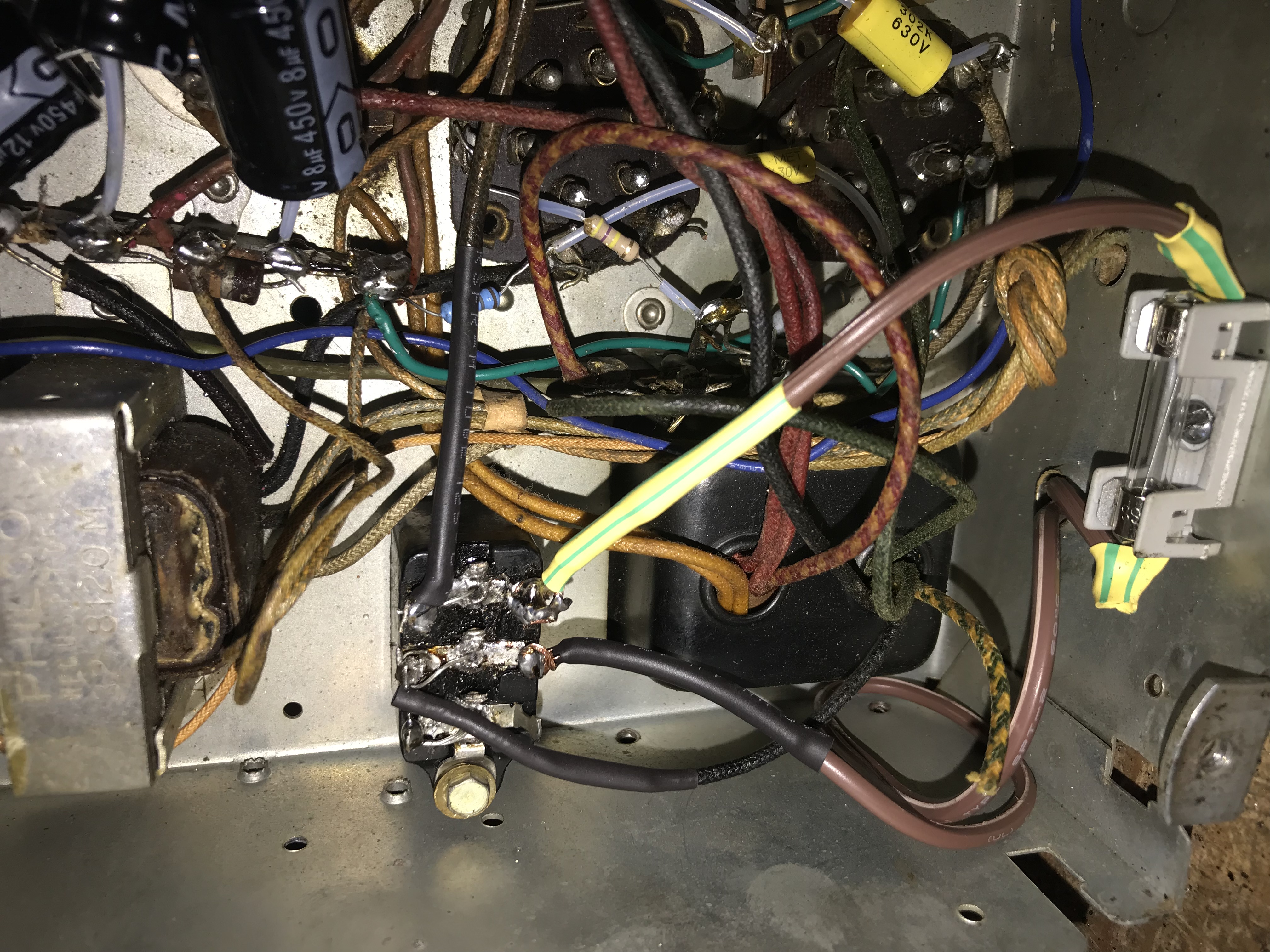

I should have been clearer - I drilled through the eyelets to get this material that was blocking them - They are still there firmly attached to the block. Everything is hooked up and it’s working well. I tried to make liberal use of heat shrink to protect everything. It seems quite stable and secure to me.

Great idea putting the fuse in there Bridkarl! I would still have that console that Dad (really Mom and my sisters) made me toss after the transformer fire caused by a shorted 5Y3. I always install a fuse in a transformer powered radio (The 35Z5 / 35W4 is its own fuse in an AA5). I also disconnect the HV Secondary to the 80 / 5Y3 plates and put 1N4007s in series between the winding and the rectifier plates (Observe polarity). I can't remember where I got that from, maybe Phils Old Radios or Ron Ramirez. Protects the transformer in case of a plate to cathode short in the 80 or 5Y3. Not really necessary on tubes with sleeved cathodes like 5AR4, 5Z4, 84, 6X5, etc.
#64
I get what you are saying. Given these are new caps I’m less concerned about that since the chances of a short on the B+ seem low.
I haven’t been doing that. It seems like if you put a fuse on the center tap that would do what you are talking about - right at the junction of 62 and 61. They sell these fuse holders with a pigtail on each end that seem to be ideal for that if you didn’t want to use a diode.

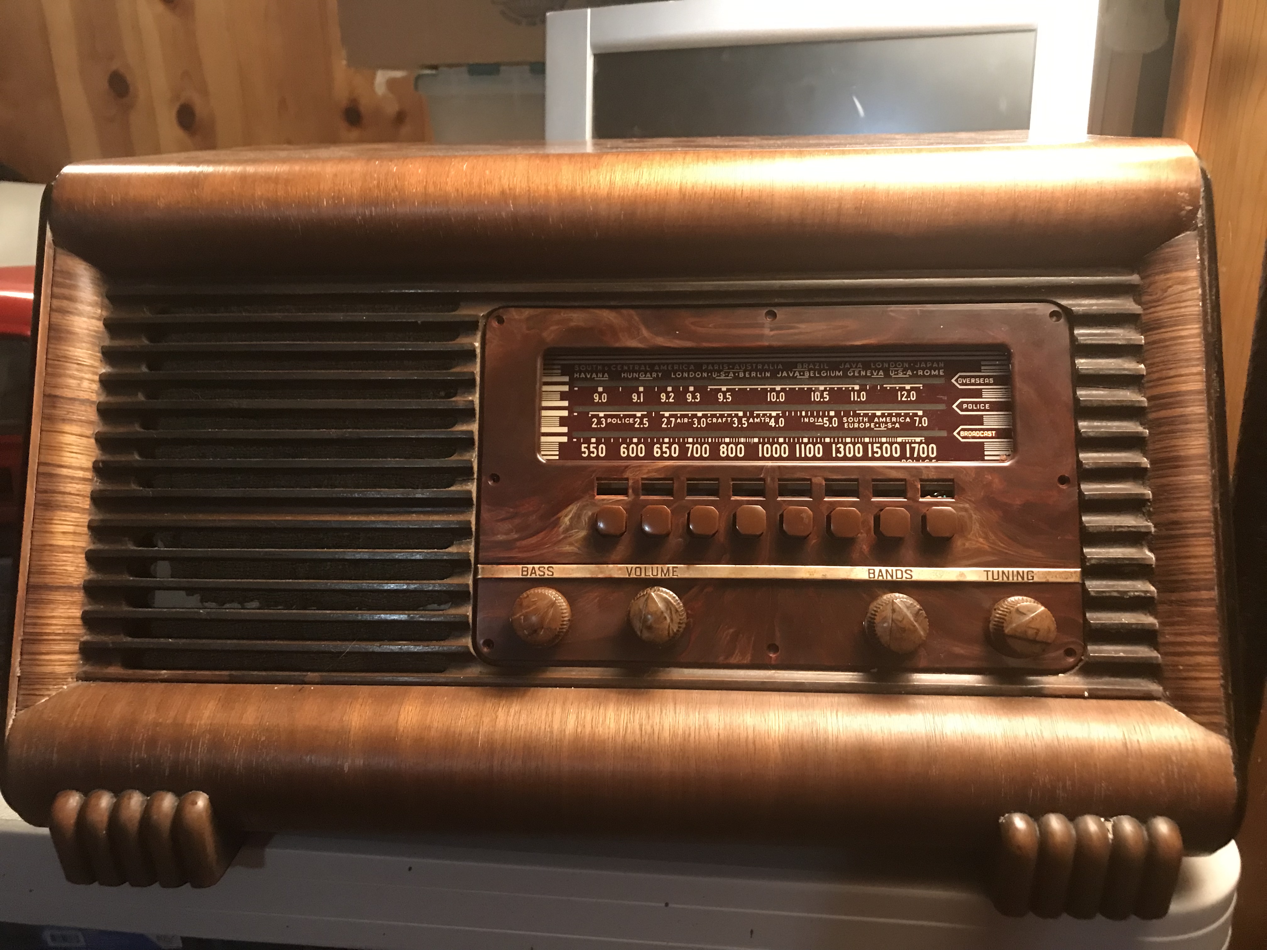

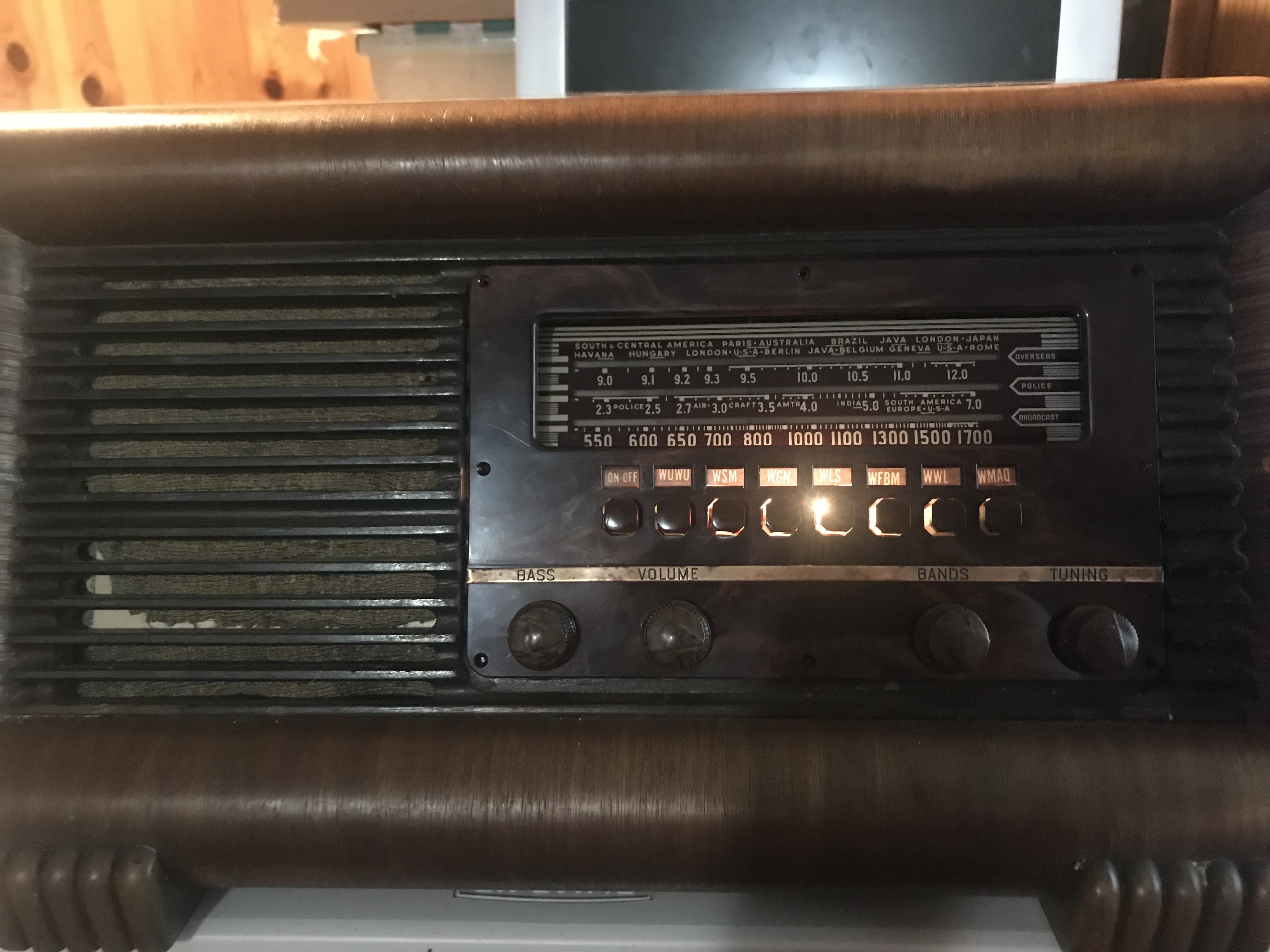

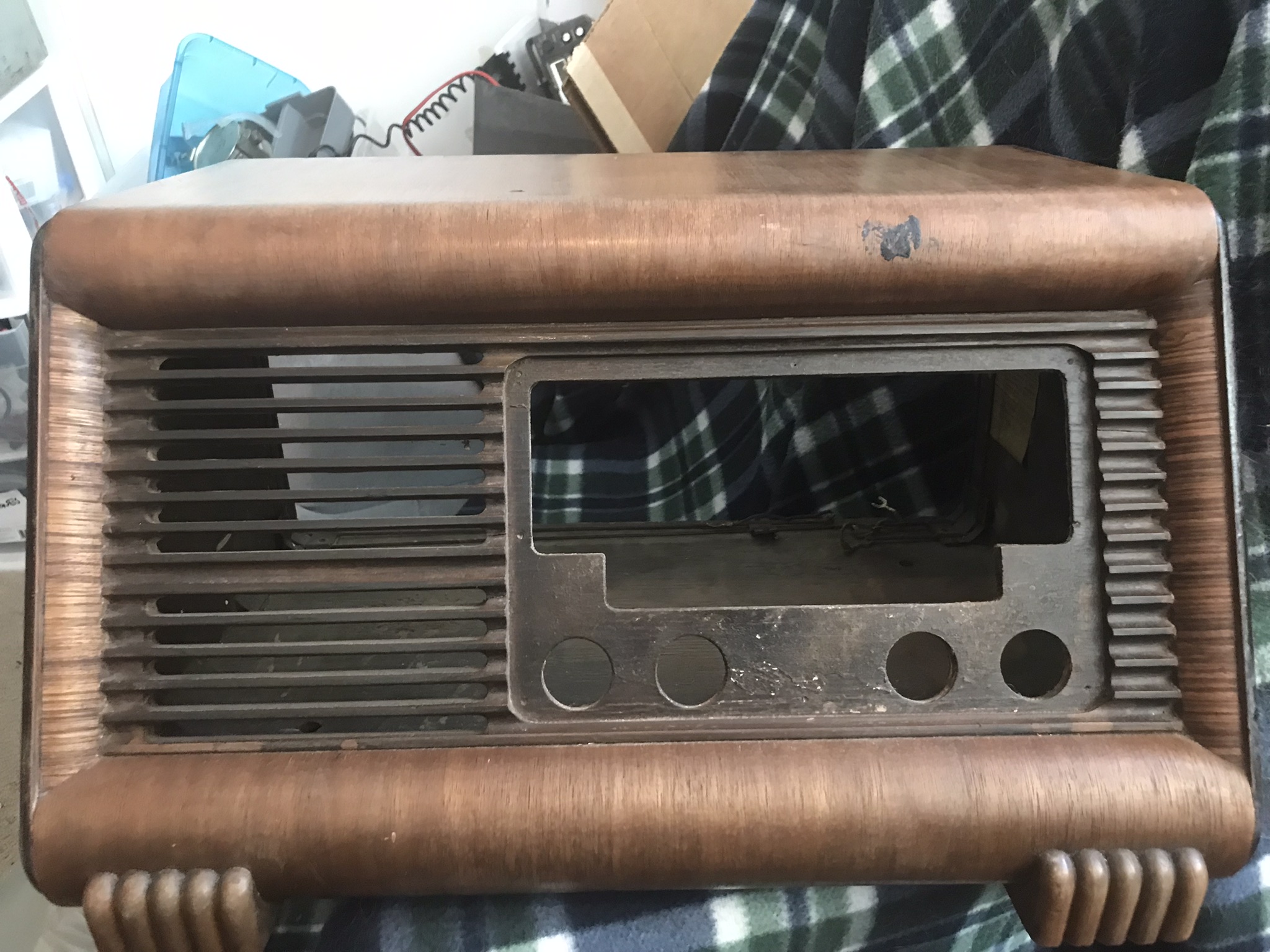

After lots of grief this is done except for putting in the call letter tabs. I have those. Thanks all - and now onto the next.
Before and after
#67
Before and after
#68
Very fine work, like the look. Paul
#69
Repair summary on this - new caps throughout including the bakelight block with Y safety caps, resistors checked and replaced, extensive new wiring including for lights, fuse added, new knobs/knob felts and faceplate, new bulbs, case cleaned and polished, new grille cloth, replaced power cord, switches cleaned with de-oxit, added station tabs circa 1941 Indiana - being a Hoosier-American I had to do that. WSM had to be there for the Opry.
Office Max printed out a whole set of tabs for $3 - don’t buy the $15 set you see online.
Radio checks out fine on all bands although extensive local interference at top band is a problem. I think it pulls about .4 amp at 120 v.
 This is just planned to be my daily driver for AM radio while I work.  This is as good and safe as I can make it. I honestly can’t think of anything else I could do with this except a full alignment - maybe this winter after I fix my signal generator.
