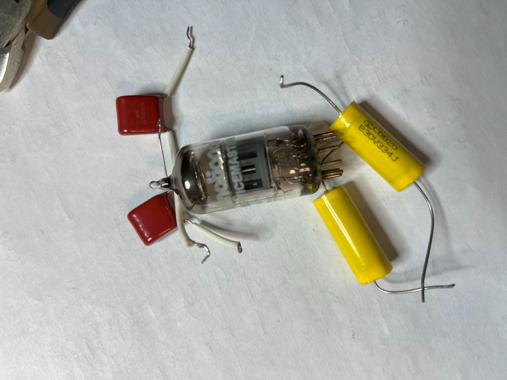

Ok, so just why? Maybe my coupling caps. I tried some generic yellow .33 caps that came with a kit. I wasn't super pleased with the brown drop caps I had in there previously, so I tried those. So, I'll try something else. Maybe some of those highly sought after leaky bumble bees  I'll also use some socket adapters and check voltages so I can see if the new sockets are working. Voltages at the pins check ok. May be time to break out the scope again. It'd be great for a guitar player - just the right distortion, but for HiFi - not so much.

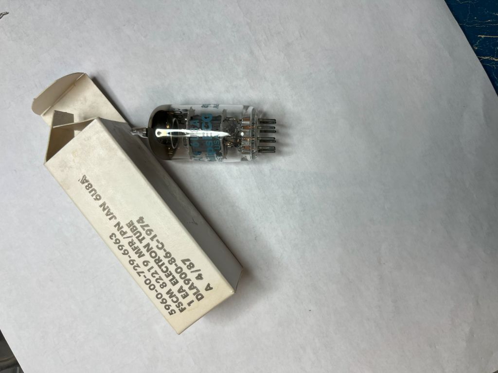

Well, found muh culprit. After using socket test adapters and finding voltages all ok, swapping 6V6s, no avail, swapped the 6GH8a with a good Phillips 6U8a and bingo! Clean as can be! Junk Jap made 6GH8 tubes! Well, I kinda think they may all be junk. Anyway, the couplers are fine. It hadn't been sounding very good and with one output tube having to be flipped or moved to get it to light up, figured the sockets were the main problem. Wrong! Stupid tube failed! Same with the china made ones. Don't last. That said, I'd observed some weird effects putting my meter/oscilloscope probes on the lower 6V6 G1 (cathode side of the phaser), so I swapped in a 10k stopper (left the 1K on the other tube) and that stopped the weird effects/oscillations. Read that needed to be done on some circuits using the 6U8/6GH8 driver instead of 7199 in AK. Well, must be something to that since it seemed necessary in this adaptation. I can elaborate if anyone would like the reason for this.

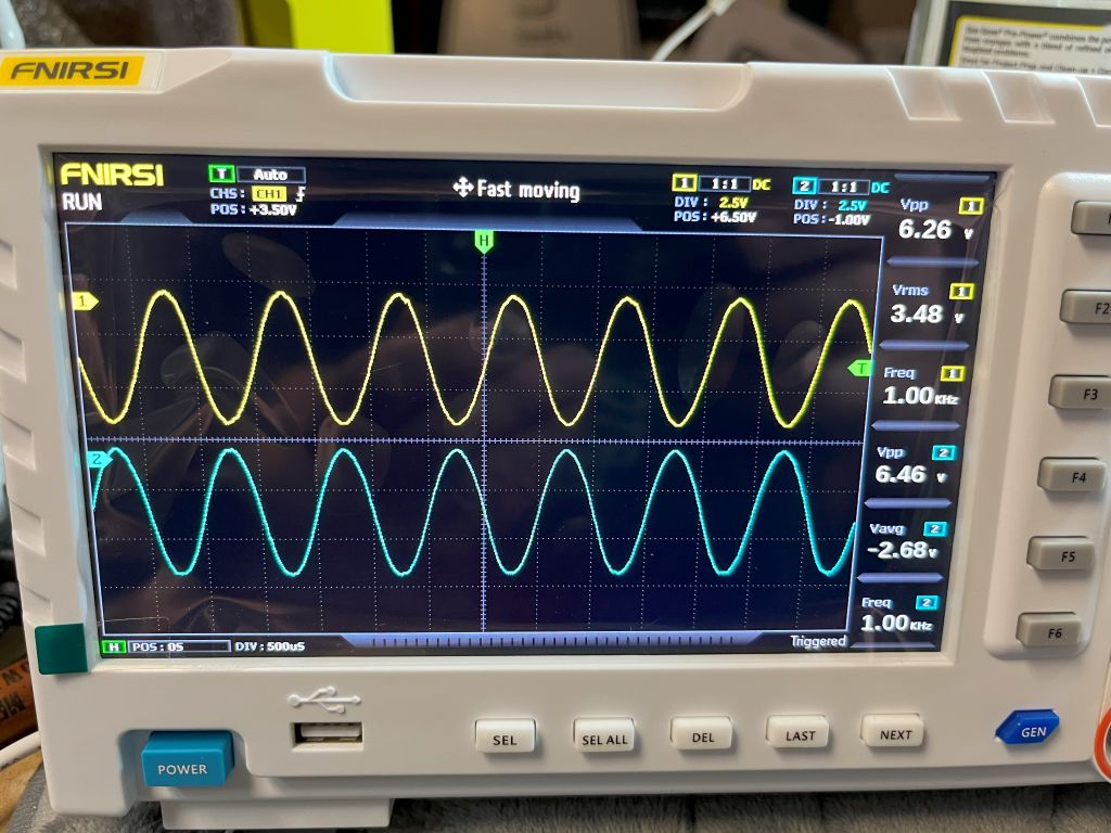

OK, I've done some more tweaks and experiments and learned some more. I found that those .33 uf coupling caps from a kit are junk! I replaced them with some IC (Illinois) caps from AES and it really woke it up. I went back to 1k stoppers after some signal checks. Below is a pic of the drive to the 6V6 grids just before it distorts. This is using the 6U8a driver. It is really cleaning up and sounding much better and putting out power very close to the 1st build. I couldn't get the same coupler caps for this build as the 1st so I tried some brown dips. Nope - go with the tubulars. I'm still tweaking so stay tuned.
Signal from 6U8a
Junk parts! Well, the dips might be ok for something else, just weak couplers.

What exactly did the caps do to the signal (I see some blimps at the tops on the yellow trace, but there is something also at the bottoms of the blue one).
And the brown dips - are they also junk or do you hear something, or does the scope shows something?
I am not sure I can understand how a cap, (if it is a cap and not some Chinese housewife buying some aluminum foil wrap in a supermarket and then twisting wires to it's product), can do something like it. At some frequencies there are resonances, anti-resonances etc, but those are not exactly audio frequencies. And the losses etc, unless they are egregious, shouldn't do this either.
I'd like to hear about your findings.

In my 1st build of the same project I used couplers that I got from AES - some white ones, and that amp sounded pretty good. The 2nd one has been difficult from the start. For some reason I only ordered 2 of the white caps to "try", then couldn't get more when I tried to order, so I stuck the yellow caps in that came with the kit - generic China ones. Thought cap was cap. Noope! I had all sorts of weird problems and didn't sound that great either. I ordered those brown ones, thinking they were like Orange drops from AES, but still 'lacked something' in sound quality. I don't have any scope comparisons, but I ordered IC caps from AES for my EL34 builds and tried those and - yes, there was a difference. Much cleaner more transparent sound. So, there is a difference and I can sense it. Worth going out and buying $100 x2 caps? Naaaah! But def something quality like Solen, Sprague or IC. And value matters too, go too big and they sound muddy, too small and they sound tinny and lack bass. Seems .1 to .25 is about right.
It's kinda weird how things work out sometimes, I just threw my 1st amp together doing about what seemed right at the time figuring I'd end up redoing about half or all of it for tweaks and changes. That one worked flawlessly! Aside from a few tube swaps, I haven't done anything to it. The 2nd amp I revised and neated up. Figured I'd redo the 1st the same way. Yes, it looks much neater - but I've had that thing apart and together more times than I care to mention, changing everything from caps to tube sockets! I finally did get it working good, but they still don't sound quite the same. I am going to try some different output trannys and feedback settings.
On the scope reading, I'd found a bad NOS 6GH8a tube that was also causing weirdness, so I switched to a JAN 6U8a and that solved a lot of oscillations and intermittent stuff going on. Honestly, once I learn a little more about my scope and how things interact, I can do some tweaking in the driver stage to improve. I also have a new signal gen since that above post which helps.
One thing I noted that might or might not be contributing to the weirdness is the power transformers. I ordered the kits at different times, and while the specs are the same on both transformers, the 2nd trans has slightly lower voltage out, by about 10-15v B+ I recall. As a result, I cannot get quite the same power output from both amps, the 1st is 15w and the 2nd is 14w. Anyway, I'm no super expert and cannot go into theory like some of those guys over at AK, but I can cut and paste, tweak and usually get something sounding about right. Anyway, stay tuned. I am still learning.
