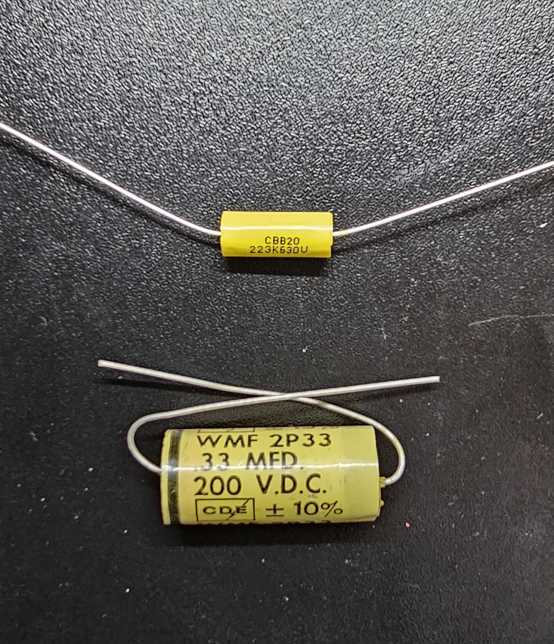

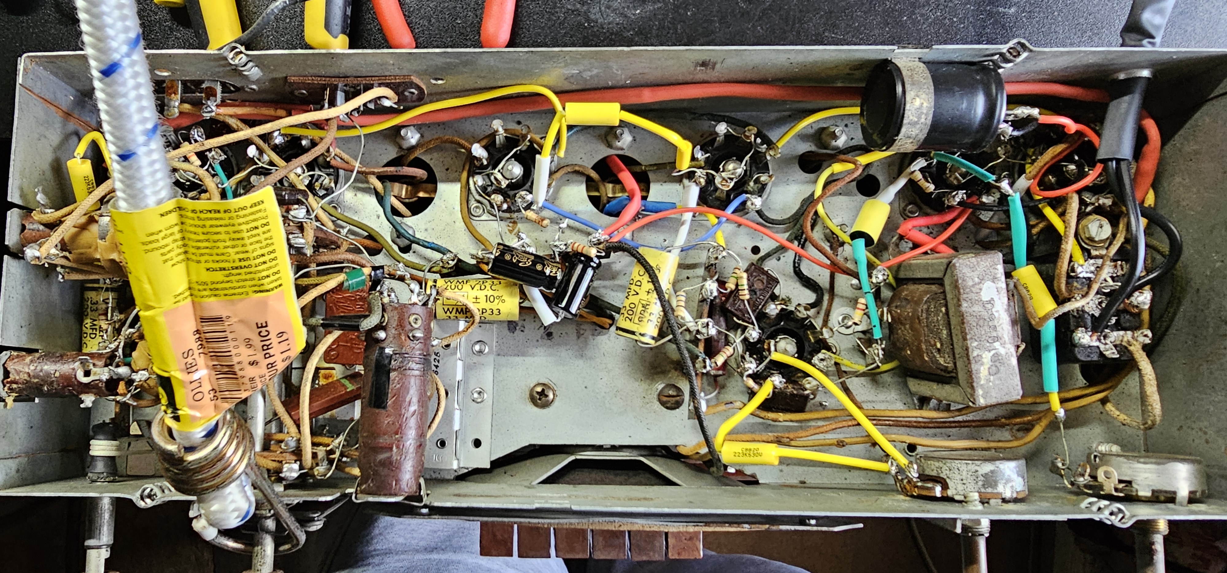

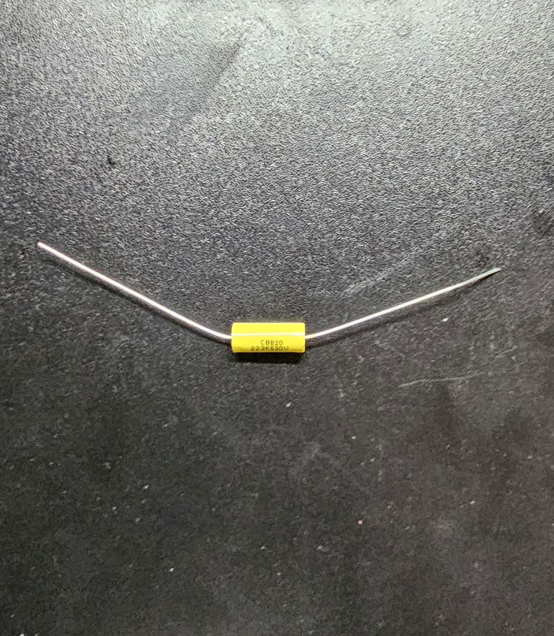

Now for an update film capacitors arrived and installed, all 630Volts. After installing and trying the radio I realized that with the wrong type caps and the polarity issues I wasn't getting any feedback from the tone or volume controls. Now I have feedback along with static from the reception and hopefully no smoke or popping. Back to more testing to see if I can get it to pickup any stations as when I first started.
I sure hope these 630V capacitors are ok, they look so small compared to the 200Volts I purchased.

Oh yes I did use the 200's in place of the 200Volt ones to be replaced the smaller one's are 630volts 0.22 mfd which were listed saying that they are good for radios. I just posted a picture showing the difference in size. Please tell me that the 630's will work, so far the radio has powered on and I finally was able to pull in a radio station.
I was skeptical about the size of them when received and would be glad to order another type if needed.

The 630v caps will do just fine. Physical size increases with capacity values and voltage. You don't have to replace 200 volt caps with 200 volt caps. The replacement can be 200 or more. The voltage rating of a cap is the capacitors' maximum operating voltage. Quite often you will find the 630v version is cheaper.
Your antenna is, in essence, an rf transformer, with the primary capable of being connected to a long wire aerial. The secondary connects the signals to the input of the first tube.

The thrill is gone again, thought I was close to being done with it. Well Friday it was receiving broadcast, Saturday morning the same. My final check before inserting the Chassis I turn the band selector knob to see if any of the other bands worked and nothing so back to regular broadcast. Now can't receive any broadcast at all, only static. I have tried moving the antenna wire around and no change. I've done nothing but turned the band selector. I've checked the selector to see if it may be shorted because I noticed a slight static at times while turning the knob.
Does anyone have any idea of what I can check?

The band switch selects different oscillator coils for the band selected. I would look for a bad connection in the switch contacts or the oscillator is not operating correctly. When you hear the background hiss and no station it usually indicates that the oscillator quit. You can confirm it with a signal generator tuned to the modulated IF frequency into the antenna. You don't need the oscillator to hear the IF.
