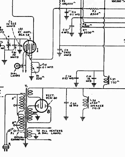

It is interesting phenomenon. Yes, dogbones, 95% I encounter or so, they increase in value over time, from 20-50% to all the way 100-150%.
But.

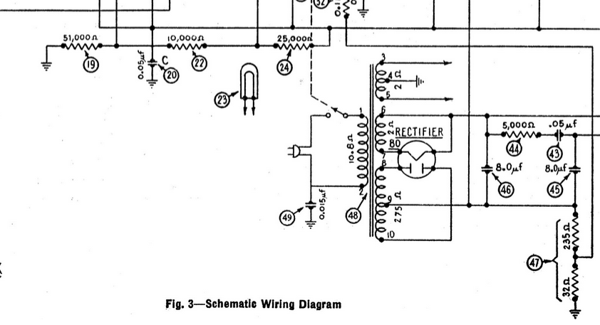

There is that place in some sch, where those are used as the immediate bucking resistors/dividers right after the power supply, and they conduct some significant current. Those are often 1W or 2W larger and large dogbones.
Like these in my RCA140: (R5/6/7) at the top of this picture
Or in Philco 60 (and some other Philcos) R19, 22 and 24.
I have always found these dropping in value, unlike the rest of the resistors within the same radio.

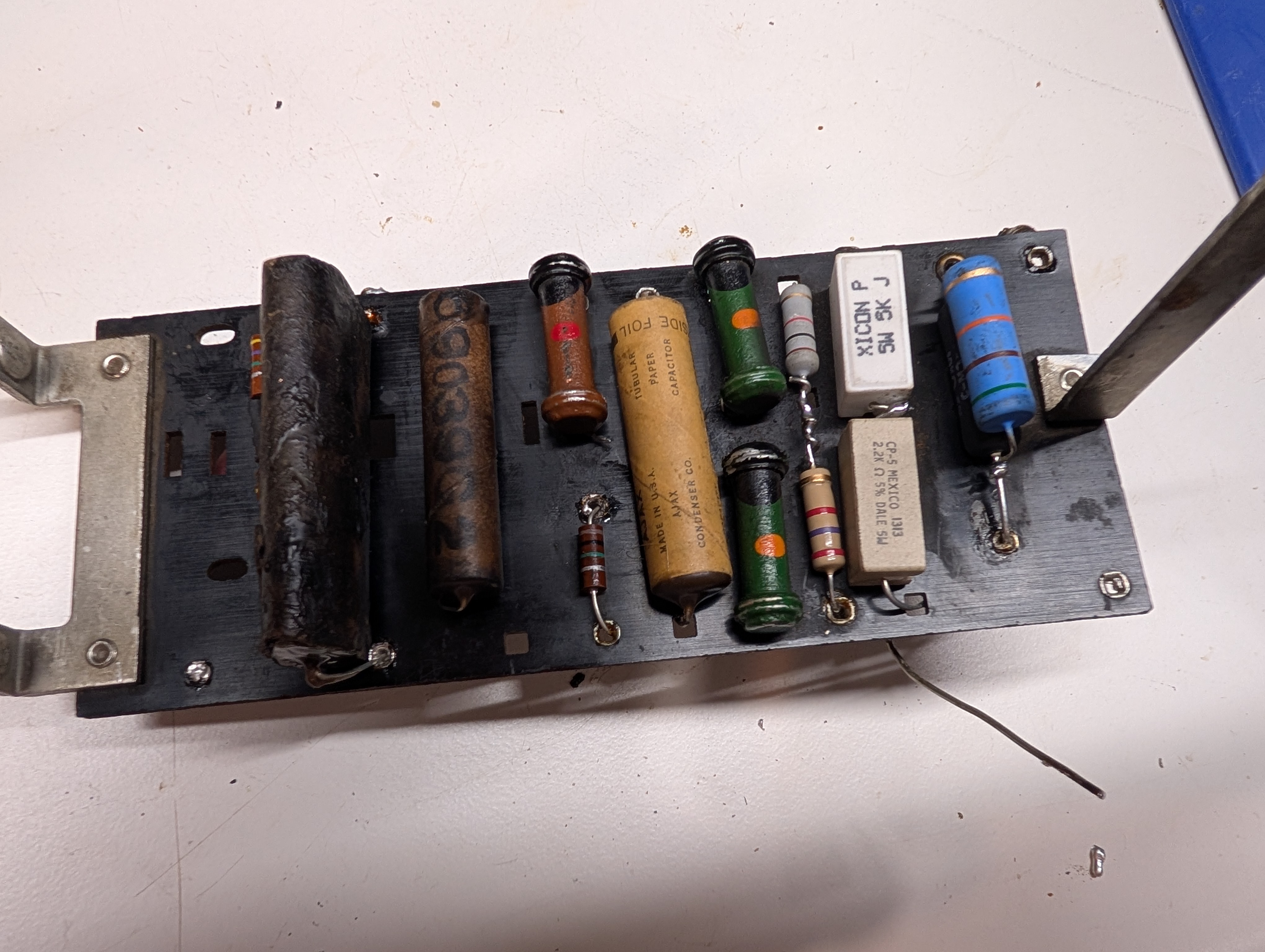

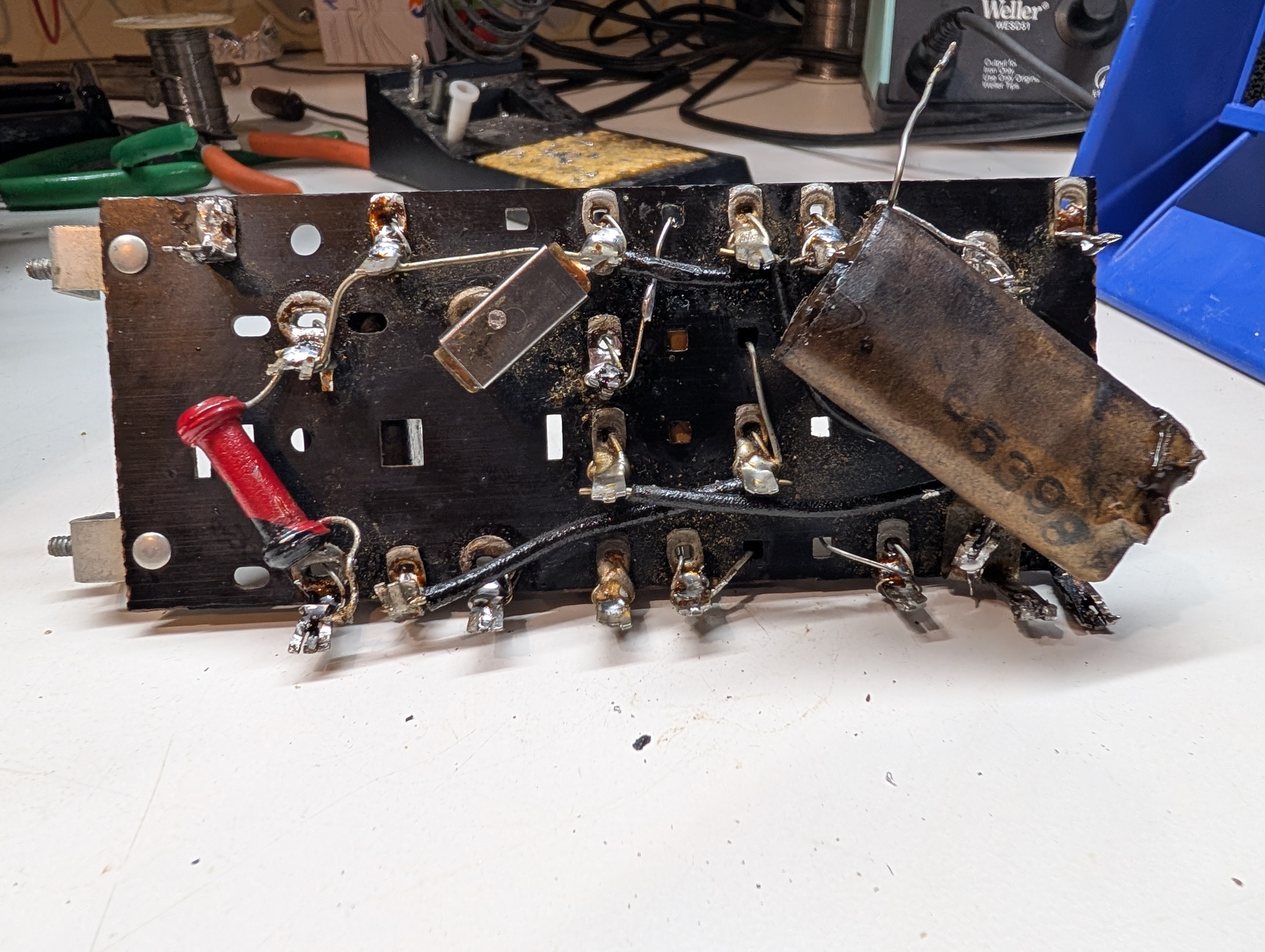

Other than one cap, which will go to outside potentikometer, which I have not put itn for that reasin (will solder it after the board is ready to be re-installed), this is how it looks now:
Top
Bottom

Hello Morzh,
That resistor board looks good !
Now is the time to start clearing and cleaning that mess that I showed before. Then the electrolytic cap restuffing and mulling over what to do about that cap can. Restuff / clip and bypass.

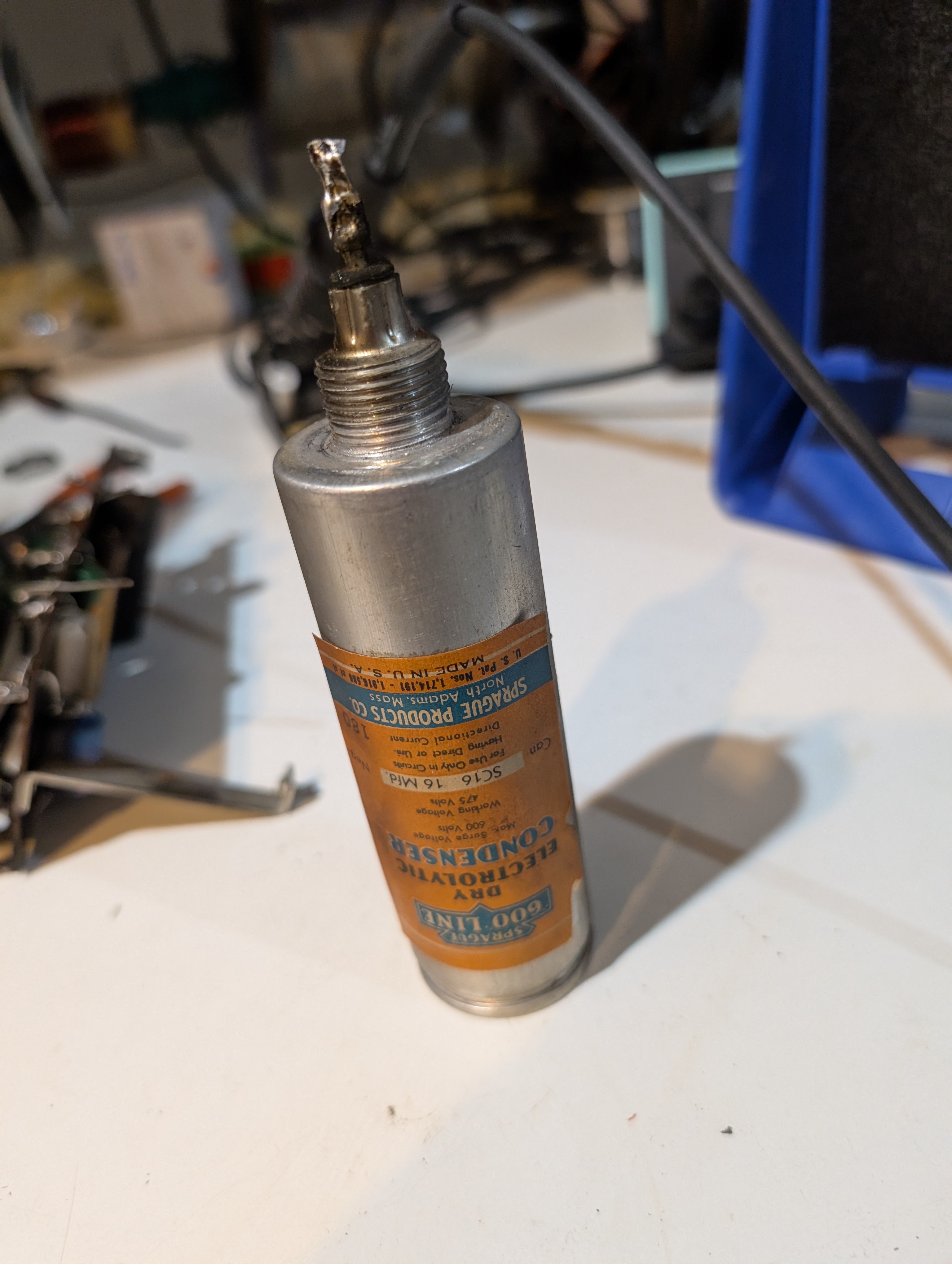

Extracted the main elecxtrolytic cap. Ity is 16uF (10uF in the sch).

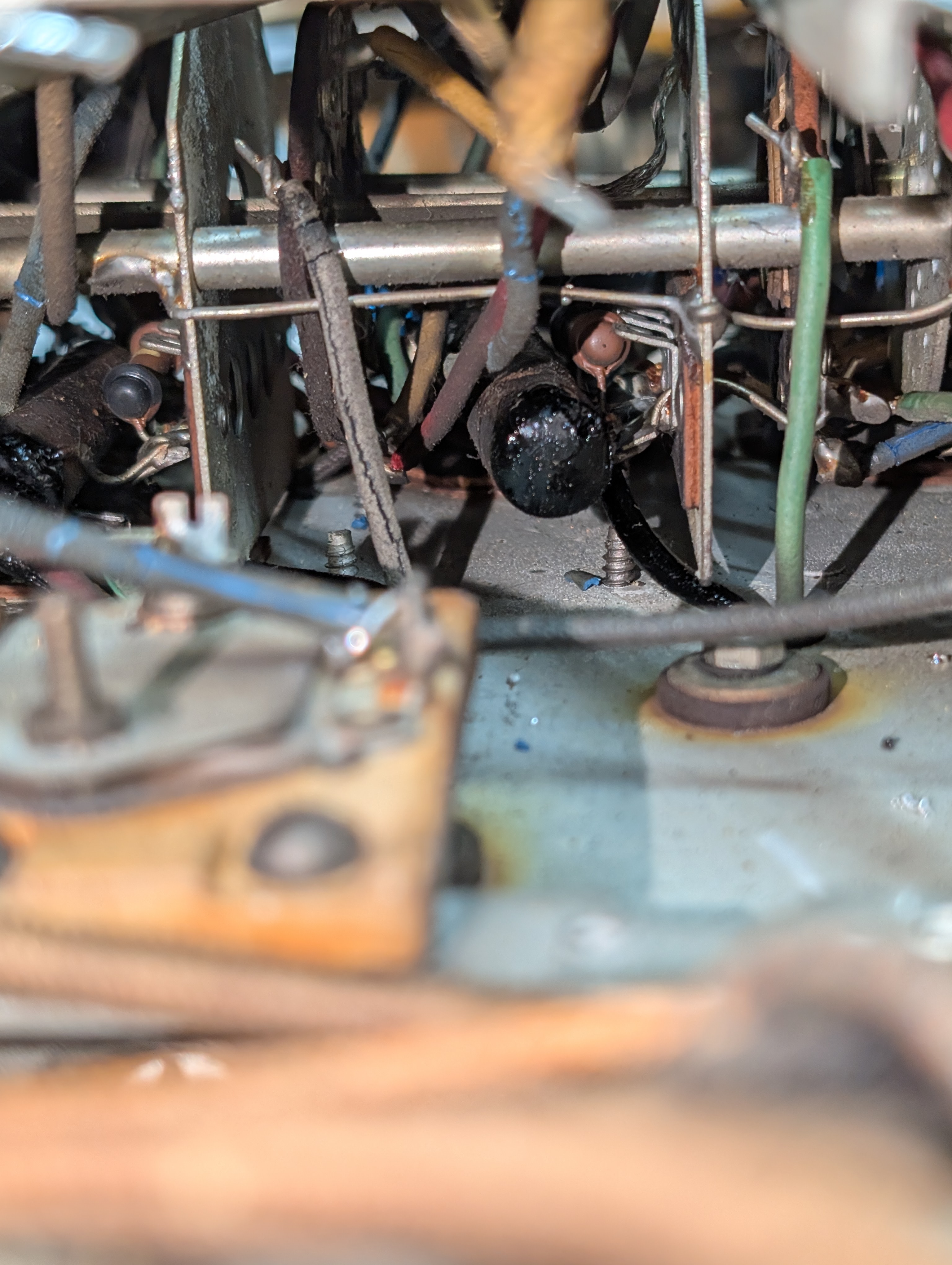

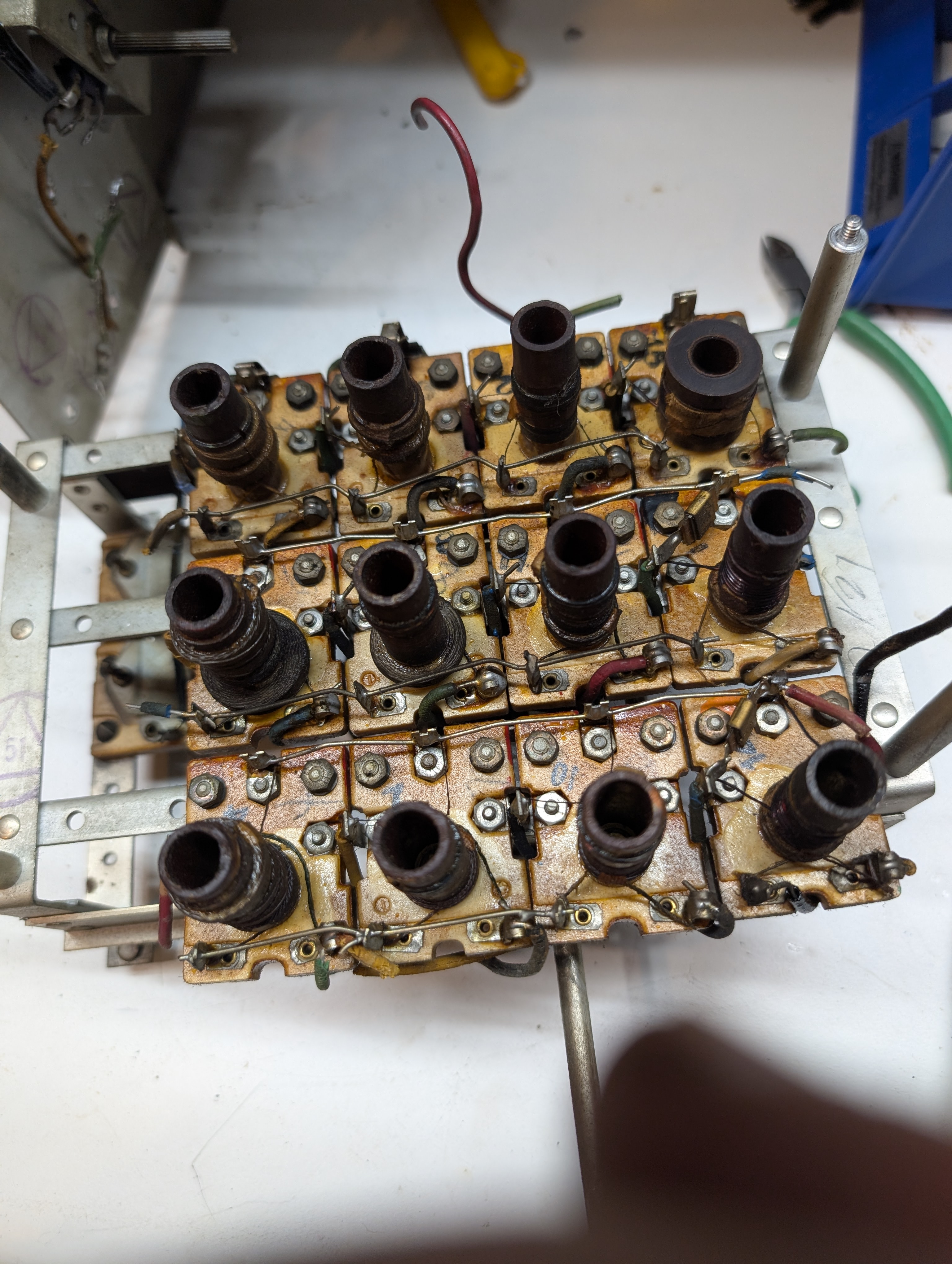

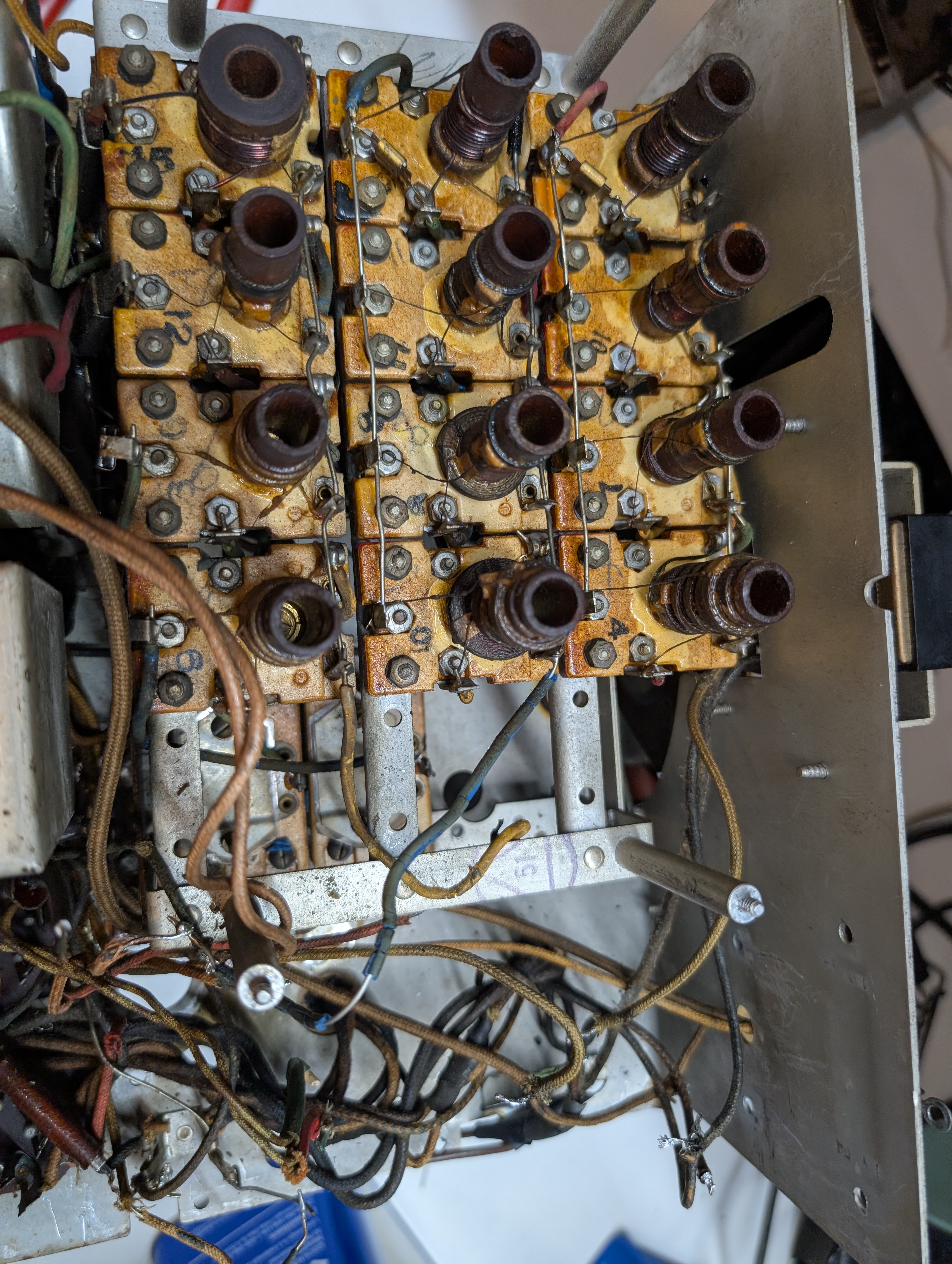

Now, this is the picture of the space under the tuning coils.
There are caps to be replaced.
The access looks like so:
This is the top
And the other side, also with caps underneath (no, not that BB). You could see it right above it.
Gonna be challenging.

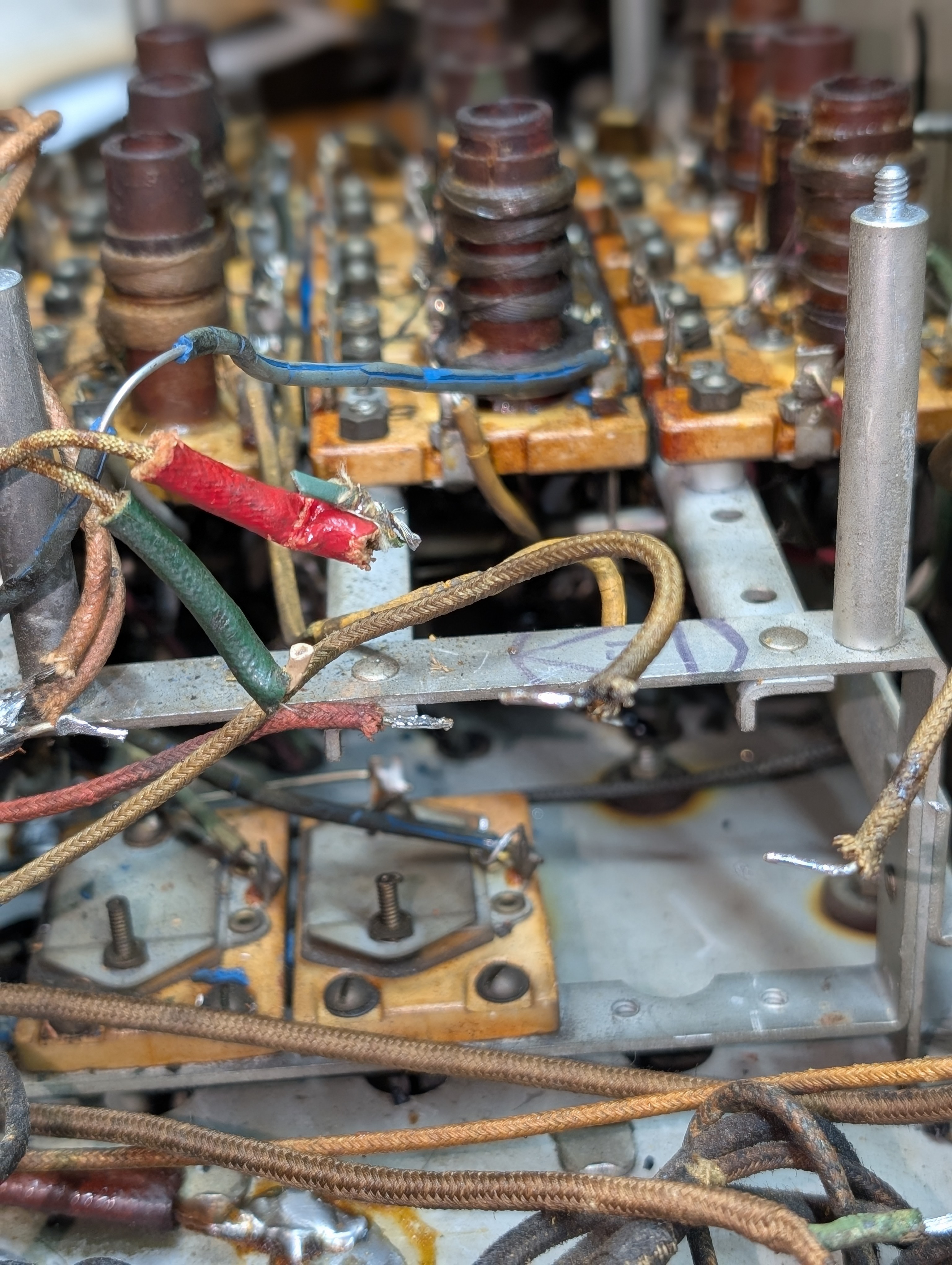

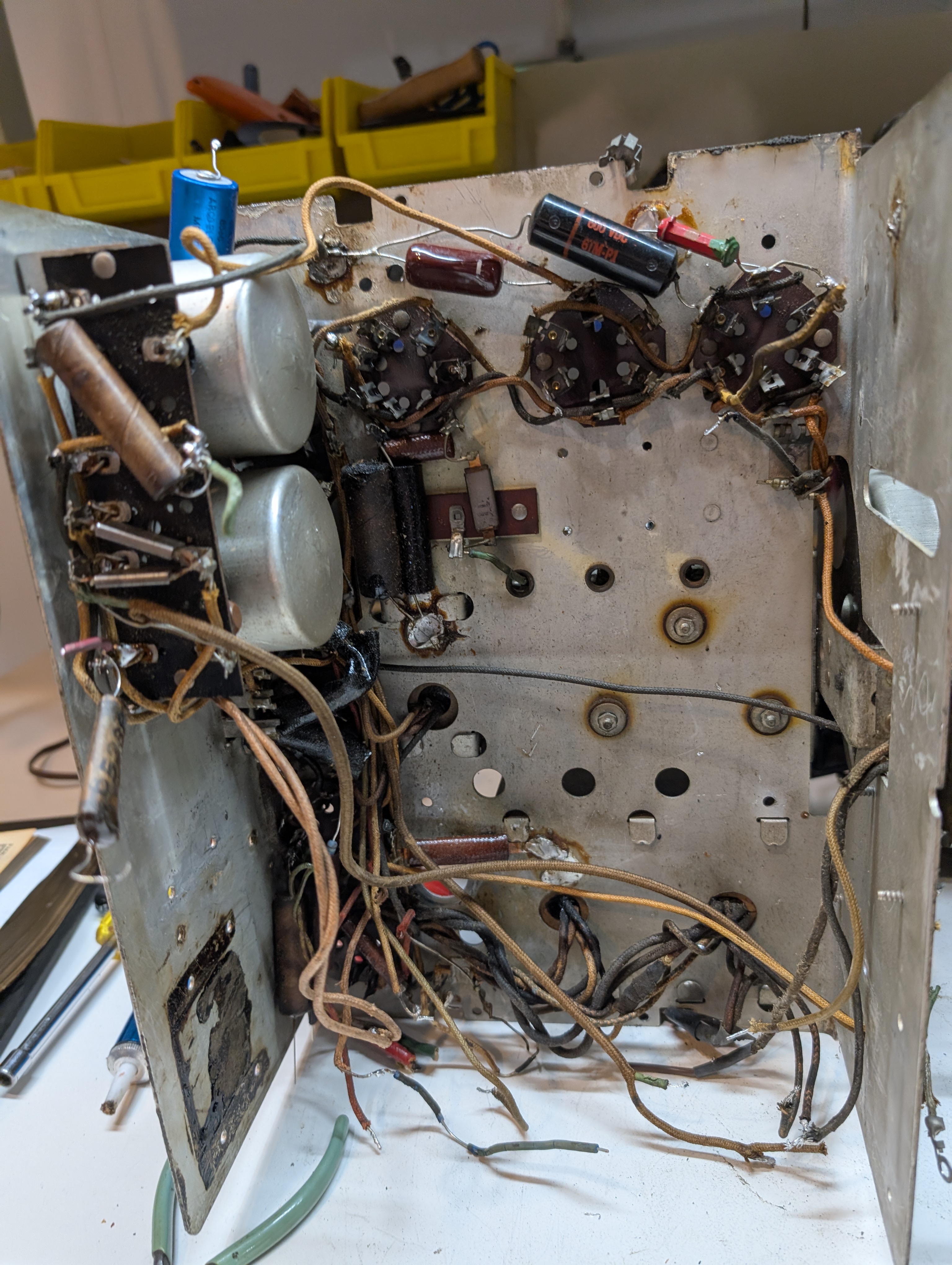

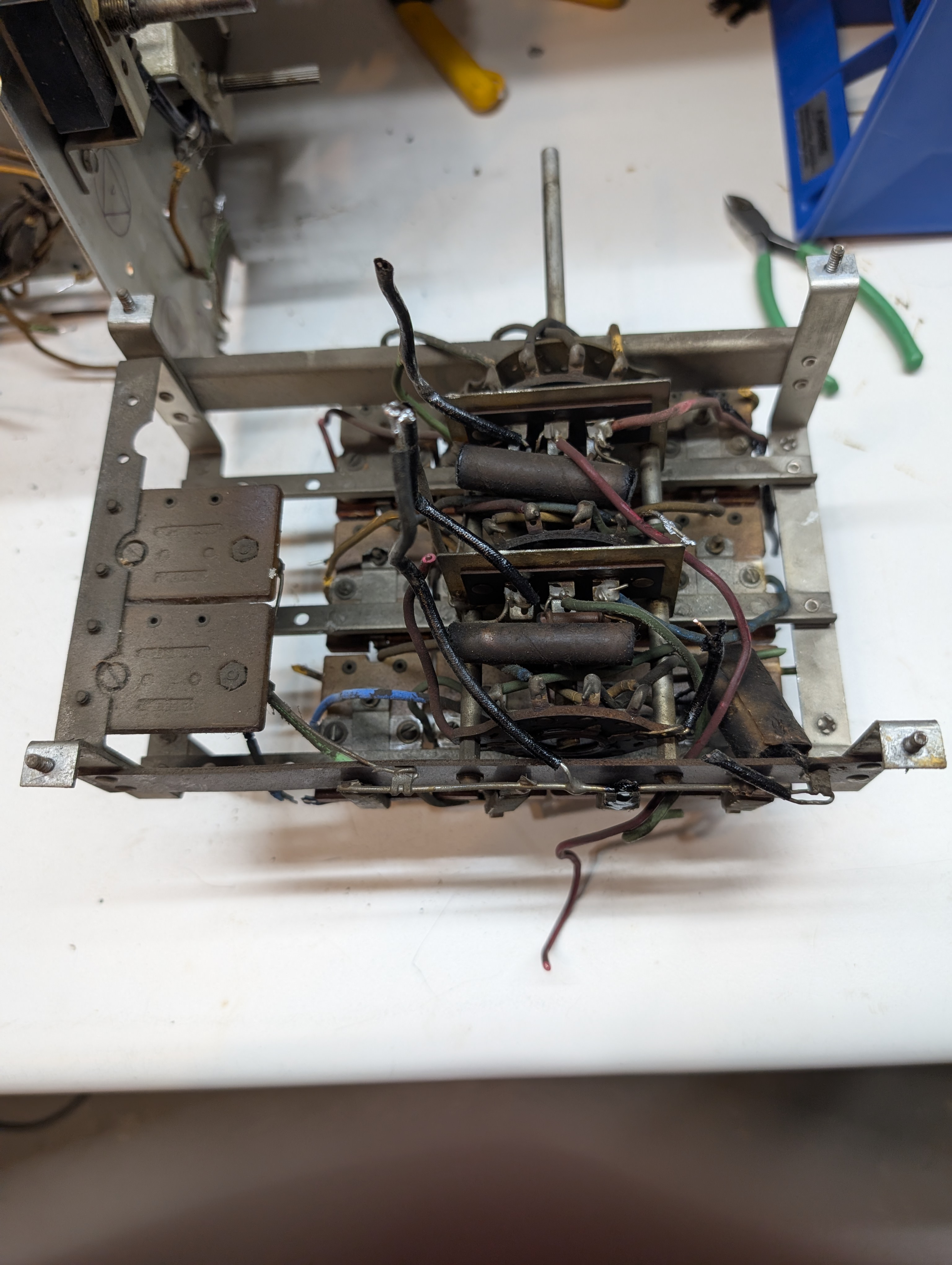

Today I decided it was time to remove that RF assy.
After unscrewing the posts and snipping wires, it was still being held in place, and I almost gave up, but then I calmed down and found things that were holding it (wires to the tubes' panels). Actually not that many. There it is. The assy and what is under it.
Many wires are rubber-insulated, so will have to be replaced. They used a medley of wires, some with rubber insulation and some cloth-covered.
Other than that, I had to remove the interstage transformer and realized one half of the secondary is open (strange, usually it is the primary).
Also I tested the tubes, and 2A7, the pentagrid, the first I tested it, somehow did not even move the needle; then I took it out, checked the filament, gave it the look, and put it back. I worked, but it was SOOO weak, I do not think it is usable. Will have to buy a new one. Actually, might borrow one from the other two radios.
The rest of the tubes all test strong to very strong.
Also I desoldered/clipped everything going to the tuner cap. It is very dirty and needs to be washed.
So far this is it.
