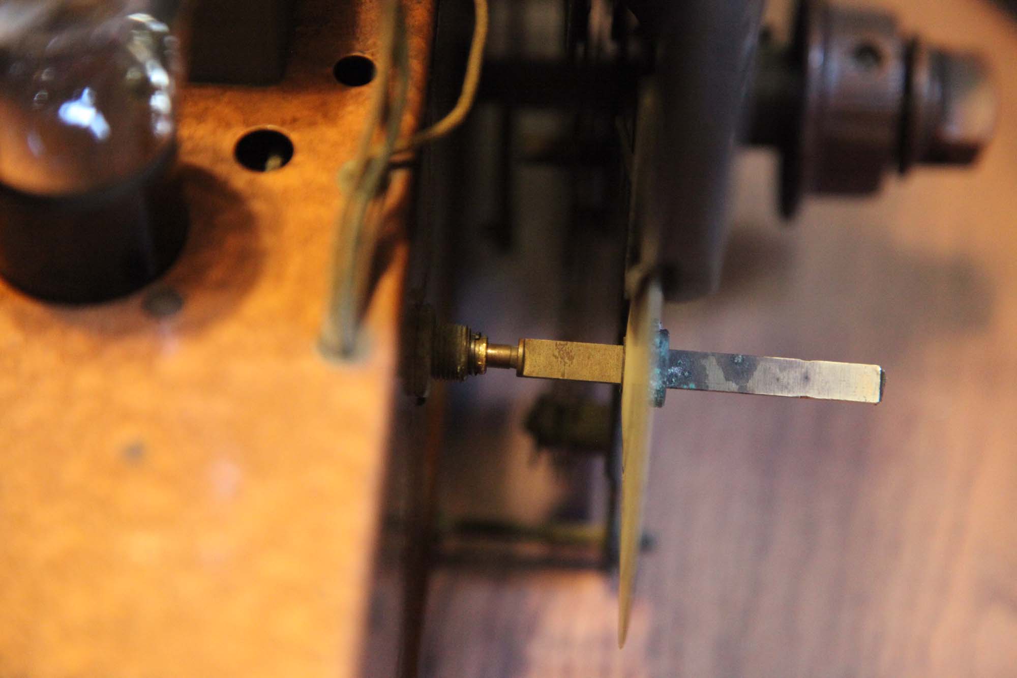

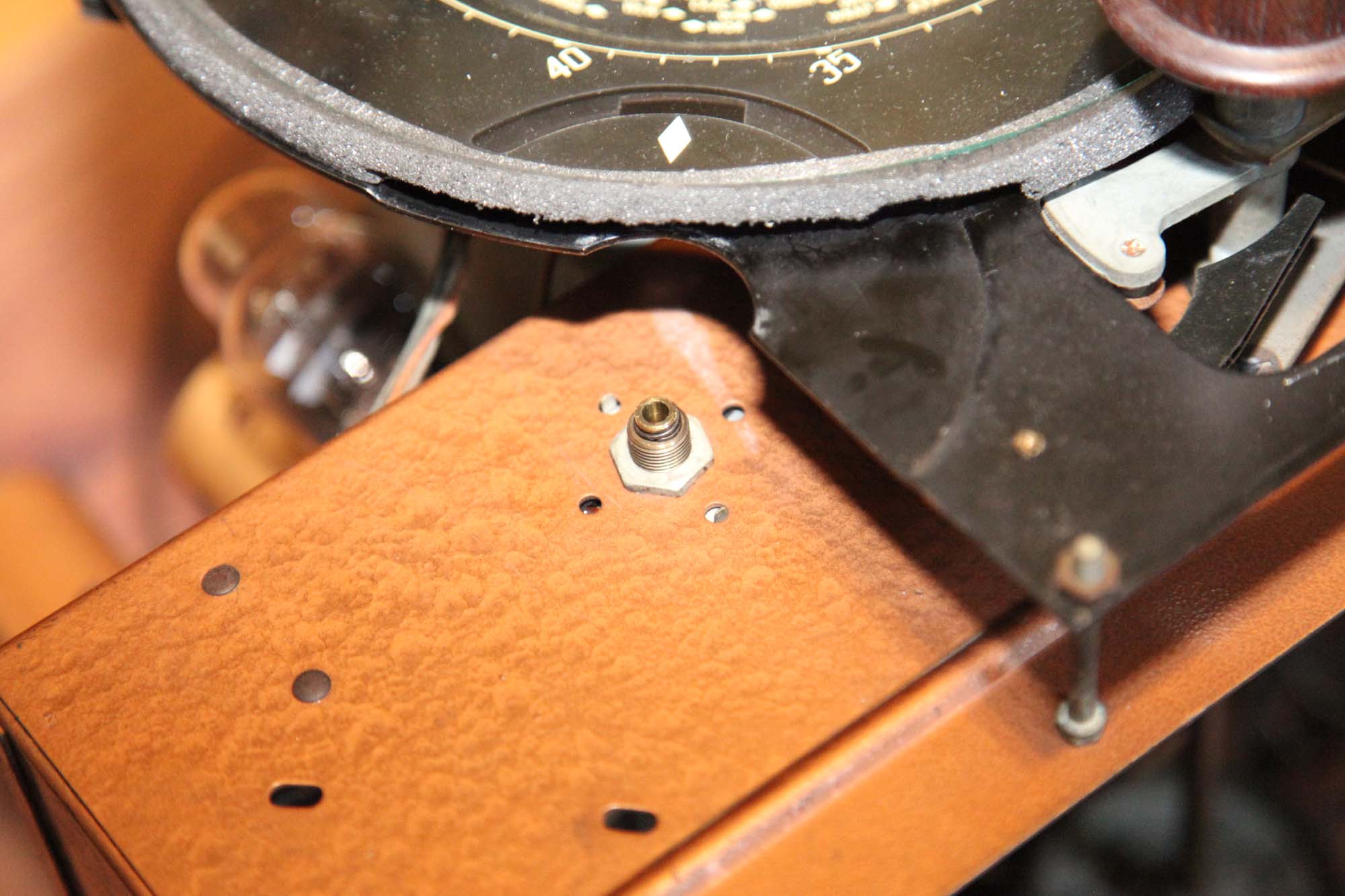

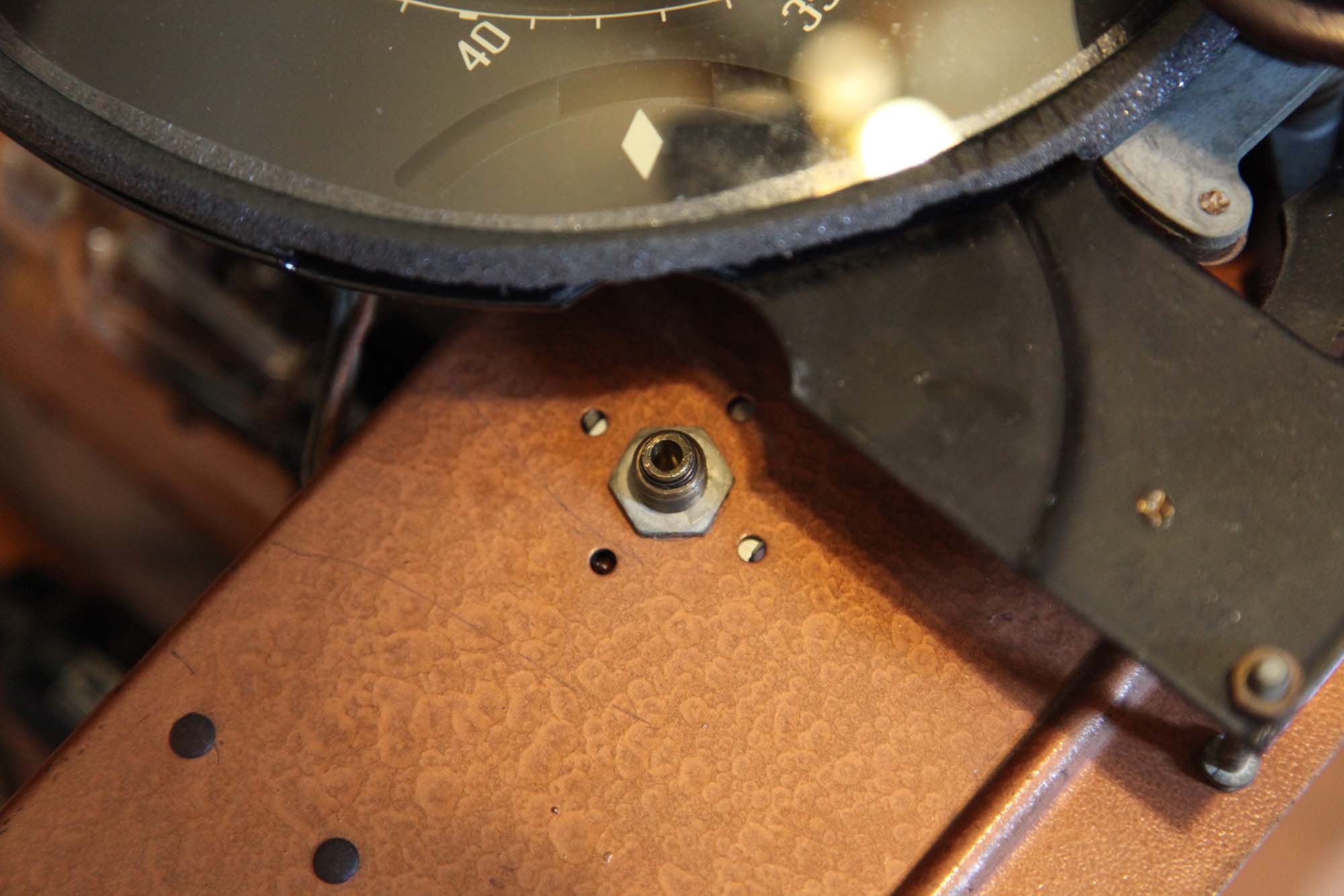

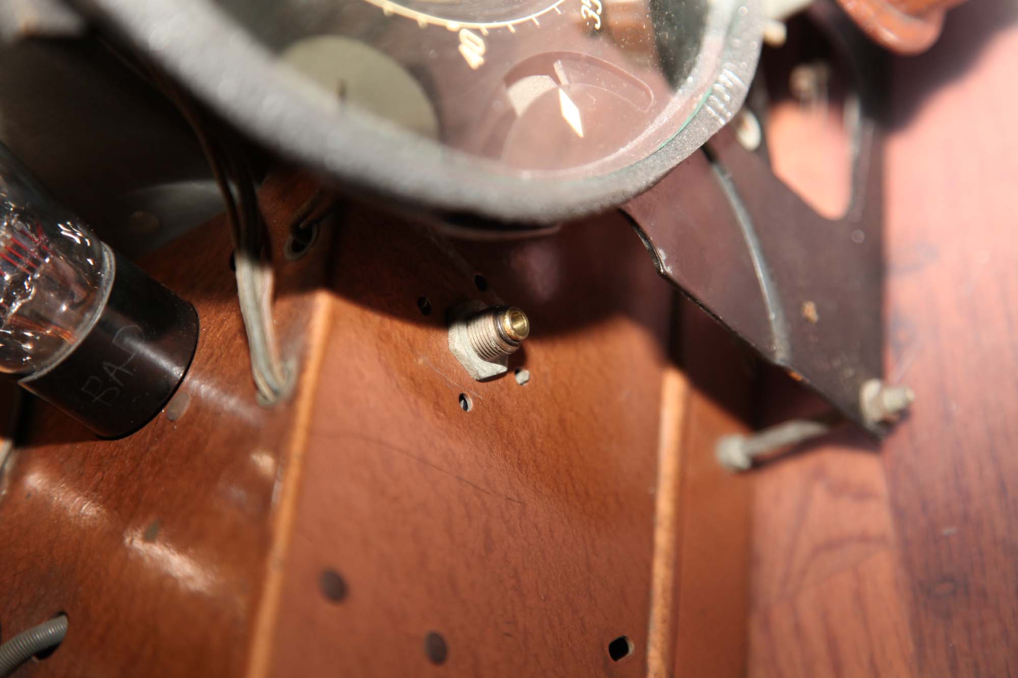

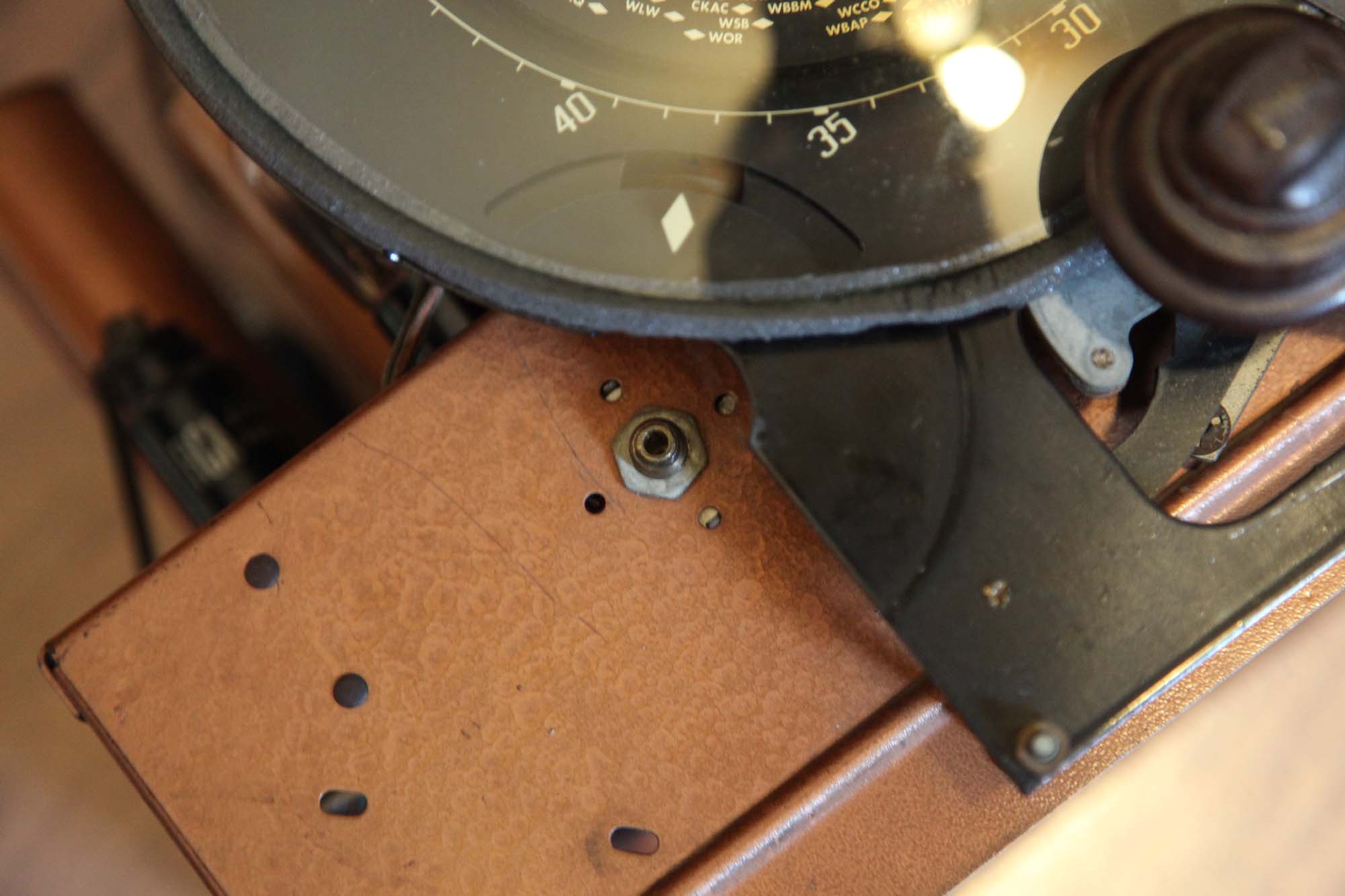

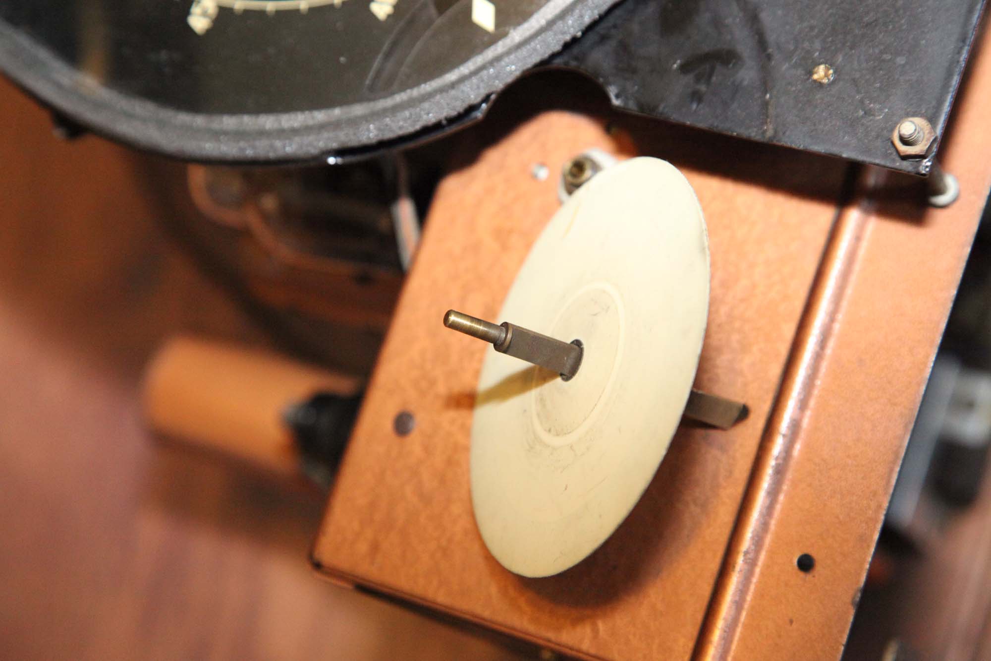

Actually, I have a question.
On this radio of mine the volume regulator has the removable shaft that is inserted iside the pot, but i not in any way secured, so it only works when I press upon it to provide friction. It freely comes out, and the actual shaft is a short barrel, protruding above the threaded part (that goes through the chassis) by a couple of millimeters. It has a deep axial hole in it where the removable part goes.
I am not sure how it is supposed to be, mybe it is glued or something.
Does anyone know?

I see that the shaft is different than mine in the pics. The pot is exactly the same. The shaft should be just like the on/off switch, solid and attached to the pot.
Maybe someone repaired a broken shaft?

That's a replacement switch with a universal wedge fit shaft. Once the shaft is cut to the correct length and aligned rotationally you just tap the end of the shaft and it will wedge fast into the stub on the switch.
Larry

thanks. I tapped it some, it seems to grip after that, though I am not sure how it does it.
I expect it should be a bit conical to do this (is this what's called the "wedge" here); maybe it is, just not too noticeable. Then it should do it by sheer friction, correct?
(It's not a switch though, it's a pot).

Switch or pot, machs nix. Yes, it's slightly tapered so tapping it in wedges the taper into the stub. Very common with replacements. It allowed servicemen to stock less controls to cover more radios. For instance, there might be 7 different radios that all use the same control but with different shafts, short, medium, long, 1/4 round, 1/2 round, split, fluted, etc. Rather than having to stock 7 different controls he could stock one control and a selection of shafts. Now multiply that by all the different controls, vol (with or without power), tone, power, etc and you can see how much less controls were need to cover the same number of radios. Plus, if a customer broke a shaft he didn't have to replace the whole control, just the shaft.
Larry
