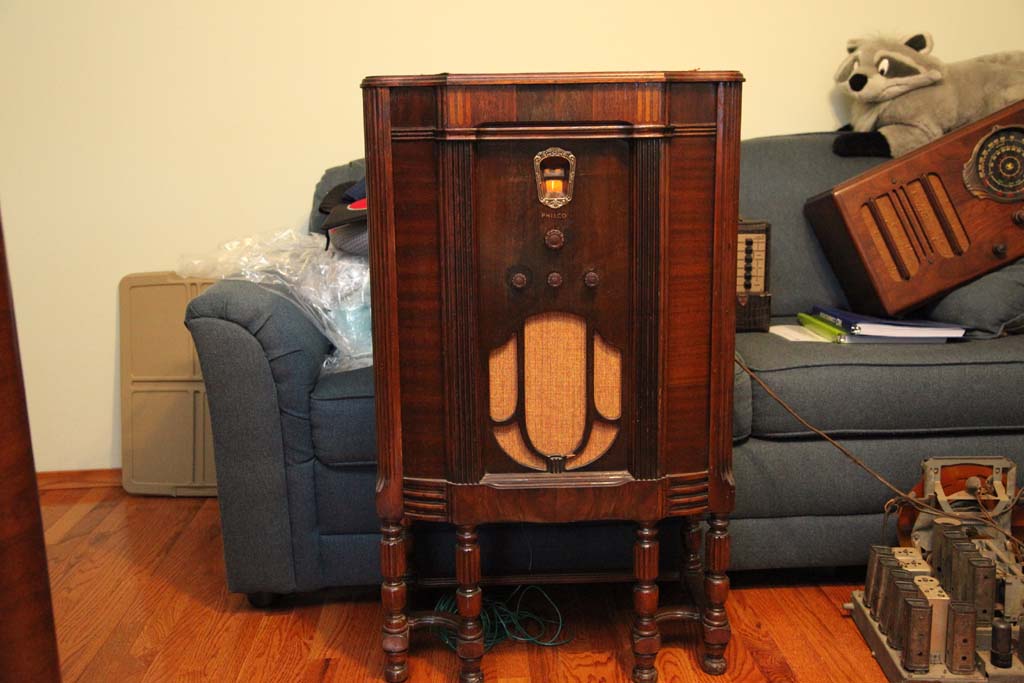

Here are the photos.
Again, the cabinet has not been touched. Yet.

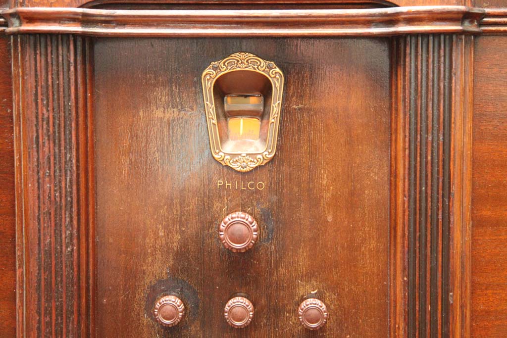

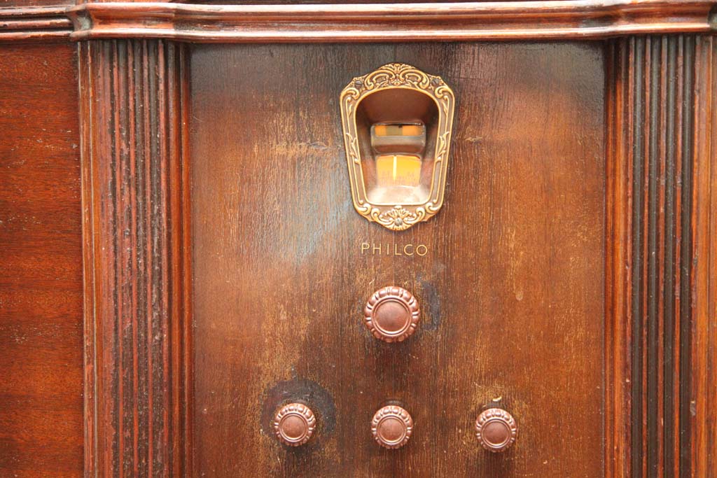

Also I suspect the chassis sits a little skewed, judging by the location of the centerline on the dial and the shadograph's shadow. Not sure why - thought the screws would straighten it automatically, but...OK I will try to adjust it. Icon_smile
Assembled.
Shadograph when tuned.
Shadograph when out of tuning.
#63
Mortz, that looks really nice! Are the lower knobs shafts centered the the cabinet holes? If so, perhaps the tuner mounts can be adjusted slightly to center the dial scale a little? As for the shadow meter, a slight bending of the bracket to move the bulb horizontally will center beam.

I tried everything, and every trial is taking it out and then centering it.....First of the dial is too close to the escutcheon and sometimes I can hear it rub against it.....so I tried to move the dial a bit in (had to remember the position....tightening that screw is a RPITB, the dial moves every time) and then it would get stuck around 1400, so had to move it back.
The tuning cap is mounted on grommets so not much adjustment there, alas.
And yes, the shadow meter can be bent a bit but I am so much afraid to break something.....I adjusted it just a tad, and for shadometer that's enough, when it tunes in the shadow is practically in the middle, but the lighted slit for the dial is a bit off.
Also could be something due to the grommets the chassis is mounted on, one of them is oversized and does not allow much skewing teh chassis, although this did not help much in the first place, so....
I decided "best is enemy of good'nuff" and am gonna live it for now. It looks just fine and works great. And even without alignment the 1160 station is at 1160. Icon_smile

Looking at the photo of the escutcheon and dial, it looks like the dial and bright reference line are in the right position ,but the escutcheon is shifted to the right by about 4 or 5 mm. I wonder if someone remounted it on that position? I guess it would be easy enough to remove the 3 escutcheon mounting screws and see if it could be repositioned in the correct location.
#68
Judging by the position of the tuning knob, it itself is about 2mm off to the left. Which is about how much the dial slit is off. So I think the escutcheon is OK, it is the chassis that is de-centered. Somehow I am not sure why. Could be that one grommet tat is wider and does not allow to shift the chassis to the right a bit more.
#69
Morzh, are the lower knobs centered in their holes? If so I don't think your tuning capacitor is setting level with the chassis. If they too are off, you need to level the chassis. A picture like the last posted taken straight on with the knobs off would be instructive.
Jerry
#70
Jerry
As I noted right before your post I think (I looked from above) the shafts of the tuning cap is off center by about 2mm. Not sure why. Cannot move the chassis much. Maybe that one grommet that is wider than others (I inherited all 4).
#71
Quick and easy test Mortz, take and loosen the chassis mount screws on the left side of the radio (looking from the front) and slip a wedge of some type under that side from the back to essentially raise that side. Should not have to be raised more than perhaps 1/2 mm as the shift in location of the dial will be magnified by it's height above the chassis. Set it where your dial is centered. If all looks good, you will need to shim up the chassis grommets on that side a tad. This is where the really soft compliant chassis grommets are nice as they have a wide range of compression and you can "dial" chassis placement through adjusting the tension on them.
This should also help with your shadow meter alignment.
Jerry
#72
To my eyes it looks like the chassis just needs to be shifted over a bit horizonatally, as the big tuning knob is also off to one side with regard to the escutcheon, and it is in line vertically with the control below it (bandswitch?) and the indicator. I think if it were a case of the chassis washers being taller on one side then the bottom controls would be cocked over at an angle somewhat.
#73
I agree with your idea as well Aaron. The real answer to the problem is to see how the lower three shafts align with the holes in the cabinet with the knobs off. If they are 2-3mm off center laterally it is a case of moving the chassis if not, a slight raising of one side should do it.
