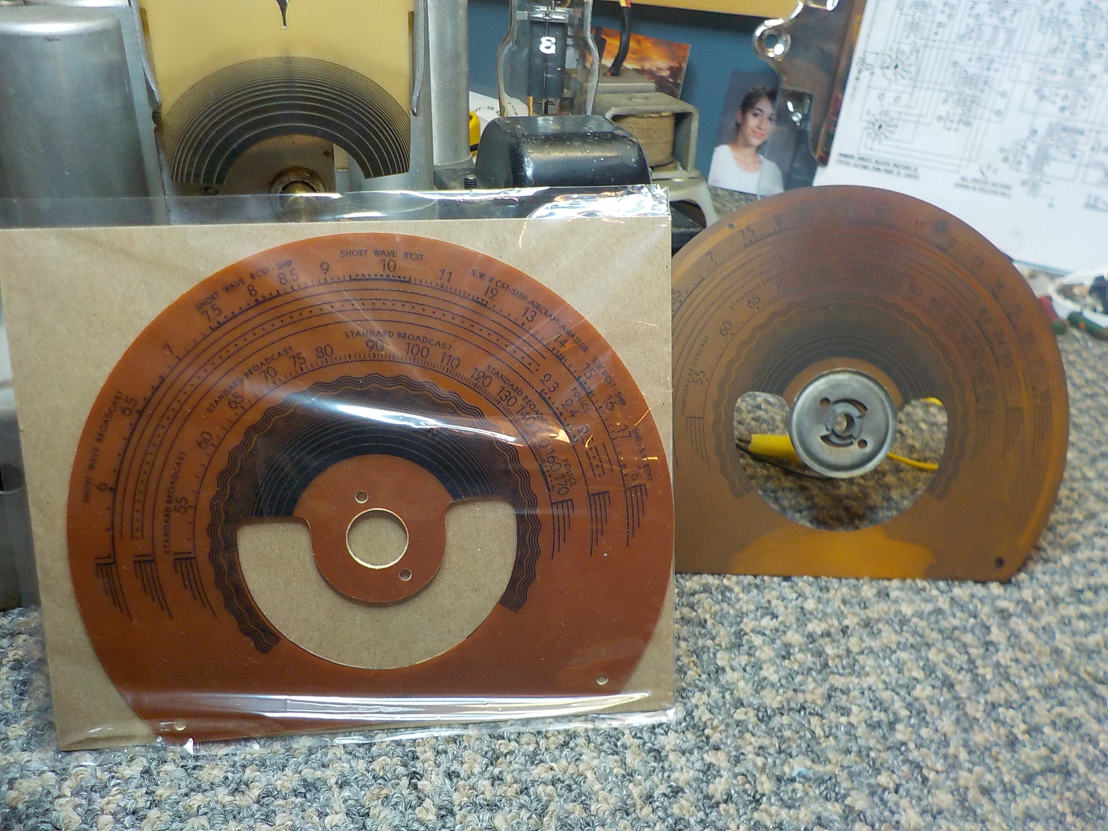

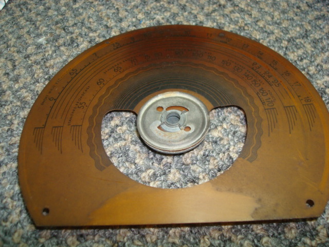

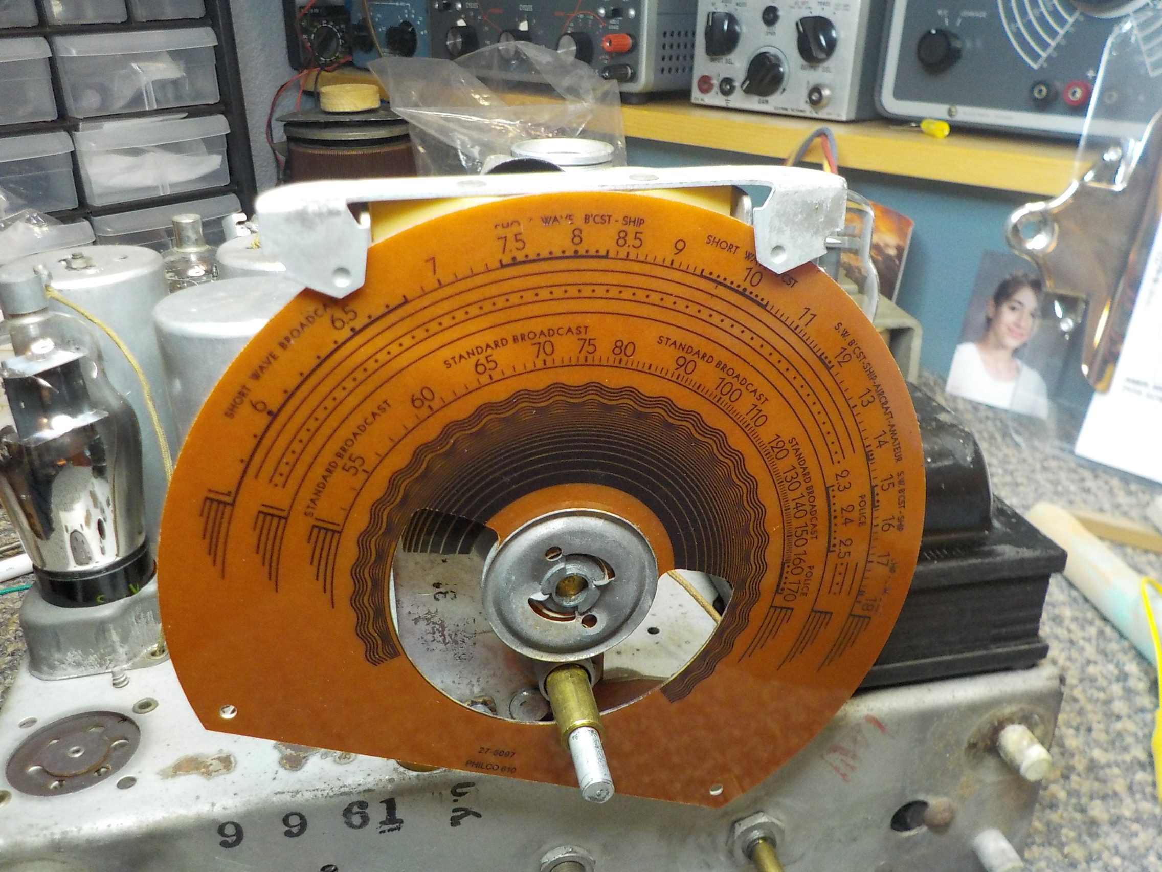

I decided the original dial needed replaced and found a very nice repro from Radio Daze. I had to slightly enlarge the locating holes with a 5/32 drill bit. It was slightly thicker, but went on fine.
One thing I noted: The two guides at the top of the dial were each bent down, and I discovered that this scratched off some of the lettering before I realized what was happening. They are suppose to be straight out, where they guide the dial on the unprinted edge. Learn from my mistake.
I found the band switch to be dirty so I hit it with deoxit, seemed to help. It works pretty good on the BC band, but not so much on either SW band. I do get some stations, but not very sensitive. It may be my antenna. In the center band I get some bleed through from the BC band, but I dont know if there are really any stations there anyway. The AM is pretty sensitive and picks up a lot of stations. It may need the alignment touched up, but it does work now after how many decades of silence?  Icon_thumbup More to come ...
Tim
#70
Hmmm...maybe we should start gluing some felt to the inside of those metal guides to protect those expensive dial scales?
#71
One thing is for sure, those dials are NOT cheap, so some felt may not be a bad idea. Thanks for the suggestion Ron! I think it is easy to bend those tabs while working on a chassis without even knowing it. I am sure this happened in a previous repair. It's something to watch for at least.
