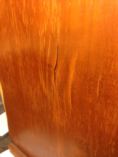

Working on the center cabinet issues. The veneer had buckled on a burl in the veneer causing a lift and separation right in the center of the cabinet arch. Making an insert to back the cabinet while clamping.

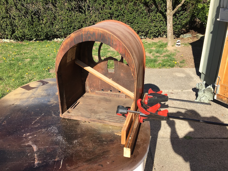

I have made the insert for gluing the center issues on the cabinet.
I will apply the Glue and clamp the heck out of it until tomorrow.

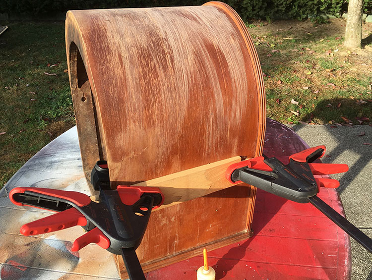

im finally gonna try to repair the veneer issues on the center of the arch.

I think I am finally done gluing!
This cabinet will not be perfect but it will be a lot better.....
