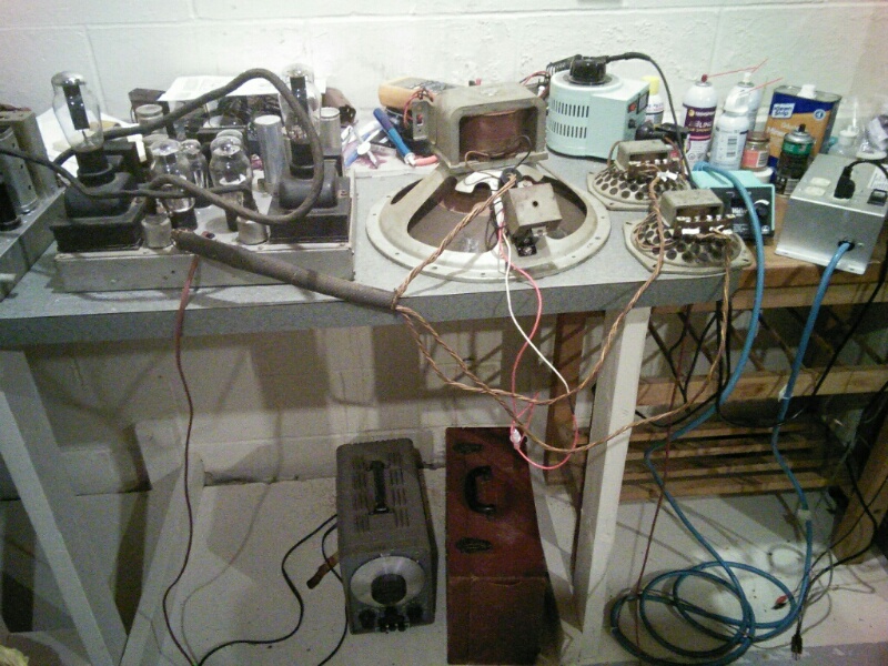

Rich called, said he has no 14" cones and he's not aware of anyone making them. Suggested a ring and a 12" cone.
I suggested a patch, as he of all people could make it well, he agreed.
The tweeters he said are ok to recone.
Speakers came from Sound Remedy. Rich did a great job plus he patched my woofer for free, only having charged me $80 for the two tweeters reconing.
Now the transformers. Promised by Heyboer for the mid-July or so.

With regard to the interstage transformer, does this set use a class A-B power amp, with a third triode driving it, a pair of triodes driving it, or is it a class A amp?
The interstage has to be CLASS A, as it is one pentode 6F6 driving the primary of the transformer which in turn drives the 6L6 pushpull and the tweeters directly.

The output transformer still has the centertap leaded and one plate lead goes to the fuse. How'm I gonna solder to it?
OK, I'll short the fuse and put an nline fuse to the CT.
I am very sad. It's been three (3) shipping back and forth. I ain't shipping for the 4th time.

Time to go to contact Edcor and see about ordering a new one from them, it won't look the same but the impedances will probably be correct. If they have to build a custom transformer they will apparently refund the engineering charge if they find the specs for your transformer on file.
Arran,
That's the thing: I do have a transformer I bought for mere $20 or so, a 20W rated 4 ohm to 6,600 ohm PP.
I was hoping to install the original. And....I guess (now that they got the impedance straightened out after 3rd try) I could uee it, but soldering won't be nice.
I think I will suggest tbis xfmr being discounted, as I spent over $40 just for shipping.
OK. It lives!
Last Sunday I installed the interstage (guess what, the wire colors were correct!) and today I installed the output xfmr. Yes it is ugly as I had to solder external inline fuse.
Then attached the tweeters, the woofer. Thought of powering up tomorrow but decided today. It took it about over a minute if not two to warm up: while some reaction was there when touching the grid caps, a full fleged hum appeared after that much time. And then I pulled the local station loud and clear. No music so cannot judge the tweeters and the quality but the speech is good.
