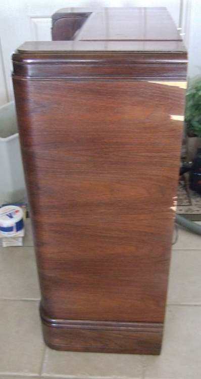

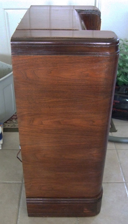

Over the last two days I used some GoJo waterless hand cleaner to clean the cabinet surfaces. I used cotton Q-tips in hard to reach spots. The top right area had veneer coming loose, so I may either take it off or thin some Elmer's white glue and work it up under the veneer, then apply clamps as it cures.
The right side of the cabinet has some missing pieces of veneer at the back edge. I managed to save a few pieces that came off and will put them back on and work some of the glue up under the mating edges where they are loose then apply clamps to finish the re-gluing. I have some red oak veneer that has similar wood grain that I can use to patch the areas that remain on the right side, then stain to match as closely as possible and add some clear lacquer to complete that side.

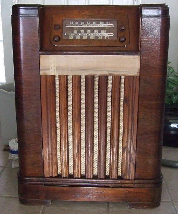

The front changer tilt-out had the top edge veneer so loose that a slight tug made the entire piece come off. I plan to use the red oak veneer package I bought to make two new pieces, in a mirrored effect if possible. Then I will apply some stain to match the vertical wooden ribs over the speaker area and apply some clear lacquer to the mirrored veneer pieces.
The vertical ribs had about 50% of their original lacquer finish flaked off. I removed the rest of the finish there and then applied some paint thinner to bring out the original stain. Then I took pictures to show what it looked like (minus the veneer on the top of the changer tilt-out).
Here are some pictures of how it looks after cleaning.

In the previous set of pictures the front ribs over the grill cloth have had their lacquer removed and were cleaned with some mineral spirits. They were left several days to thoroughly dry. I wanted to apply fresh lacquer to those ribs and noticed that the speaker baffle board was mounted using 6 wood screws from the back side. I wanted to get the grill cloth out of the way before applying finish. I removed the wood screws and lifted the speaker out of the way only to discover that the grill cloth is fastened to a separate thick cardboard form in front of the speaker and nailed to the wood from the back side. I have doubts that I would be able to get the nails out without damaging either the cardboard or the cloth. I have some craft paper and I think I will use some it placed in front of the grill cloth but behind the ribs from the front side. That will keep the lacquer off of the grill cloth.
The grill cloth on this radio is not an exotic type and could be replaced, but it is in good shape and it will be less time consuming to leave it in place, protected and proceed with the finish process.

The veneer used on the sides is French walnut, not red oak, probably straight cut judging by the grain. If you have some French walnut veneer scraps those will make a good good patch material. Make the patches first, and make them larger then the areas needing repair, and irregularly shaped so that they roughly mimic the wood grain, then place the patch over the chipped area with tape, and cut around the outside of the patch into the veneer under it. New walnut veneer of any species is fairly easy to get, there is a guy on fleabay who sells lots of surplus veneer left over from fitting out yaughts and private aircraft, and there are others that will see you smaller amounts too.

So far so good - the veneer I added on the tilt-out looks good. I had a few pieces of the French Walnut that had cracked off of the side and have already managed to glue those back on as well as regluing some areas that were loose.

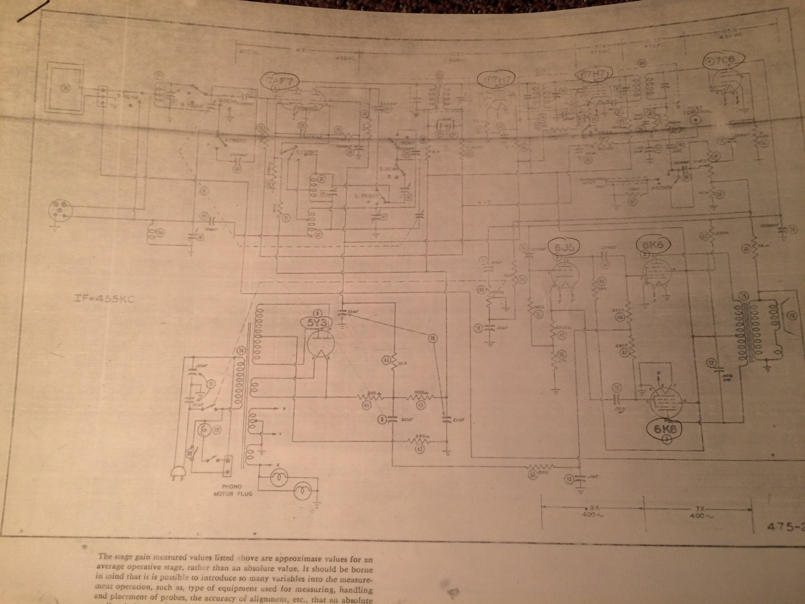

wow,, i think,,, i really think i might be the only one here who has the exact answer.
your diagram seems to be a code 122 print... yes the 7AF7 superseded the prior codes which was 7F7.
There was never a print made for the 46-1226 code 125 period,,, noda!!!
what you do is use the code 122 prints but you integrate all the changes manually in your minds eye or physically with parts to meet the "typed out only" changes provided for code 125 run 1,, run 2 and Run 3.
the philco workbench can get you the prints.
I can get you copies
either way go to our resources page and order them up ,,, they come from a member here and it was really cheap.
what this boils down to is "how you ask for prints".
you say,,,,
"i want prints for a philco 46-1226 code 125 which consisted of 3 run numbers. run 1, run2 and run 3.
You wont really know very well which run number you have until you get a print of code 122 in front of you. Still you will need the typed out text documents that integrates all the changes pertaining to code 125 run 1,2 & 3.

For the subject line of this thread, during the restoration i found out i would need to be using the 46-1226 code 122 prints.
Code 121 is close, but code 122 are a match BUT,, there are updates to to the code 122 such as some filter cap changes, PM speaker mod and power supply secondary re-wire tasks. THERE IS NO KNOWN print to specifically match code 125,, dont even ask. in order to restore a 46-1226 code 125, you must combine code 122 prints and the updates which will then equal code 125.
5may2017 update= lessons learned- If you obtained a set of prints from Chuck at the philco work bench **and** you are restoring a code 125, ****USE ONLY*** the fold out schematic for rewiring as this iwll accuratly represent the changes pertaining to the V1 7AF7 tube socket updates.
You will recieve a technican repair guide pamplet and that represets the component layouts for an *earlier* radio version.,,, use the pamplet as a guide only but revert to the fold out schematic to work through your troubleshooting or repair.

the major 2 things of many on code 125 was you have a PM speaker and your transformer became wired differnently than the previous code 122... just sayin'
so be careful... i stayed confused for a long while till i got my head around one single concept..........
only use the fold out schematic for code 122 **and** the typed out text pertaining to code 125 runs 1>3.
the philco workbench sent me a good bunch of info but...
they provided a booklet that broke up the radio into sections on individual pages.
there was an insert fold out schematic that also had dark lines around "sections".
i have no idea why but ignore the booklet !!!!!!!!!!!!!!!!!!!!!!!!!!!!
Just use the fold out schematic.
i suspect the booklet is early code 122 and the fold out schematic (what you want) is later run 3 code 122.
(This post was last modified: 02-10-2019, 08:24 PM by jcassity.)

Okay, yes, I was aware of the PM speaker. Where can I obtain the "fold out schematic for code 122 **and** the typed out text pertaining to code 125 runs 1>3"
