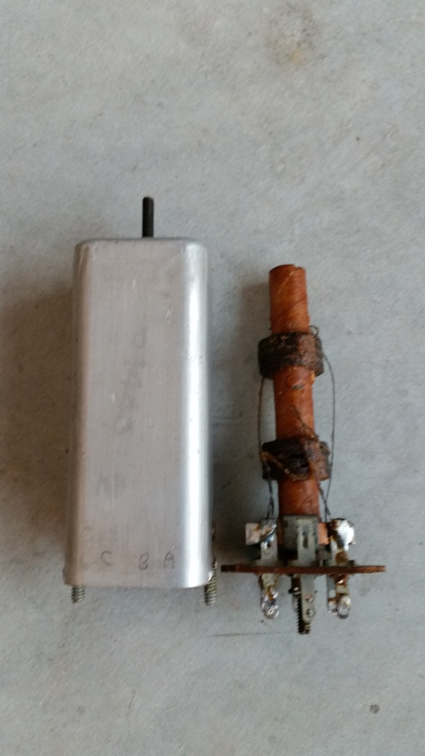

More investigation yesterday. I was curious as to the state of the capacitors within the I.F. transformers. (Pics to follow). Removing the easiest candidate -The first I.F.- took but a few minutes, and the can was easy to open, revealing two tall windings on a waxed paper tube. The capacitors were miniature versions of the clamped type mica style. I removed each in turn, and measured the capacitance. Expecting 100pF from the schematic, I found these were each accurately 110 pF. Too much of a coincidence for me to consider making a change to what was found, so everything was returned to place as found.
I am still not convinced that the two I.F.s peak up quite as they ought to, but am reluctant to risk causing damage.

Here is a picture of the IF transformer I checked:
The view is from the primary side, with the small cap soldered between the outermost pins in the phenolic base. In this picture, it is behind the center, unused, pin. An identical arrangement is made on the other side for the secondary winding. Replacing the capacitors would be easy - they desolder without much trouble, and there is room for replacements, but I doubt that this will be required for a long time to come, and the value marked on my schematic differs from what was measured.
