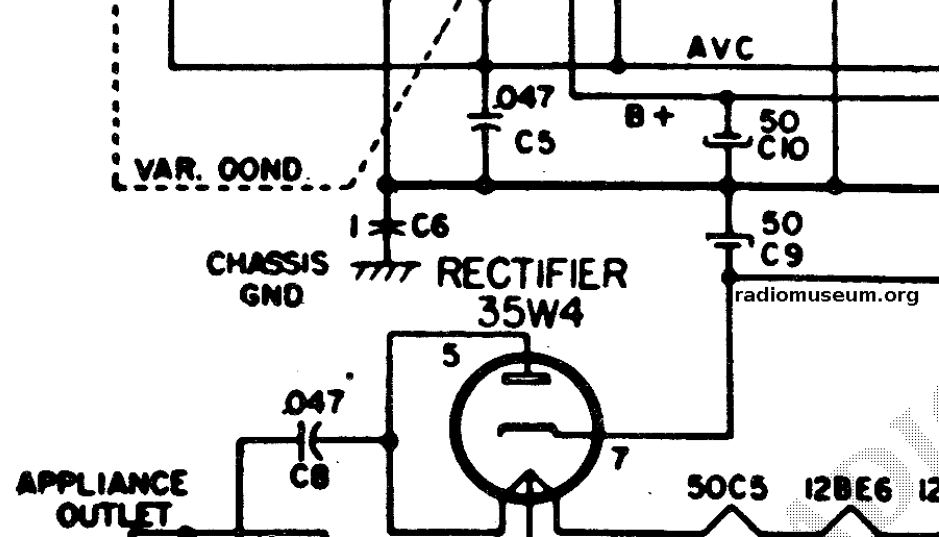

Just to muddy the waters a bit more .... here's a snippet of a Bulova schematic for the model 100-110-120 clock radios .... they use two 50UF after a 35W4

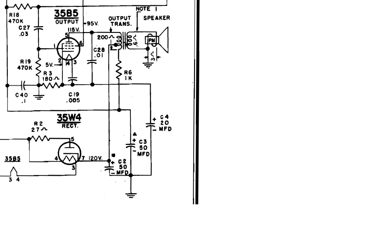

Here's a screenshot of the audio stage of this radio, showing the output transformer and its extra tap on its primary side.
#83
That tap connection is the B+ feed to the entire set. Just move that B+ feed down to the top of R6 (bottom winding on the transformer) and eliminate the tap completely.

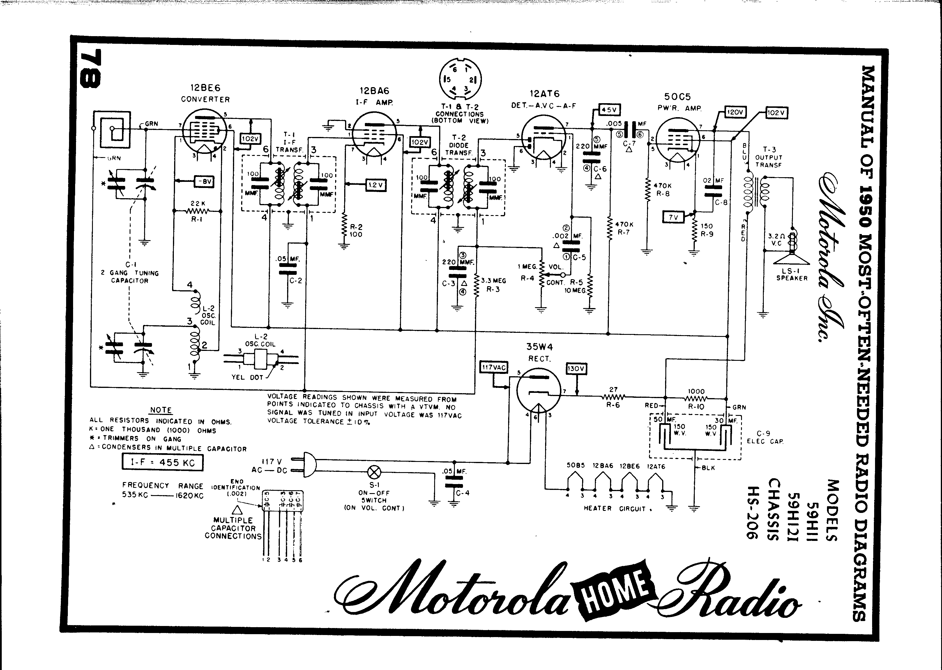

Something like this just note 50C5 vs 50B5 on the pin outs. David

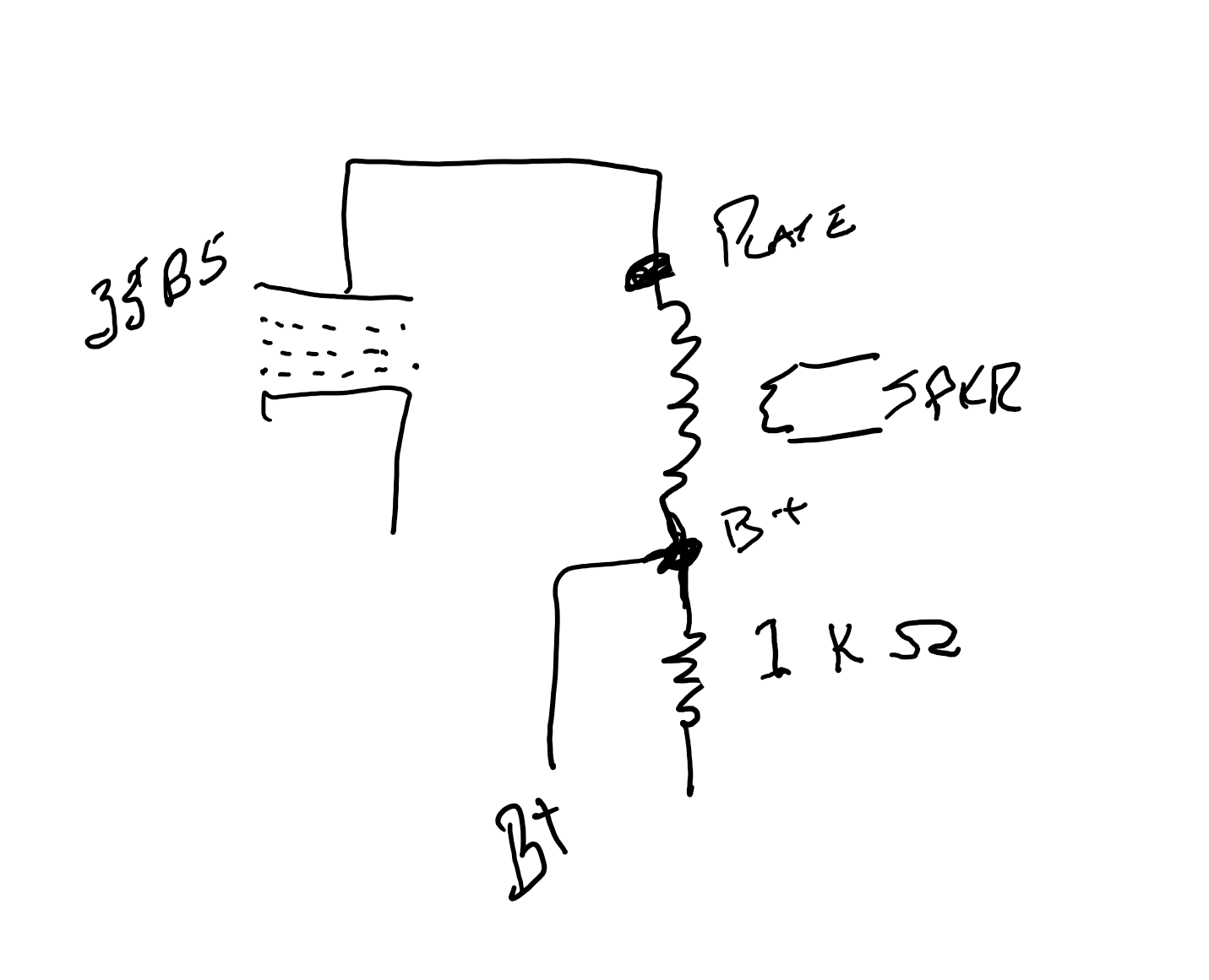

Pardon my scribbling. This is how I would wire it :
