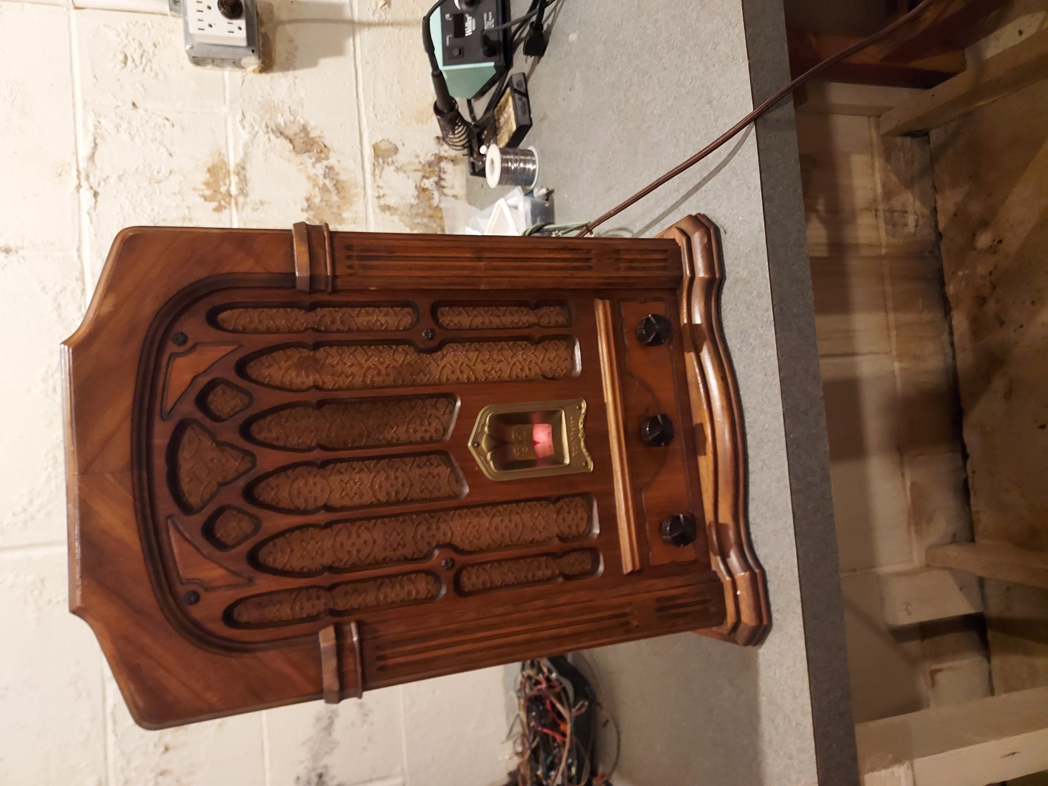

Well, unlike this one, the 140 was one of my bucket list radios, so I was actively looking for it. This would explain my desire and the level of effort expended.
Well, this completes it.
Today I assembled the radio, after having wiped some real black, real greasy stuff with mineral spirits off the inside of the chassis bottom cover, that alcohol would not remove. Considering the percentage of the open magnetics, I wonder......well, I best not think of that.
It sounds OK. Do I think the 3H 18K turns burnt inductor in the driver stage, replaced by a few hunder mH one and 3K resistor, is part of it? Maybe. It does not sound amazing, but sounds quite acceptable. Plenty of power, volume; this is the 1st radio that, after the alignment, put the local station at the exactly where it should be, 1160 kC. Not even a shred of the small division to the left or the right.
I have a small video, but I stopped posting on youtube a few years ago, and i am not sure where to put those anymore without being sniffed by those bots. Like in "The Matrix". So the photos should suffice for now.
3 months it took me. Willy-nilly. Not bad.

Michael, This is a very beautiful radio! I have enjoyed your restoration narrative. Joe
Joe,
Thanks.
I agree with Joe. It looks great. Good job.
Thanks Ron!
Actually, I was surprised that the grill cloth was intact and clean! The radio clearly was put away due to insurmountable repair problems (2 chokes and the output transformer open), and obviously was kept somewhere where it was dry and fairly clean.
There was a repair attempt, I guess, as the screws,m that held the rails to the back of the cabinet, were gone. But I think, it progressed to the realization of it being too much, and I saw no signs of soldering or replaced parts.
So having a fairly clean cabinet and good cloth (and!!! surviving the trip in Kirk's van! Which is in itself a very dangerous thing for a radio to undertake!) is surprising.
PS. Thanks Kirk!
