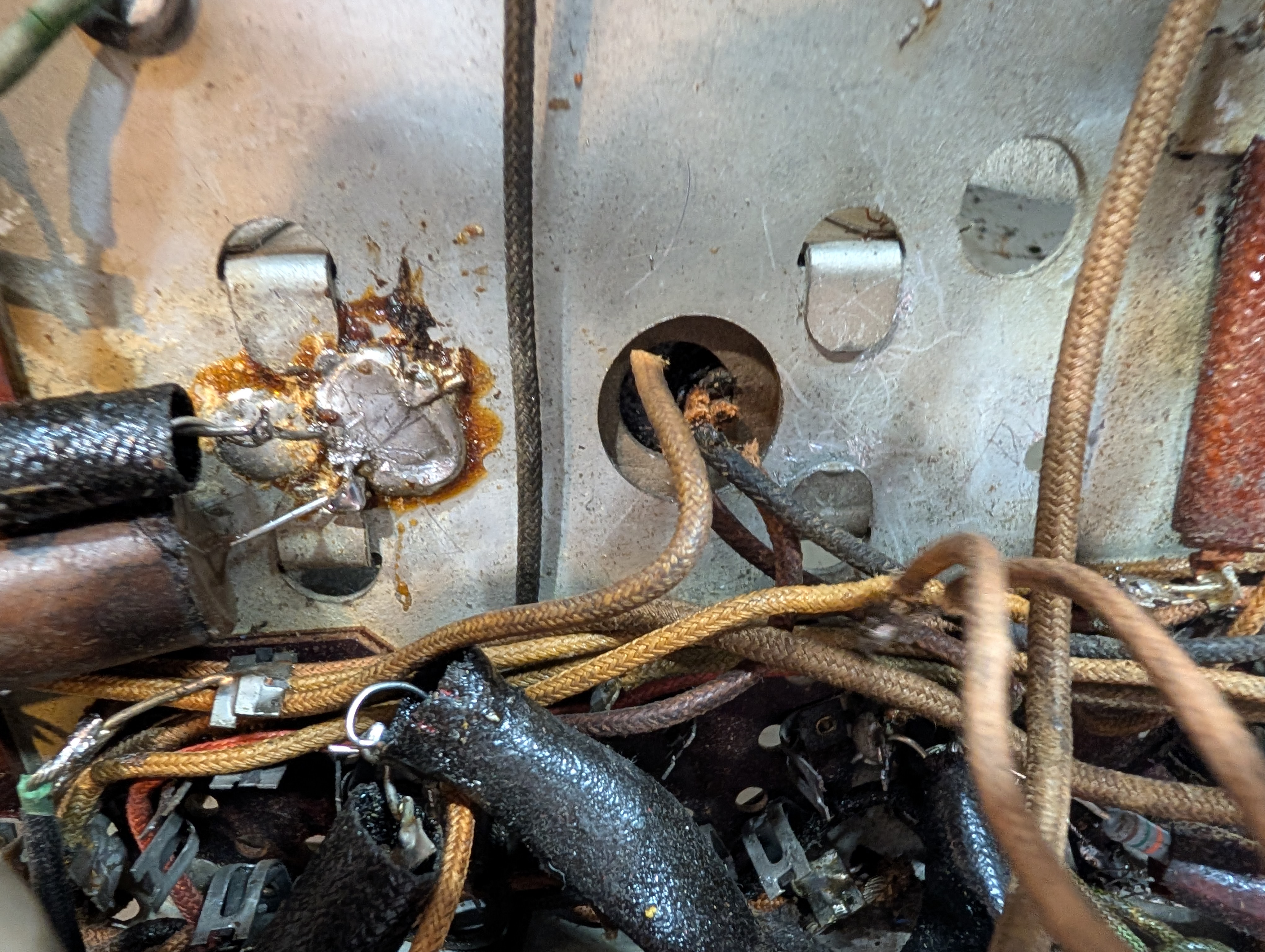

Continuing the recap of the coil assy.
I ordered some solid AWG22 wires yesterday that should come tomorrow. It is a colored insulation 600V wire. I want them thinnker than what I have (black AWG18).
Plus some of the wires that come to the switches, they go in the same solder posts as the caps I remove, so I decided to wait 'till tomorrow, so I do not have to solder the same post twice.
They use real black tar on these caps. I hate black tar. Especially the soft black tar. Though easy to remove, it fouls up things around.

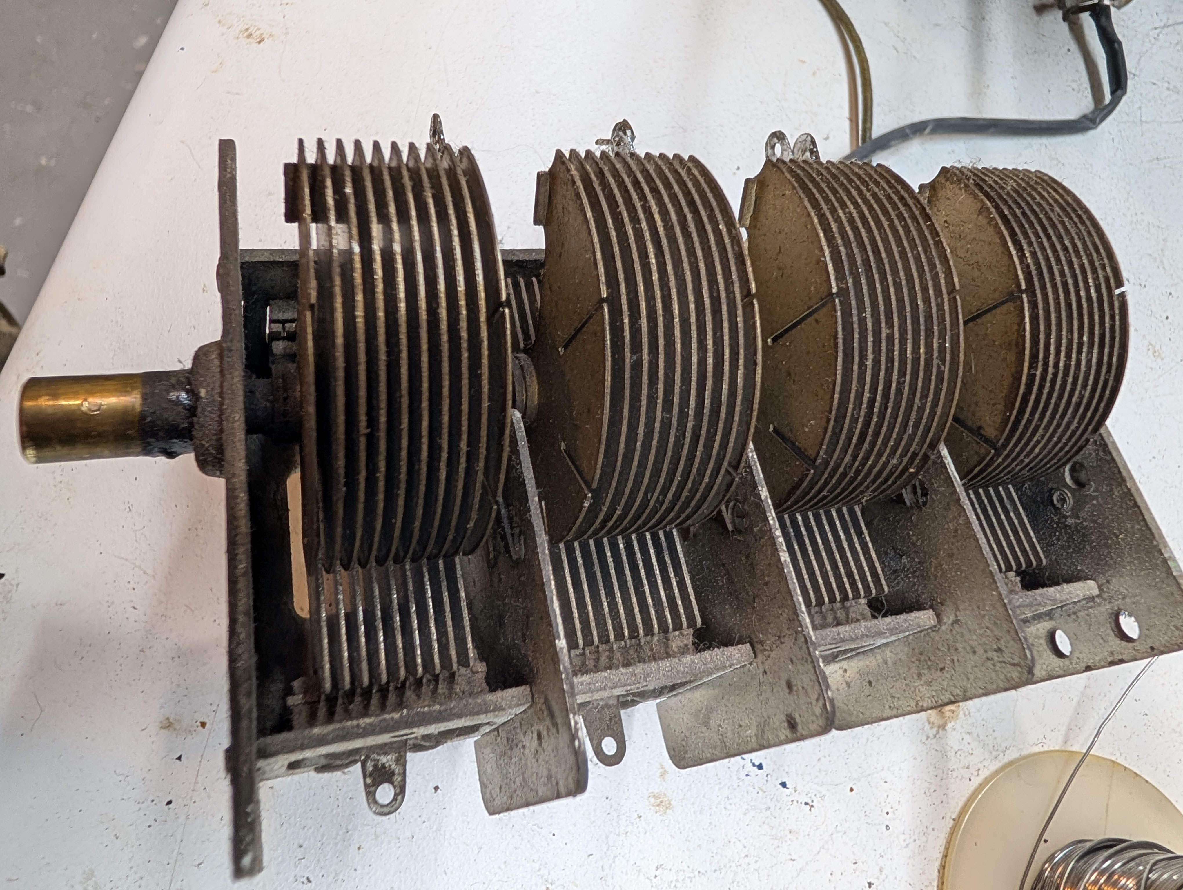

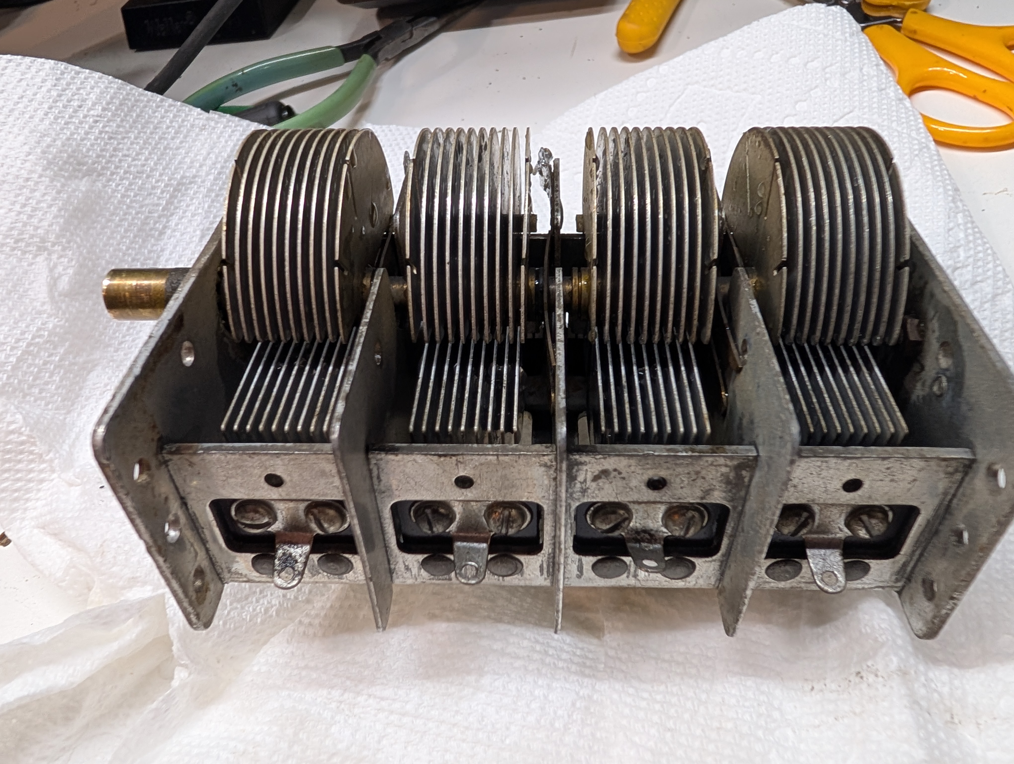

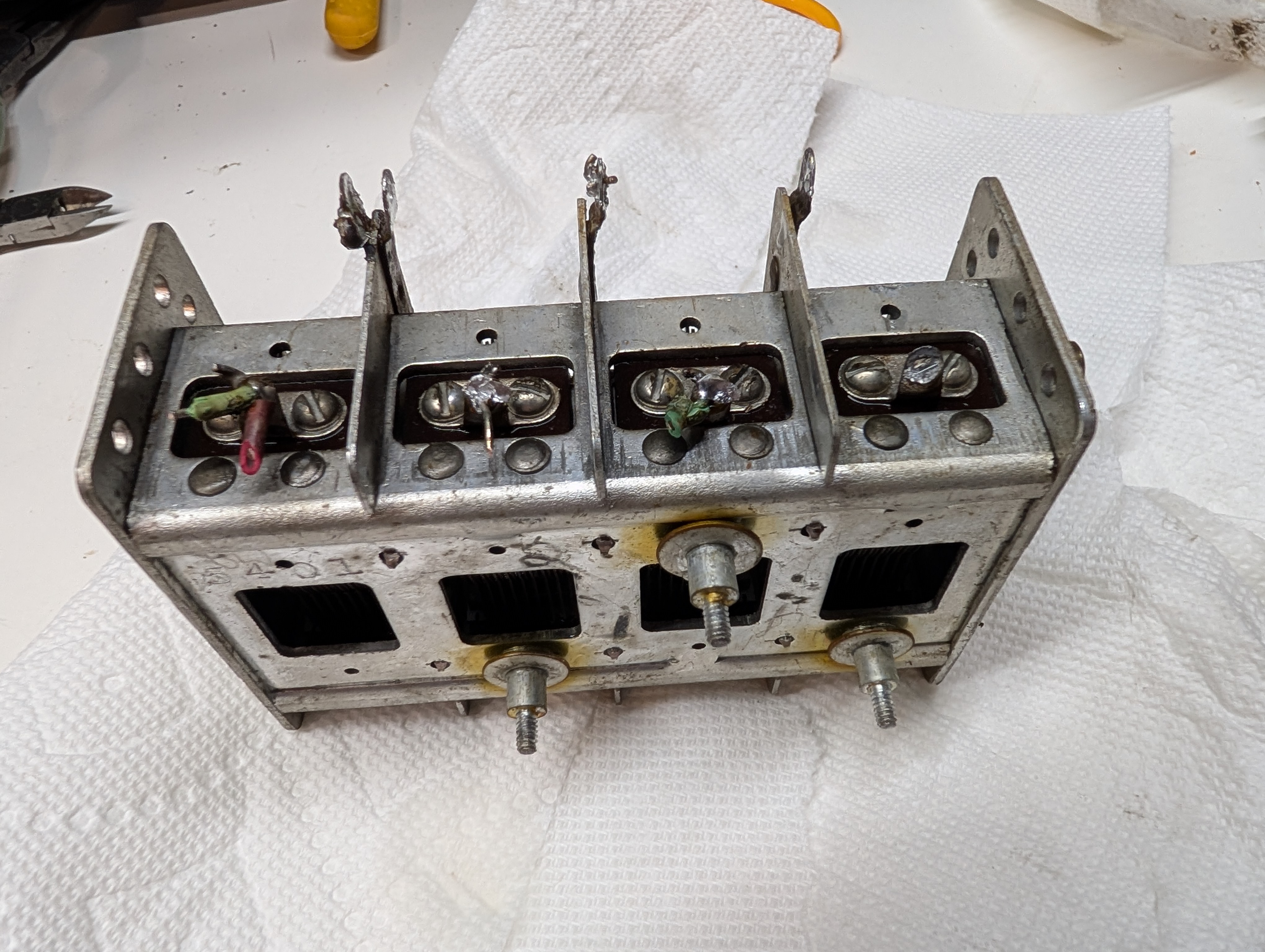

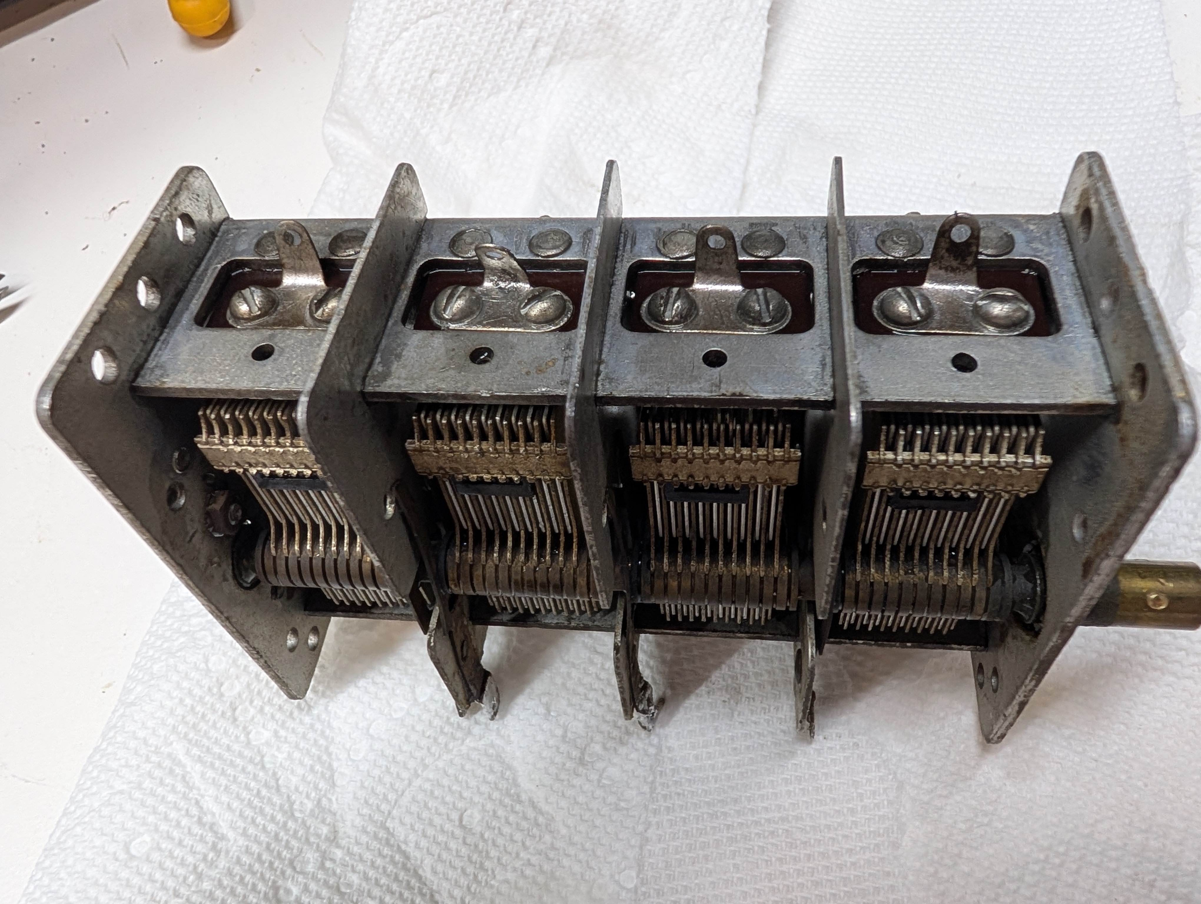

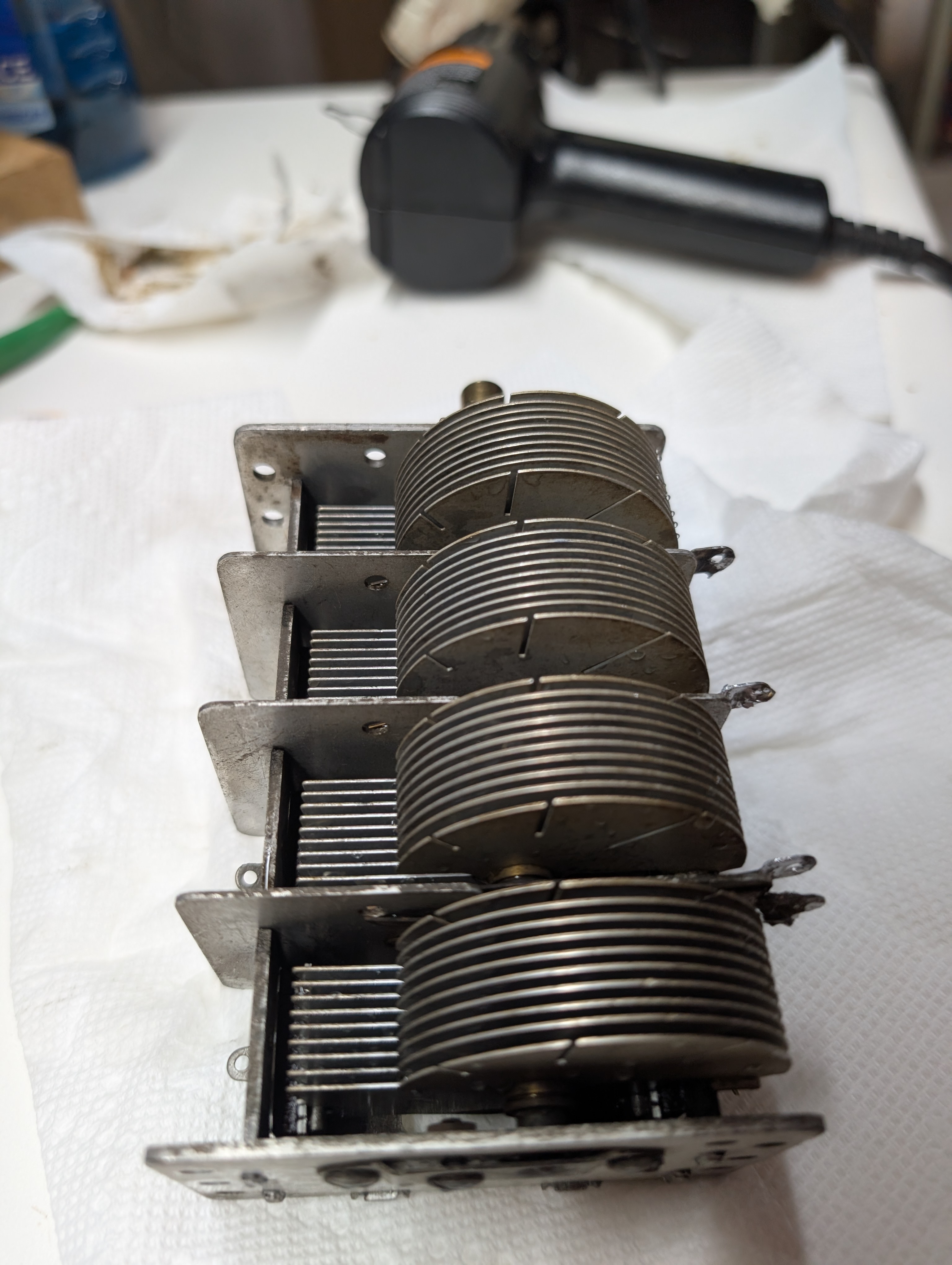

Today I washed the tuning cap. Regular dishwasher degreaser soap and very warm water from the tap.
And a long soft brush.
Soaked for 10 minutes, then brushed.
Then rinsed.
Now drying.
Before
After
After that I intend to take the smaller can out.

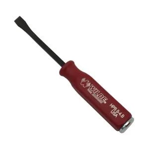

#89
    Morzh,
Here are a few of my favorite small prybars: one is made by Wilde and the other by Dasco. All of them are made in the USA.
#90
Rich
I think i might have one of those, similar to the blue ones.
I think my tools will come today.
I saw that first one that looks like a bent flat screwdriver. I think it is good, but my entry angle is a bit too restricted for it; this was the reason I chose the indexed one.
If what comes today does not work, I will dry some other versions.
