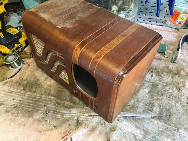

Finally done veneering and gluing!
Today is Strip day  Icon_thumbup
Someone put something on this cabinet that was not lacquer so the first strip needed real stripper.
Now to use the lacquer thinner...

I just found Mikes other cabinet... Oops,  Icon_lol
Just needs Toning and clear...
Me

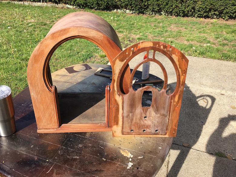

Well,
  Luckily my belt sander is in the back of the shop so I could not use it..

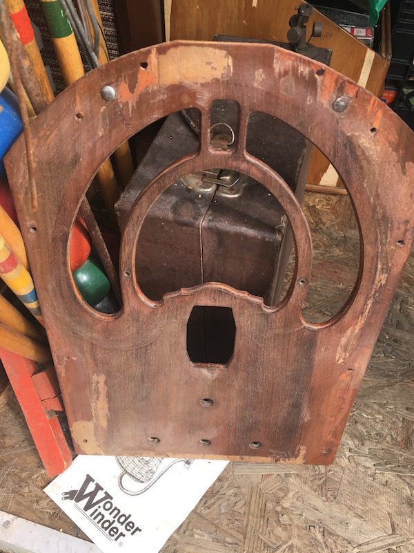

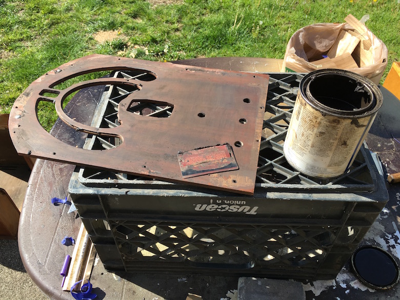

This cabinet is a real piss off. I had to double strip this crap off and then thin.. I dont know what this guy did but I found body filler in it..... The face was ripped off once and they tore all the veneer..
You can see all the patches in the pics...
  I will have to fix all this and then I can start grain filling the cabinet...

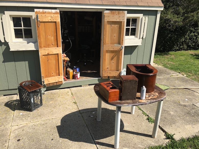

I cant do any in this weather... The veneer on Ron's could warp in the high humidity and I cant tone yours in the rain...
I am twiddling my thumbs here!

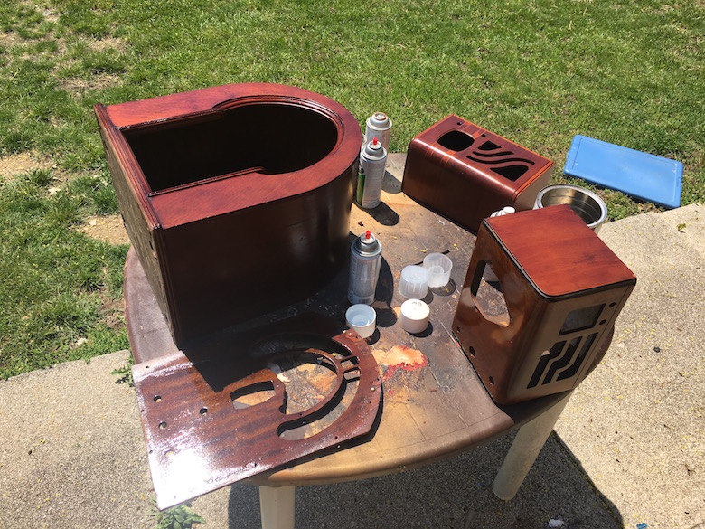

I found out today that this cabinet has silicone poisoning...
I am toning the cabinet and she has about 6 spots that are fish eyeing badly.......
Soooooooo, I am clearing, sanding, clearing, sanding, clearing, sanding....
Finished that after 2 hours and am now toning.. She will be darker than original as the veneer was so poorly refinished and filled with putty. Any lighter and you would see the mass imperfections...
Never use a belt sander on a cabinet people....
