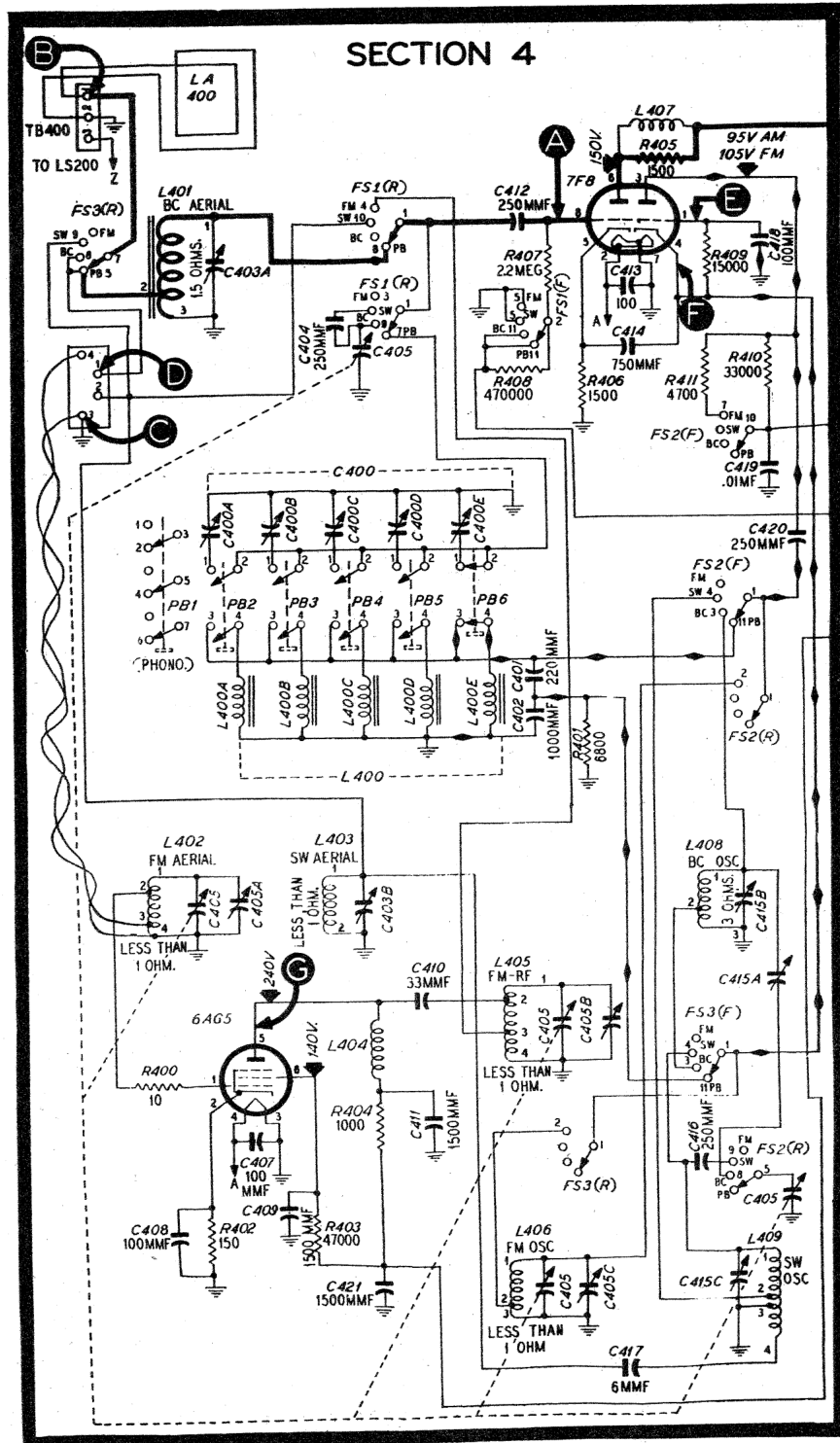

Well, from the osc frequency readings to obtained, it appears the oscillator is spot on and can be eliminated as the problem. That, with the fact that you do receive the signal generator well at 1000 kHz points to the antenna circuit as the next place to look. The possible components here are the bandswitch, antenna coil, tuning capacitor, loop antenna and the connections between them.
Have you sprayed  the bandswitch contacts with contact cleaner and "exercised" it? Usually these switches have not been operated in years, and the contacts are coated with an insulating layer of tarnish. I am surprised that you don't get static noises when you rotate the switch though.
I have sprayed and exercised the bandswitch but will do it again.  I feel like I'm a good schematic reader but I'm having trouble understanding the front end on this one.  It looks to me like the only time that the loop antenna and AM antenna coil are connected to the circuit is when the bandswitch is in the PB (pushbutton) position.  I'm looking at the FS1( R ) section.  When it's in the BC (broadcast) position the connection is opened.  What am I missing?
Thanks,
Rich
Looks as if there is an error on the schematic, as it can't work as shown. The two contacts marked BC and PB should be connected together, so the ant coil is connected to C412 in both positions. The switch section below then selects either the main tuning cap C405 in BC position or the push button trimmers C400 in PB position.
Make sure you have continuity from L401 to C412 in both BC and PB positions of the band switch. In addition check for continuity from C405 to L401 and C412 in BC.
Thanks Mondial - I came to the same conclusion about the schematic after looking at the tabs on the rear of the 1st section of the bandswitch.  Pins 8 and 9 are indeed connected when the switch is in the BC position, which results in the antenna coil being connected to C412.  I didn't want to conclude that the schematic was wrong since I have two different schematics and they both show it that way.  But now that I've done that checking and you've concurred, I'll move on  ;)

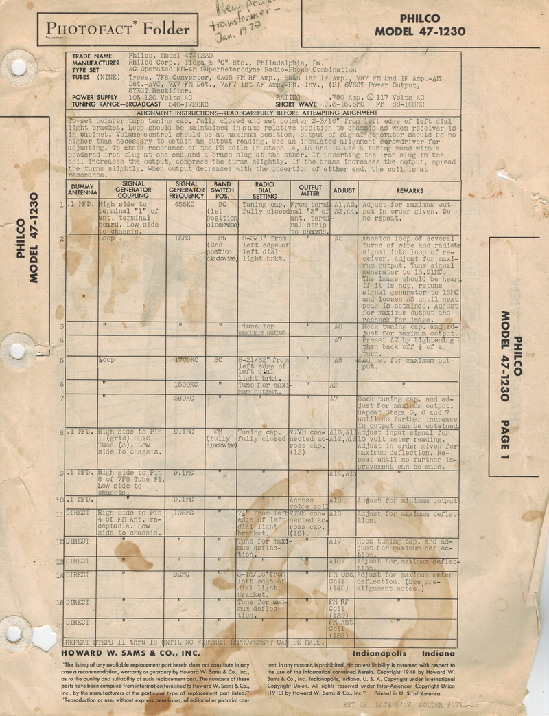

I hadn't completed the alignment procedure and after looking at the remaining steps I decided they were probably pretty important in relation to the problem I was having.  Here are the alignment steps from the Sam's Photofact

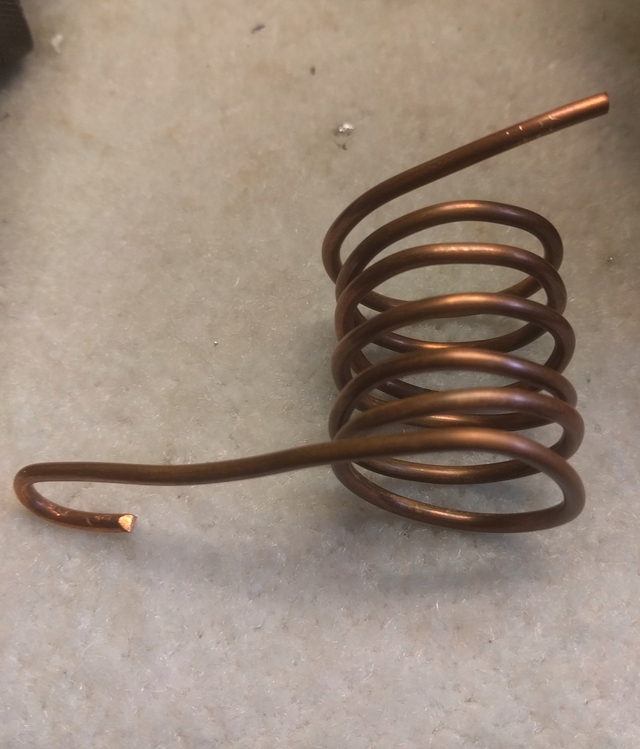

I did step 1.  Steps 2, 3, 4 are for shortwave and I didn't continue on and do steps 5, 6, and 7, which involve adjusting the caps for the AM antenna coil and the AM oscillator (403A, C415B, and C415A in the schematic I posted in post 100)...pretty important.  I made this loop and suspended it inside the radio's loop antenna for these steps.
So now I get about 6 stations, but I have to have the volume all the way up to make them listenable.  I'm going to continue trying to improve the alignment but if that doesn't improve the volume I'm going to have questions about how to fix that.  But for now, I'm smiling!
