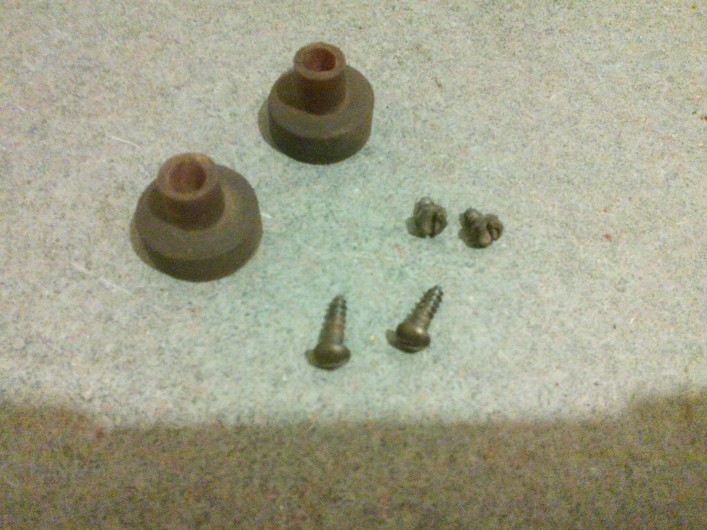

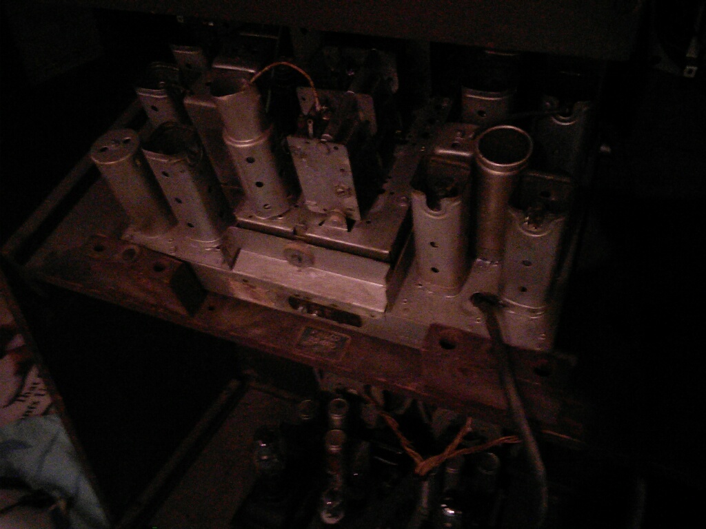

OK, guys,
Need help with assembly.
This is what I have with the tuner:
This is what's left unused:
The tuner chassis should probably be held in proper position where it is aligned with the front by something other than the shipping wooden blocks.
As I said before, the radio was partly taken apart before I came so I do not remember all the fasteners, and in the inclined models of 1938 it is different from the ones from 1937 where it is parallel to the floor and is held with one 4-40 screw.

The grommets need to go on two small shafts on the front of the sub chassis before it's installed in the main chassis. Then you slide the front of the sub into the two openings in the mounting bracket and slide back. So these brackets have elongated rails for the grommets.
I'll try to get pictures from mine later today.
