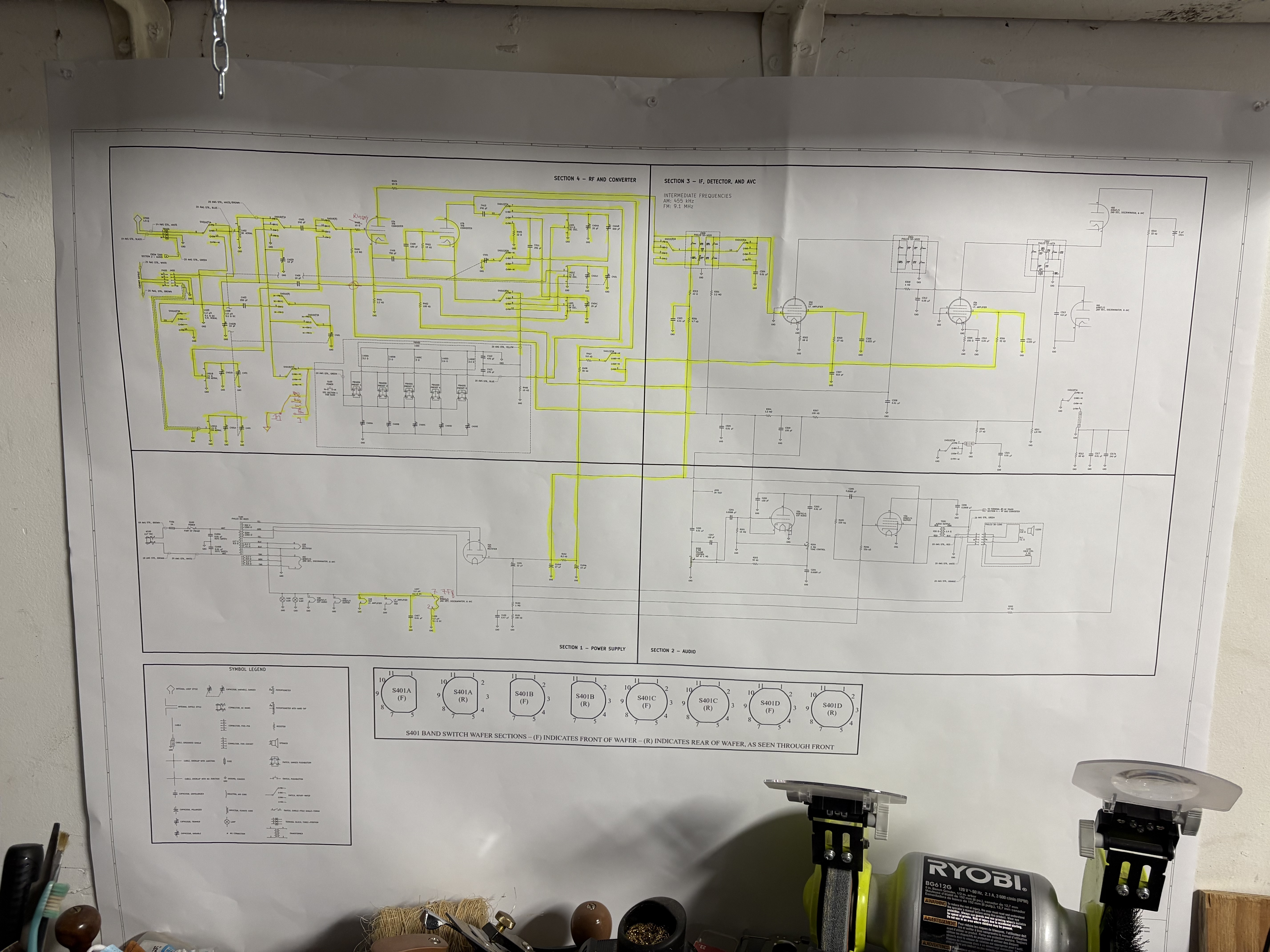

I've got a printout of my schematic which I have pinned to the wall above my workstation. I mark it off as I install components.
I've realized as I go along that there were a few minor mistakes. First, I realized that I had a crossing of two wires which I had not marked with a dot to indicate a node. I referred back to the original Philco schematic and concurred that there is not a node at that point. So I added a "jump" symbol to indicate that one wire crosses over the other without creating a node.
Second, I realized that I had mislabeled the 7F8 heating filament, and had pins 2 and 7 reversed. I caught the reversed pin numbers when looking back at one of my sketches of the wire traces, and consequently noticed the wrong name when I then looked at my schematic.
Third, I realized that my schematic had two different resistors labeled R408. Recall back to one of the earliest posts I made in this thread. The complete Philco schematic was missing a grid resistor connecting to pin 8 of the 7F8, whereas the enlarged Section 4 portion of the schematic showed one. The enlarged Section 4 schematic properly calls this resistor R409. I am not sure where I found a reference to it being called R408, but there is already an R408.
Fourth and final, this was a good one. The original Philco schematic lacked this detail, but the revision notes captured it. I also had depicted it in a sketch of the wire traces while I was disassembling the radio. Essentially, a production change was made to ground pin 1 of S401A(F), so as to ground the push-button trimmer capacitors while in FM mode to prevent oscillation. They accomplished this by creating a hard ground connection at pin 11, and the wafer switch rotor connects pins 11 and 1 while in the FM position. I've decided to add this detail to my schematic, even if the original schematic lacks it. Pin 11 acts as a pole in this application, but also as a throw for another circuit. Hence why you'll see it twice here. I don't like to show it on two different instances of the same switch, but Philco did that in several places on this very schematic so I kept the same styling.
I've made these corrections to the Rev 0 and the Rev 1 PDF, since they are applicable to both. I've gone ahead and re-uploaded both here.

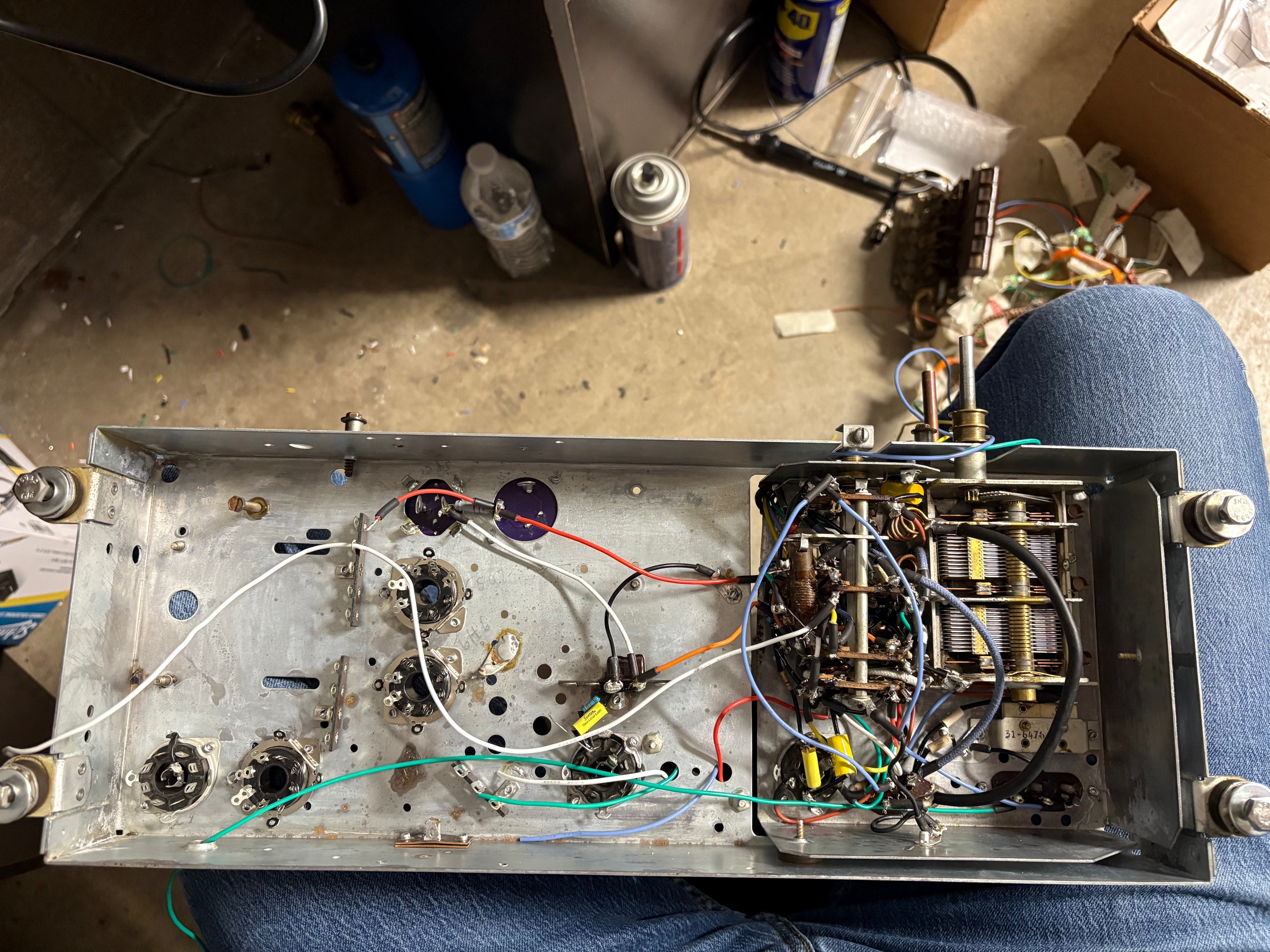

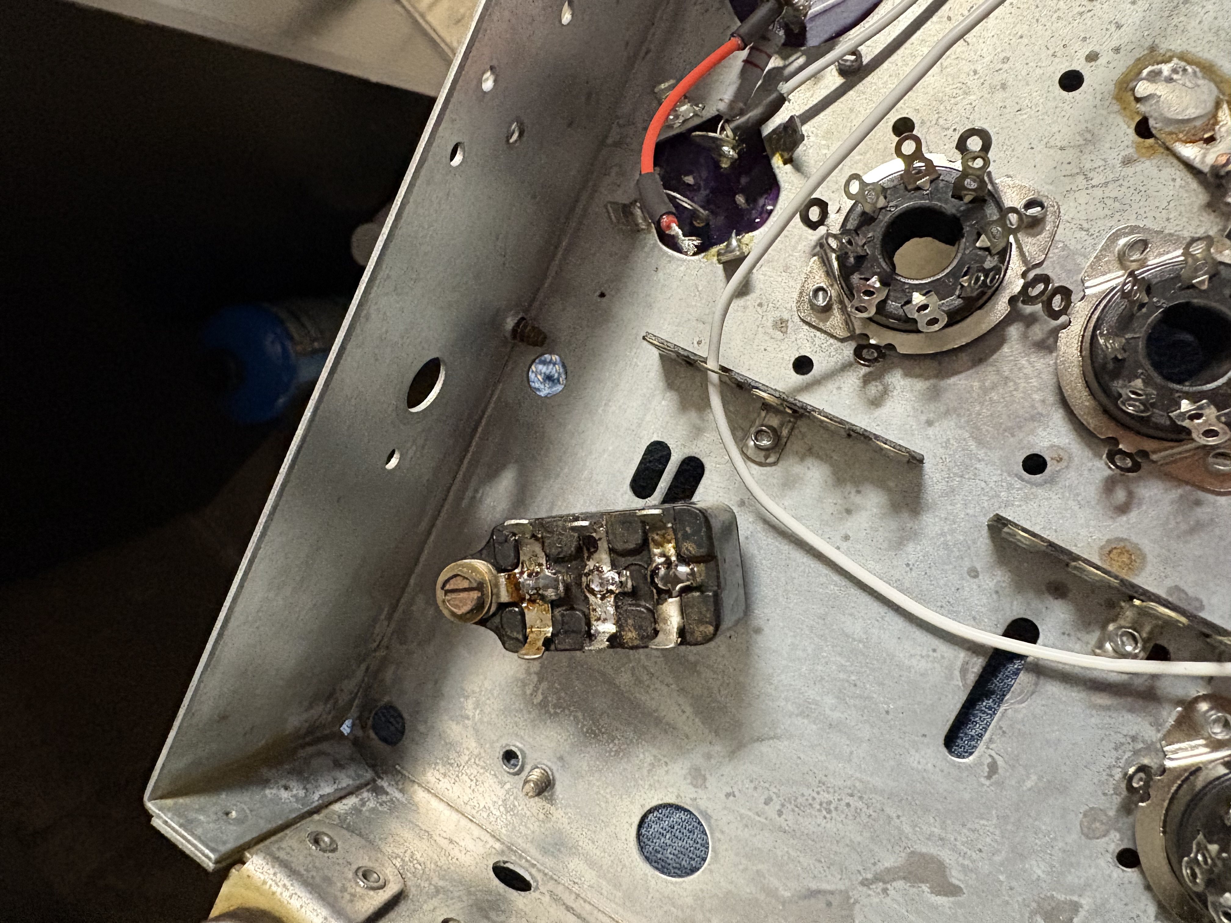

I kept working on reassembly this week. I wasn’t able to solder for a few days while it was too cold (single digit low temperatures and highs below 20 degrees), but now things are warming back up in Tulsa. This weekend it was about 50 degrees both days, and the snow is just about gone. Here’s a couple of pictures to show this week’s progress. Except for the push button assembly, I have finished the RF section. I haven’t found any more issues with the schematic.

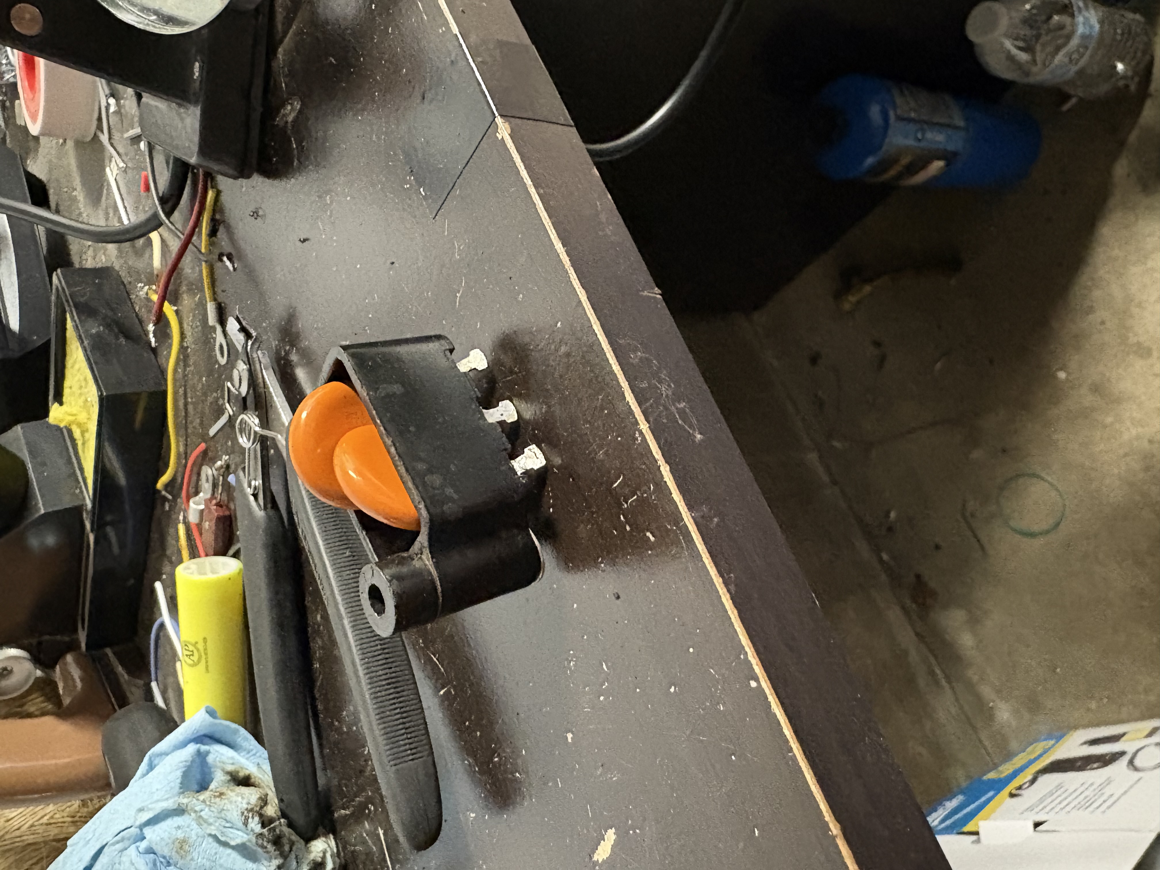

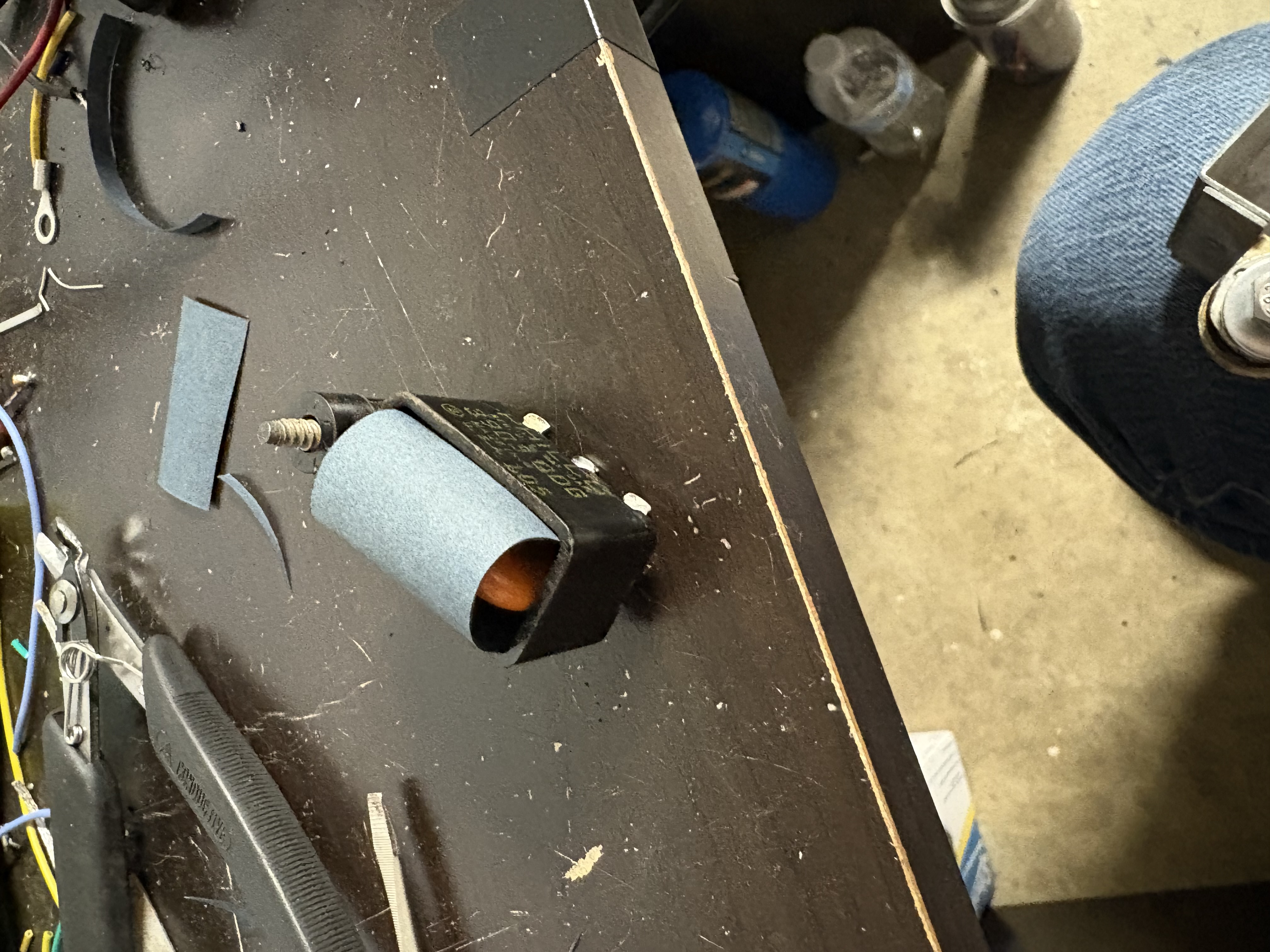

In other words, take a look at this Mike! I got the Bakelite capacitor emptied out and restuffed with the safety capacitors! They seem to be very large discs, and they do protrude out of the assembly a bit. But I am able to reinstall the assembly into the chassis without any issue. I will note that the discs do touch the chassis when the assembly is bolted into place. Perhaps I should add a piece of fish paper between the chassis and the capacitors, for added insulation.
