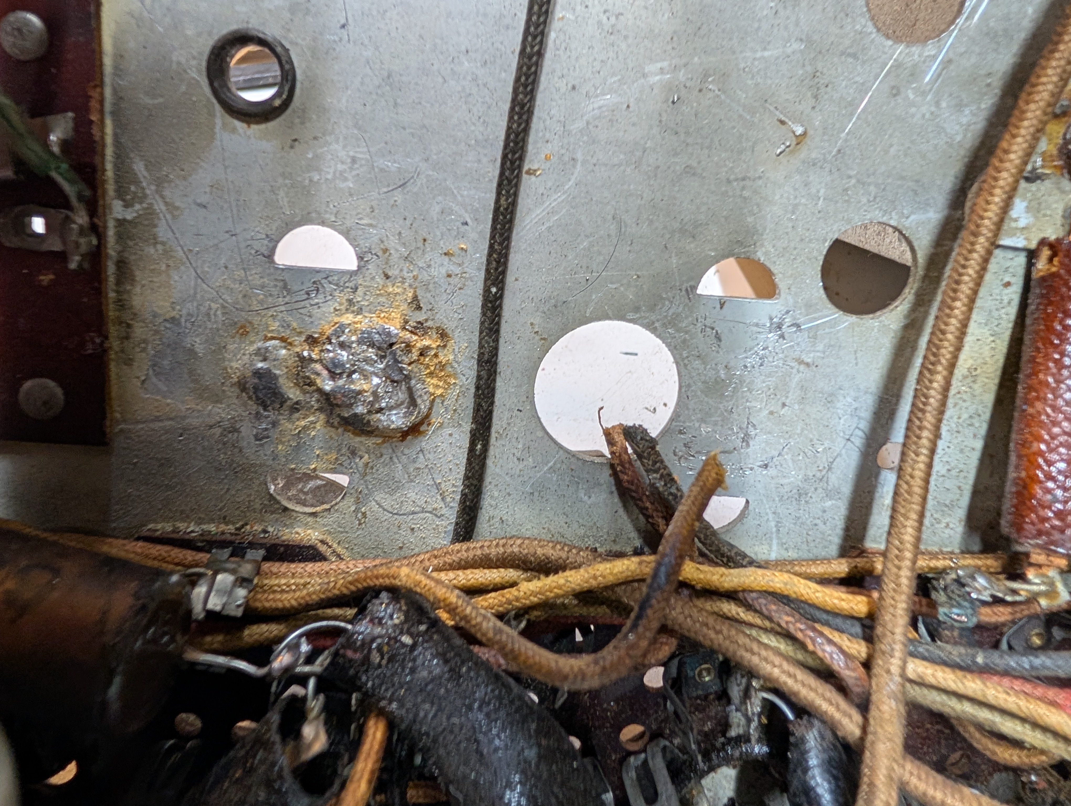

The iron I need because some parts are soldered directly to the chassis, and in a couple of places I was not able to desolder leads even with my iron at 850F (in some cases it did work). Instead of killing my good smaller iron, I will have an industrial one that is made for these kinds of jobs.
And the reason was...couple of those tabs I need unbent are tacked with solder and I need to clean it first.

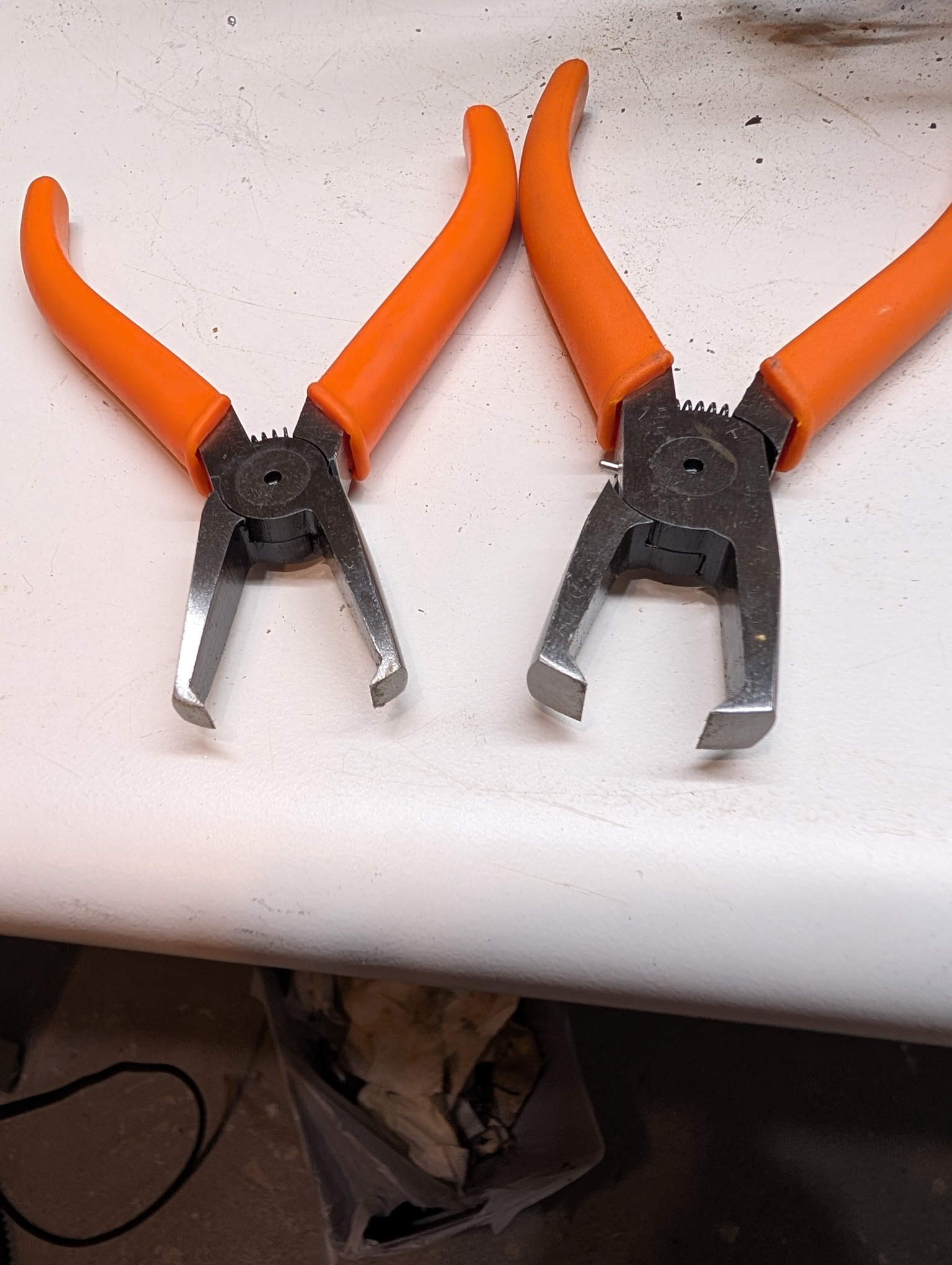

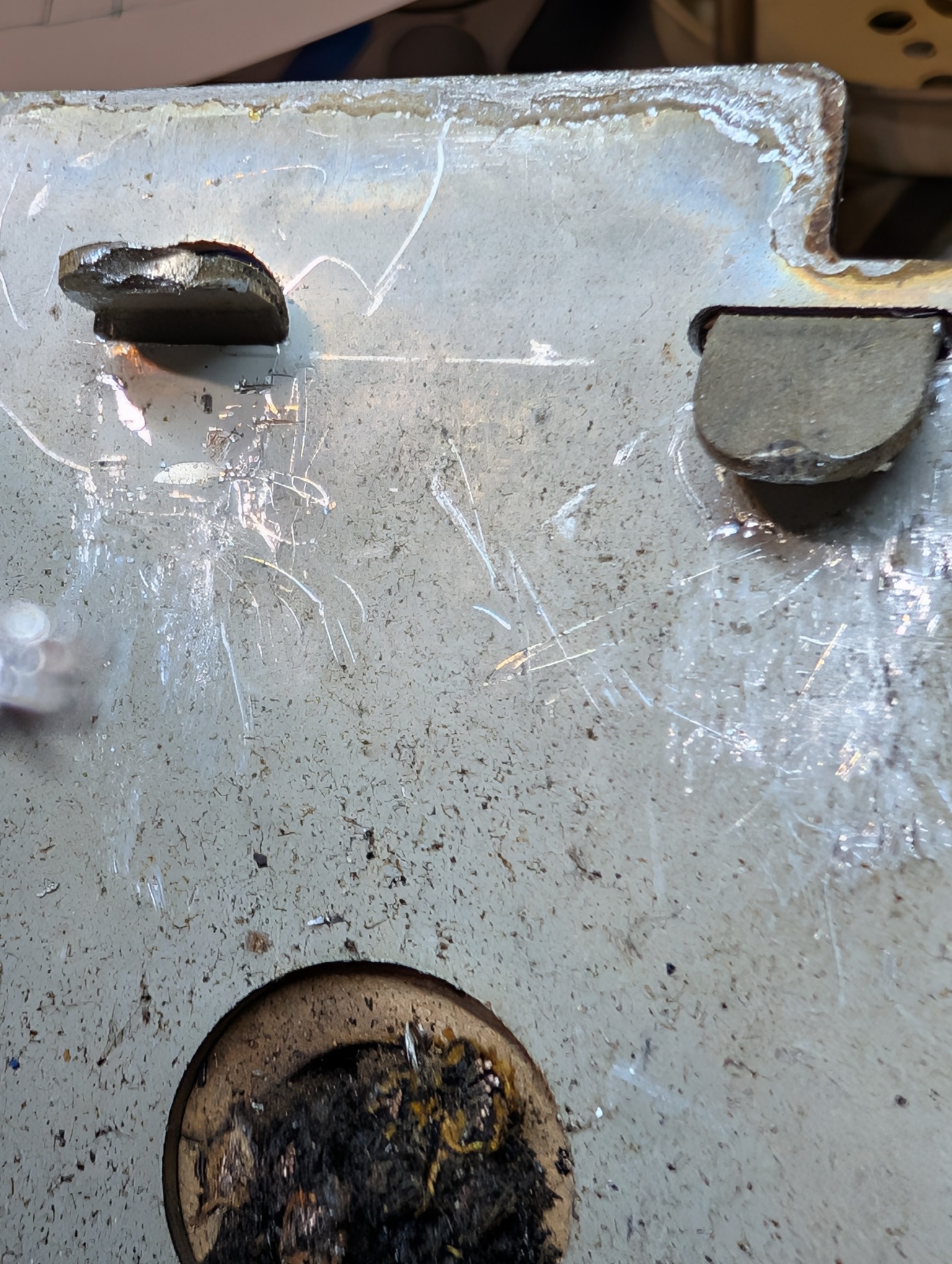

The flush cutter does a good job but I need a narrower one to get under the tabs that have some solder at one end.
So I ordered the rest of the gauges (I have 10mm, so I ordered 4mm, 6mm and 8mm).
The iron set at 300W did the job but I did struggle a bit. The chassis is thick and is a massive heatsink; also, the device is fairly heavy, which is OK in itself, but coupled with the necessity to keep the trigger pressed makes the hand a bit tired if held for more than a minute. But it is fine, it works eventually.
So when the narrower cutter comes, I will use it and the iron to first lift the tab a bit, and then will finish the job with the pry bar and eventually pliers.
Today a narrower flush cutters came, and I was able to take the smaller can out.

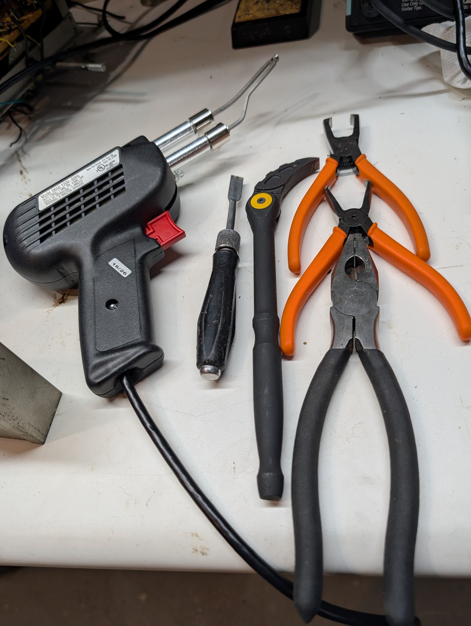

These are the tools I had to use in order to do it.
The flush cutters and the soldering iron allowed to separate the tab from the chassis and lift it a little.
The small chiesel allowed to lift it a bit more.
The lady's foot allowed to bend it some more, though I had to use various angles as the foot itself was stomping on other things around or on an already unbent tab.
And eventually the pliers allowed me to grab the tabes, straighten them out, and the can came out.

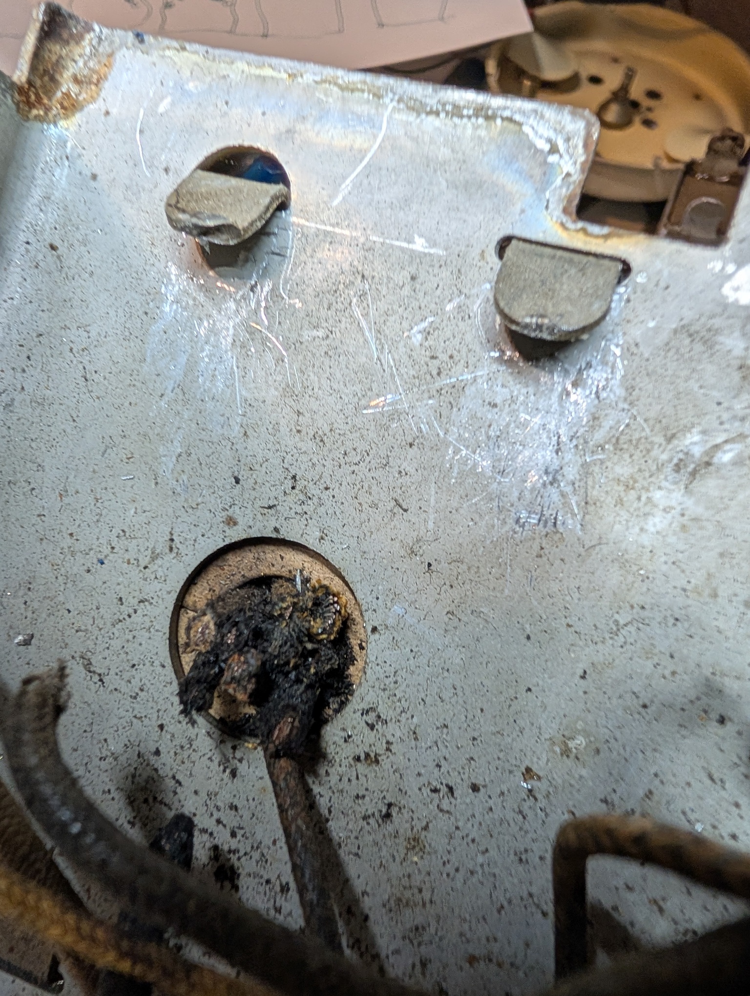

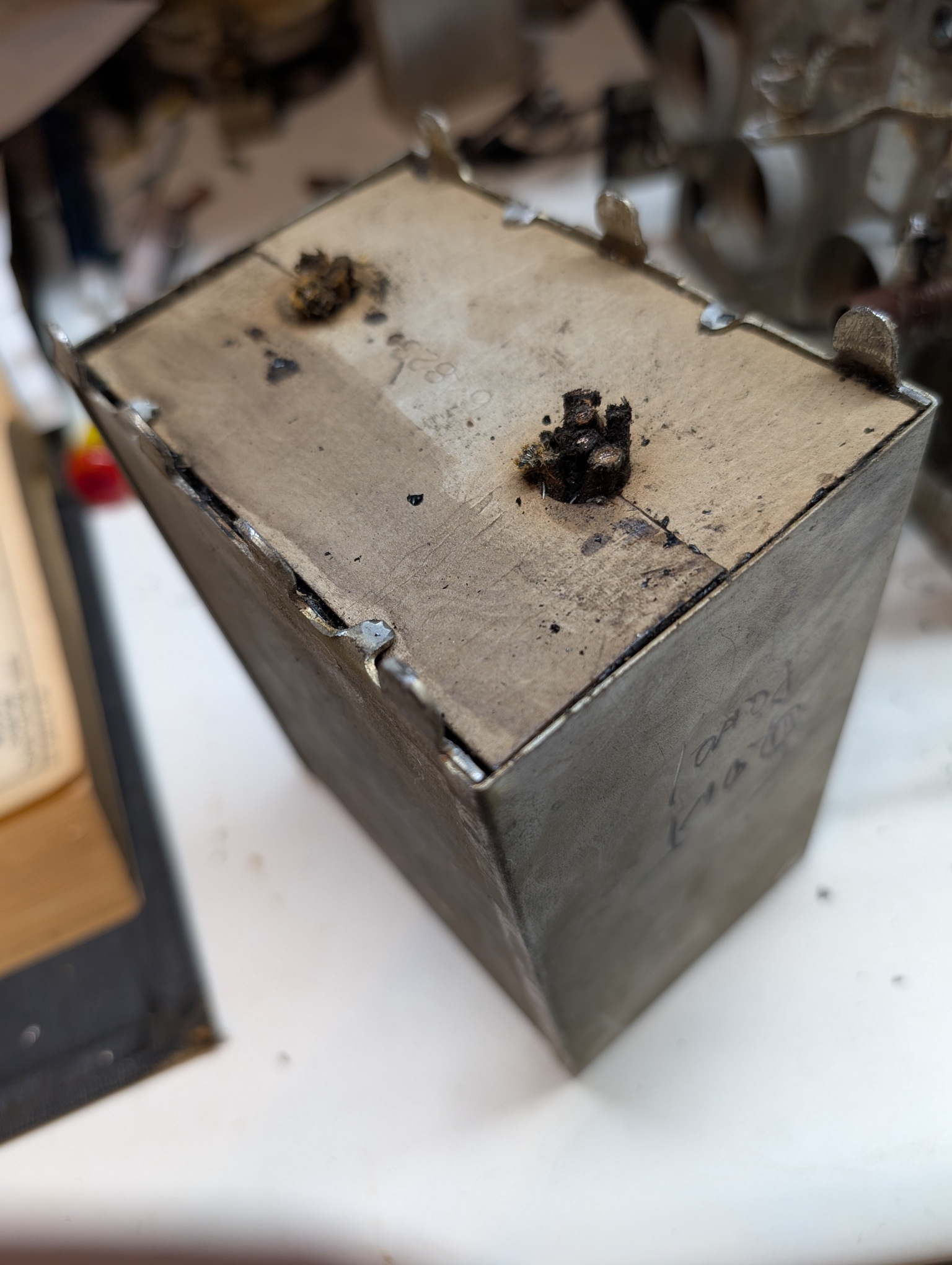

This is what was left:

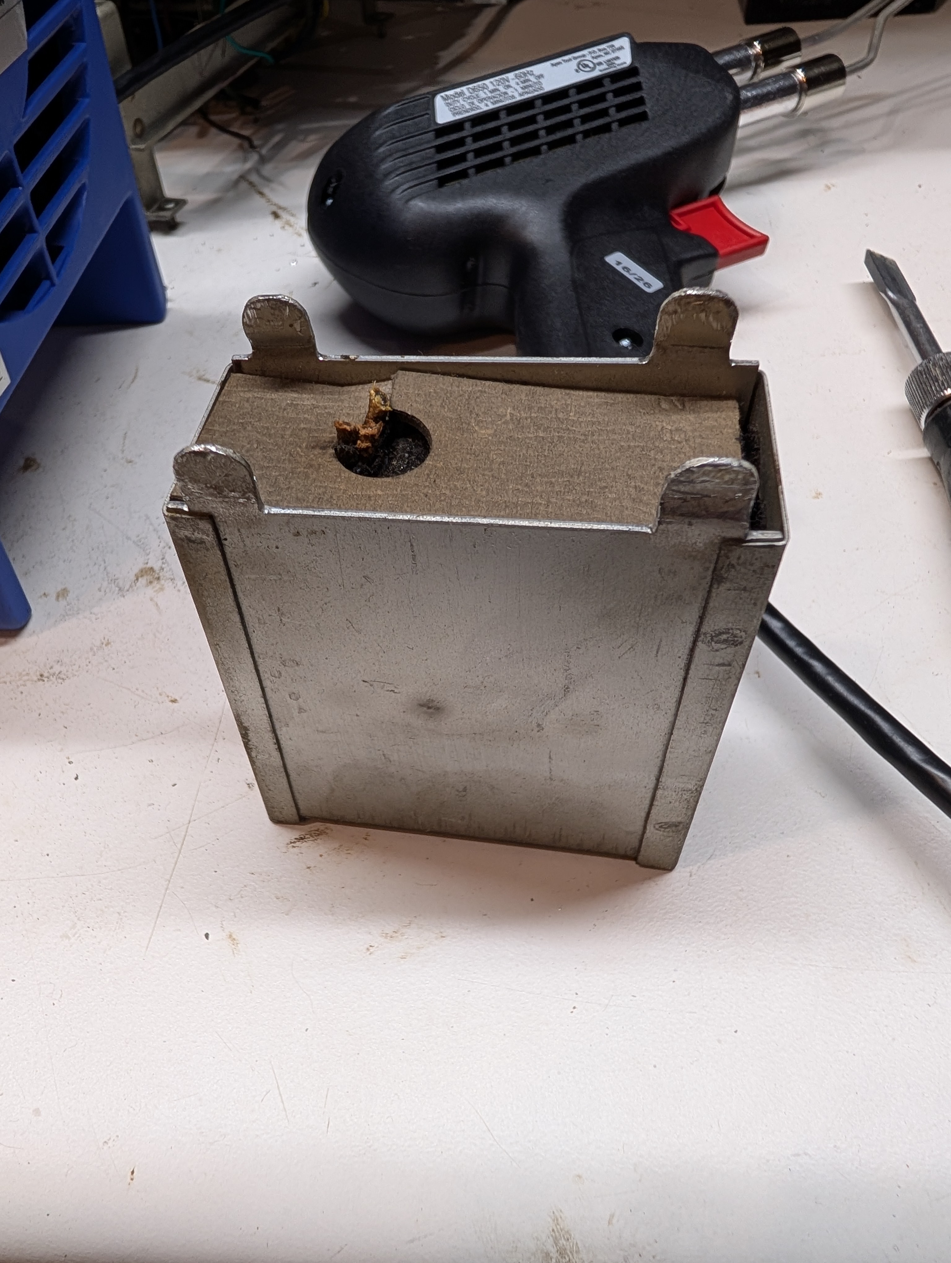

The can

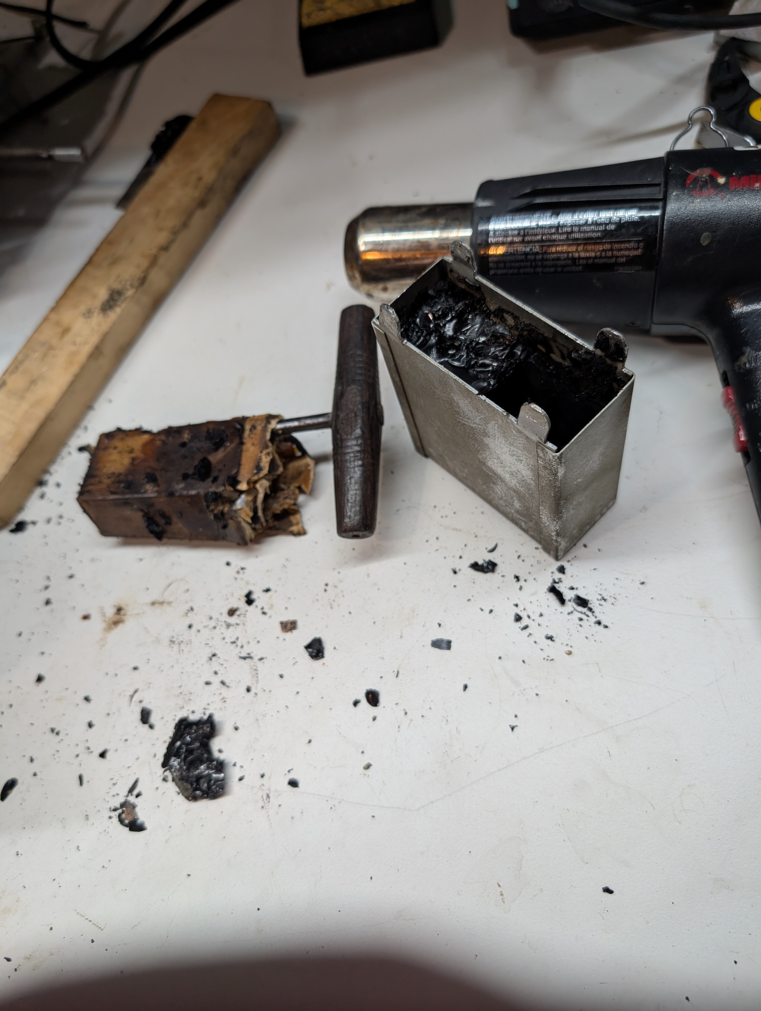

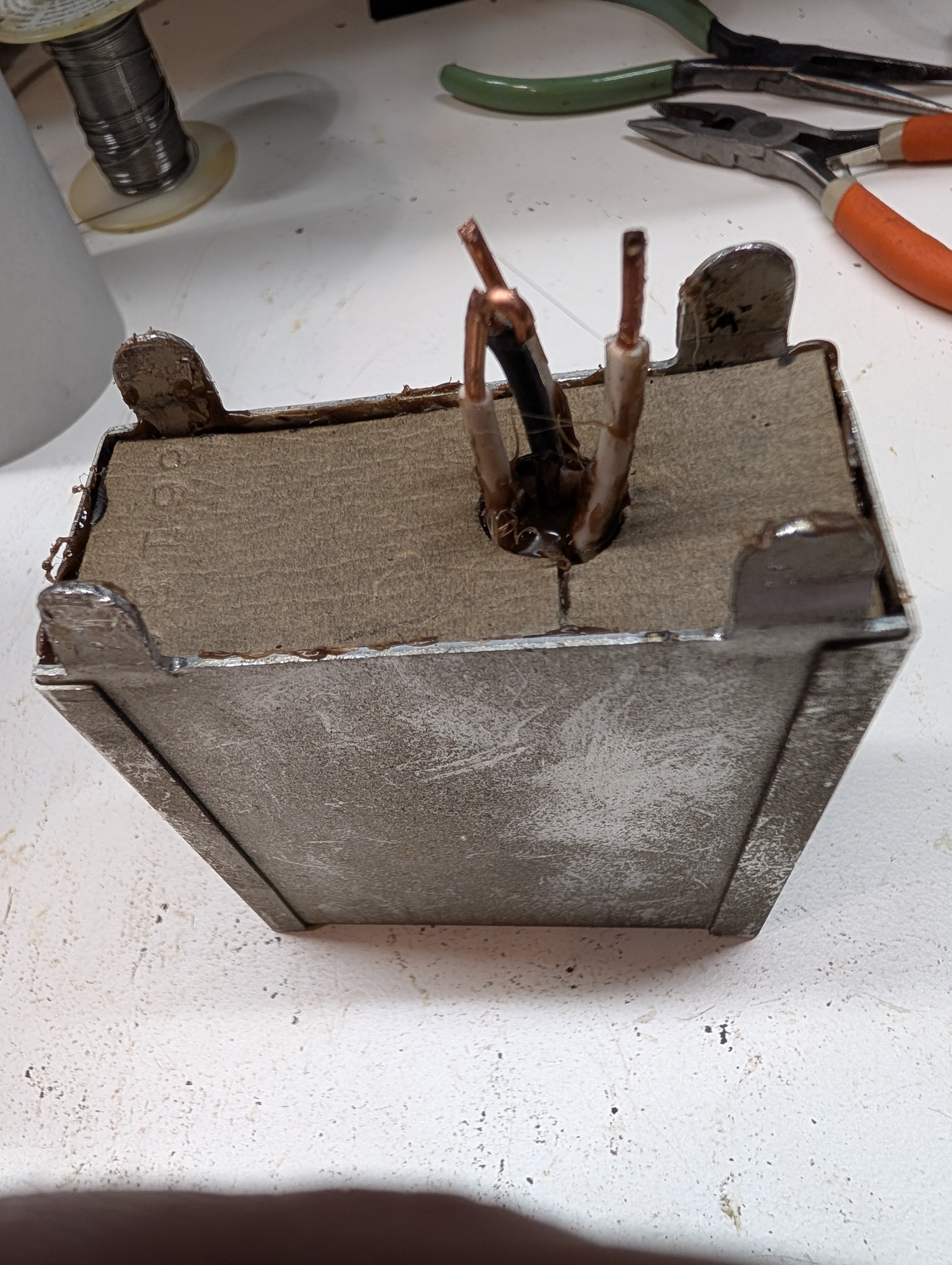

Then I used a heatgun, corkscrew and a wood bar. I heated up the can with the corkscrew in, then hung it between a large vise's grips by the corkscrew's handle and using the wood bar started pulling down on the can. The caps came out.
Only one half of the can was caps, the other just tar. I wonder if I should keep it; probably should.

Good job Mike.
I think I would leave the tar. Should be plenty room for the new caps ,maybe some fish paper around the walls and bottom.
Mike
Yep, that's what I am leaning to.
It is just three caps, so it is enough space with the tar left.
Rebuilt little can.
Took out the big can. Was able to do it fairly quick, now that I have all the tools.
Here's how I did it.

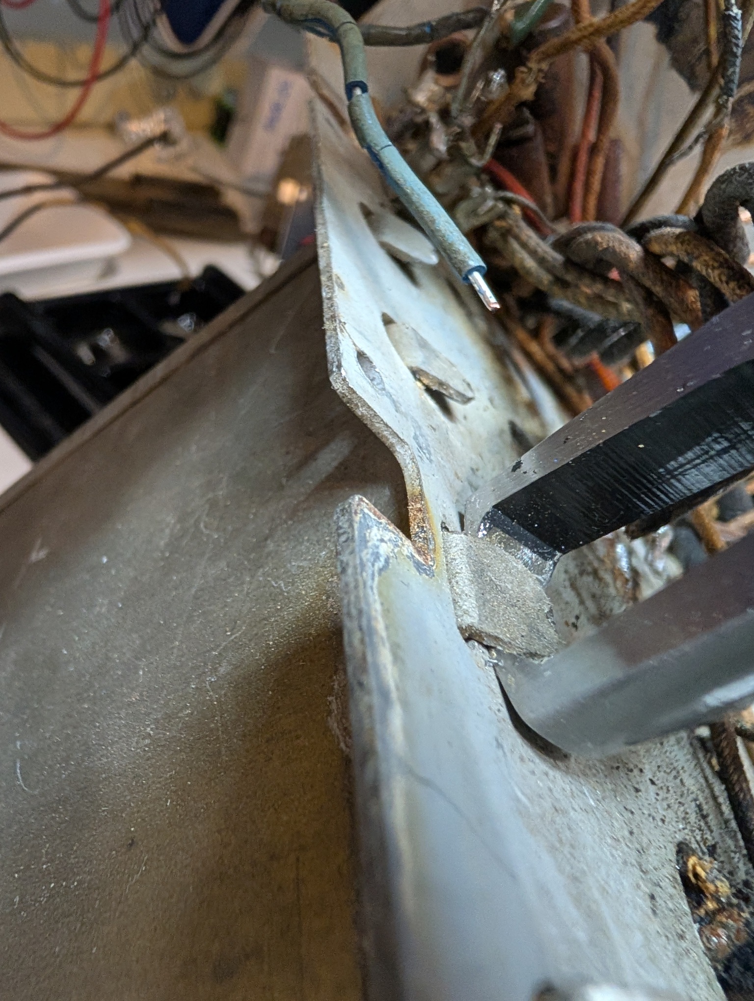

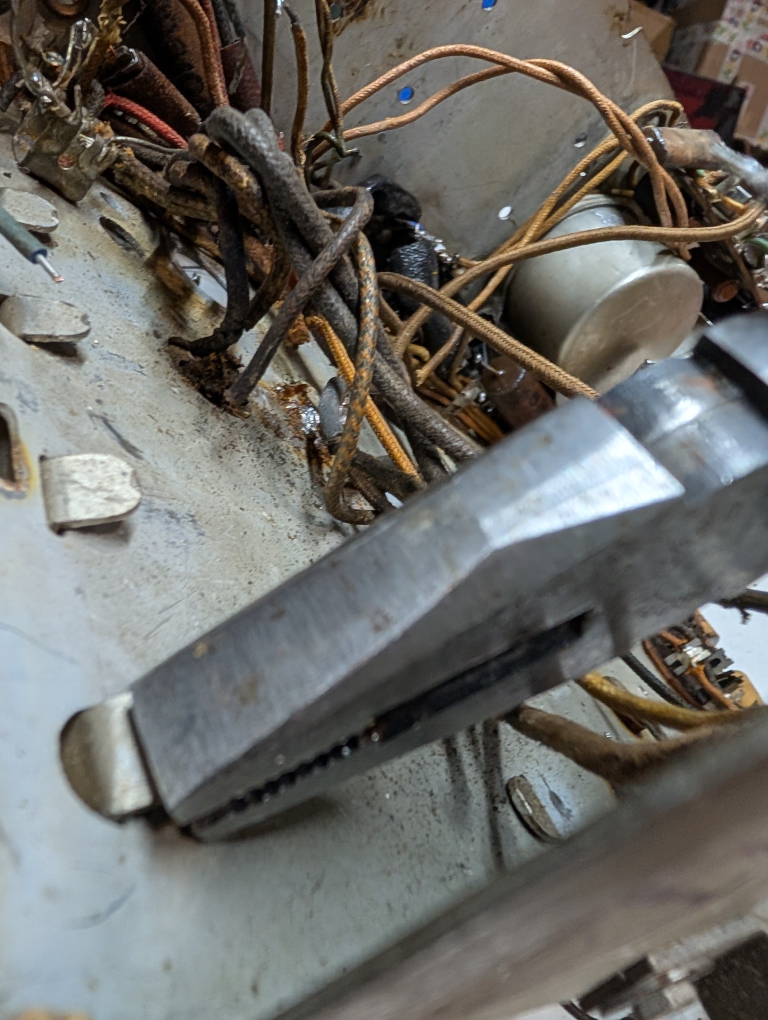

The initial lift is done using flush cutters. Depending on the position, various width tools could be used.
This is the cutter in the position. The idea is, the cutting surfaces get under the tab and then unbend it. The metal of the tool is pretty good, so I did not see any damage to the cutter itself.
Also, unlike a chiesel, it could be operated from the top, when there is little space to use a chiesel, which is long. On the other hand, the chiesel is useful where the cutter would have a handle too close to a chassis wall and could not be positioned well.
The more tools you have, the more flexible the choices are.

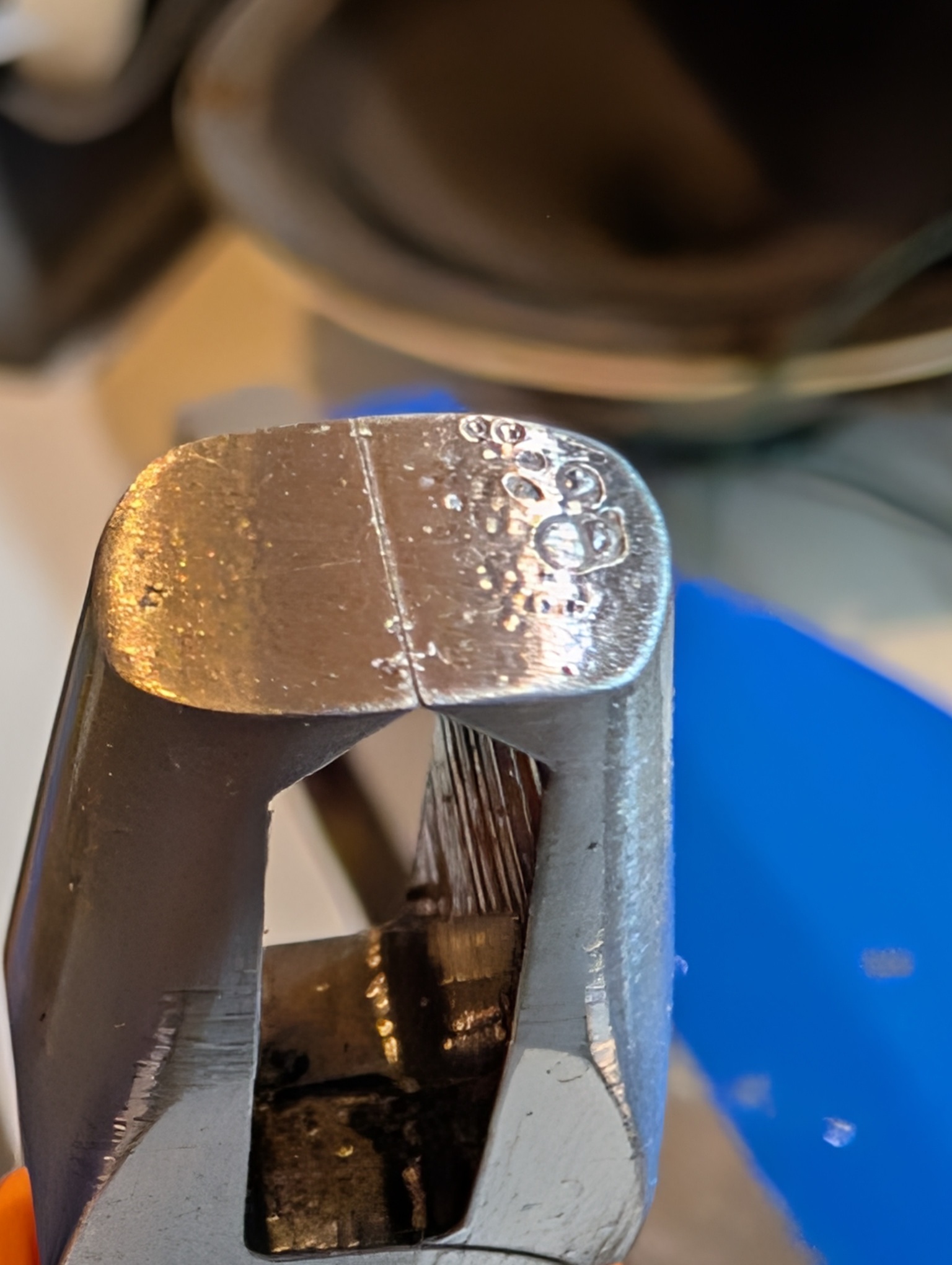

This is what flush cutter is:
And the surface of it is smooth. Unlike the regular cutter, the groove is inside and the cutting surfaces are on the outside.

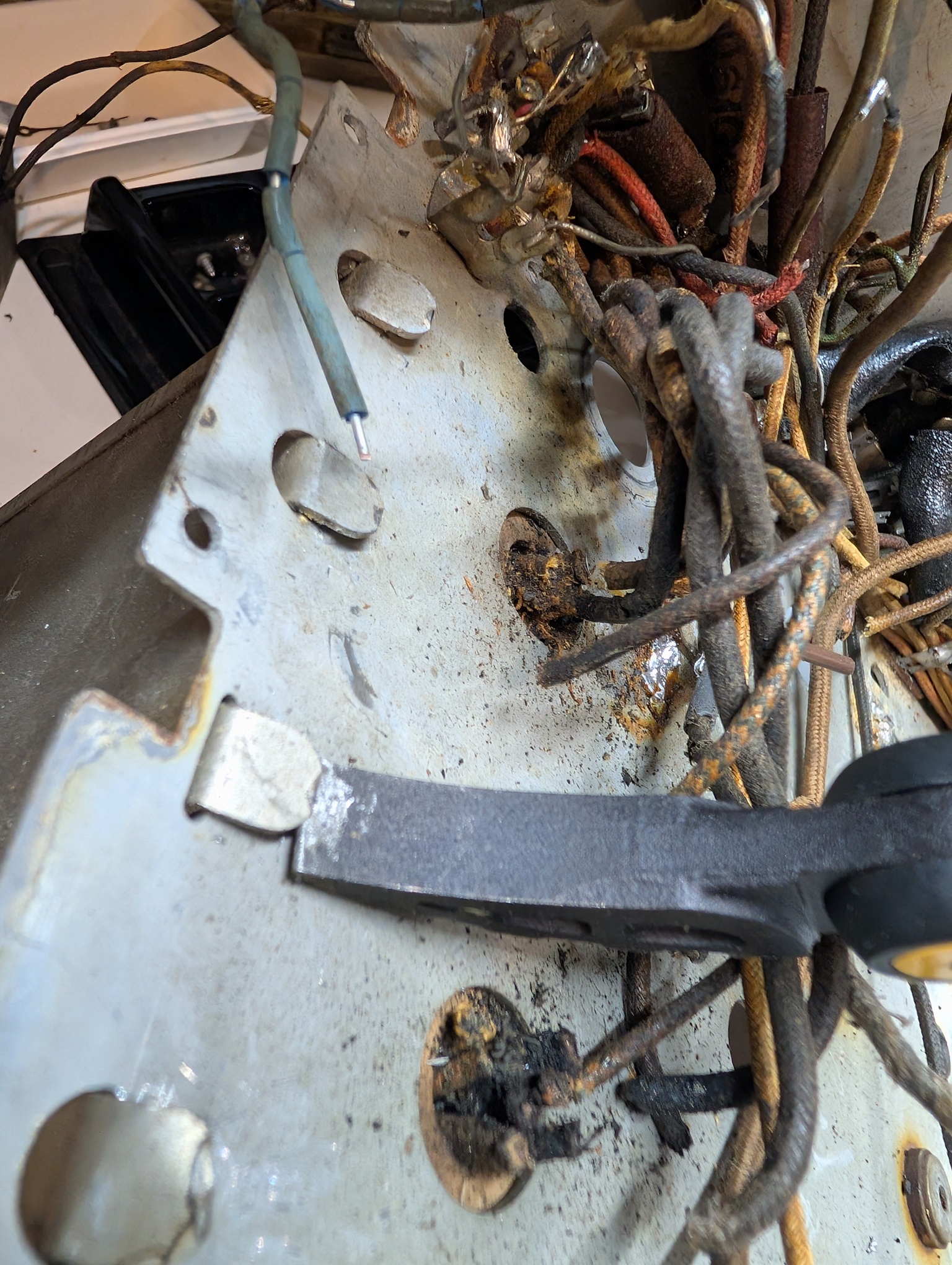

Then I proceed with a prying "lady's shoe" tool.
It brings it to this position

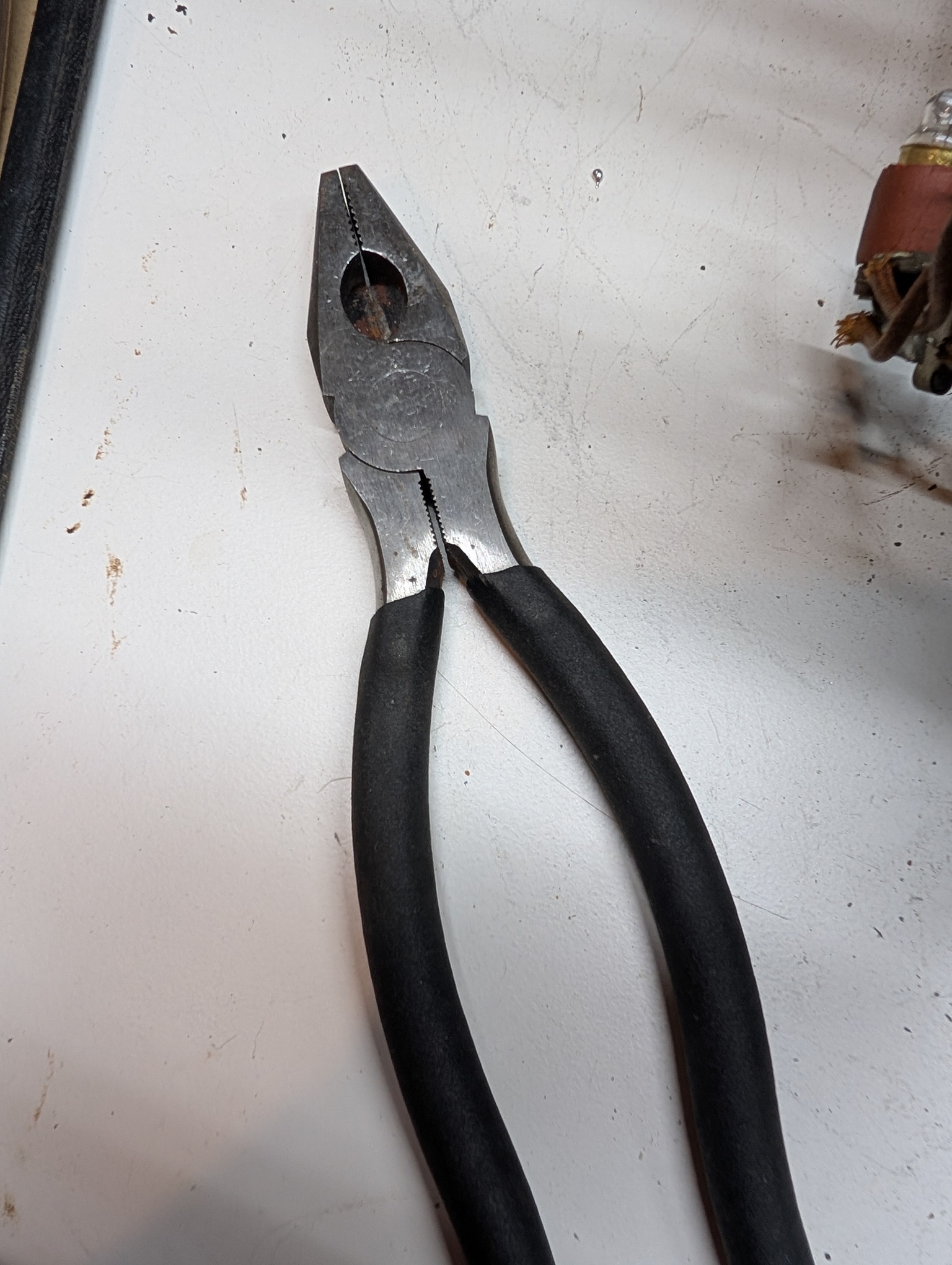

Then I proceed with regular pliers:
And straighten it out:

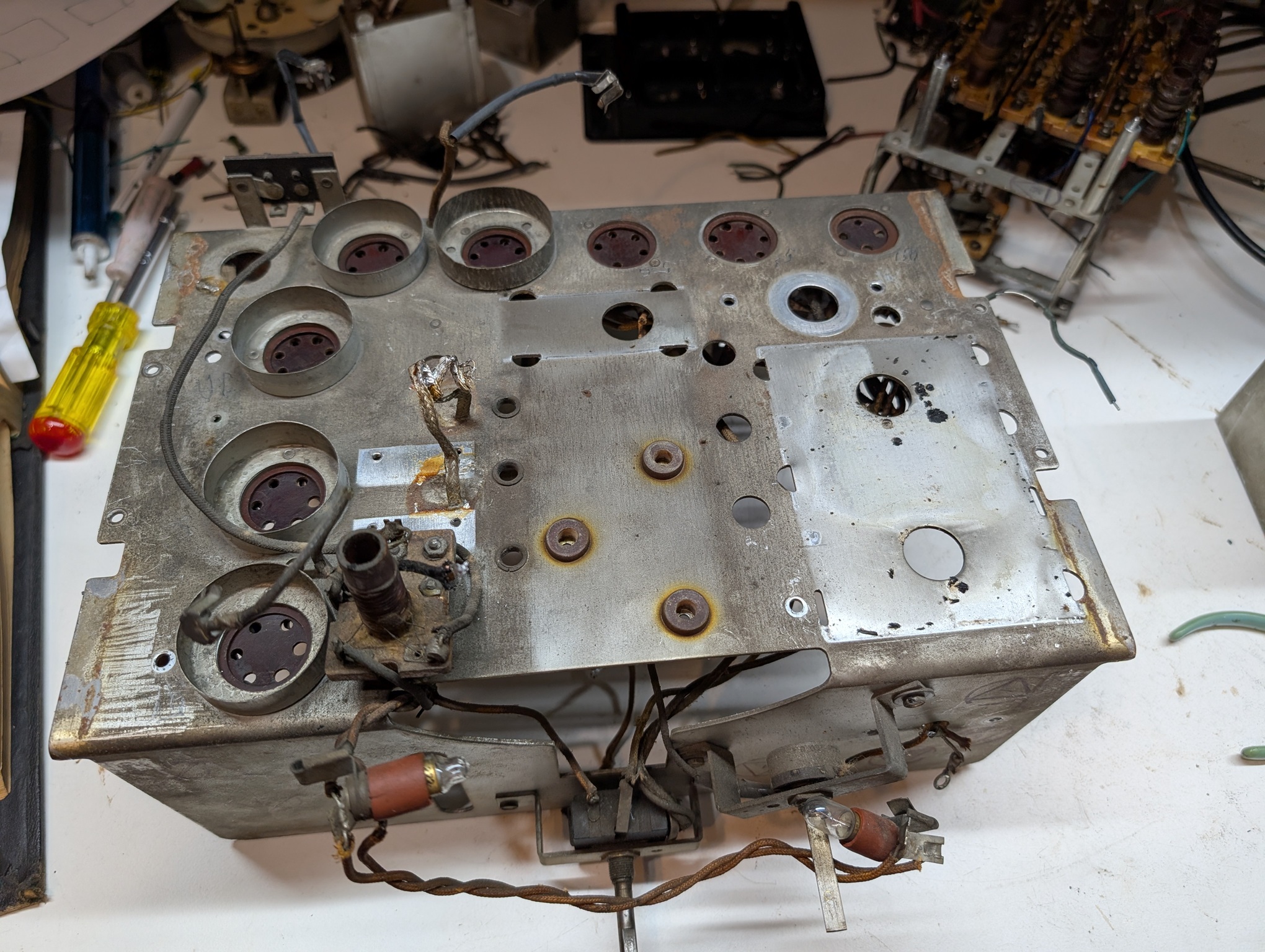

The big can is out:
The chassis is ready for cleaning, now that I have very few things left on it:
The can weighs at least 8lbs. Heavy.
