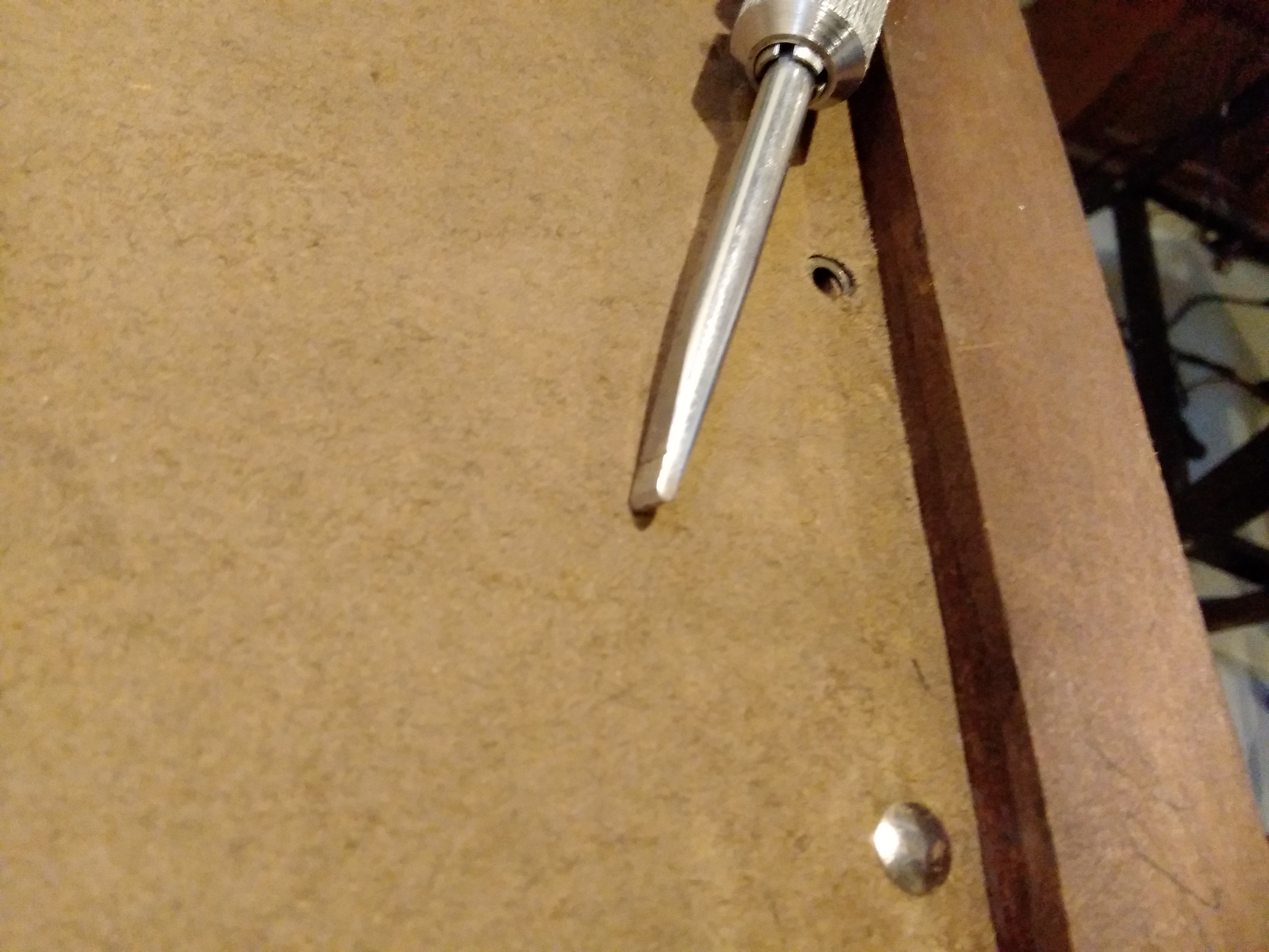

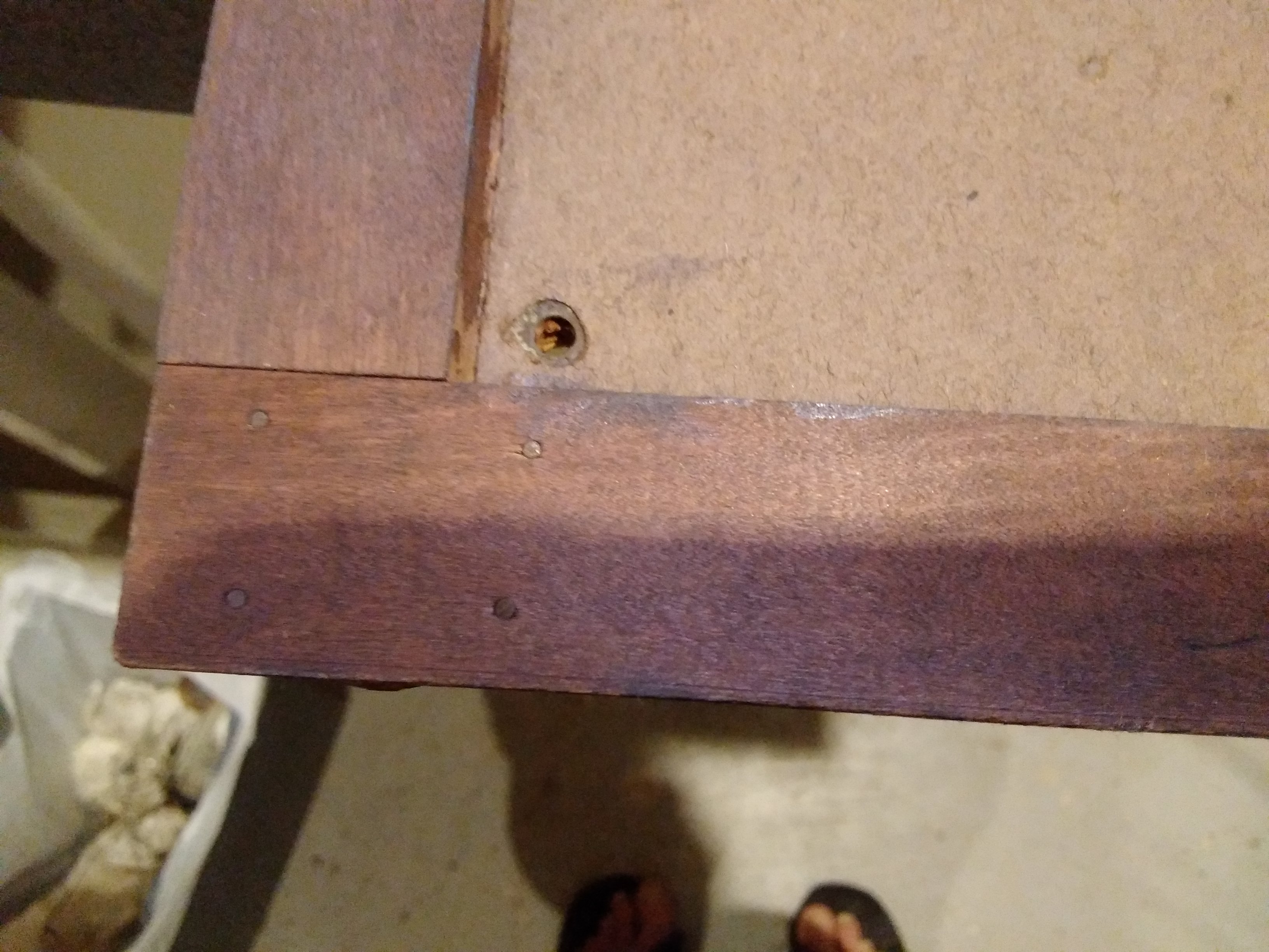

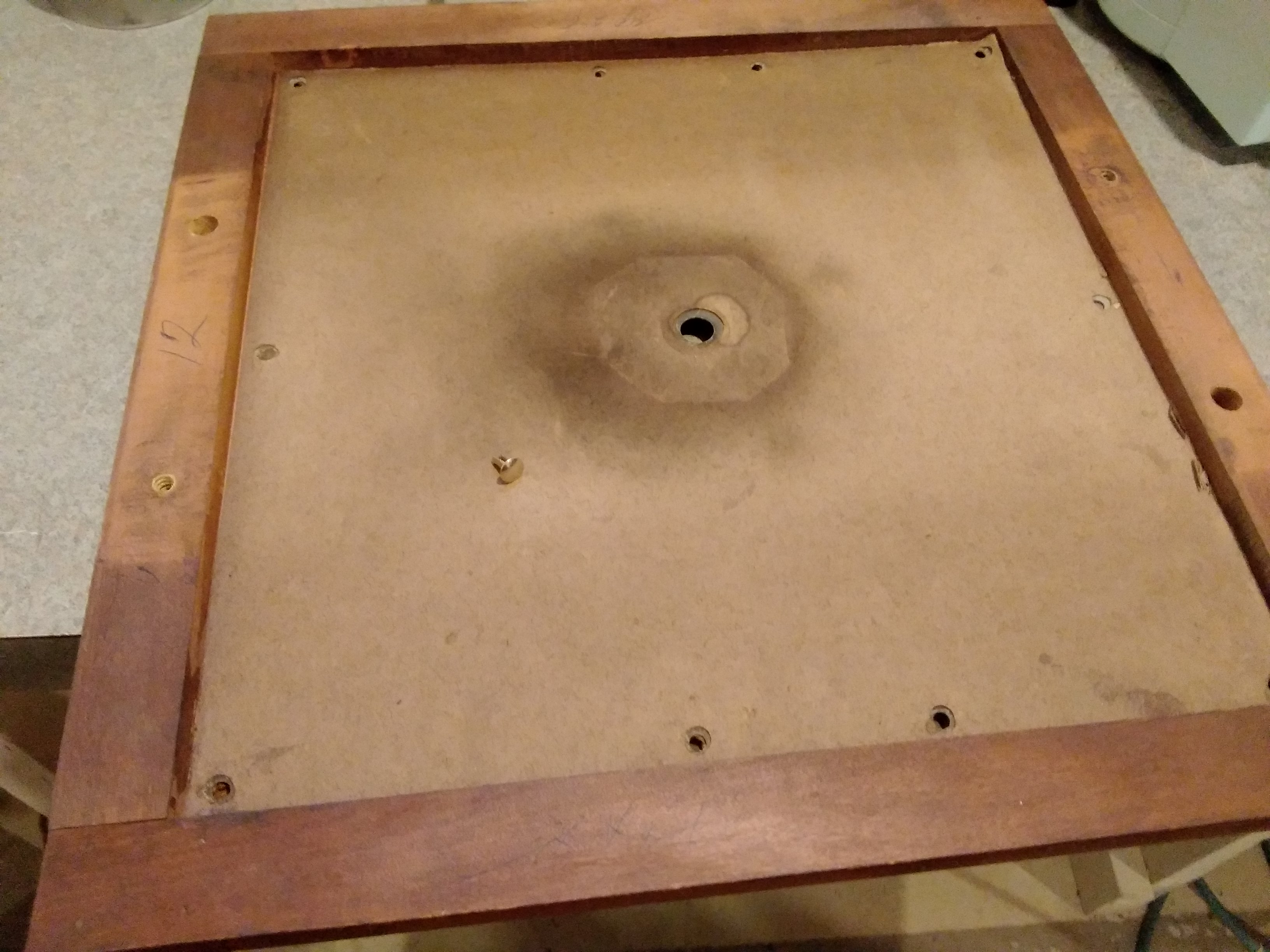

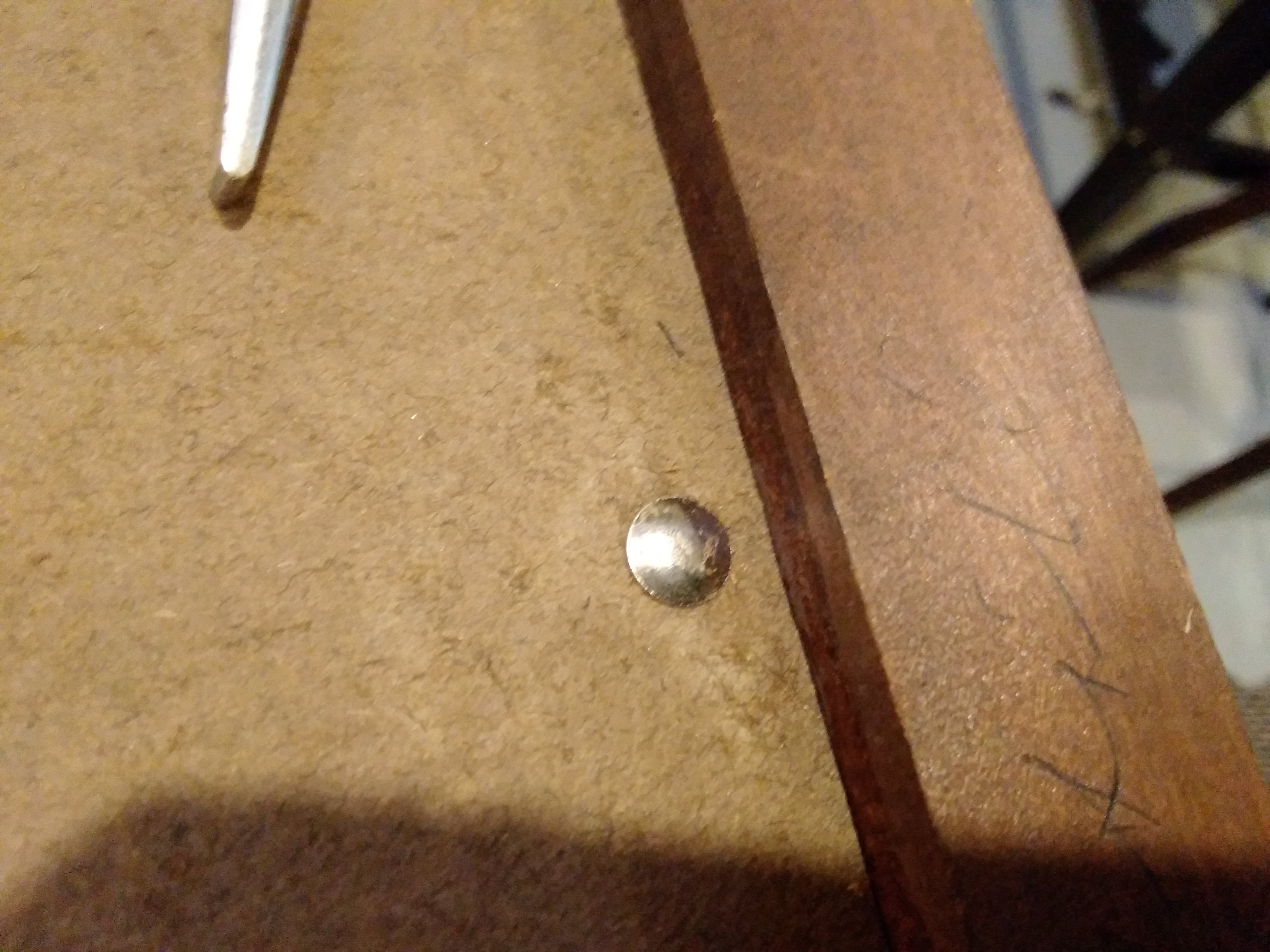

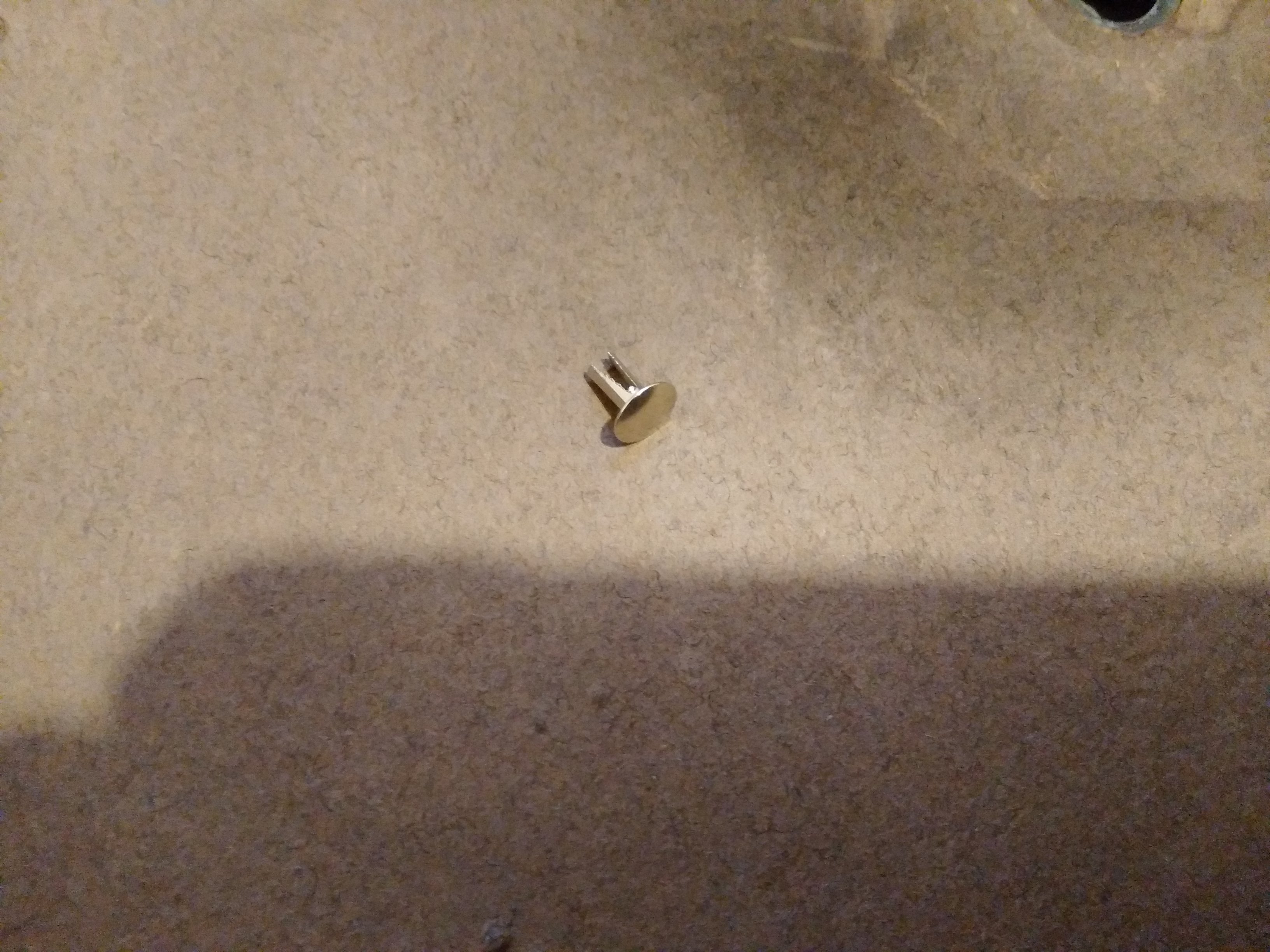

So I tried the split pins.
Though the diameter was exactly right, stainless against wood provides very little retaining force.
So I used a wedge tool to split the pin further.
The pin then has to be aligned and compressed a bit to start getting into the hole. Or maybe the end of it ground to form a chamfer. Or maybe the wooden hole slightly countersunk at the top. Just to start guiding the wider split pin.
The result is acceptable.
At the end, I think it might be a better choice for this particular goal than the one from the Renovated Radios, the reason being, the latter, if does not provide retaining action, cannot be split anymore being plastic, whereas the metal one can.

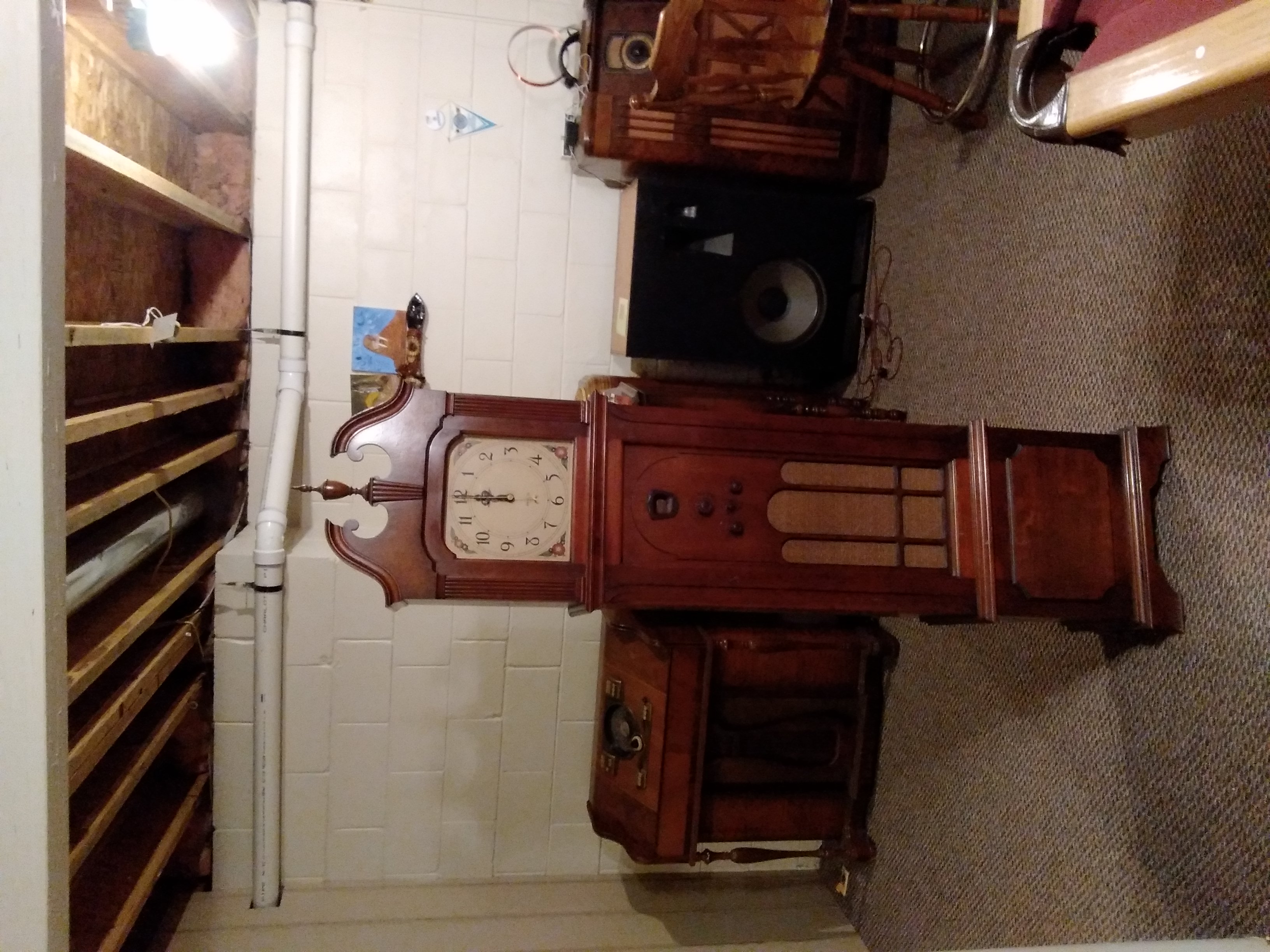

The clock came back this morning.
It is being quarantined for 4hrs in the garage, and then will go to the shop.
It works.
Haven't checked the timekeeping yet.
The trippler does not take the new plugs so I have to plug the cords separately.
I also have to come up with a fuse box, the wire nuts inside that can do not make me confident.
So...
What I am pondering is....
The clock is working well.
So does the radio.
I am not in the habit of keeping my radios plugged in, as I do not want to drill holes and install fuses, and the radio without a fuse is a fire hazard.
So, I resort to plugging them into power strip that are off. If I want to listen to a radio, I turn the respective strip on.
However this done to a clock means the clock being, well.....useless.
This is why I thought plugging the radio and the clock to a fused strip. Like 1.5A - 2A, fast action, should be adequate.
I cannot seem to find anything like it.
I can make one myself, taking a 2-outlet metal box, placing two outlets in it, putting a fuseholder...well, 2 fuseholders, to protect the radio and the clock separately.
I have to exclude the original tripler mount on the wall from the picture. It does not accept modern polarized plugs.
But before I make a project out of it, I would like to make sure there is no off-the-shelf solution.
The fact that I haven't found one does not mean it does not exist.
Anyone knows of something of that sort?
Like a fused tripple plug adapter? Or anything suitable?
