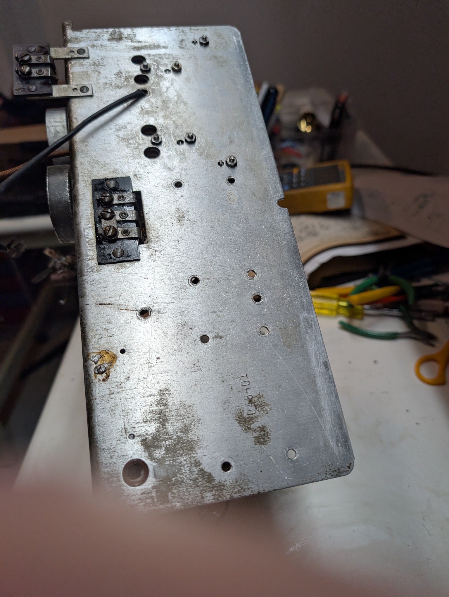

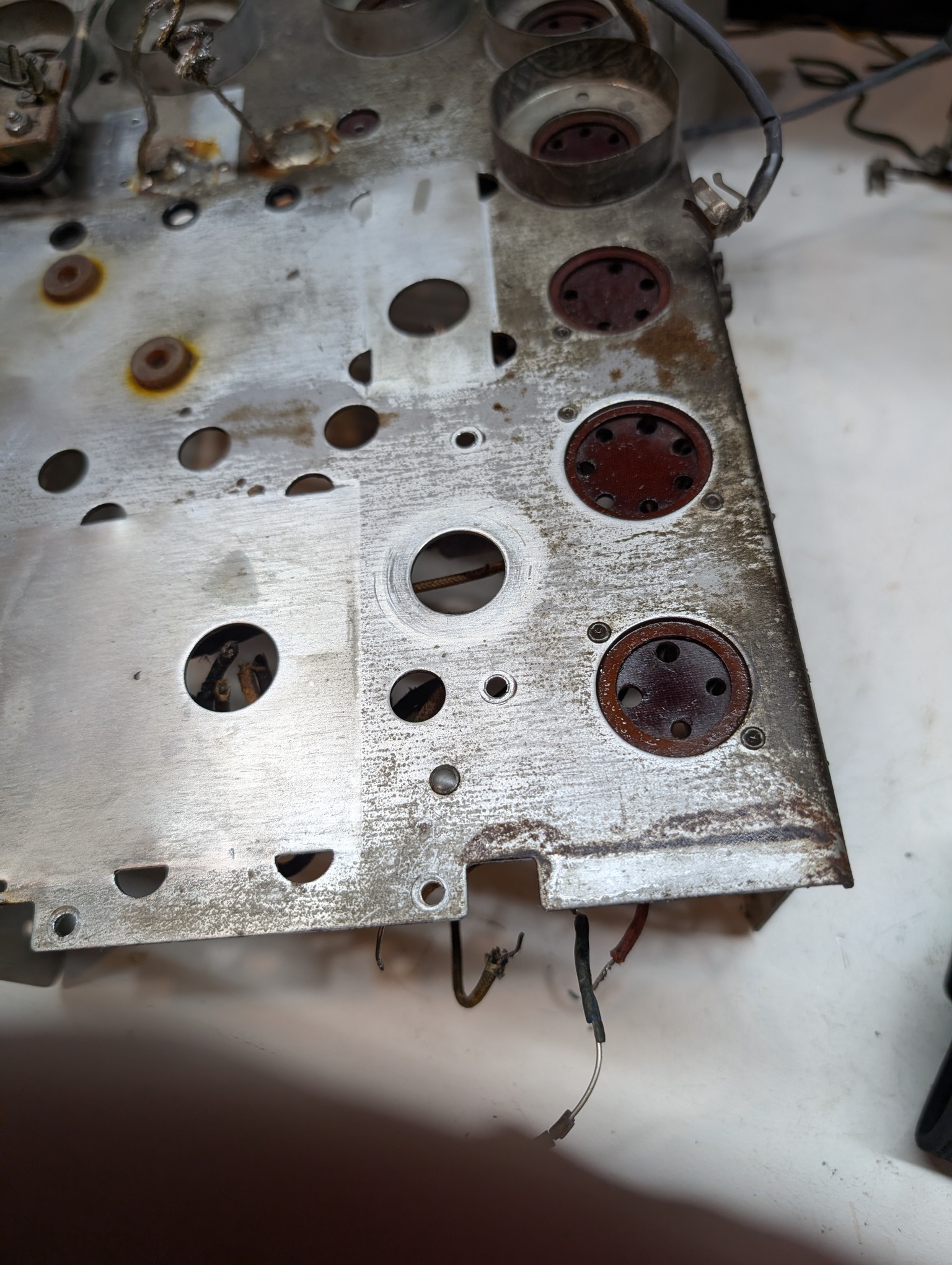

Does anyone know what to clean a cadmium plated chassis (I assume that this is cad plated) without removing the cadmium?
It has 1) C12, 4uF for 2nd RF cathode feedback, 2) C49, 10uF for 2nd Det cathode feedback and 3) C39, 10uF for LC power filter for B+ that goes everywhere other than the pushpull output power.
I had some reasonably modern saved axials (a Xicon 4.7uf, a Rubicon and an IC 10uF) I extracted from the radios I restored before, where they were out of place, so I used them; tthsy are all 450 or 500V. I just wanted to use them up; the first two cap can be 25-50V rated.
MrFixr
I do not make my chassis' look like they just left the factory's division intended for export to royals around the world, so, being not very proud guy, I use Windex, and when Windex struggles, I use odorless (???!!!) mineral spirits.
Neither is known to strip cadmium.
The OMS did a great job on hat smaller can, the photo of which I will show here later.

I restored a Phonola chassis from Italy that was cadmium and completely coated with the oxide. I used a diluted mixture of Naval Jelly and water applied with an acid brush. The oxide was everywhere so the brush was really effective. I could see where the oxide didn't appear on some of the parts that were stainless or maybe plated, like the tube sockets.
Cleaning.
So, Windex works some.
So does OMS.
Eventually, I applied some Goop and it did some extra work, judging by the result and the way the paper towel looked after wiping it off.

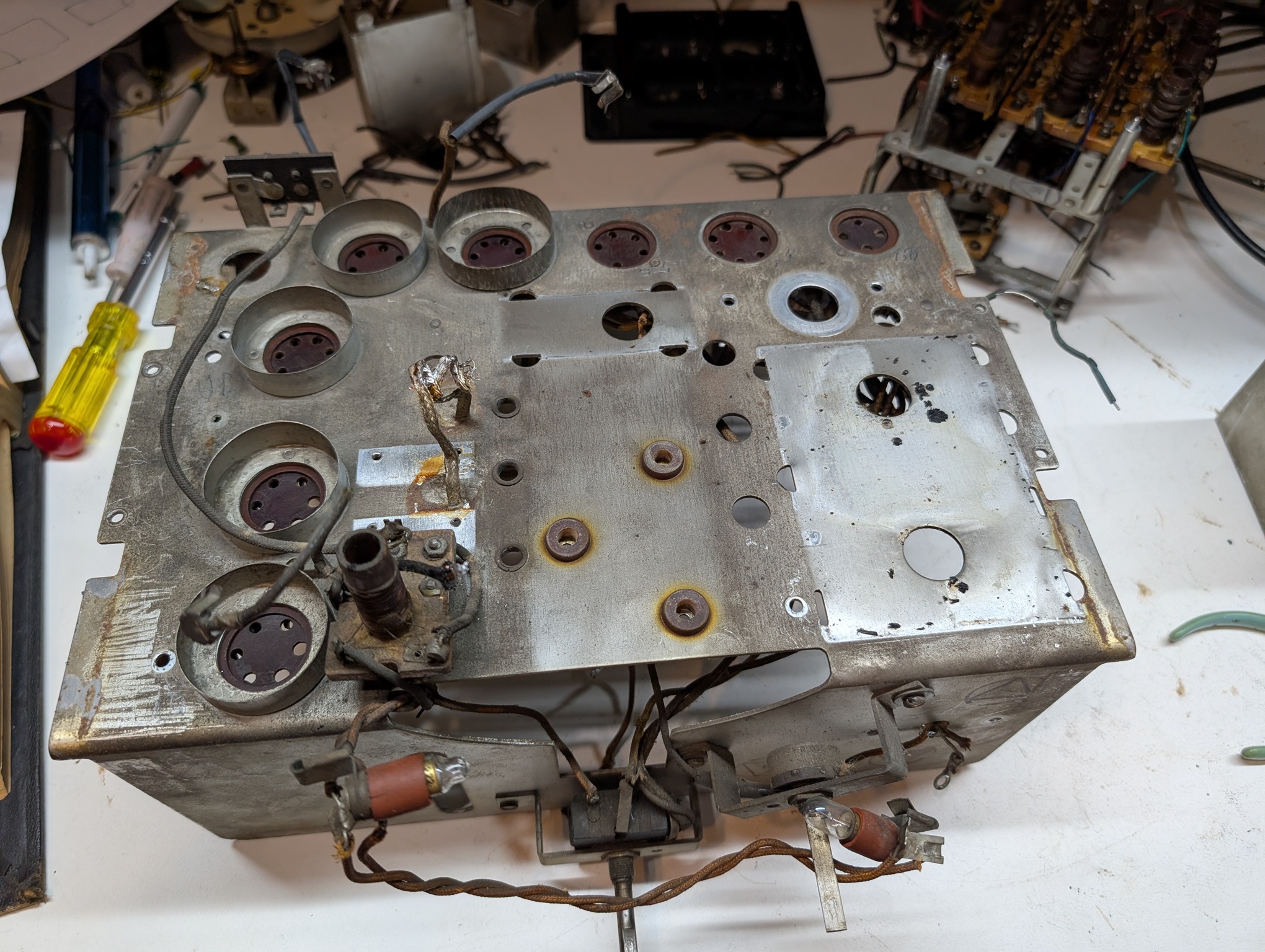

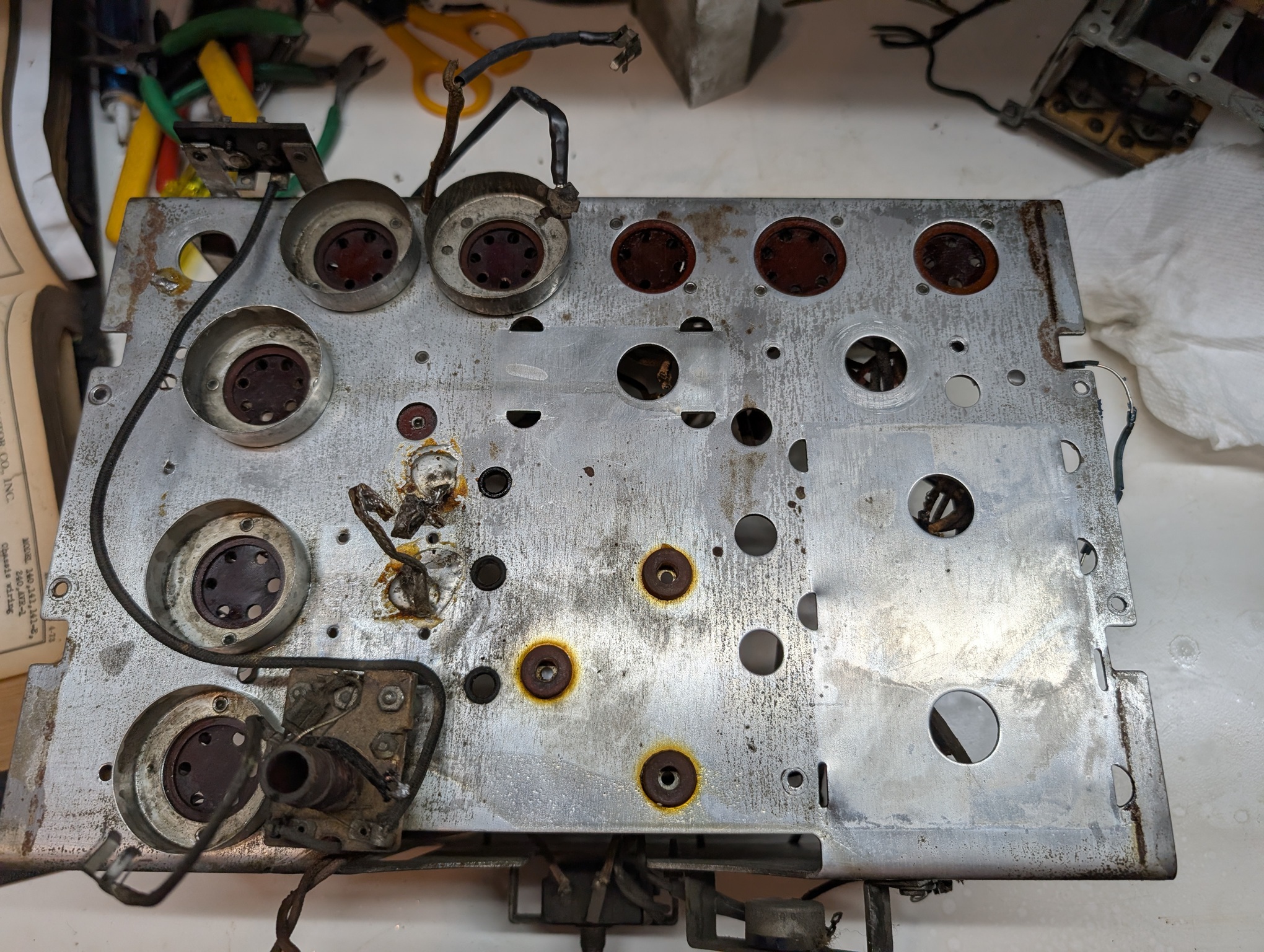

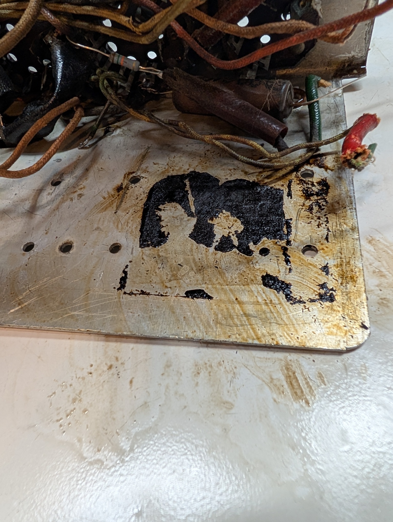

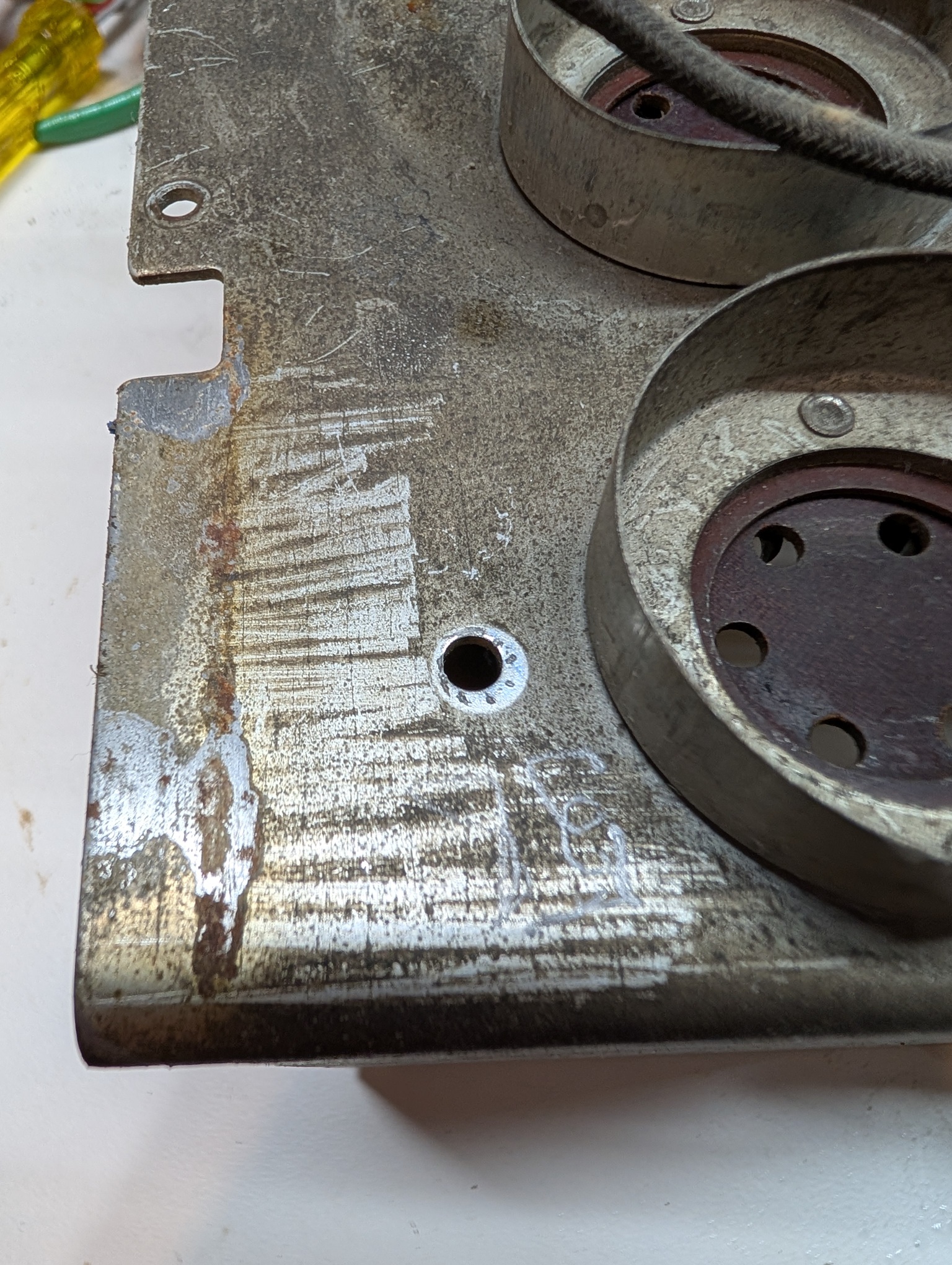

So, this is the way the top looked before cleaning.

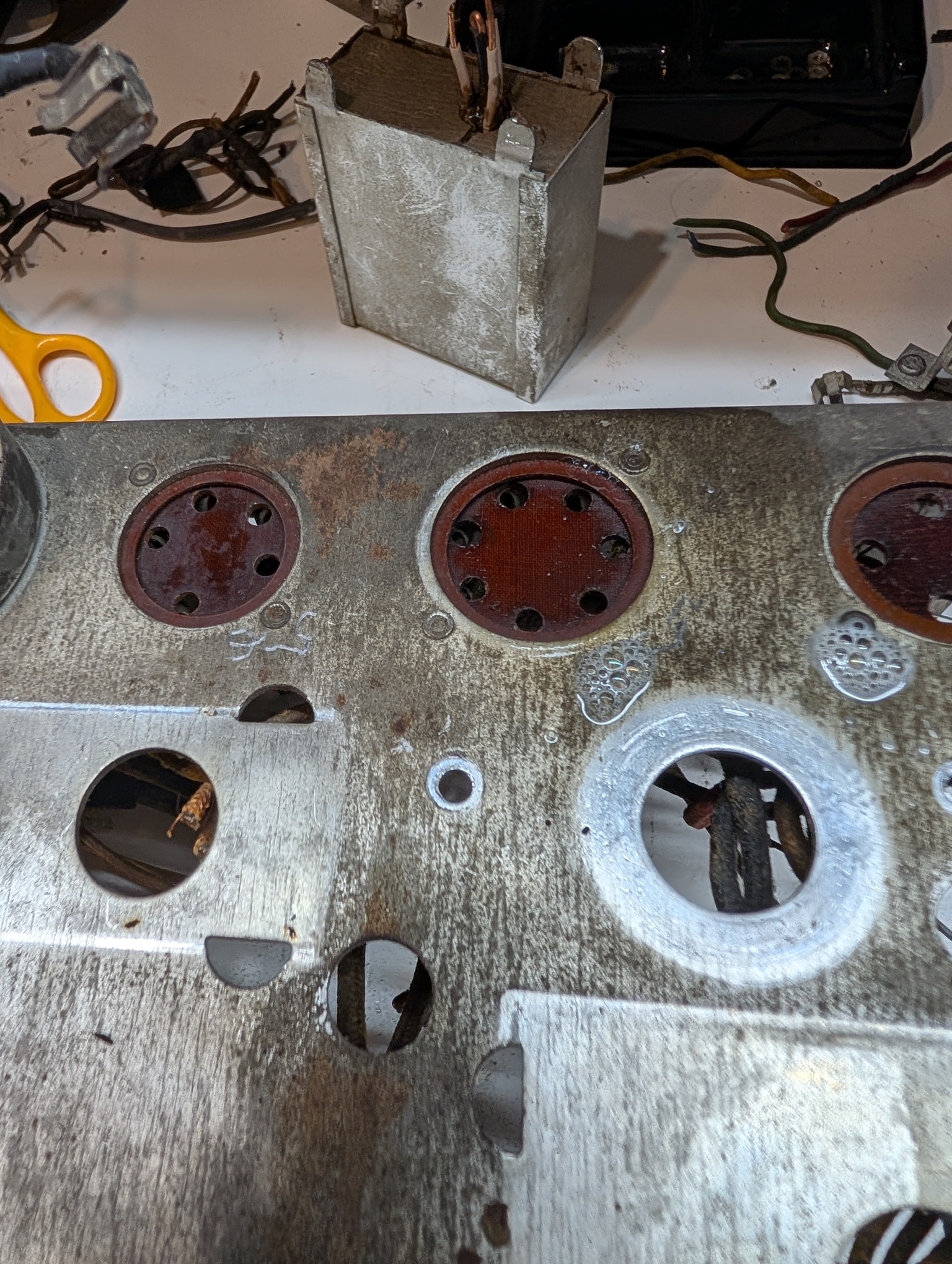

After some cleaning with OMS
And after Goop and some OMS. The surface has some pitting, and so whatever is inside it, does not come out, not with toothbrush, or anything else. And judging by the paper stayingclean after wiping, I decided that the perfect is the enemy of good enough.

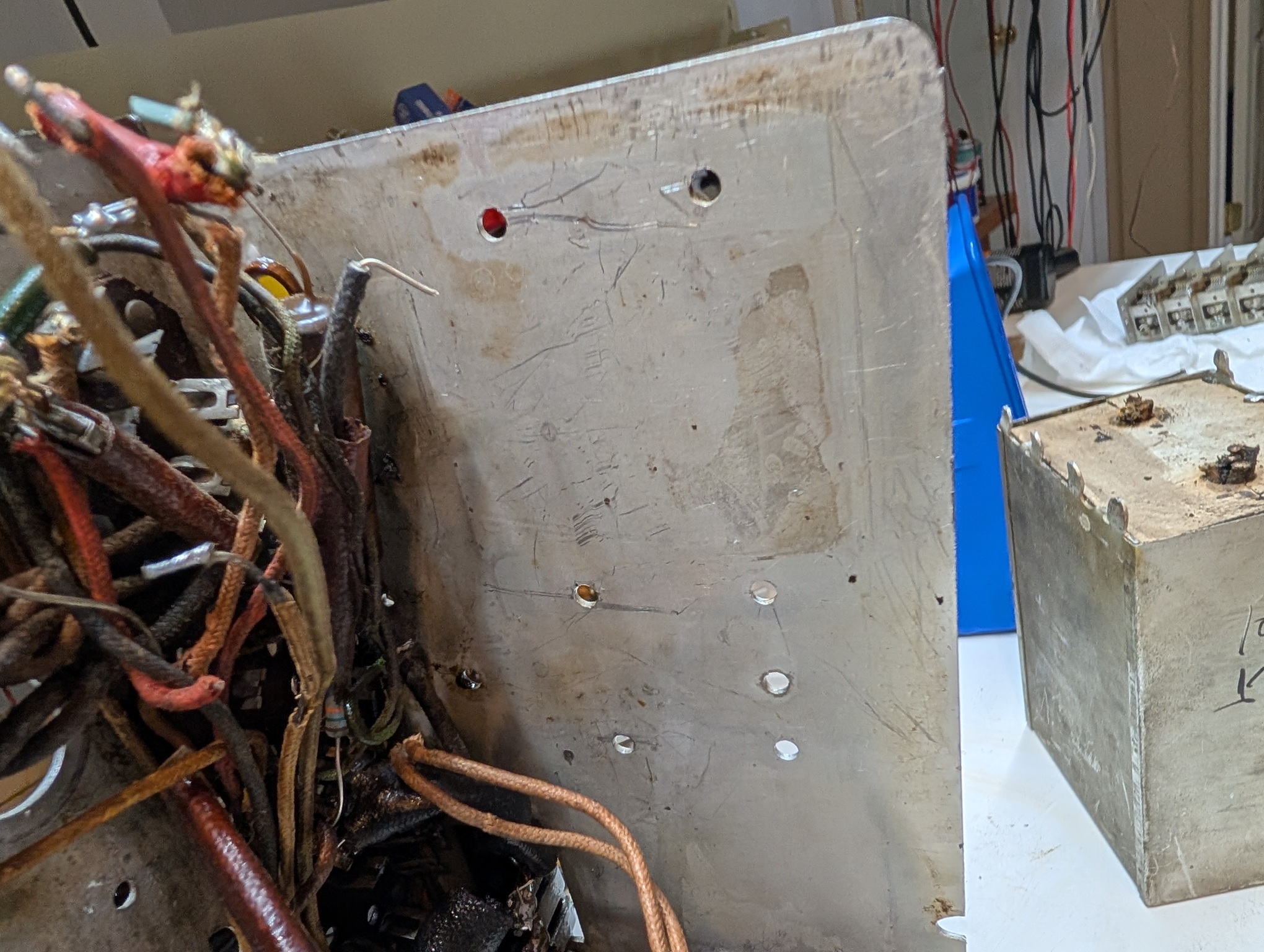

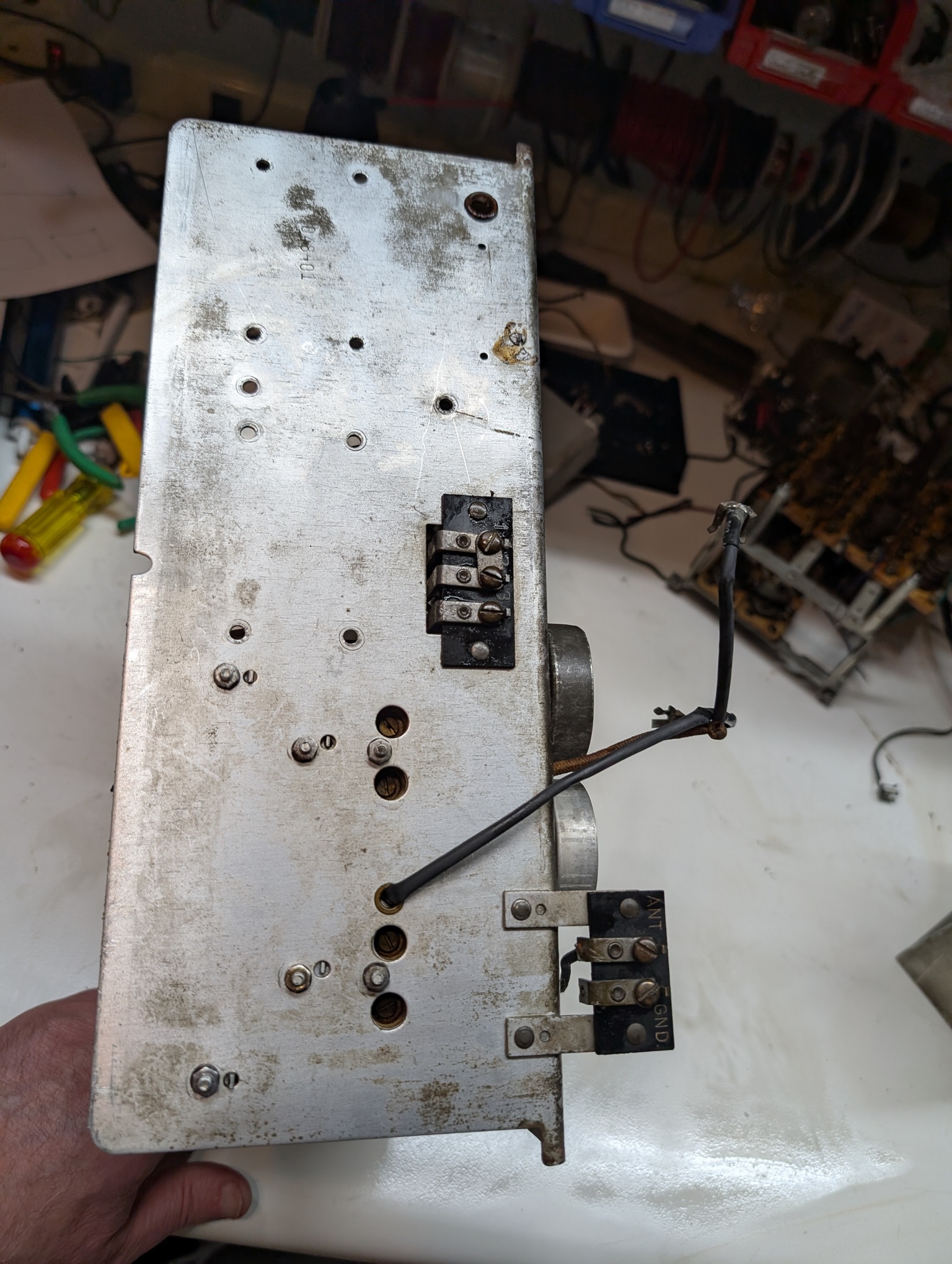

The rear after OMS
And then after Goop and OMS

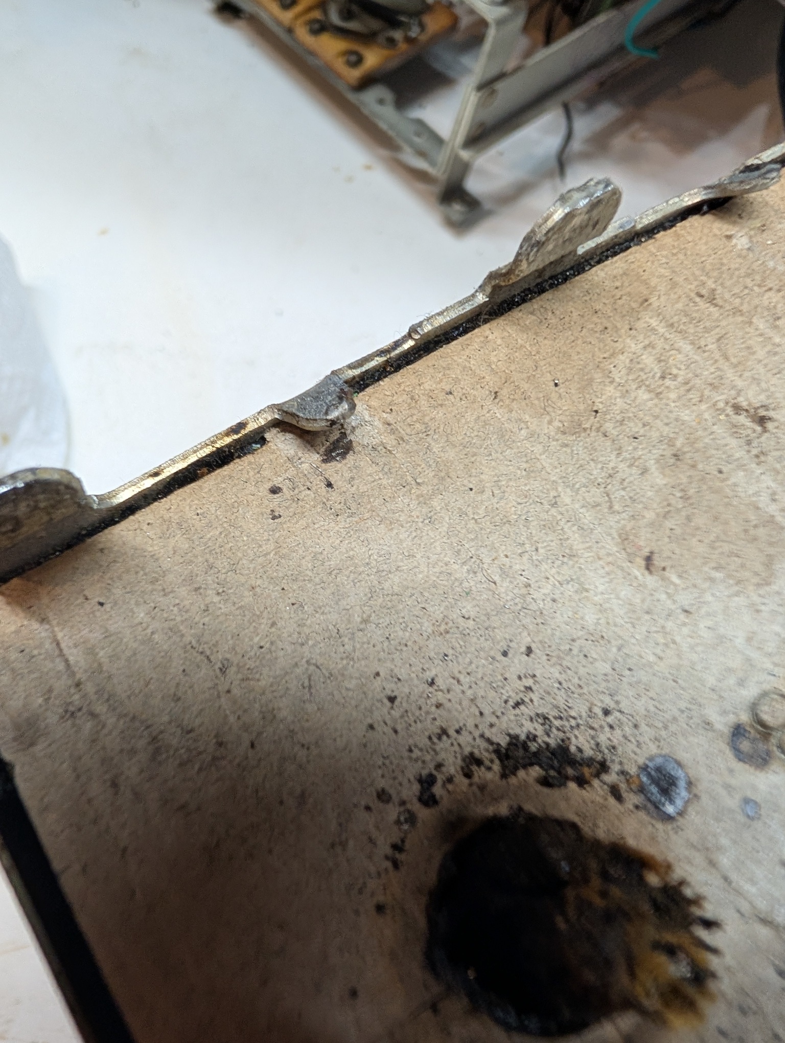

And, eventually, the can is prepped for freezing. Needed unbending the small tabes holding the paper cover.
I wrapped it in two plastic bags and stuck in the freezer box.
When extracted, I will try to use a wood square and a hammer and give it some taps all around the sides, to try rto break the bond.

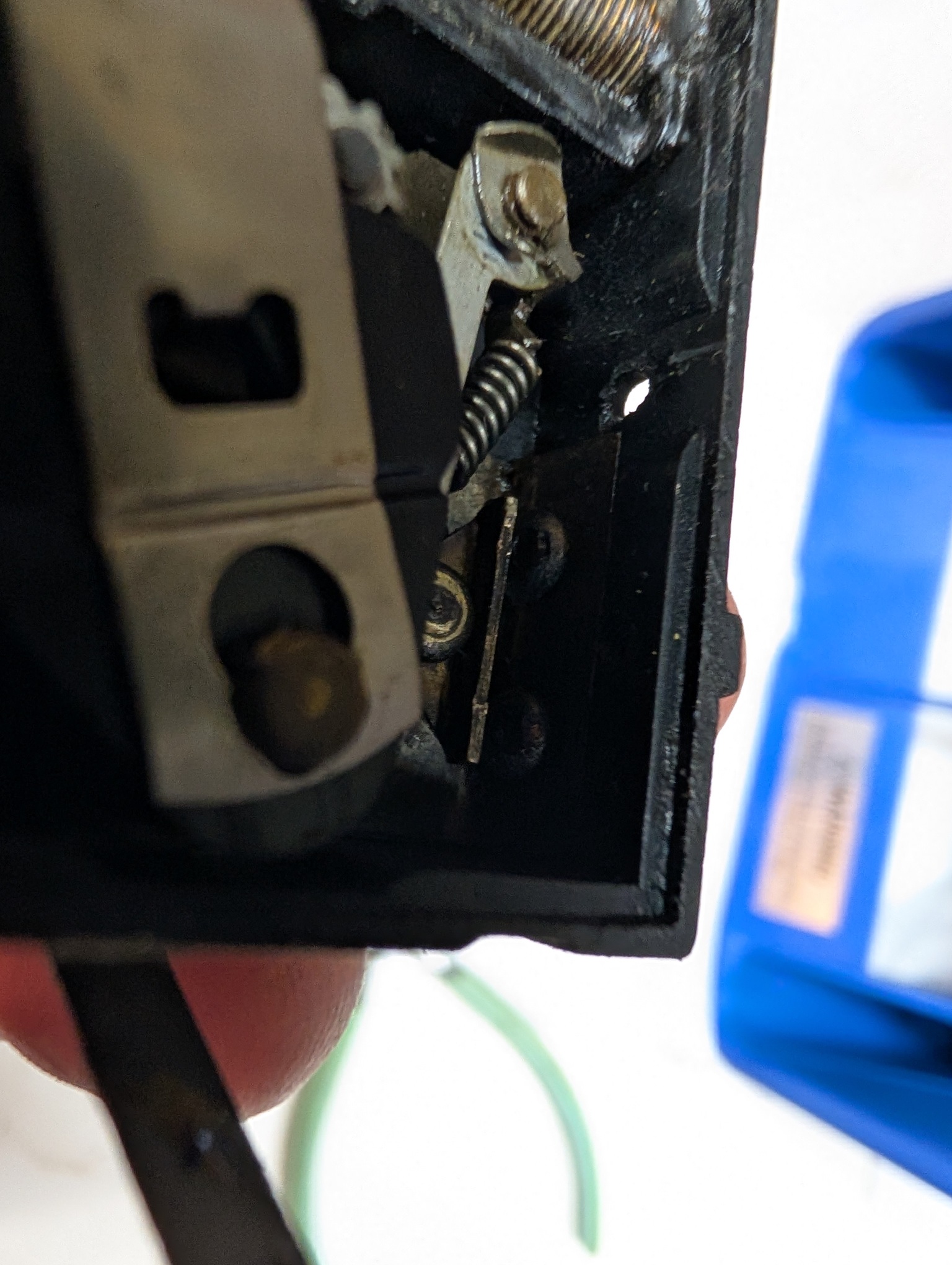

The tone ctl also has the switch, and the switchm when made, was in tens of Ks.
Luckily, it opens easy: the tabs are pushed through the holes and the back cover is pulled out.
So this is the inside:
I put some F5 on the rheostat (the end of it then started making contact). The pot is wirewound and seems to be 3.7M or so, which is close to the declared.

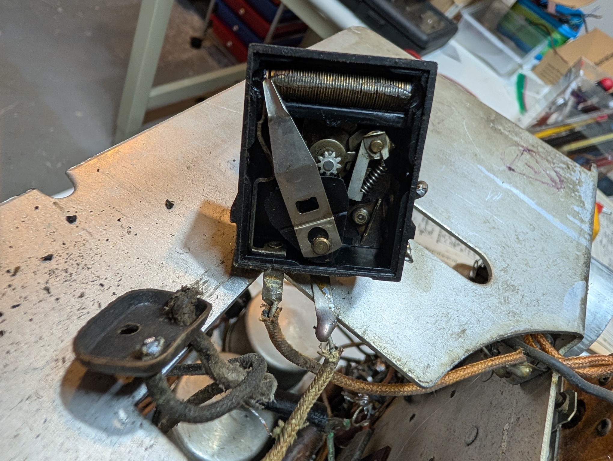

Now the switch contact group was all black:
Some alcohol took care of the soot.
Also there was another problem: when the switch was made, the contact bar would sit above the actual contact bumps. The resistance then would be in a couple of hundred Ohms. The arm that holds it, it has some play and can land plus-minus 60 mils or so; I could push it down manually and this would make the made resistance better.
The arm is fairly soft, so I used fine pliers and bent it a little so it would land the bar a bit closer to the front pot's wall. This seemed to have improve the contact resistance.
I put some D5 on it for good measure.
I also put some F5 into the volume pot which seems to be a replacement type, judging by ribbed shaft. The shaft does not cover the bushing in full, and there is a sizeable opening there, so I sprayed F5 right in.

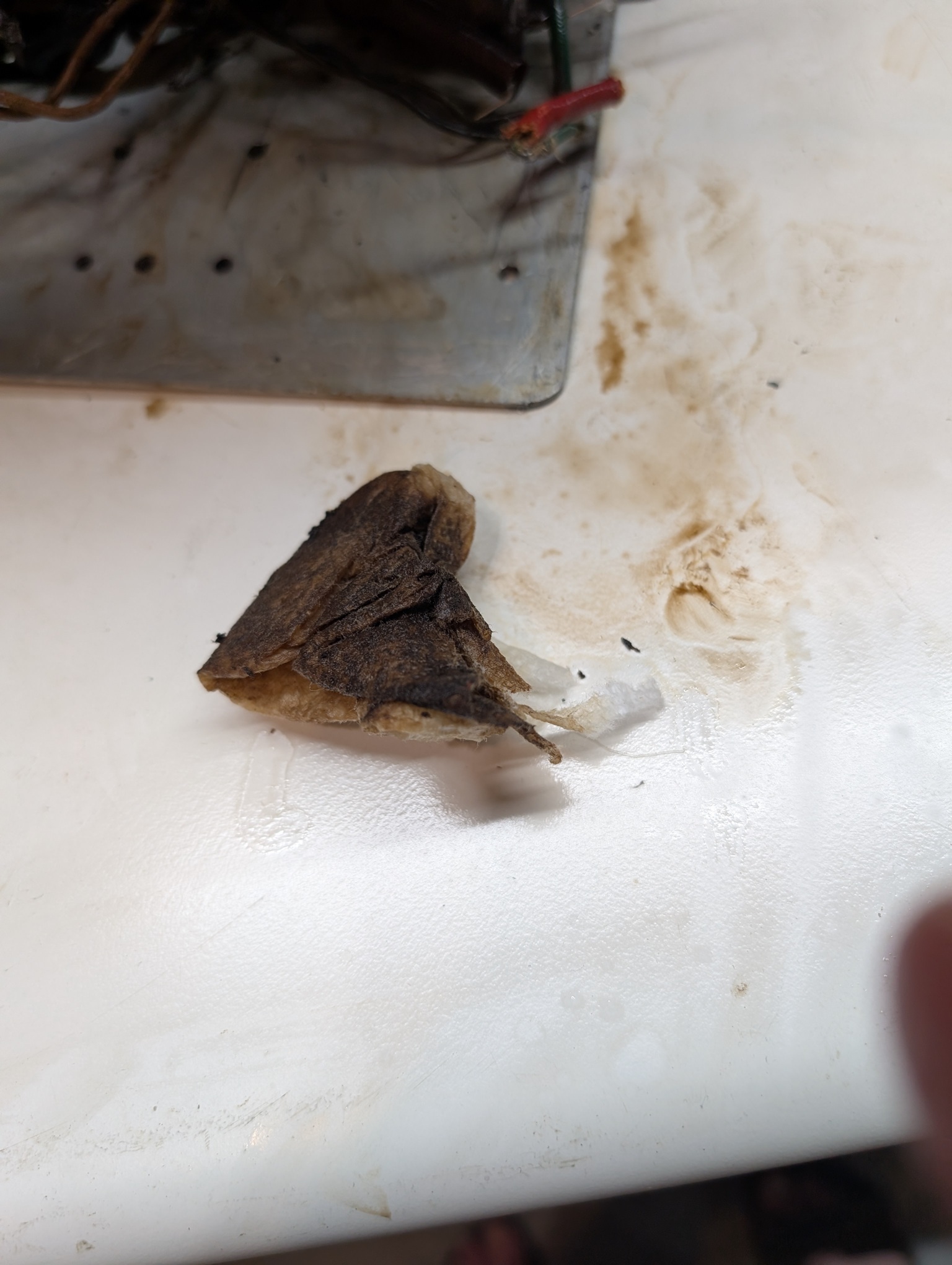

I have frozen it and pried some frozen tar aut of it.
Not sure this transformer is good, plus I cut the leads short.
