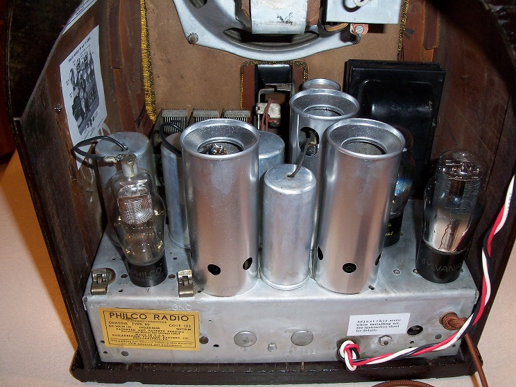

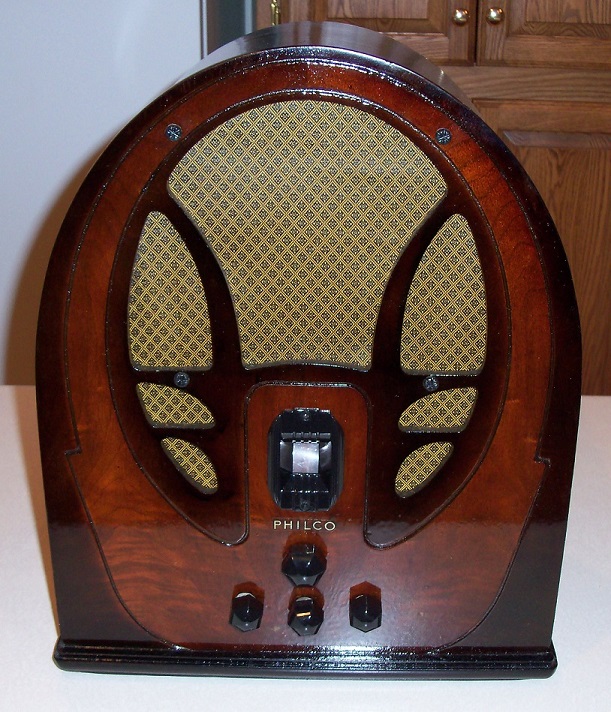

I did a little tweaking tonight on the trimmers. Nothing extreme for now, but did make a bit of an improvement. I'm happy with it anyhow. It's now back together and on display in my home. I know this isn't the place to post photos of restored radios, but since you have all been so helpful, I figured I'd borrow the Model 89 thread to show mine. Go easy on me.... I know it's not a 100 point or factory / period correct, but I like it just the same
Here you can see the reproduction cabinet labels that really look nice

Looks fantastic Greg, be proud of a job well done! What did you use on the tube shields, they looks good.

Chassis looks great. Did you paint it or is it the original plating?
Am a bit confused by the label saying to adjust this screw... That is the IF trimmer so I hope no one tries to "adjust" it. Actually one of the hole plugs should be over that adjustment hole because the screw has 250 V on it. The center IF adjustment hole had no plug because it had no HV on the screw, only AVC voltage.
Label looks like should be for the regeneration control of the Model 80 instead.

Thanks Mondial. No, the chassis is just naval jellied.
Good to know about that little label... I really wasn't sure where that was for. I may take it back off. And move the hole plug.
Thanks, Gregb as well. I actually used some chrome spray paint on the tube shields
