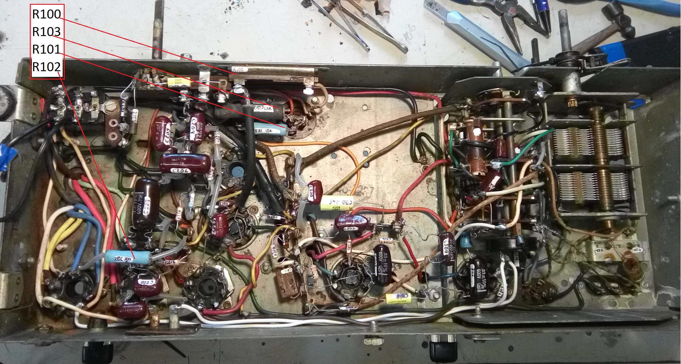

The real question is whether the radio is drawing excessive B+ current from the power supply. It is very easy to measure. Just connect your DC voltmeter across R100, indicated on your photo. This is the wirewound bias resistor and the full B+ supply current flows through it. The current here is pure DC, so there are no complicated waveforms to worry about. Measure the DC voltage across this resistor, then divide the voltage you read by the resistance of R100. You can measure the actual resistance of R100 if you want to be very accurate. The voltage divided by the resistance will give the current draw in amps. Multiply by 1000 to get mA.
If this current is close to 0.1 Amp or 100 ma, then the radio circuits are fine and there is no excessive current drain.
If the current is ok, then the 300 ohm series resistor is getting as hot as it is supposed to. Remember, wirewound power resistors are designed to operate at very high temperatures (several hundred degrees) at their rated power dissipation. If you want a cooler running resistor, derate it ( use a higher power rating resistor) or use one which can be heat sinked to the chassis.

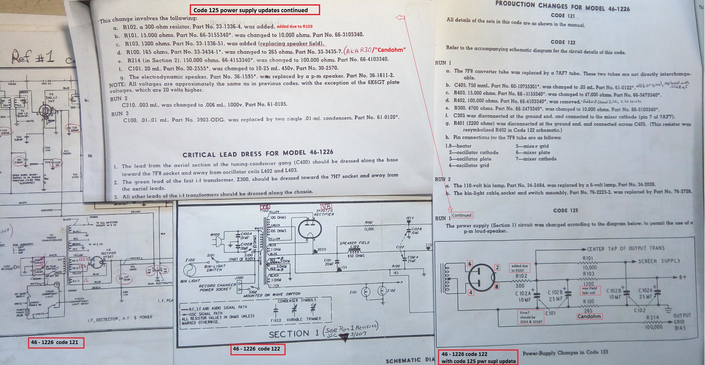

my resistor that is getting too hot is called out as R102.
R102 *IS NOT* the speaker field coil replacement.  R102 is spoken to in the code 125 update as simply "added" off pin 8 of my rectifier tube.
the resistor that replaces the field coil is R103 and is the original with code 125 called out PN#
additionally i have the original R101 with the correct code 125 call out PN but its leads were too short, replaced with the blue one in the pic.
My candohm is shown as well, as R100... its pn upgrade to code 125 is also correct.
going to get the information requested now.
I have provided updated prints & picture to help.  does this change any opinions?

the error i think i find in the filter capacitors shown to the far right on code 122.
I assume that the first filter section cap off pin 8 of the rectifier tube is C101.
I assumed that the text "C101" was correct and that the text of the 10 & 25 uf caps was meant to be C101A & B.
I have to wonder if the diagram isnt bass akwards.. a few terminations i made reinforced my assuptions were correct though.

Part      AC across      AC IN     AC Out      DC across    DC in     DC Out    OHMS     Comment
R100     O                 0            0              0                0           0            271        could be intermittant / candohm
R103     4.6               4,5         1.2           50              226        175        1341
R101     4.5               4.7         1.4           63              226        162        10024
R102     65.5             66.9       4.8            74             301         226        511         substituting/300ohm call out
v6-3      --                 4.3         --              --              214         --           --            6k6, from chassis to pin 3
v7-3      --                 5            --              --              212         --           --            6k6, from chassis to pin 3
Green    --                 0            --              --              0            --           --            T6/T100 green highV center tap
Something is wrong with your measurements on R100. Is is connected correctly?
One end should connect to chassis ground, the other to the can of C101 and the center tap of the power transformer. You measured a resistance of 271 ohms which is correct, but there is no DC voltage across it? That makes no sense unless it is not connected properly.
updated voltage results above....
on the candohm R100, i was also at least expecting something like -15v per the diagram-  46-1226 code 125 power supply update to the far right.
T100 center tap of the hv secondary (green) to>
terminal strip to>
white wire to>
C101 filter cap group (parallel caps with negatives tied to>
one side of R100 candohm to>
chassis.
if you look at the prints... Filter cap C102 negative can bond to chassis direclty.
Filter cap C101 can not be bonded directly to chassis, it must go through R100 before getting to chassis.
