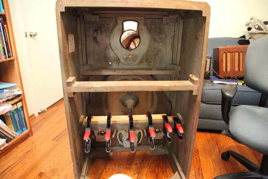

I've never seen a 37-116 that had any sort of wood blocks on the side of the chassis...and I've had a few 37-116 sets pass through my hands.
These originally used four special "J" bolts to hold the chassis in place for shipment to the dealer, and ultimately to the original purchaser. These "J" bolts hooked over the studs which stick out on the sides of the chassis, and then passed through holes in the wooden supports under the chassis. The "J" bolts were supposed to be removed by the dealer when the radio was delivered to the original purchaser. Most were, and most were tossed afterwards. But I once owned a 37-116 that was in very poor shape...that still had the "J" bolts holding the chassis in place. I kept the bolts, they are around here someplace.
You now know, Morzh, that two of the control shafts do indeed take one (each) of those rubber spacers.

Here's some pics of a 37-116 /121 with the wooden braces on and the inside of the cabinet. Your set is a code 122 but they the same. This is where the extra pieces go. I couldn't put my hands on the long screws that go from the wooden side pieces down though the cabinet. As you can see there are some rubber washers mounted in the cabinet along the front and rear edges. The long screws also have these washers too.
I made up a pair of mounts for the other 37-116 I've got. It's easy just need a drill and hand saw.
Hope this brings it in to focus. As for the J bolts I've never seen them but I'm no expert and have only seen 4 or five of these sets. Some had no mounting but center rear screw and others had the wooden braces.

Terry, before I look at the photos: I think Ron's theory is corroborated (no wooden blocks) because I have just finished speaking to a guy whose name is John Goller (he is in Indiana) and who was recommended to me by name by Ed Shultz, the owner of the "Renovated Radios". John has just finished restoring 37-116 and has done many of them, and he says that the wooden blocks are not used on 37-117 - they are used on those with tilted front panels (690 and such).
According to John the chassis is held by one single bolt in the center of the back of the chassis and the rest is the weight and the hub of the dial mechanism.
So at least I think I don't have to worry about the missing blocks.

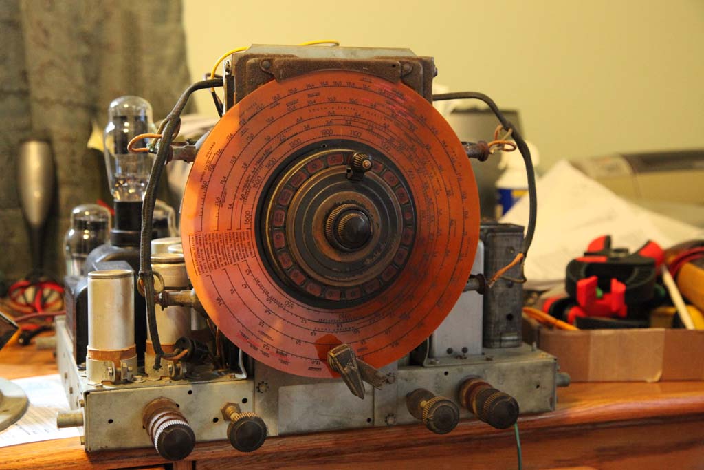

Yes resting on the dial is not a good idea, with the dial not working, let alone the fact that the metal is pretty thin on both the hub and the escutcheon and considering a very heavy chassis they would bend each other - John probably meant the fact that if you tilt the radio side to side or backwards, the fact that the dial protrudes through the hole of a close diameter will not let the chassis fall out which it would do otherwise being heavy and held by a single (and not that thick) screw at the back (the leverage is hyoooooge!).

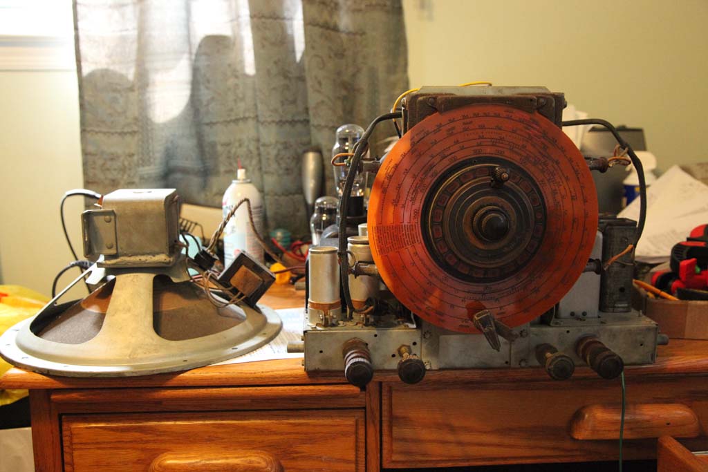

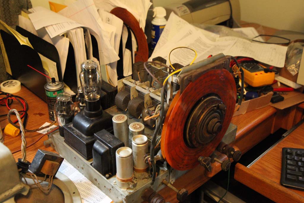

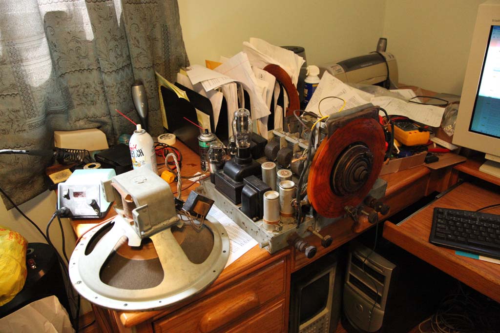

Well, I bought some felt furniture pads, stacked them in two and placed under the chassis.
Then using razor blade I trimmed the height of those so the hub of the autodial would go in the middle.
Anyway: wow. And I mean WOW! What a sound! That leaves my Zenith in the dust!

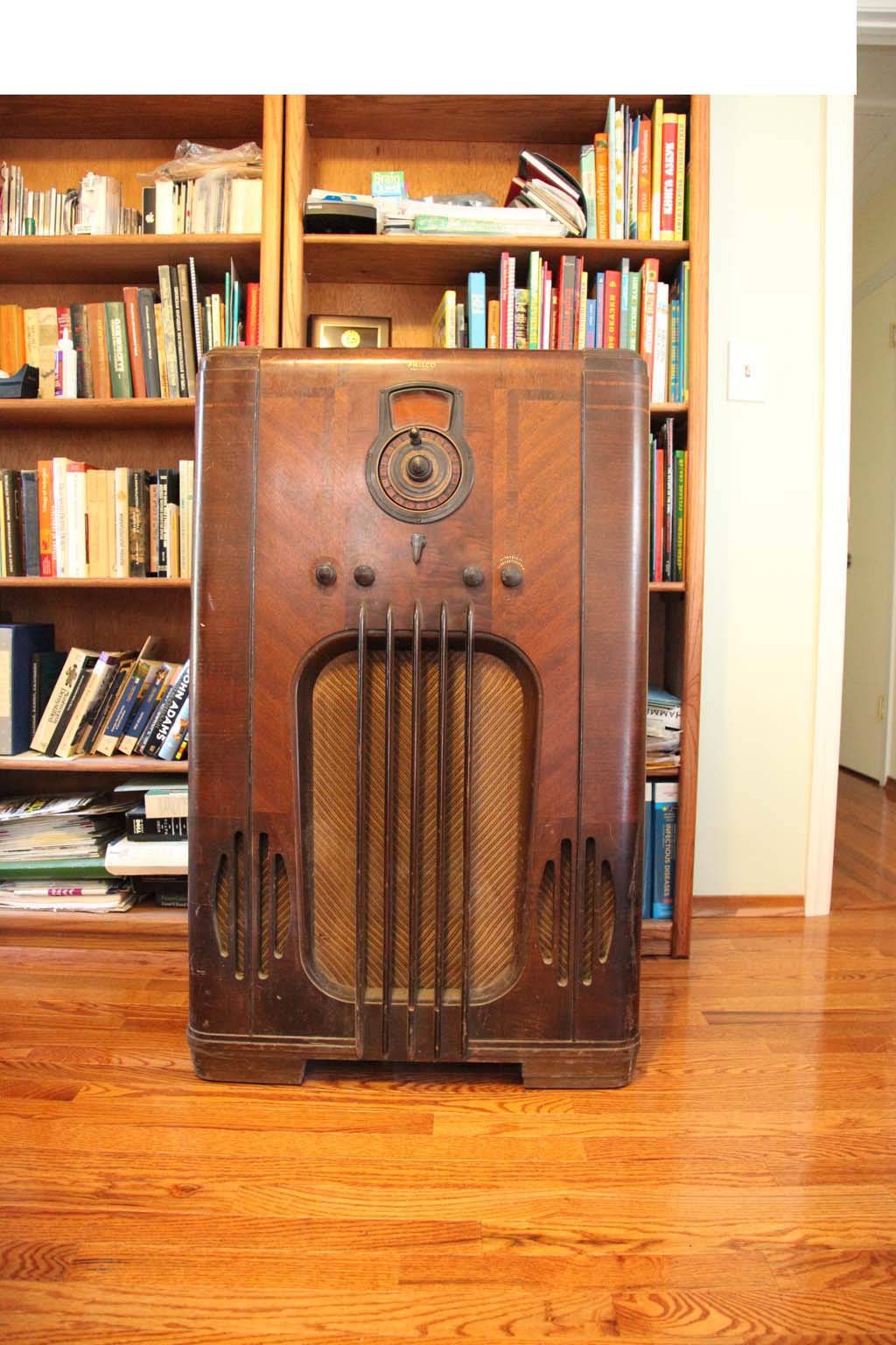

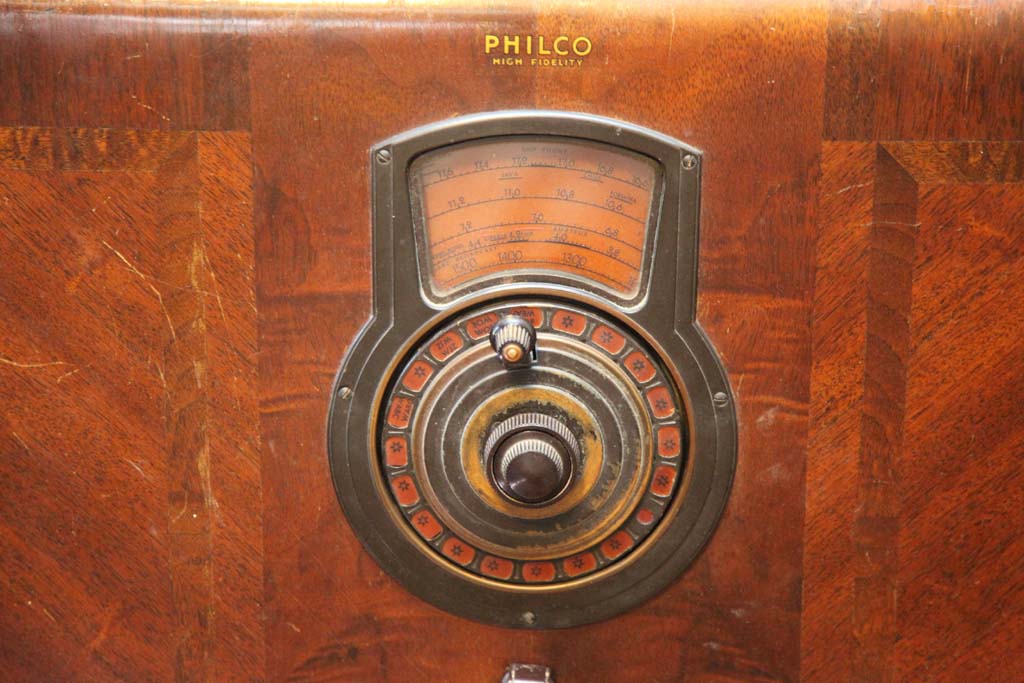

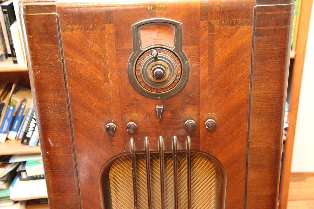

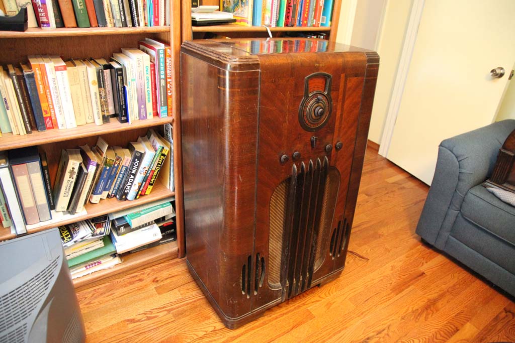

Here are some photos.

If you want to do something quick, easy, non destructive, and cheap to clean up the cabinet. Get some GO-GO (Non pumice/no grit) give it a good rubdown with the GO-JO and a soft rag like an old t shirt. It will clean up the old finish, remove years of dirt, and darken the scratches. All in all will make a big improvement on the looks. Don't know if you have already have but pop off the handles (knobs) and soak them in a bowl of warm water and a bit of shampoo for 15-20 mins. Scrub with an old tooth brush or finger nail brush till nice and clean.
