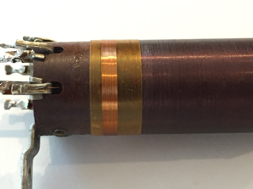

Ok so I gave your method a try and it came out pretty good.  I used some polyimide tape that I found on Amazon that has really good dielectric and temperature specs.  I used 27 turns of #38 like you suggested and I'll be testing it soon.
Dave Thomas
Coatesville, PA
Wow that looks great Dave!
Mark K8KZ
