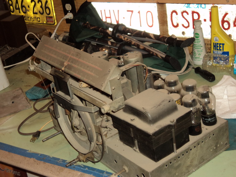

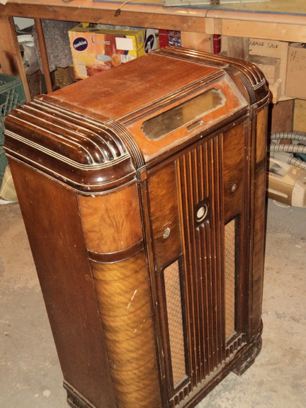

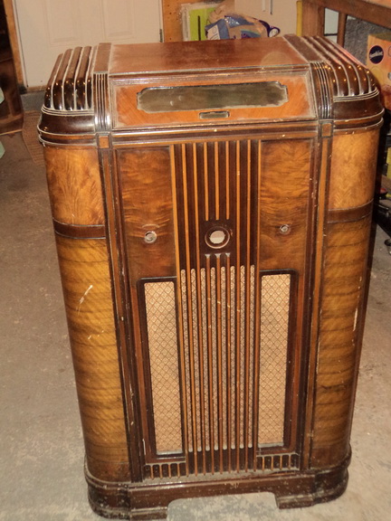

I picked up a Queen Elizabeth 11-11
 I drove the 360 miles [round trip] for this Rogers Queen Elizabeth. model 11-11 [6R1131]
 I now have the radio recapped and it sounds very good. the cabinet is original and I hope to keep it that way
by just doing a good cleaning with go jo and a little touch up.
 This one is a keeper; at least for me.
   Living in Calgary Alberta
Nice Dan. Looks like the cabinet should clean up nicely and I like the way the speaker grill extends up to top of cabinet.
Magnifique!
I like that style!  Very, very nice!  Please keep us updated as you get it back together.
Craig R
That's a awesome radio Dan, love the design on cabinet and the book matched veneeres. I bet it will sound as good as it looks. Icon_eek Icon_eek Icon_eek Icon_eek Icon_clap Icon_clap Icon_crazy
Looks very imposing.

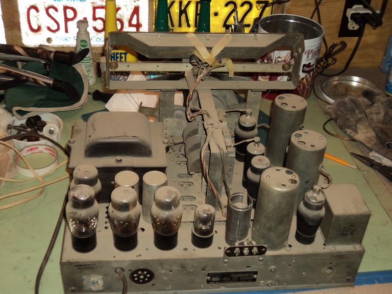

  Are you sure that it's a Rogers branded set or a Canadian Majestic? From what i can tell all of the higher end Rogers brand sets got the rolling pin dials such as the 10-10 and 10-12. Anyhow the groggy performance of that 10-12 you have, the one that still has the clock, might be attributed to drifted resistors, I found a whole bunch of off spec resistors whilst rebuilding my 10-60, not to mention that crappy rotted rubber/gutta percha covered wire. It may be worth checking the ones in the Queen Elizabeth for drifted values as well, often recapping is not enough.
P.S I love how they reused the same sheet metal chassis for different models, note the three caps they put over the holes along the top right hand side of the chassis. They did that in my Deforest Crosley Brahms, on the 10 tube version of that chassis they add an extra tube, on the 11 tube they add two extra tubes and an extra IF can. It was sort of a scam though, the extra tube in the 10 tube chassis was an 84M, a Rogers copy of a 6H6G with a spray shield, and the two diodes perform the same second detector-AVC functions that the diodes in the 6R7M do in the 9 tube Brahms chassis.

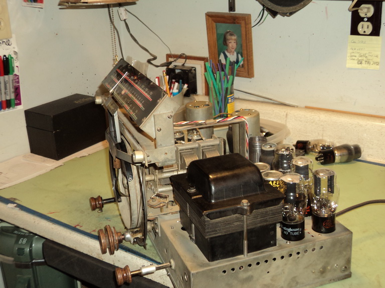

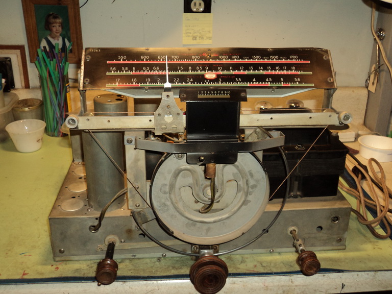

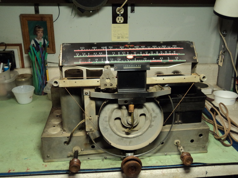

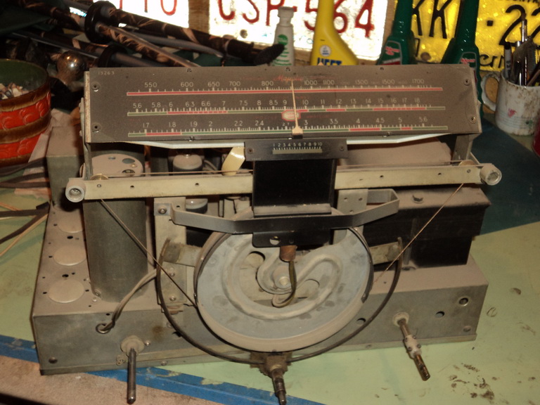

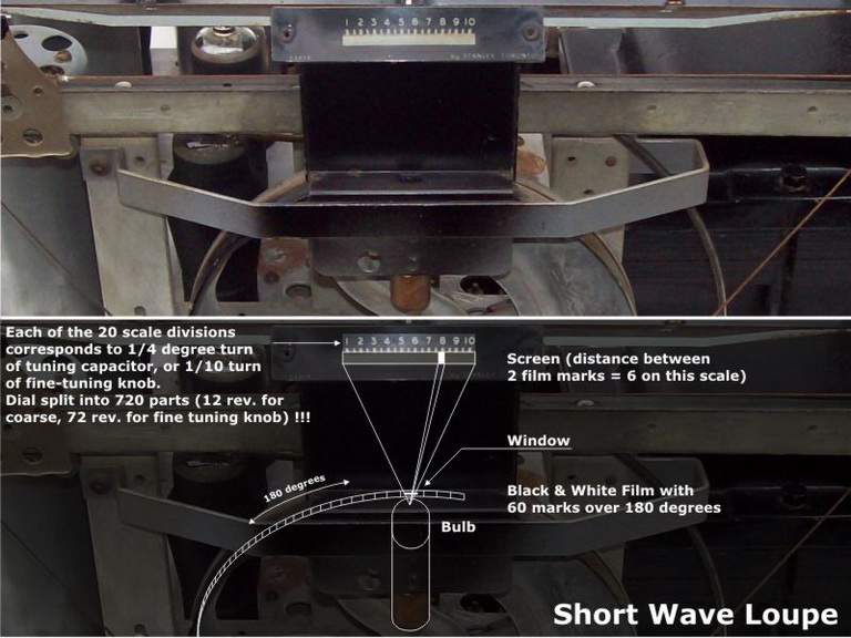

 There is one thing about this radio that I have never seen and it is called a short wave loupe. {see photo]
On my radio, everything is there  and working but I can hardly see anything on the indicator unless the room is totally dark.   MAYBE IT WAS ANOTHER SELLING FEATURE THAT REALLY DIDN'T DO ANYTHING.
 I did try moving the bulb closer or farther away but it did not make any difference.
  The Queen Mary  also has the same setup.
  As far as the cabinet is concerned I have had a close look at it and I think I will go over it with gojo and use Trade Secret on it  and that should be all it needs. It is only original ONCE. The Rogers grill cloth is in good condition and I am glad because it is like hens teeth  to get any. I had some extra knobs which are the proper ones so I am good there.

Dan;
  That "Short Wave Loop" as they called it, looks basically like a gimmicky Majestic brand version of a vernier tuning display. The Rogers brand sets had a wheel with numbers on it that would spin around as it followed the pointer like the 10-10 and the 10-12 had. I figure that they did things like this just to fool the public and the dealers into thinking they were getting something different as opposed to a Deforest Crosley or a Rogers. The "Short Wave Loop" display on the Majestic probably needs either to be taken apart and cleaned or needs a brighter bulb, when I first saw that I assumed that it was some sort of shadow meter until I saw the words "Tuning Light" marked on the dial itself. I will see if I can find any service information on this feature out of the Canadian Majestic manuals I have, it will probably be listed under 6M1131 if I have it.
  That Queen Elizabeth has the sort of chassis that I would consider performing a capacitor restuff on, it doesn't look like anyone had replaced anything. Which is more then I can say for my 10-12 where someone decided to re-engineer the audio circuitry for very questionable reasons. The only thing I can figure is that maybe the audio interstage failed, but that doesn't explain why they disabled the tuning lights and messed with the tone control circuitry, probably someone who was ignorant and rather then figuring out how it worked decided to do their own thing.
   Arran,    I agree with you , that it was another sort of gimmick ,but I still would like to get it working properly.
  Can you suggest a bulb to use in that ''Short wave Loop' 'system?  I have a 47 in there now. it is a screw base.    There is nothing to take apart, and the only cleaning is to wipe off the plastic attached to the tuning wheel. There are no moving parts, other than the wheel.

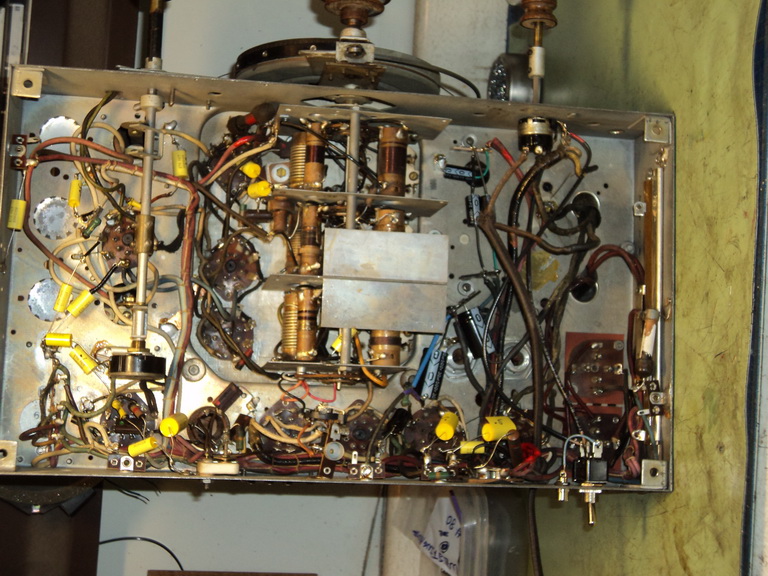

   I have already recapped the radio and I didn't restuff the caps . I was going to restuff the three in the cardboard box but decided against it.

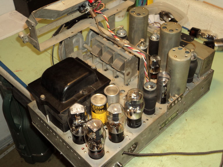

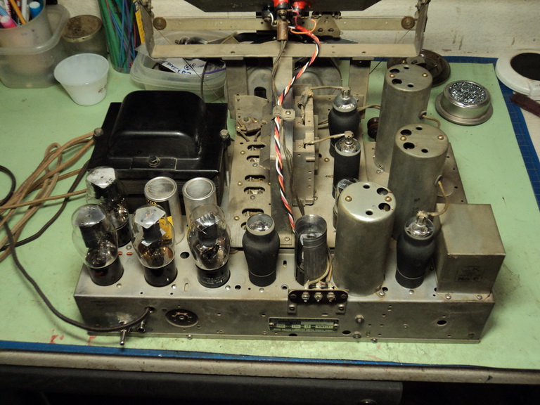

   Well the rogers 11-11 is all recapped and aligned properly. what a good sound.. I added a phono jack with a switch and the MP3 sounds very good through it ..Just like the old juke boxes. It is a keeper for sure.
 Here are some more photos..
Looks great Dan, that's a darn nice radio will look fantastic with your other Rodger consoles.

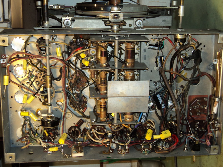

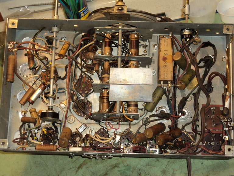

   I thought  I would show a couple of photos of the underside of the chassis after I recapped it. I am
  waiting for warmer weather to get at the cabinet.
Icon_clap Beautiful job ! I know what you mean about the cabinet. I am waiting to finish my 37-61 until it warms up enough to varnish the cabinet also. I keep my house at 60F in the winter to save fuel costs, so it is really too cold to do it in the winter, not to mention the fumes, so it will wait until the weather warms. How did the alignment go ? How is she playing on the bench ?
