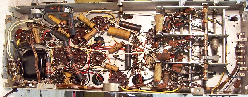

Before I start work on the chassis I annotate an under-chassis photo with part number callouts from the schematic, and then compile a complete survey of the condition of all parts.

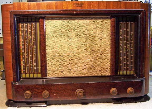

  • The cabinet was in good condition with only occasional scratches and finish loss. The knobs were original. The back cover was present and in good condition, but the retaining screws did not appear to be original. One knob spring was missing.

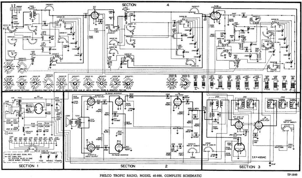

I have attached a copy of the schematic, for those members who are not members of RadioMuseum.
I tried using Photobucket as recommended, but when using a width of 900 pixels, the size was about half the size when using an attachment. If anyone would like a clearer copy, send me a PM or email.

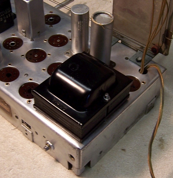

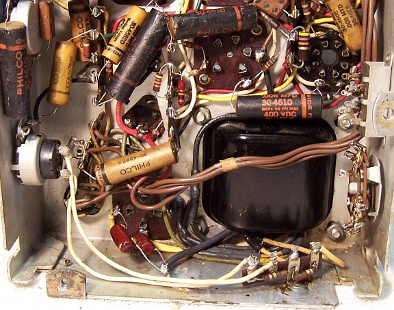

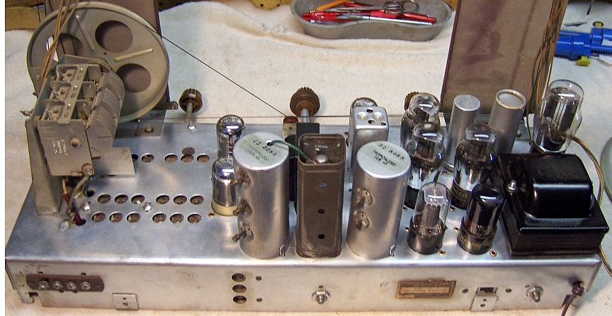

The replacement power transformer and restuffed filter capacitors were next re-installed. As mentioned before, the mounting centers of the original and replacement transformers were exactly the same, so no modifications to the chassis were needed. All of the wiring associated with the 115/230 voltage selector switch and Hi-Med-Lo line voltage switch was removed.  The switches were left in place. The power transformer primary leads were connected directly to the AC power supply terminal strip. The existing AC power switch wiring was left in place (also connects to the AC power terminal strip). There was some fraying and wear where the wiring bundles passed through holes in the bottom transformer cover. The cover was removed and shrink tubing was applied to any wiring that was frayed to prevent future shorts.  Some of the lead wires were very stiff and could break if bent. I used a heat gun to soften up the old insulation prior to bending the leads. There was no room inside the transformer covers to splice on new leads, so the existing leads had to be used.
The replacement power transformer leads exited the bottom cover, just like the original. However the positions of the primary plus 6-volt filament bundle and the high voltage plus 5-volt rectifier bundle were swapped on the replacement – they were on opposite sides of the cover.  This meant that some of the replacement transformer leads were too short.  These leads were spliced with appropriate new wiring and the splices insulated with shrink tubing (double layers for the high voltage secondary leads).
The wax/paper capacitors that were removed in order to gain access to the filter capacitor wiring, and were subsequently restuffed, were also reinstalled. A few out of tolerance resistors in the power supply and audio amplifier sections were replaced. I do not like to have too many loose parts at one time, so before doing any further recapping or resistor replacement I wanted to reinstall everything that had been removed up to this point. Once some of the (leaky) capacitors in the audio section were removed, additional resistors were discovered to be out of tolerance. And some had likely been damaged by soldering heat. I tried to make sure that all resistors in the phase inverter circuit were within 10% tolerance, as they affect the balance of the audio output stage, and thus the fidelity.
C100 and C101 (bottom center of bottom view) were replaced with 0.0027mfd 1600v dipped film capacitors. The originals (0.003mfd 1500 volts) had been replaced with 0.003mfd 600 volt paper caps as received. Since these are connected between the high voltage secondary leads and the chassis, I did not trust using 630 volt caps here.
Attached are photos of the top and bottom views of the power transformer area of the chassis. The AC power cord has not been installed at this point.
Looking good! Icon_clap
 Very professional looking work. Icon_thumbup
What Bob and Mike said, only they said it first!   Icon_clap  Quality work.

I then reinstalled the rectifier tube and monitored B+ with my DVM.  I again powered up the chassis with my Variac through a watt meter while monitoring the B+. Power was increased at about 10 volt increments, allowing time for the new filter caps to reform. The band switch was set to the broadcast band and the volume control set a maximum.  At about 80 volts AC I heard some noise. I increased the AC to 115 volts. The radio actually worked on all bands. The volume control was smooth and free of noise.  The tone control, which was an area of concern, seemed to work OK although I’m sure not as well as it should, since the resistance had drifted from 6meg to 16megs! At maximum CCW, bass boost or loudness compensation was reduced.  As the control was rotated clockwise to about ½ rotation, bass increased. Further CW rotation reduced the treble.  So for most fidelity the control should be centered.  CCW rotation reduces the bass, and CW rotation reduces the treble. This seemed to agree with the schematic.
The next step is alignment of the two IF stages and 10 bands of trimmers! At this writing I have completed alignment of the IF stages and Shortwave #3 band. I was concerned about this band since my signal generator only goes up to about 12mHz with any stability. I have to use harmonics for adjusting anything above 12mHz. So to set the SW3 band to scale at 21mHz, I set the generator to 10.5mHz. I use a frequency counter to calibrate the generator. SW3 was easier than I thought it would be. Even the image frequency appeared where it should have been.  All that’s left is to complete the alignment, clean the cabinet, and reassemble.

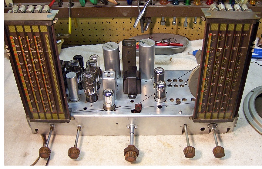

Photos of the completed chassis are attached.
nice , looks great dave   Icon_clap Icon_clap Icon_thumbup
+1 on sam's comments!!
Icon_clap Icon_clap Icon_clap
