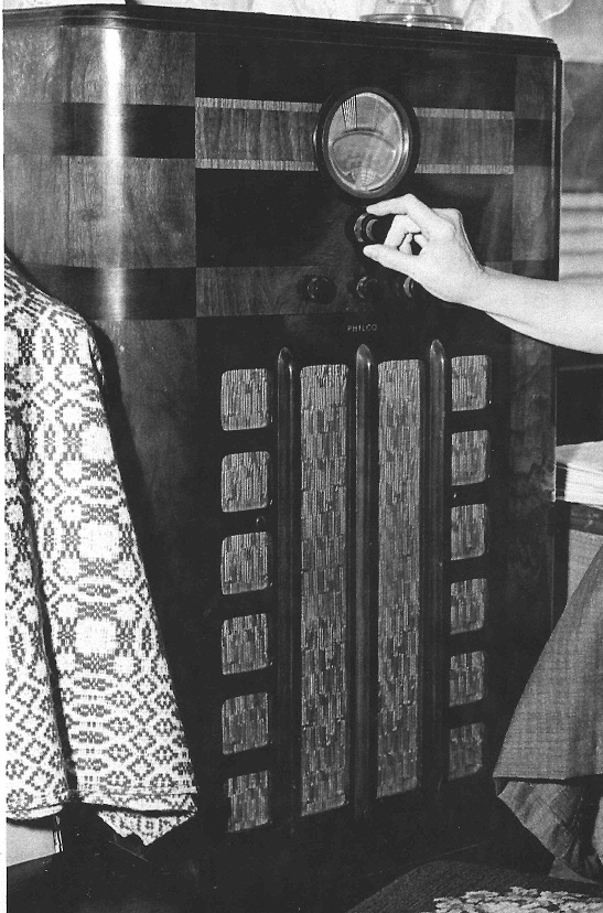

Hello everyone.  This is my first post and it concerns the identification of this Philco radio.
Could I tap into your knowledge and have you identify this radio.  I would like to know the model number and years it was produced. I think it's from the mid-1930's but am not sure. Can anyone tell me how many tubes it had and give me an idea of its short wave capabilities as well as the frequencies it received.

Hey and WelCoMe!
That beauty is the 1938 series but which one exactly I cant say.
Here they are on the Awesome Philcoradio.com gallery page.
http://philcoradio.com/gallery/1938a.htm

If you take a look at Ron's gallery link to 1938 Philcos (introduced in June 1937) you'll see a number of models that used this cabinet (38-9K, 38-38K, 38-39K, 38-40K, 38-89K, 38-623K, 38-624K, 38-630K & 38-2630K)  http://www.philcoradio.com/gallery/1938a.htm
No shadow meter - so we can eliminate 38-630K and 38-2630K. Icon_smile

Now that I got your attention, here is the story behind this picture. According to the woman whose arm you see pictured, she heard Amelia Earhart broadcast over her radio. I am assuming this is the radio she heard that broadcast. From some of your answers, the radio must have been recently purchased. The date she said she heard the broadcast was July 3, 1937 at about 1400 Eastern Standard Time. (her local time) or approximately 1900 hours GMT. The time in the Pacific where the broadcast allegedly originated was approximately 0600 or just about sunrise. I have only superficial knowledge of these old radios, but I have been told numerous radio technicians that the best time to hear a distant broadcast is right around sunrise at the transmitting location.
At the moment, I am not sure if she had an outdoor antenna rigged to her radio (Was that common in 1937? and what time of antenna would she have used?) It is unknown what frequency she heard the broadcast. Earhart was told to transmit by voice on 3105 kHz during the night and 6210 kHz during the day time. There is confusion whether she actually followed those directions. However, it appears most of the possible legitimate radio signals that were heard following her crash were heard on the harmonics associated with 3105kHz. Amelia was using a 50-watt WE-13C transmitter. She would have had to have the right engine running on her Lockheed Electra in order to power the generator.

As mentioned, it's hard to say for certain which Philco model that is without more information because Philco used the identical cabinet for a number of models.
But.. we can say that based on the list of possible models it had 6 tubes (different tubes depending on the exact model).
Would the woman pictured know if the radio ran off of batteries or was plugged into the wall?
AC and AC/DC sets include 38-9K, 38-23K, 38-40K, 38-89K.
The rest are battery operated sets.
38-9K
  • AC
  • 6 tubes
  • Two bands: AM and shortwave from 5.7-18.2 MHz

  • Two bands: AM and shortwave from 5.7 to 18 MHz
38-38K

The above information comes from the gallery link posted earlier and a summary of tube layout information for Philco models of that year summarized here:
http://www.philcorepairbench.com/tube/tcomp5.htm
Thanks for generating that list Nathan!  Looks like the set had to be the 38-89k, 38-263k or 38-264k to hear broadcasts on 3.105MHz.
Yes, Philco sold an antenna set up for outdoors known as the High Efficiency All-Wave Aerial.
It would not have been a 38-623K or 38-624K - the knobs are spaced differently on those. So that leaves the 38-89K.
July 1937...yes, the 1938 Philco models were introduced in June 1937, so that was still basically a spankin' new model, one of the first 1938 Philcos produced.
OK..I see how the knob positioning for the 38-623k is different from the pictures in this thread http://philcoradio.com/phorum/archive/in...-3979.html

So you need to find a 38-89 chassis or its equivalent. That would mean any of the following radios with a working chassis (or even the chassis without the cabinet since the chassis in these are the same) would fill the bill: 37-89B (table model), 37-89F (console), 38-89B (table model), or 38-89K (console).
Borrowing might be difficult since shipping is always a somewhat risky business but you never know until you ask. You can add a note in the "Wanted Ads" section to buy or borrow a set and see who might have something. There are a few 37-89s on ebay at the moment even some that claim to be working (that sometimes means that the dial lamp glows or you can hear static).
There is the Northwest Vintage Radio Society that is only 2 hours south of you that might have someone who owns one of the above radios and could help you out. Unfortunately I don't know anyone in that group but you could give them a call to see what they might have. Most folks in this hobby are pretty friendly and always interested in showing off their collections.
If you are trying to recreate the radio call that the lady believes she heard and looking for the same set to use as part of the experiment, keep in mind that restored sets today may vary quite a bit in performance depending on how well they were restored. Reception on short wave can be very dependent on the atmospheric conditions that cause the radio signals to bounce off the atmosphere and travel long distances (I'm no expert on this, just general info. ) OK..probably more than you wanted to know ...
