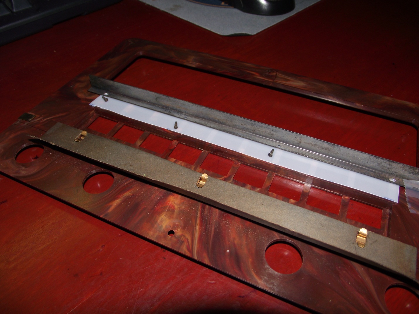

1) The first thing I did was purchase a repro escutcheon. The original was severely distorted & broken.
In my zest I removed the brass plate for the dial labels & the angled cardboard piece that goes on the backside of the escutcheon.
Problem 1) - I did not note if the cardboard angle faces up or faces down. I installed it on the upside & the escutcheon doesn't seem to want to install. Before I fatigue the brass again to flip it around I wanted to ask what is the proper position for the cardboard piece.
Note: Picture with correct installation added after original posting.
2) Second question - Push button copper "spring". Unlike the other buttons the left end button does not have the rectangular spring. Is that proper?

1) Mine does not have a cardboard piece on the backside of the escutcheon, so I 'm afraid I can't help you there. Perhaps you can post some pictures of it.
2) I believe this is right. Mine also did not have the copper spring on the On/Off button, which is the one on the left.
It's not how bad you mess up, it's how well you can recover.
The copper springs are designed to block light from the little tabs above each pushbutton *except* for the button that is pushed in. Notice when you push the button for the AM band, the "B'D'CST" tab lights up above that button.
When you push the OFF button, this turns the set off, so it cannot be illuminated; therefore, no copper spring is needed for this button.

Question- On the back of the escutcheon, above the push buttons, trapped by a small angled metail detail is a sheet of plastic ~ 5/8" wide x 7-1/4" long. When new is this item translucent or clear?

Using a reproduction escutcheon one has to transfer or replace the white vellum paper and angled metal piece on the back. When doing mine, I found one of the four drive screws was missing.
The drive screws are tiny ~ 1/16” dia x 3/16” long.
Replacement screws can be purchased @ SpencerAircraft.com
P/N MS21318-2 or alt part # AN535-00-3
I have now have extras if you need one.
FYI – install hole = .052 diameter, that is a #55 drill
(This post was last modified: 04-28-2014, 11:12 PM by gfleduc.)

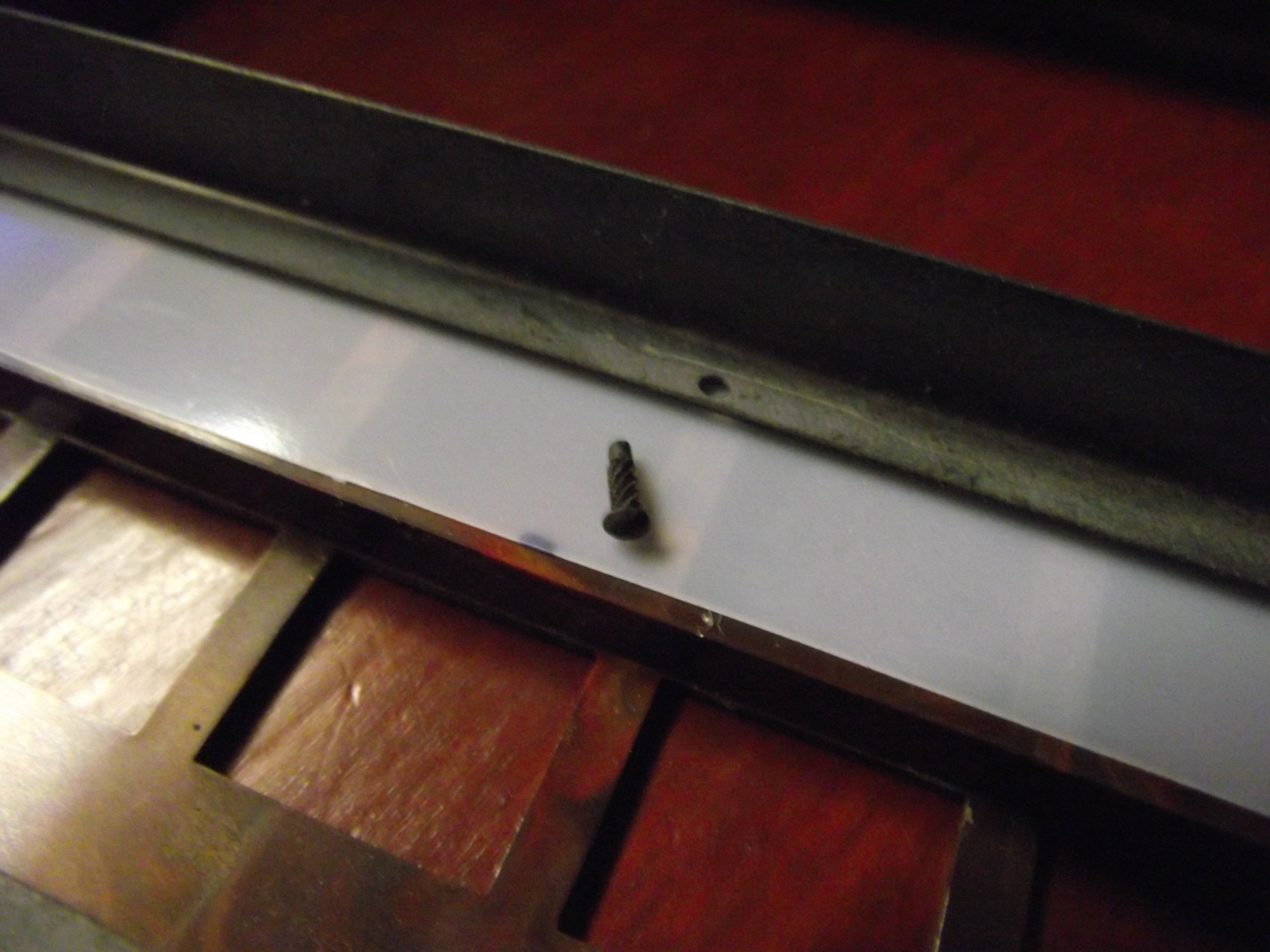

Mine is missing one of the 4 screws as well. I just got the 4 new screws. However I'm wondering how do you get the old screws out without damaging it? And do you just hammer in the new ones after you drill the hole?

Very carefully  actually you might be right about tapping them.in with a hammer. I have seen screws like that before. Does it have a head that looks like a round nail haad and are the "threads" different than it's screws? They kind of go up the screw instead of around aND around? If so then they need to be tapped in carefully.

Very carefully use a sharp pick. lift up then use pliers and twist off
