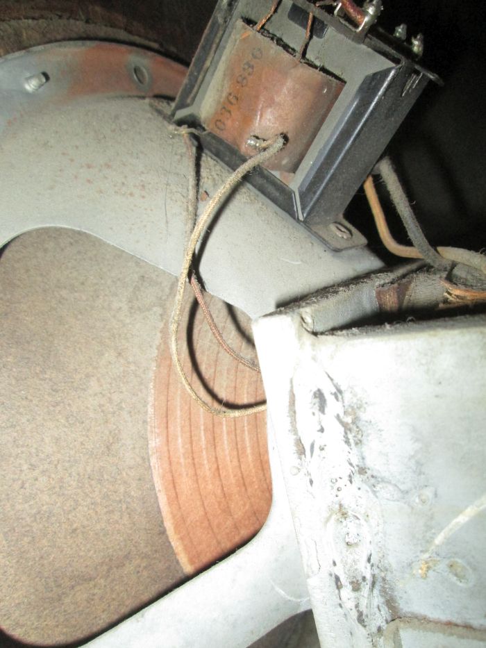

Speaker issues: The center spider cone with 3 spider fingers isnt level. the spider fingers dip in twards the field coil a bit like 1/8 inch. Ideas are: shim out the spider(mark oppat). Assist the spider with something, Reverse the voice coil leads to the output transformer. Yes, I noticed that when I removed the cone to patch suround, I saw that the the voice coil wires cross each other after the suspension wire holder spring. I would think they wouldnt cross and go straight to their perspective output transformer terminals. Looking for pictures of 116x speakers.

Oh you mean like this...

Speaker issues: The center spider cone with 3 spider fingers isnt level. the spider fingers dip in towards the field coil a bit like 1/8 inch.
It maybe from the damage cone that you are repairing. If the cone isn't rubbing on the pole I wouldn't worry about it. If it's rubbing then shimming and or re centering w/ the screw in the center may work for you.
Speaker shouldn't be an issue as you only have one speaker. If you had multi speakers then the phase relationship will make a slight difference.
